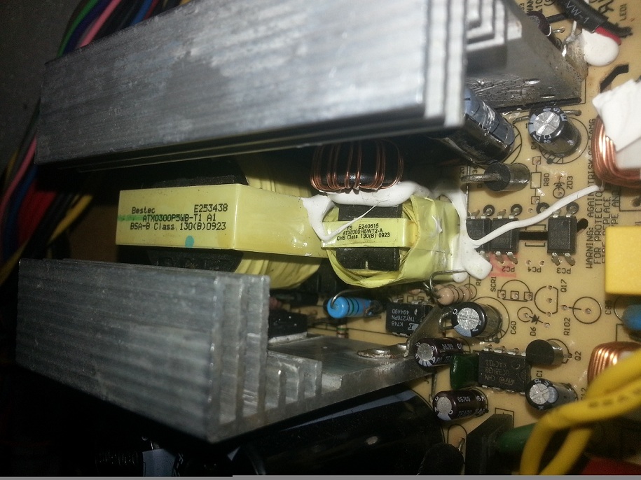

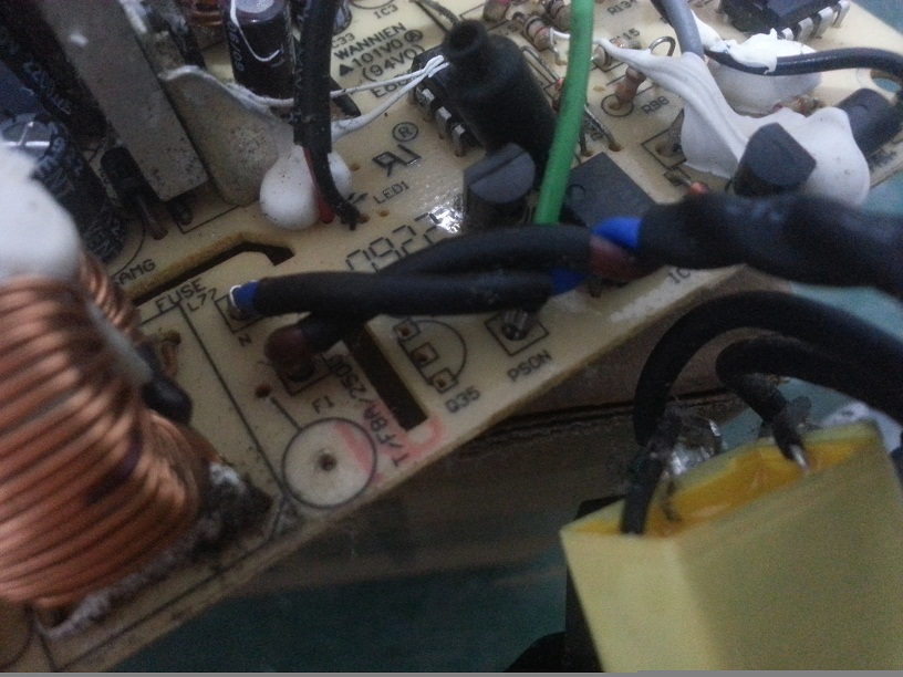

    I bought a dead motherboard, and connected it to this PSU,
    Was checking the standby voltages on the motherboard, and, whilst doing so, the PSU made a loud bang with a flash of light.
    So now i truly got a bang for my bucks, and something else to try and fix.
    The fuse was blowen, and the top was blowen off of a TNY276PN chip
    The glass fuse didn't have any marking to say if it was fast or slow blow
    So i checked the marking on the PCB thinking that that would tell me,
    but it 's got a T/F8A printed on the board
    So should i get a fast blow fuse, or should i get a slow blow fuse?

    Re: Bestec ATX0300F5WA - fast,or slow blow, fuse?
    nothing etched on the metal fuse ends?
      Fast blow.
        I thought that the other end was just trademarks etc,
        but on the outer ends it had "CONQ FUSE", which i looked up to be Conquer Electronics
        so, on that other end of it, nearly half hidden, was "GFE", which is "Fast-Acting"
          This is working OK enough now, but there is a squealing sound that appears to be coming from the smaller standby(?) transformer, and it gets louder, and sounds like bagpipes, when i turn it on.
          i checked all of the electrolytic capacitors that are around it - they test OK
          Standby is 5.14V, so that's a bit high
          Any ideas as to what could be causing this squealing?
              T is for time delay slow blow

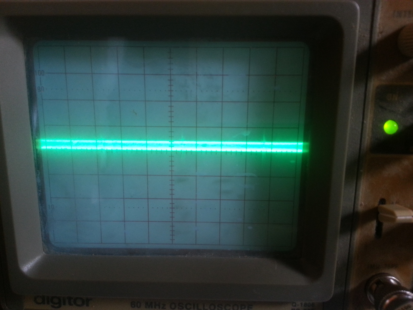

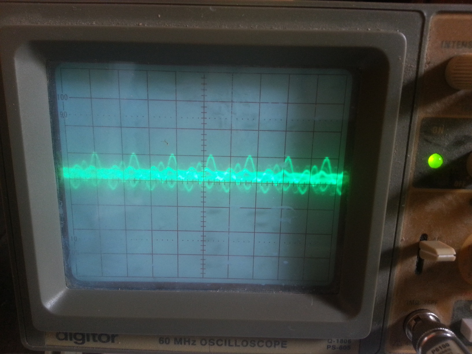

                    I only needed to replace the TNY276, chip and a TVS diode (which is just behind the blue resistor which is also a replacement, because, although the original resistor tested good, it has some of it's insulation missing.
                    Using the recommended testing capacitors, i can't get a clear signal on the 5VSB rail, and it gets worse when i power it up (see attached photos)
                    When it's powered up with a hard drive there is peak to peak ripple of 70mV, which is higher than the allowed 50mV
                    And i can't trigger a well-enough defined signal on the other rails either (but can on another PSU)
                    Adding a 1A load to the 5VSB doesn't clear up the signals
                    It looks messy
                    But maybe that's OK for these PSU's?
                      I think you have to check in spite of the capacitors on the secondary side, also the filter coils. These signals showing in the oscilloscope look not very clean. There may be something wrong with the PSU.
                      I have seen situations when the noise from the transformer is related to the maximum allowed duty cycle coming from the PWM IC. It happens when we want to change the output wanted set point i.e. from 3.3V designed to work the transfromer to 5V or when the input voltage is too low regarding to rated voltage i.e. 150V instead of 230V.
                        Thanks for your thoughts
                        There is 162V across each primary capacitor, so that's OK,
                        And i don't think that the following is applicable in this situation, because all of the rail voltages are in spec:
                        It has to be something that is common to the standby and the main rails, because it's affecting all of them.
