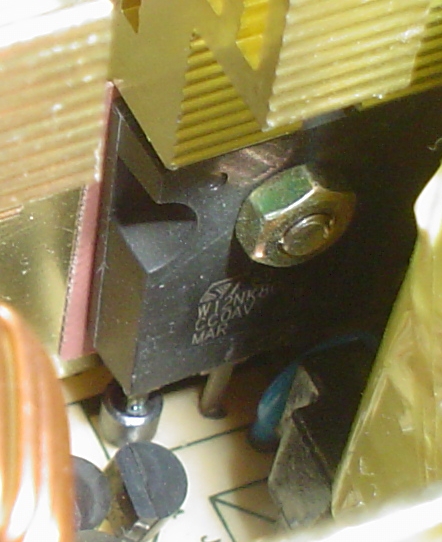

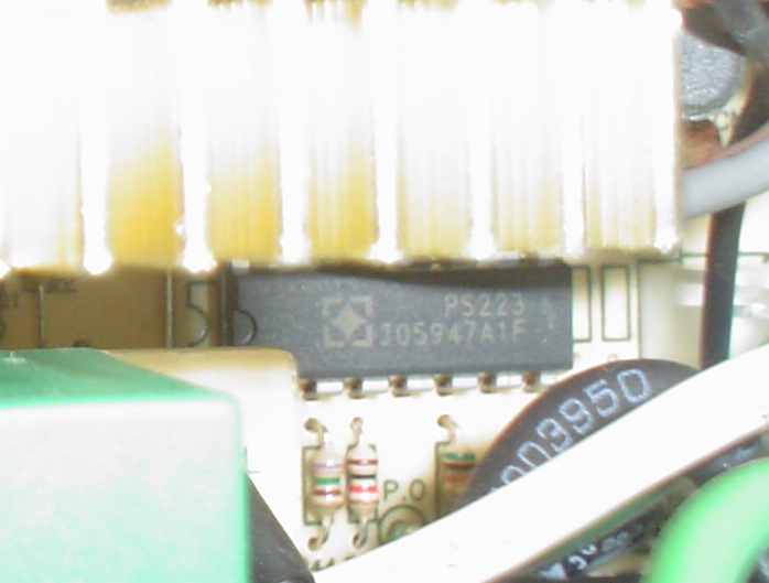

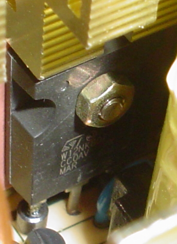

          Reading the post above
          "being supplied via an UPS" that puts a slightly different light on it.
          Oh ensure brain in gear before typing so I was thinking old school on the bridge thing

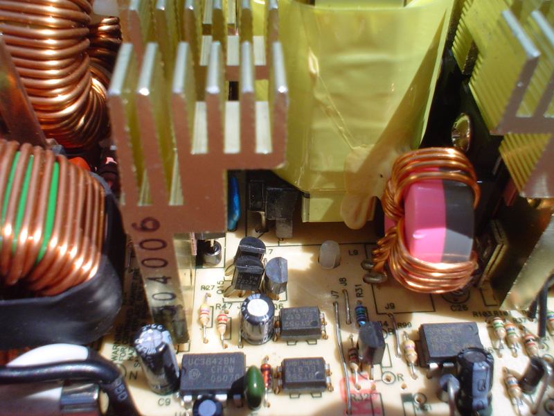

          I pulled mine out and had a look (didn't break the seal)
          From what I can tell (with mag glass sunlight eyestrain etc)

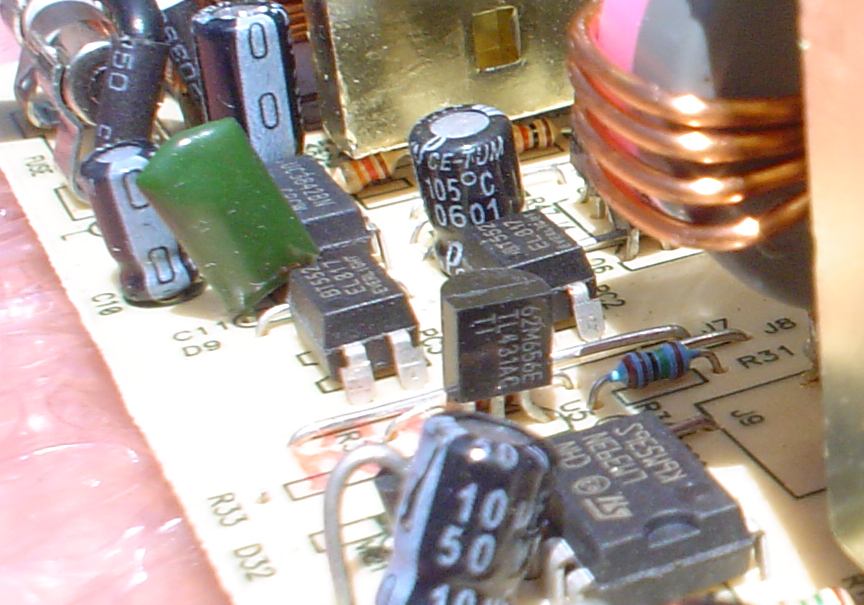

          The supposed bridge that I was talking about, It actually looks a little shorter but th pcb has very near it BRD1
          The number as best I can get off that semiconductor is its an ST component
          W12NK80Z which makes it a MOSFET
          from the search I did
          (really hard to tell NK on it)
          PDF here

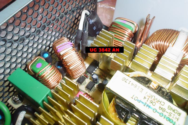

          Near this marked as U1 an UC3842BN with a couple of opto couplers near by EL 817
          (find pdfs on UC3842 here)
          (with that number and no expert here but I would have thought most designs would have been tried and trued by now?)
          The vertical PCB on the mains side of things I just cant see so no idea what chips are on that. (think this is A-PFC controller pcb?)
          There is on the secondary side an IC numbered J05947A1F (PS223)
          "logo" square type box with a box (solid) diagonal inside but over lapse edge
          no idea what that one is
          Anyway with out stripping it down thats the best I can come up with on whats in the box.
          cheers

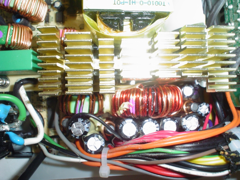

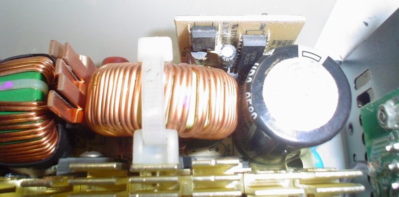

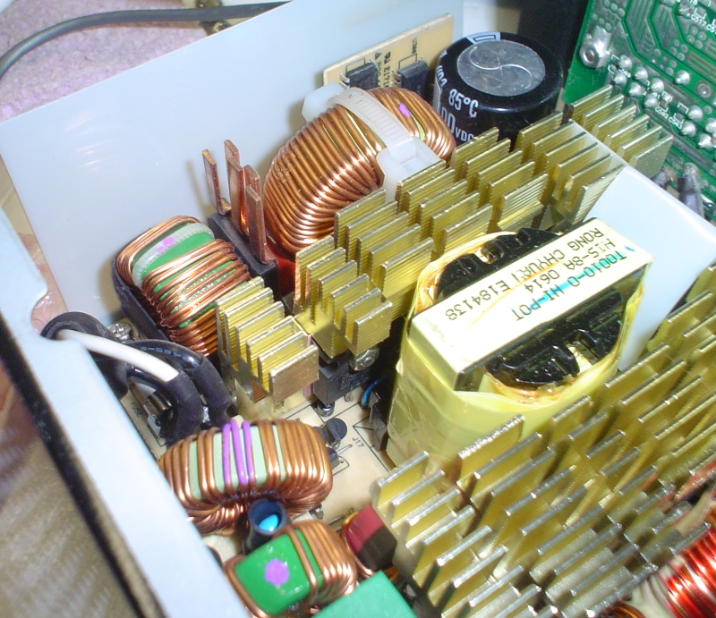

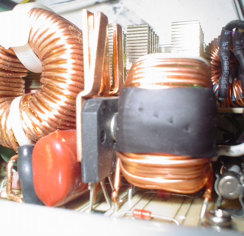

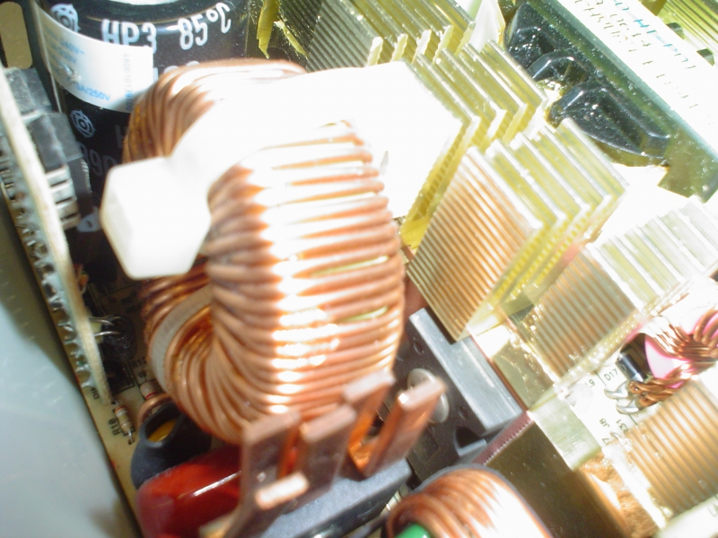

            #65
            Re: Enermax Liberty ELT620AWT
            ok got a feeling it was out of warranty anyway
            So I opened it up.
            Without doing an Oklahoma Wolf & madmat
            rip it apart with a soldering iron Trick...
            (nice pics of the Corsair TX750W Power Supply Thanks guys, U2 JG)
            They are pretty compact so its hard get all numbers of devices.

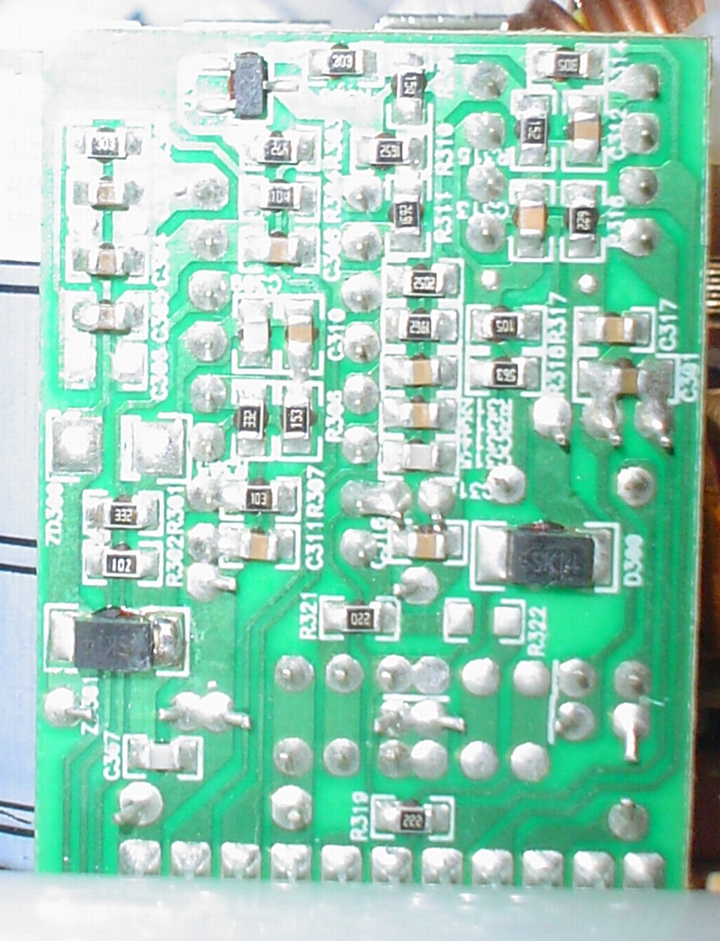

            it appears on the small mains side PCB (I am assuming A-PFC or part there of)
            The IC are as follows;
            LM393 Dual comparator
            http://www.national.com/mpf/LM/LM393.html
            http://focus.ti.com/docs/prod/folders/print/lm393.html
            UCC 3817 AN Power Factor Pre Regulator IC
            PDF HERE

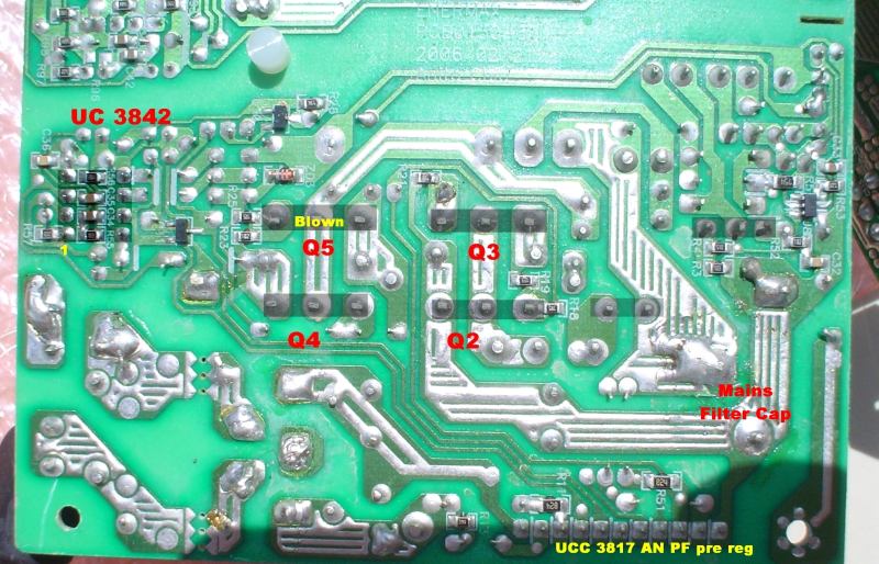

            There are 2 W12NK80Z Mosfets back to back on the Heatsink
            (opposite side of the blown one in plywood99's post)
            here is a photo of the device that went up in smoke on plywood99 unit
            some more photos
            (click on them to view, some are large files)
            so there's some info on the liberty, hope it help someone
            (will try and get some pics in sunlight)
            Cheers

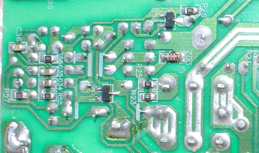

            • starfury1
              • May 2006
              • 1256
              #66

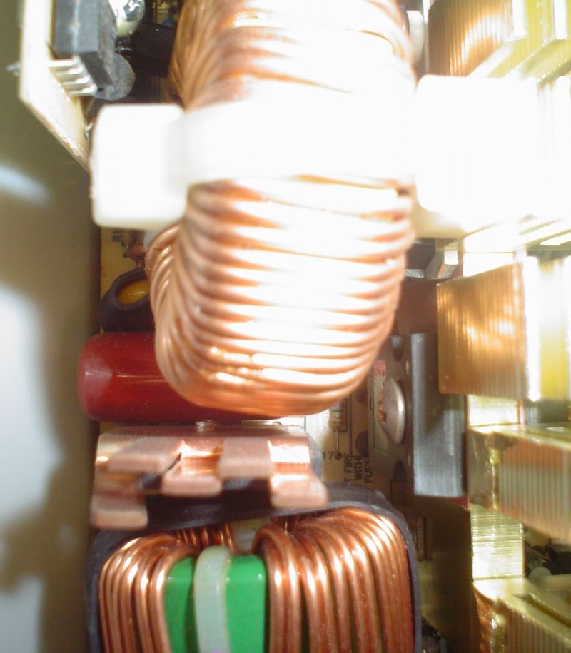

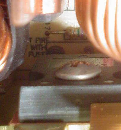

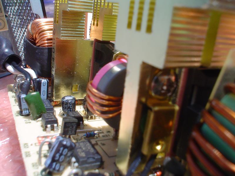

              some more photos
              You step into the Road, and if you don't keep your feet, there is no knowing where you may be swept off to." Bilbo Baggins ...

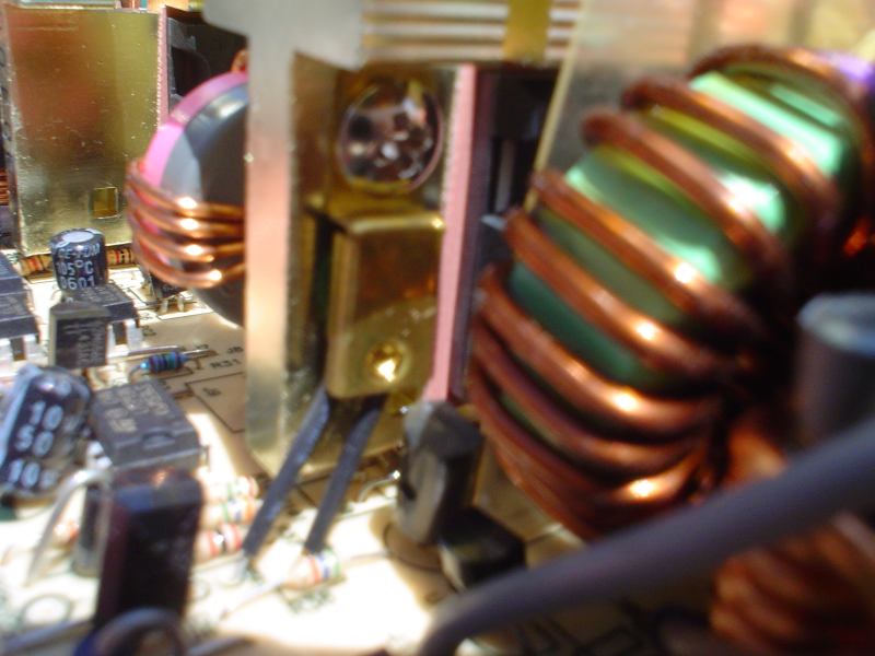

              • Super Nade
                • Jun 2006
                • 294
                #67
                Ferrite bead on the leg of the FET? Or is it a heat dissipation device? Never seen anything like that before!

                  I pulled the cTc caps out. Notice that the 3300uf 10v are the same size as the 3300uf 16v.
                  Replaced all except the 16v with Rubycons. Xicon for the 3300uf 16v. Don't know if that is a good brand or not. I may replace them if I get better quality caps for that size.
                  I did look in the Bios and compared voltage readings before and after cap replacement and readings are exactly the same. I'm typing this on the system that has this power supply.
                  I did notice the slight buzzing that has been talked about at boot. It starts out buzzing for about a half second and then its gone. It is not loud and I can't hear it if I'm 2 feet away from the power supply.
                  I put a temp probe that hooks up to the motherboard. It is touching a heatsink fin and reading 42c/107f. Not very hot.
                  Well hopefully this power supply will last. I'm not using the full capacity either which may be prolonging its life. Only 215 Watts reading on my Seasonic Power Angel. I'm afraid to use it when I upgrade the system knowing that my wattage usage will be higher.

                    #69
                    Well to me they look like Ferrite beads but not the guru here
                    (RF suppression? or maybe more some aspect along these lines here )
                    They look like they are fixed to the legs,
                    maybe they just come as part of the device...
                    don't know
                    The device is marked as Q5
                    (the one that did the July 4th impression)
                    Q4 is on the opposite side and is the same type
                    Q2 and Q3 (Q2,4 mains side Q3,5 inside.)
                    Just cant get the type numbers off Q3 or Q5
                    (3 devices in all on each side of the first heatsink from what I can tell)
                    Q2~Q5 have these on the outside legs.
                    photo of Q4
                    Just having a look at the infiniti photos (above review)
                    The mains side is similar but different
                    I think the A-PFC (Pre Reg) PCB is the same to look at
                    (not to say there isn't component changes)
                    There is defiantly changes when you start comparing the 2 units
                    from the photos
                    (wish I had an Infiniti to pull apart oh well)
                    Cheers

                              Anyway for those that might make a bit more sense out of it here are a few more photos
                              Cheers
