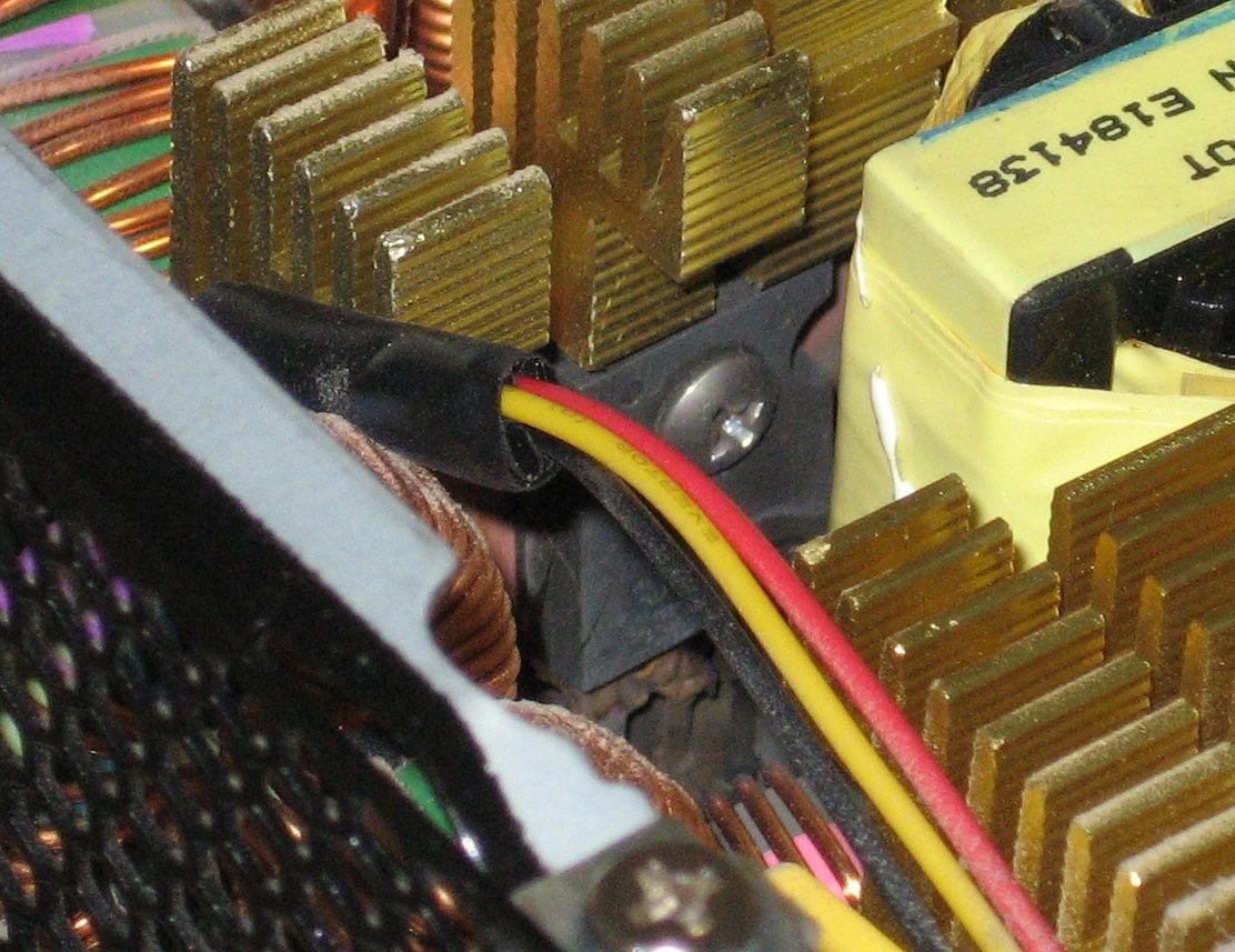

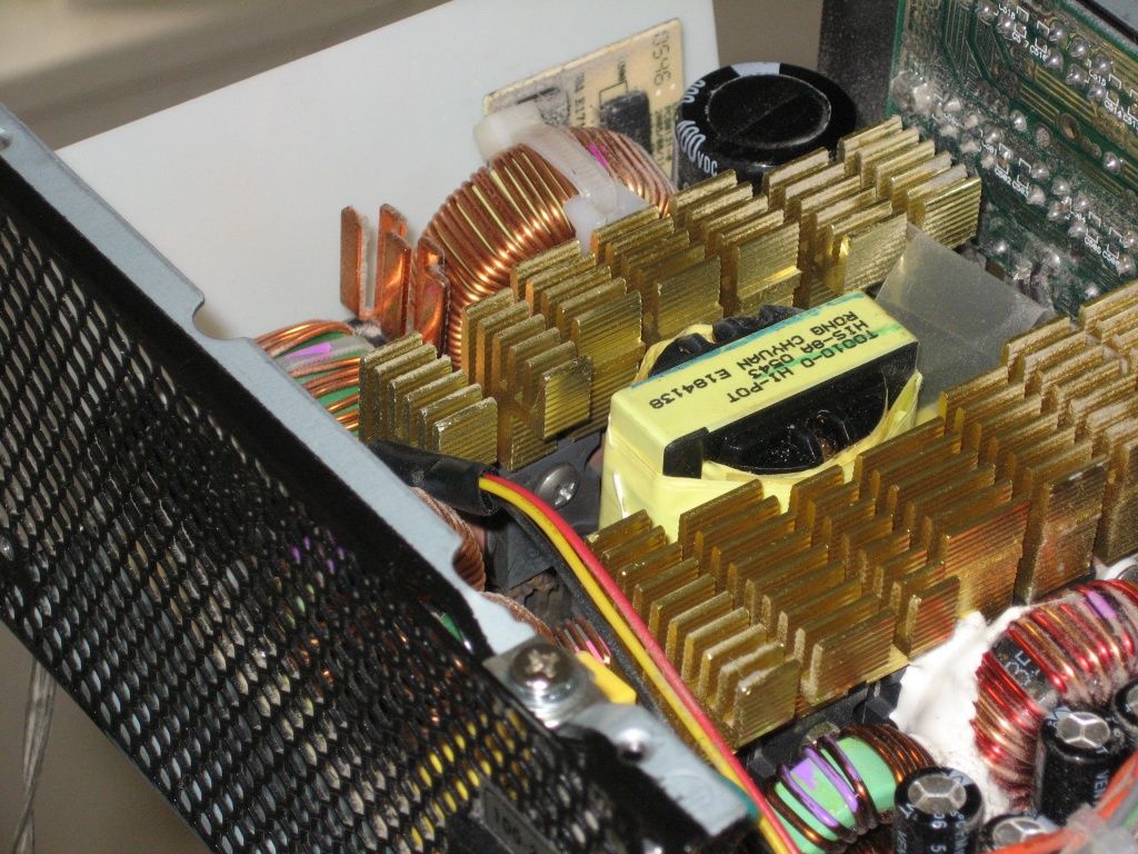

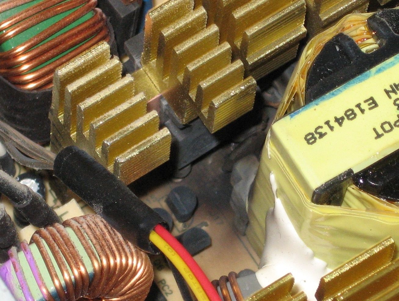

                    Here is a liberty 620W owned by plywood99 from over at Xtremesystems. It went BOOM as well. It wasn't the caps this time though (although they are the ctc crap, they hadn't failed yet), check it out. Rectifier blew up and went into a permanent short condition which in turn vaporized the fuse. At least the fuse did its job if nothing else.

                      Looks like poor cooling did it in. Looks very dusty.
                        There was some disagreement in one xtremesystems thread but it looks like that part was a mosfet, and from others accounts of a zapping sound when the unit is turned on, most likely due to insufficient inrush current limiting in an attempt to increase the unit's efficiency. It is not likely to be due to bad caps as one person had suggested even though that could possibly cause it. It would be quite cost effective to repair and then adding an NTC thermistor for current limiting if there really isn't any mechanism present.

                            Doesn't look like an abnormal amount of dust to me...

                              Me either, it actually looks very clean compared to most I've seen after they'd ran for a few months, and since we see a light coating of dust we know it wasn't cleaned off from a prior dustier state.

                                  if you have a look at this site HERE , at the photos on this page
                                  (its a review of the Enermax Liberty 620W 1st page
                                  From the basic layout I am incline to agree that its a well cooked mosfet in the photo. although I don't know this for sure
                                  If you look at the mains side second photo it looks like a standard bridge package with a Copper finned heat sink attached to it.
                                  You can just see it behind in the first photo posed by Sparky.
                                  for comparison here is the review of the Infiniti
                                  On this page for the infiniti you will see what appears to be the bridge with heatsink clearer.
                                  There is *some difference between the two but since there has been a few reports of the boom factor with the Liberties and none that I know of with the Infinities...what did they do right with it and wrong with the Liberty?
                                  (*how large or small this difference is I have no idea, or with the supply design in general...since I'll never see the schematics for both thats probably the way it will remain to me)

                                    I doubt it was from the switch on since Plywood99 was using his PC at the time it blew. He said (and I quote)
                                    Originally posted by Plywood99 @ XS
                                    Was browsing the web when a bright flash, with a pop/crack sound came from the back of the psu.
                                    and also
                                    I noticed a electrical type smell yesterday, but thought it was coming from my laser printer since it puts out a similar smell when heating up. Then this morning I play Ep2 for a couple hours and all seems well. Later I'm just browsing when the shebang happens.
                                    At least the PSU kept the damage to itself.
