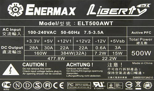

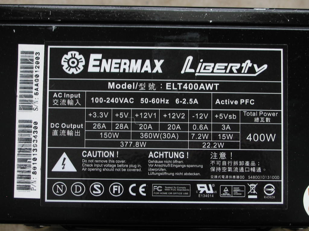

    First shown is the label below, so anyone reading can see what PSU we're dealing with here.
    ^ It's model ELT400AWT. Given the strong 3.3V and 5V rail ratings, this is also a fairly out-of-date product… but still viable for a low-mid power modern PC.

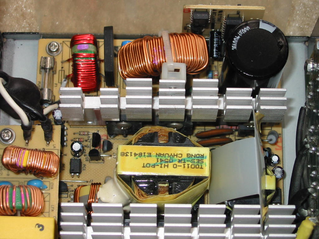

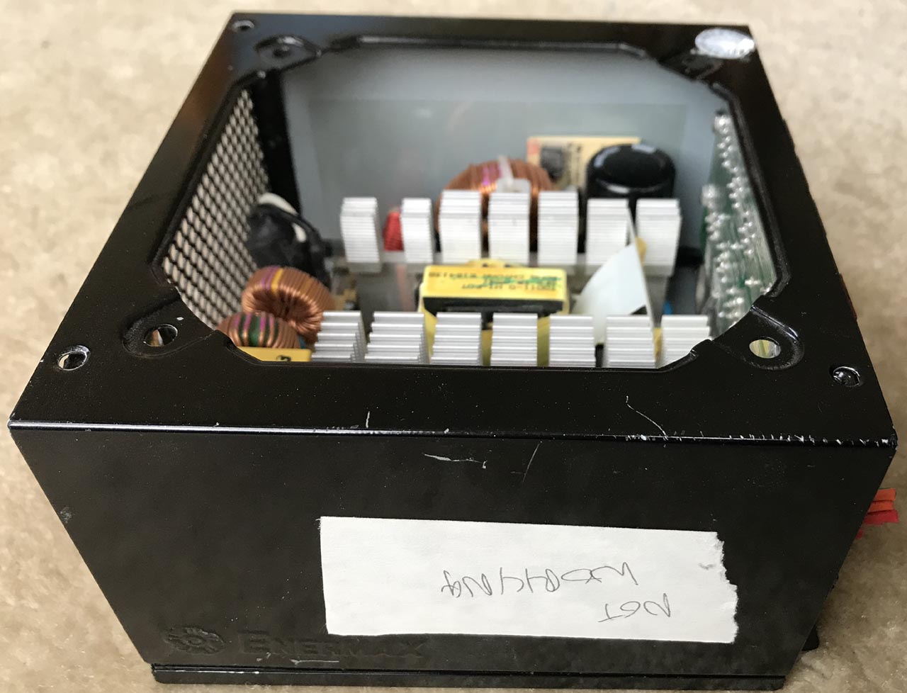

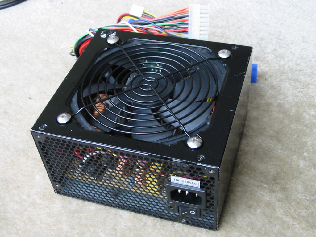

    Now the label looks nice and pretty above. But the rest of the PSU did not when I got it. To give you an idea, here are some “before” pictures of what the PSU looked like when I got it (minus the few dust balls I removed - don't like to store dusty hardware):

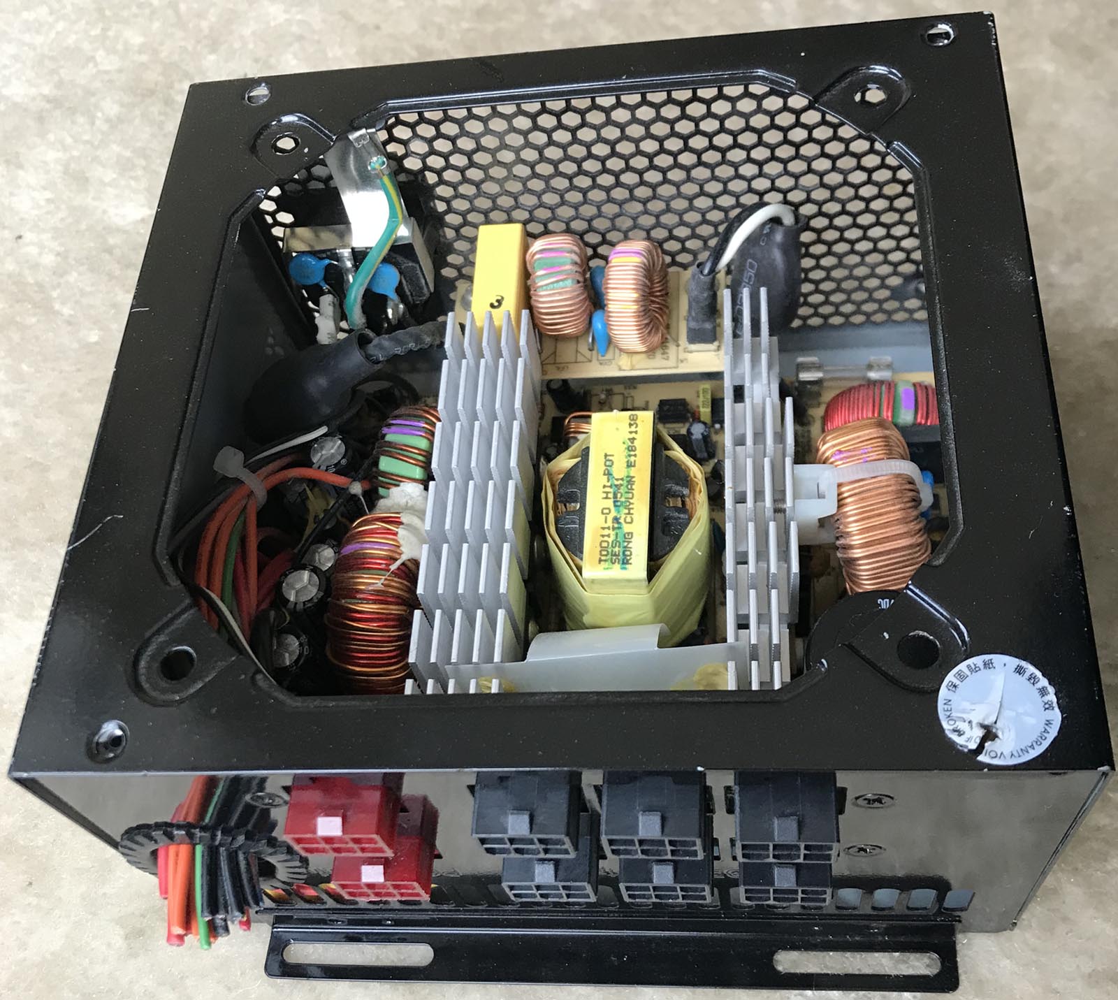

    As you can see, the fan's missing, output wires are cut, and someone put a “Not Working” label on the case. Clearly it was destined for the scrap heap… which would have been a shame, as Enermax PSUs are designed fairly well. The bad caps aside, I'm pretty sure this PSU can do the power ratings on its label.
    And speaking of which, let's see the rest of the PSU built quality (though I will skip doing a thorough breakdown here like I normally do.)
    https://www.badcaps.net/forum/attach...1&d=1613372320

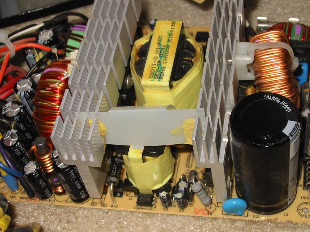

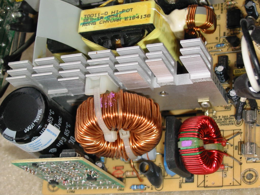

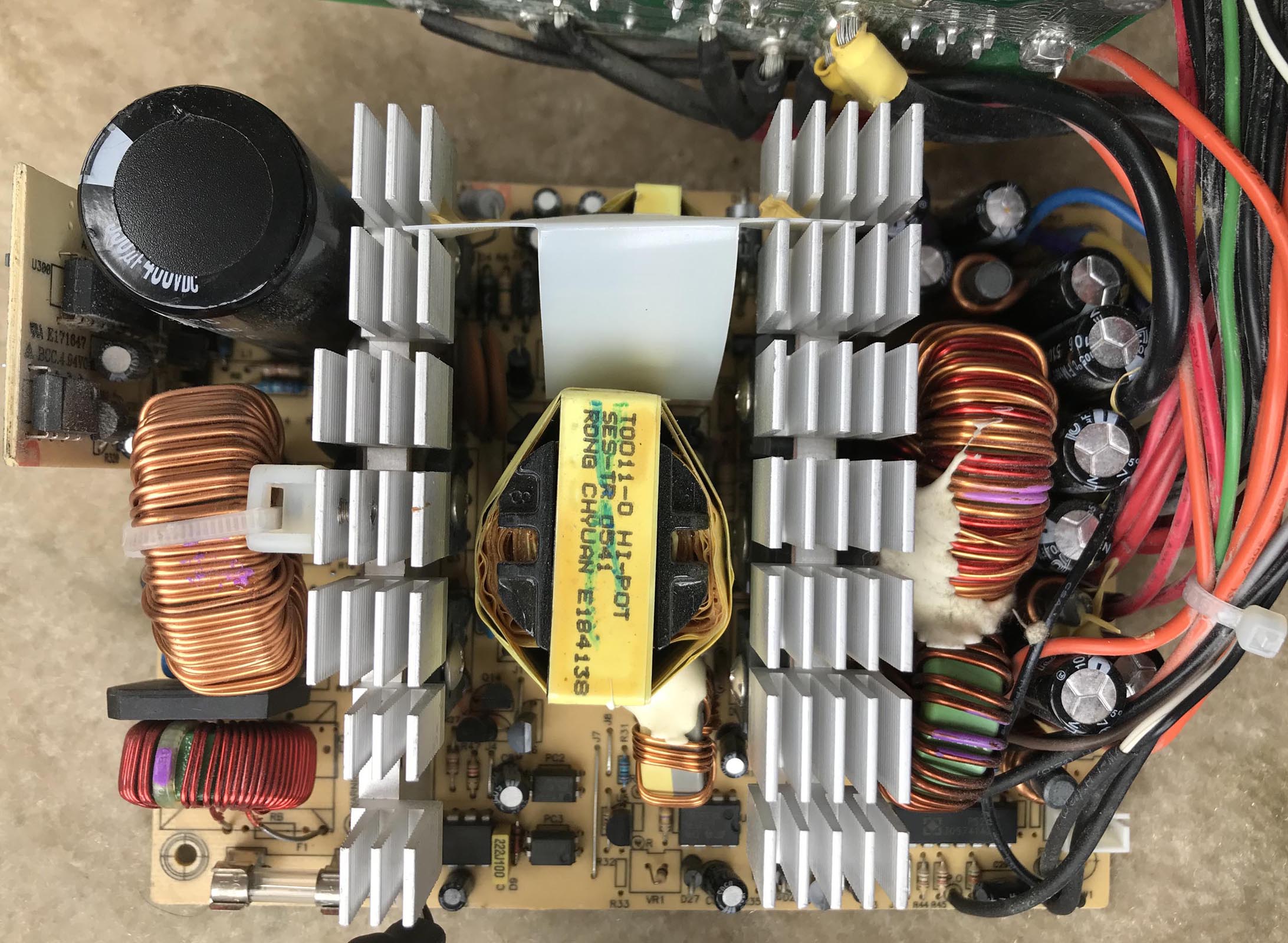

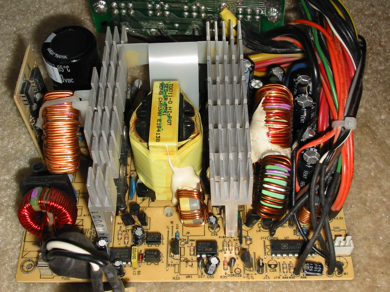

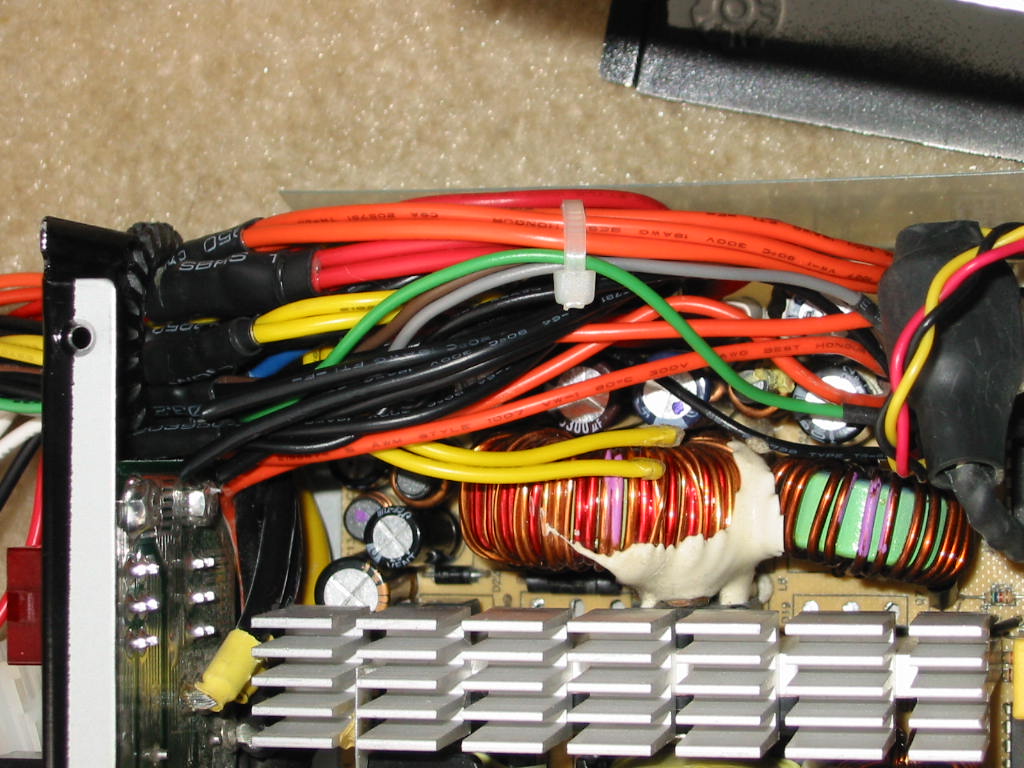

    ^ Crap caps aside (and cut wires), there isn't that much to complain about here. It's an older group-regulated design with a mag-amp 3.3V rail. If I remember correctly, the 3.3V rail rectifier looked like a 40 Amp –rated part. Same goes for the 12V rail, which was coupled to the rectified DC side of the 5V rail (i.e. 12V rail is a super-imposed 7V rail on top of the rectified 5V rail for better cross-regulation.) And speaking of the 5V rail, I think that one had two 40-Amp rectifiers. So all in all, it's a 5V-heavy PSU also capable of heavy 12V loads (probably depending on transformer output turns ratios and coupled inductor windings.)
    Primary side has APFC with a 400V, 330 uF Hitachi HP cap - good, but not great, given that it's only rated for 400V and 85°C. At least it really is a Japanese brand, like the PSU's product page states. APFC controller is an UCC3817 located on the small daughterboard by the primary cap, along with a LM393 comparator. Meanwhile, the PWM controller is a UC3842bn (actually visible in one of the pictures above.) And the 5VSB also has its own PWM IC, mounted on the solder-side (it's a small 6-pin SMD - SOT-23-6, if I'm not mistaken), but I forgot to look up its numbers.

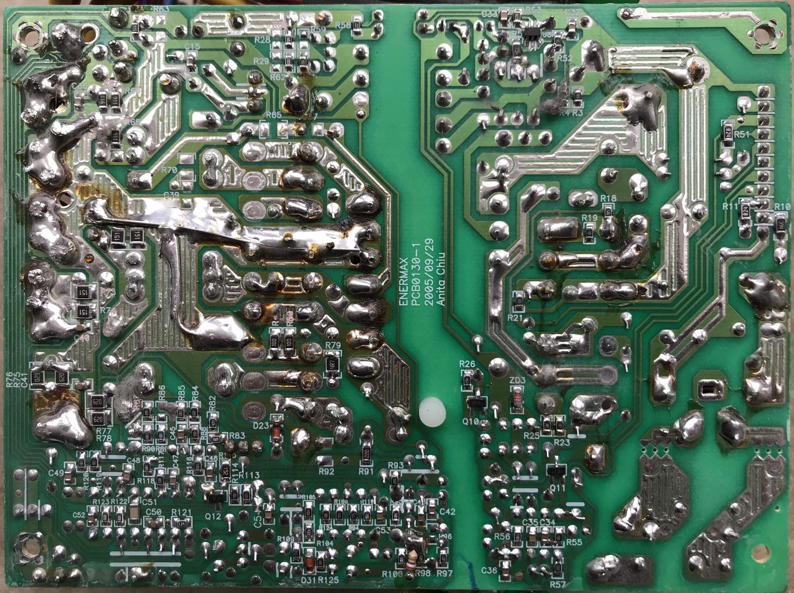

    Speaking of the solder side, here's a high-resolution picture of that:
    PCB is marked:
    "ENERMAX
    PCB0130-1
    2005/09/29
    Anita Chiu
    Wow! For a 2005 design, this was actually quite good! Back then, PCI-E and SLI were still a new thing, so even some of the most “decked out” SLI PCs would have been satisfied with the power offered by this PSU.
    Back to PSU discussion… this is one thing I never really liked too much about Enermax PSUs – somewhat messy soldering. In particular, here's one thing that really caught my eye while working on this PSU:

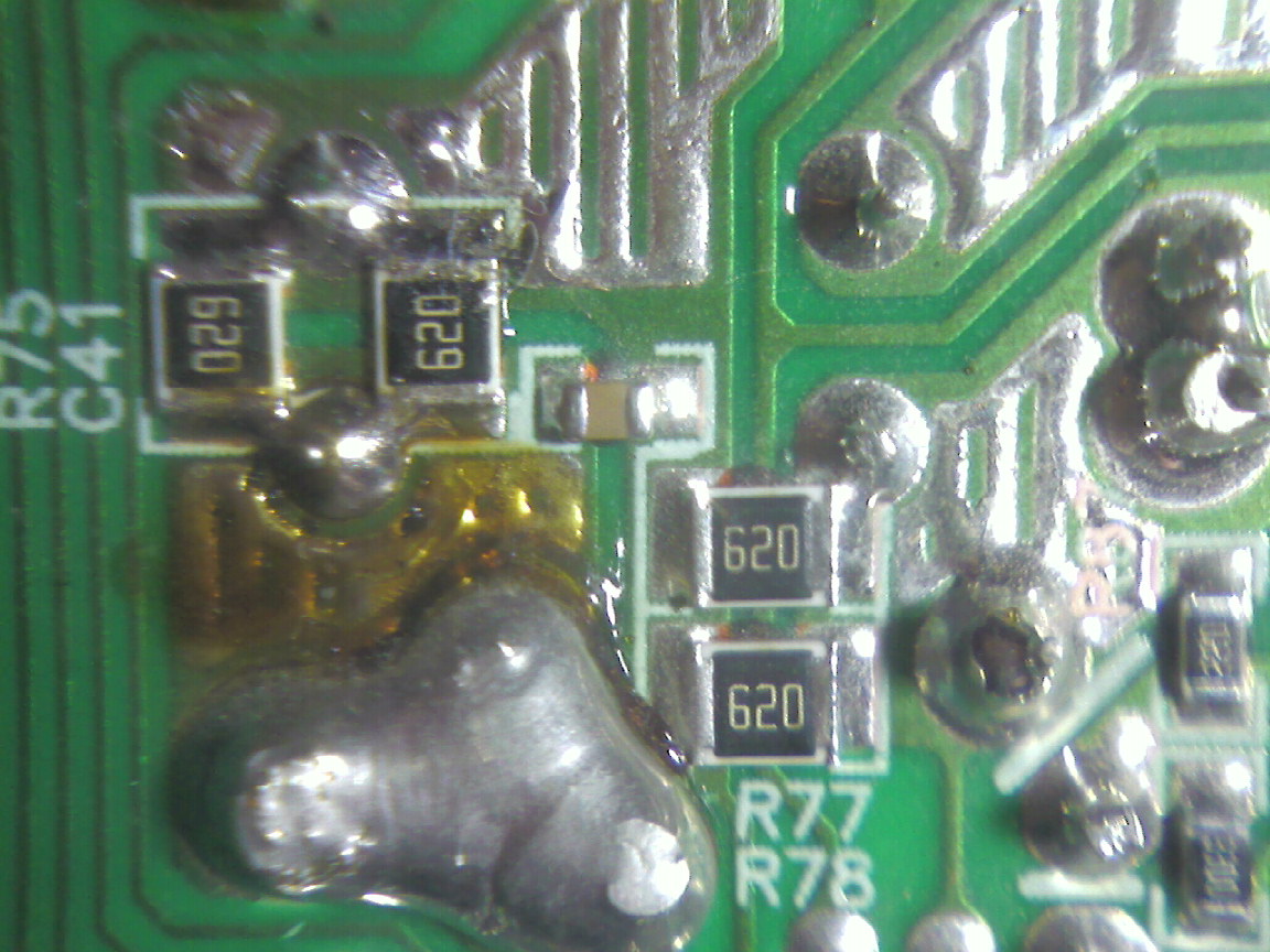

    See those 62-Ohm SMD resistors? Those are the dummy-load resistors for the 3.3V rail. And that big blob of solder on the lower-left is nearly shorting the 3.3V rail to ground. It was literally just a flux crust separating the two from shorting out!
    Apart from the excess solder on some joints, the PCB soldering is acceptable.

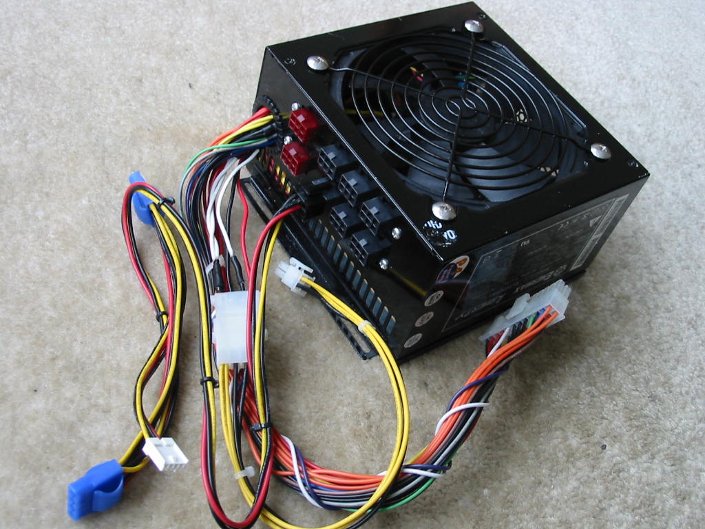

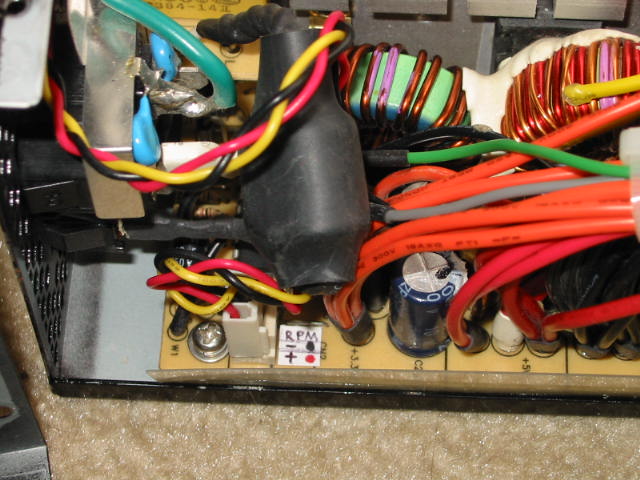

    On that matter, it’s the cut output wires that had me waiting on fixing this unit for so long. In the end, I just took the 24-pin wire harness from a dead/parts Raidmax RX-380K (Sun Pro KY-480ATX). Its wire harness was a joke with ultra-thin 20-AWG wires… but at least they are real copper. Meanwhile, since I had already used the crappy 4-pin 12V CPU connector from that Raidmax on another PSU, I had to come up with something different for the 4-pin 12V CPU connector on this Enermax PSU. Looking through my stash of cables and connectors, I found a really nicely-built female Molex--> male 4-pin 12V CPU adapter with thick 18 AWG wires and sturdy connector pins. But instead of breaking that down and connecting it directly to the cut PSU wires, I soldered a male Molex connector to the PSU with double 18 AWG wires going to the 12V side. In the end, it wasn’t as pretty or well-built as the original design, but it should work. Also, soldering the ATX wire harness to the existing cut wires on the PSU (instead of removing the cut wires) was a good thing, because it made the crappy ATX wire harness from the Raidmax PSU a bit longer. The wires will still likely be too short to use the PSU in a case with a bottom-mounted PSU, but should be OK in a regular older case.
    As a side note, I want to mention that this is one of those instances where my “solder pot” contraption really came in handy. Tinning all those wires in the wire harness one by one with a soldering iron (as well as the cut ones on the PSU) is a slow, painful task - especially trying to do multiple strands twisted into one (due to large thickness and thermal mass.) Basically, the Enermax PSU wires are all 18 AWG and either steel or tin-coated copper, making it difficult to tin with solder and a regular soldering iron. But with the solder pot above, it all became super easy and quick. All I had to do was just put a very tiny bit of flux and dip each strand (or bunch) in the hot solder, count to exactly 2.5 (lol, not really ) and pull out the wire(s) with perfect tinning. No excess solder blobs or partially-tinned wire. Perfect results every time!
    Advertising of my solder pot aside… the last part left was the fan. The ELT400AWL uses a 120 mm fan, which was missing from my unit when I got it. Luckily, my former job was getting rid of a bunch of scrap wires and electronics one day. And from that, I got 3x Yate Loon 120 mm sleeve bearing fans. They were all used and dusty. Two were even starting to grind badly. I took the worst one, cleaned and oiled its bearing properly, and assembled it back together – it was whisper quiet now. These Yate Loon fans also came with both a standard 3-pin fan header and a 4-pin Molex. Of course, since I wanted to utilize the fan controller inside the PSU, I removed the original connector on the PCB inside the PSU and soldered a standard 3-pin fan connector.
    ^ And here you can see that connector soldered to the board and the fan plugged in it. Note that I also put a small label in there to indicate where the (+) and (-) wires go. On a standard 3-pin PC fan, middle red pin is usually positive (+) and the black outer pin is negative (-). But here, I had to have them reversed… which I did on the fan’s connector. While at it, I also removed the Molex connector on the fan, as this just wasn’t going to be needed here.
    Finally, it was time to assemble the unit back together. I ran to the garage and looked through another box of computer stuff that I had picked up a while back from Craigslist, which contained mostly fan guards, ATX extensions cables, some large 200 mm fans, and a bunch of other cables and goodies. In this box, I found a nice 120 mm black fan guard. And for fan screws, I couldn’t find anything big enough to fit the YL fan holes. However, looking through my box of salvaged bolts (many of these came from the floor of a repair shop I used to work at, since no one bothered to ever clean the floors there), I found 4 S.S. bolts with round heads that fit the fan holes perfectly. And lastly, for the PSU top cover - it too was missing its original screws. So what I did is I took the counter-sunk M3-threaded screws from the modular board and used those on the top cover. Meanwhile, since the modular board doesn’t really care about nicely counter-sunk screws, I just used 4 spare M3 screws from my junk box to hold it in place. After all of that hacking and piecing together with random scrap parts I had acquired over the years, this was the result:
    ^ It’s far from complete, but at least it’s functional now. Unfortunately, none of the modular wires were included with the PSU either (and on that note, this is exactly why I hate modular PSUs - people always loose/toss/misplace their modular cables… not to mention modular cables contribute to voltage drop from the extra connectors they have. ) But as my luck would have it again, I dug through yet another box of computer junk that someone on CL gave me after buying a PC case from him… and that box had 3x modular cables with plugs that fit the above Enermax (that is, the one with the 2 blue Molex connectors shown above.) Of course the pin configuration at the connector end was completely wrong, but nothing that a few minutes of extracting pins and placing them in the right slots couldn’t fix. On that note, always check your modular cables when buying used modular PSUs. Some people may be unaware and may include whatever modular cables they find. But different PSU manufacturers sometimes use the same connector, but with different pin configuration. So you could end up putting 5V into a 12V rail, or worse - the opposite! (Or even worse yet, 5/12V into ground and ground into 5V/12V.) So always check this before you power your system.
    Anyways, that’s all I have for this PSU so far. It will need a revision of the recap at some point in the future. But for now, it should be OK to use as yet another test PSU. Moreover, I don’t like the loud high-pitched “electrical arcing” noise it makes when the APFC comes up from stand-by. Given the discussion in this thread, the APFC may not have the best design in these PSUs. So I’m going to use it with caution for now, especially given its age. And due to the lack of PCI-E power connectors currently, it at least won’t see any high loads from powerful GPUs. Though that’s another item I have to sort with this PSU. Anyone has recommendation for cheap modular 6-pin PCI-E cables (or has a few spares?)

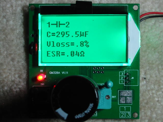

        Nice writeup, I would measure the main bulk capacitor, just to make sure the noise is not from it being failed.
          Yeah, I was intending to do that at last *before* installing the PSU in its case... and I forgot.
          Although the input wires are not soldered and easy to remove, the output wires are a pain - they barely fit through the opening in the case. So once I had it closed, I didn't feel like taking it apart again. There is a possibility that the primary cap could be degraded / starting to fail, but I was like, YOLO at this point.
          It shouldn't be too much of an issue, though, because I still don't have any SATA or PCI-E power connectors, so I can't put this PSU in a power-hungry PC. Thus more than likely, I probably won't use it much (if at all.) Need to get more caps too... but I'm waiting on a few more broken PSUs to show up from eBay to see if I'll need to order anything else. Gotta keep busy with fixing junk, you know.
          On that note, one of them should be a fairly-decent Rosewill Valens 600 unit with 80Plus Bronze or similar. Curious what problem I'll find in that one. The other one is an old-ass Hyper Type-R PSU... because it reminded me too much of FNF, Honda Civics, and V-tech just kicked in, yo!

              okay... not to nitpick, but from the label of the psu posted, this is NOT the liberty eco. the liberty eco is 80 plus standard certified from the label but this one is not. the power ratings are also different. the real liberty eco has less power and current on the minor rails but slightly more power and current on the 12v rail. also, the proper part number for the eco version is ELT400AWT-ECO. this one is just ELT400AWT, so its just the liberty standard non-eco.
              just thought i'd mention that in case newbies on the forum look up repairs for the wrong power supply and it causes issues or explosions!
                master hoarder
                • May 2008
                • 12175
                • Bulgaria
                Re: Enermax Liberty ECO 400W [ELT400AWT] - from scraped to serviced
                Good catch!
                I guess too late editing the tittle now.
                However, I do wonder how much more different the "ECO" version might actualy be (if at all) inside from this non-ECO one, then. I don't think the 80Plus certification matters too much, simply because that was started around 2004 but still wasn't a popular standard with many PSU manufacturers. In fact, according to Wikipedia 80Plus page, Seasonic was the first PSU in Feb. of 2005 to use the 80Plus cert. So perhaps this non-ECO version is too old and Enermax just didn't bother to use it back then.
                As for the slightly different current... I don't think that matters too much either. For example, if you look at the label of the 500 Watt version you posted and the 400W I have, the combined current difference on the 12V rail is just a mere 2 Amps. Same with the 5V and 3.3V rails. So that tells me all of these units have a fairly similar configuration for the rectifiers on the secondary side, and perhaps just the primary uses better (or worse) parts, dictating the maximum power the PSU can provide. Thus, the output caps could still use the same configuration for all we know. I guess it would be nice if someone had the ECO version and could post pictures here so we can compare.

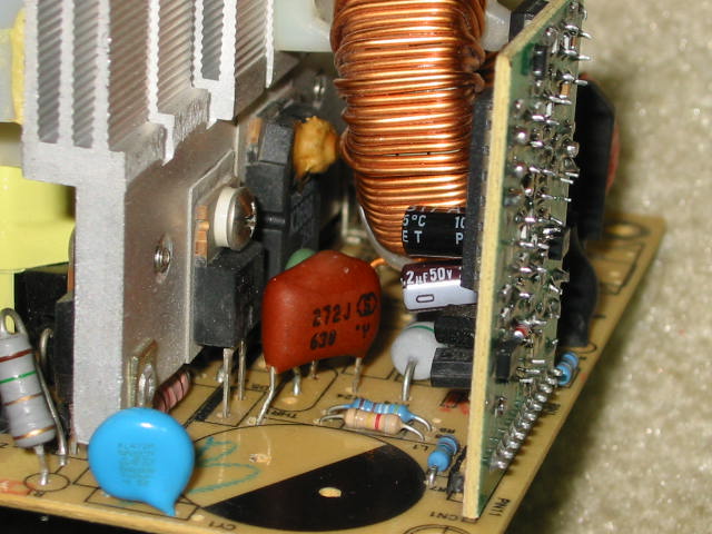

                    Enermax Liberty ECO 400W [ELT400AWT] – primary cap check and mods
                    Since people here (and I myself) were curious about the condition of the primary cap, given the “strange” noise the PSU makes when it initially powers up, I decided to pull it apart and check that Hitachi HP3 400V 330 uF primary cap. Besides, I hadn’t touched the soldering iron today, so I needed my daily dose of “the fumes”.
                    Anyways, here’s what the GM328 meter showed:
                    What do you know! – It’s actually still in spec. Capacitance is a bit lower at 295-ish uF, but that’s still within 10-11% of the spec value. So looks like all is well.

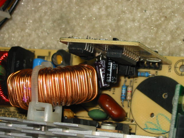

                    Of course, since I had the PSU open anyways, I figured this would be a good time to install another mod in there as a test: an extra film or ceramic cap in parallel with the primary input electrolytic cap. A while back, I bought a bunch of 2.2 uF 450V polypropylene metal film capacitors. One was for a replacement of the snubber electrolytic cap in a LiteOn ATX PSU. But the others I got with the intent to install in parallel with the primary caps of various PSUs with APFC circuits. The idea is, at least in my head (haven’t done any sort of research, testing, or measuring to prove this) that the extra ceramic or film cap can take on some of the high-frequency ripple current, thus make things a little less stressful for the primary electrolytic cap (similar to how PC motherboards often have ceramic, tantalum, or other low-ESR and high-ripple current caps in the CPU VRM circuit.)
                    Unfortunately due to limited space on the primary side of the Enermax ELT400AWT, I was not able to fit one of these 2.2 uF caps in there. However, I still wanted to add something in parallel with the primary cap just as a backup, in case it went open-circuit. That way, the APFC coil should still technically have a place to dump its energy and I’m hoping this perhaps could save other APFC components from going into orbit. But who knows.
                    In any case, I have a ton of various salvaged junk boards lying around, so I looked for the highest capacity cap I could find that would fit and meet the voltage requirements of the circuit. The scavenged part came from a Sony CRT TV board: a 2.7 nF 630V 5% film cap of some sort. Now let’s see how I fit it…
                    Basically, I found just enough space between the primary filter cap and APFC coil to squeeze it in there. The PCB already conveniently had a hole on the negative bus trace for a current sense resistor that wasn’t installed on this version of the PSU. But for the positive bus trace, I had to drill my own hole… which I did right in front of the APFC rectifying diode (which actually is a MOSFET with Gate pin soldered to the Source pin and the MOSFET just used as a diode - I guess this is cheaper than using an actual diode? ) After all of this and giving the NTC thermistor a slight push towards the primary heatsink / APFC MOSFET, I was able to fit everything in there and install the primary cap again.
                    So, did this cure the “weird” noise I was hearing with the APFC?
                    Answer: I haven’t tested the PSU yet. It got late and I needed to clean my bench area for tomorrow. As such, this one is… to be continued. However, I doubt this cap alone would change anything. I suspect it’s probably more to sooth my mind than anything else. But perhaps time will tell. I’ll post back when I get a chance to test the PSU again.

                        Re: Enermax Liberty ECO 400W [ELT400AWT] – primary cap check and mods
                        Originally posted by momaka
                        2.2 uF 450V polypropylene metal film capacitor. a 2.7 nF 630V 5% film cap. I still wanted to add something in parallel with the primary cap just as a backup, in case it went open-circuit. That way, the APFC coil should still technically have a place to dump its energy and I’m hoping this perhaps could save other APFC components from going into orbit. But who knows.
                        im still quite sceptical of that backup primary cap actually working and preventing a blowout of the apfc section if things go wrong. 2.2uF is 2200nF and 2200nF vs 2.7nF is quite a big difference. im not sure if 2.7nF is enough capacitance to hold the excess energy from the apfc coil to prevent a blowout especially when we're talking about high apfc boost voltages of 390V or more. not sure what the math formula is to calculate how much electrical energy in joules a capacitor can hold based on its capacitance and working voltage but i think it helps to do your math on paper in theory beforehand...
                        lol! i have a lot to say about the double meaning of that but i shall save the dirty talk and jokes for the vip room... hahaha!
                        which I did right in front of the APFC rectifying diode (which actually is a MOSFET with Gate pin soldered to the Source pin and the MOSFET just used as a diode - I guess this is cheaper than using an actual diode?)
                        yeah who knows? maybe they were cheapskates or it could be that it was done that way because its a trademarked, patented and trade secret design that serves some secret purpose only the designers know of that we ordinary folk arent aware of? hahaha!
                        anyway, my hypothesis here is that they used that particular mosfet that way because it has better power efficiency than using a regular diode (lower forward voltage drop perhaps?) but im a nub when it comes to apfc and diodes so i could be wrong... so dont quote me on that...
                          Well, this Enermax Pro 82+ 525W has both its primary caps go open, and the only thing left to absorb energy on the primary was a 0.1 uF ceramic cap (i.e. 100 nF). Nothing blew, aside from the NTC going high-resistance. Granted 2.7 nF is almost 33 times lower capacitance than that, but I still think it might help vs. having nothing in there, in which case the voltage from the APFC coil can really go sky-high until it finds a path to go through. So even a little bit of capacitance can make a lot of difference vs. none at all. Indeed, of course, the 2.2 uF cap would have been better. But I might just order a 1 uF cap on the next cap order I do and swap that in there. That's still 10 times more capacitance than the ceramic cap in the Pro 82+ 525W.
                          Now, how much energy the APFC coil holds per a single pulse... that depends on its inductance and average current. I forgot what the formula is here and too lazy to go back through my analog power circuits books. We did briefly touch on boost and buck converters at one point, though, and I remember it wasn't too complicated. But it's not something I've had to use too often, so it expired from my brain.
                          E = 0.5 * C * (V^2)
                          - where C is in Farads and V is in volts.
                          So for a 330 uF cap charged to 390V...
                          E = 0.5 * (330 * 10^-6) * (390^2) = 29.0965 Joules of energy
                          2.2 uF...
                          E = 0.16731 Joules, or less than 0.6% of the energy in the primary cap
                          That means the 2.7 nF cap with its capacitance being roughly 1000 times smaller than the 2.2 uF, it can hold only roughly 0.0006% of the energy of the big cap. However, if we assume the primary cap goes open and let the voltage jump all the way up to 550V (very high, but still not high enough to break down any other MOSFETs or transistors on the primary side), then that figure changes to 0.0014%. That's still very small... but again, better than a complete open circuit. So this might buy just enough time for the APFC controller to see the OV condition and stop boosting the APFC... I'm hoping!
                          Yeah, I need to do more calculations, but I'm lazy ATM. So instead, I turn to experiments similar to Garage54, except with electronics rather than cars (read: Ladas ).
                          Well, I'm not quoting you to "quote you", but rather to reply.
                          We could figure it out if we find the datasheet of that MOSFET and see how much it costs at a retailer vs. an FR HV diode and then also compared their voltage drops... but that's just too much work. So I will assume the truth is somewhere in between: that is, the MOSFET is cheaper and also provides "adequate" performance when it comes to Vf vs. something more expensive/exotic.
                          so thanks for posting this analysis and study of this psu anyway, even though i am already aware of all of this...
                          You're welcome!
                          so when properly recapped with 10k hour japcaps, the enermax liberty should be able to hold its own against all the modern 10 year warranty, 80 plus gold psus currently out there and maybe even outlive some of them with the new 10k hour japcaps u put in.
                          Maybe.
                          I'm still putting my money on the APFC cap blowing before anything else. So 10k-hour Japanese caps or not, I don't think this PSU will ever be as reliable as a non-APFC PSU. On that note, I did buy something very "interesting" last month. Pictures to come probably a little later this month in the PSU build thread (or wherever.) All I'm going to reveal about it is that it has a pink-ish paint job from the factory!
