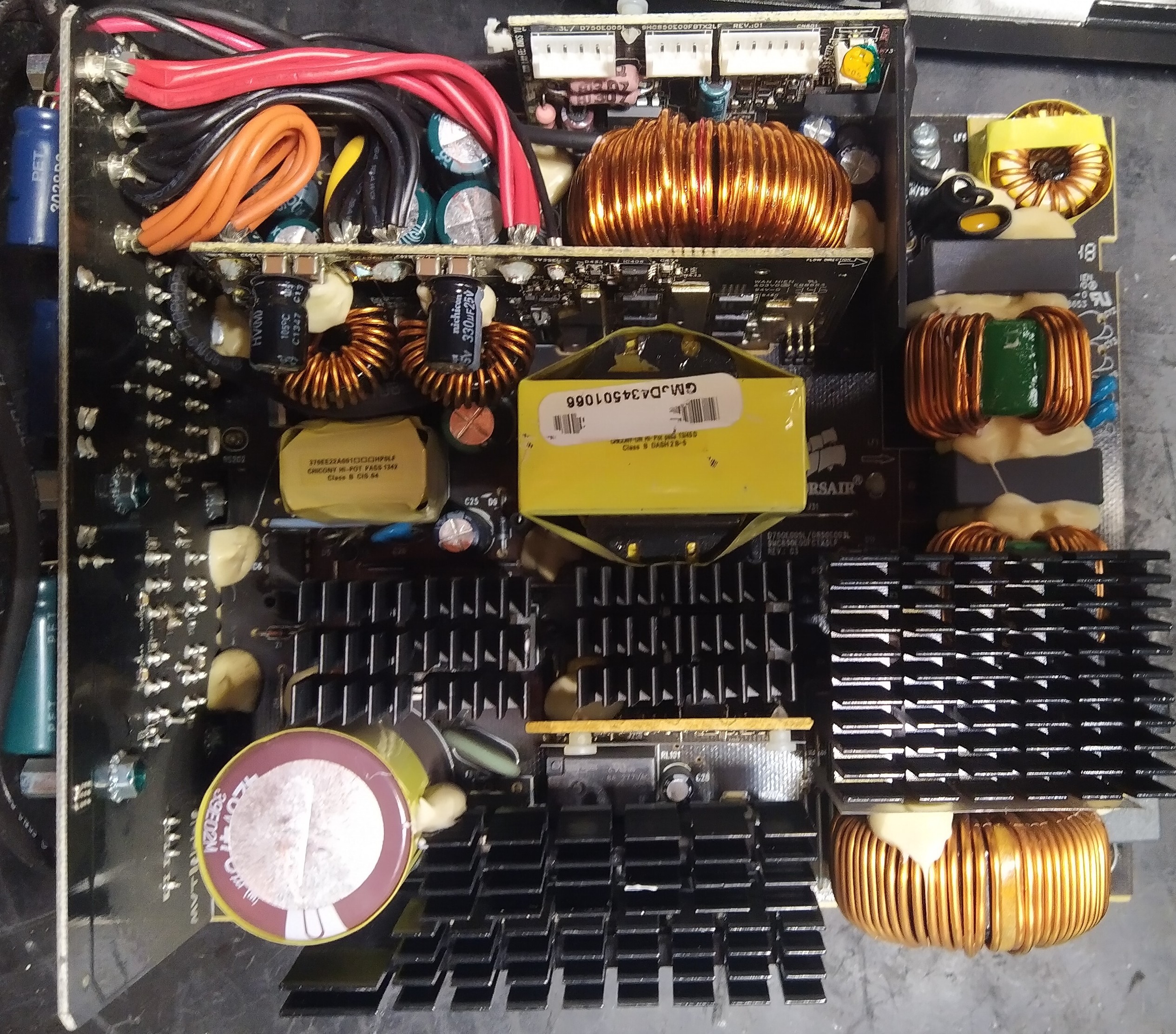

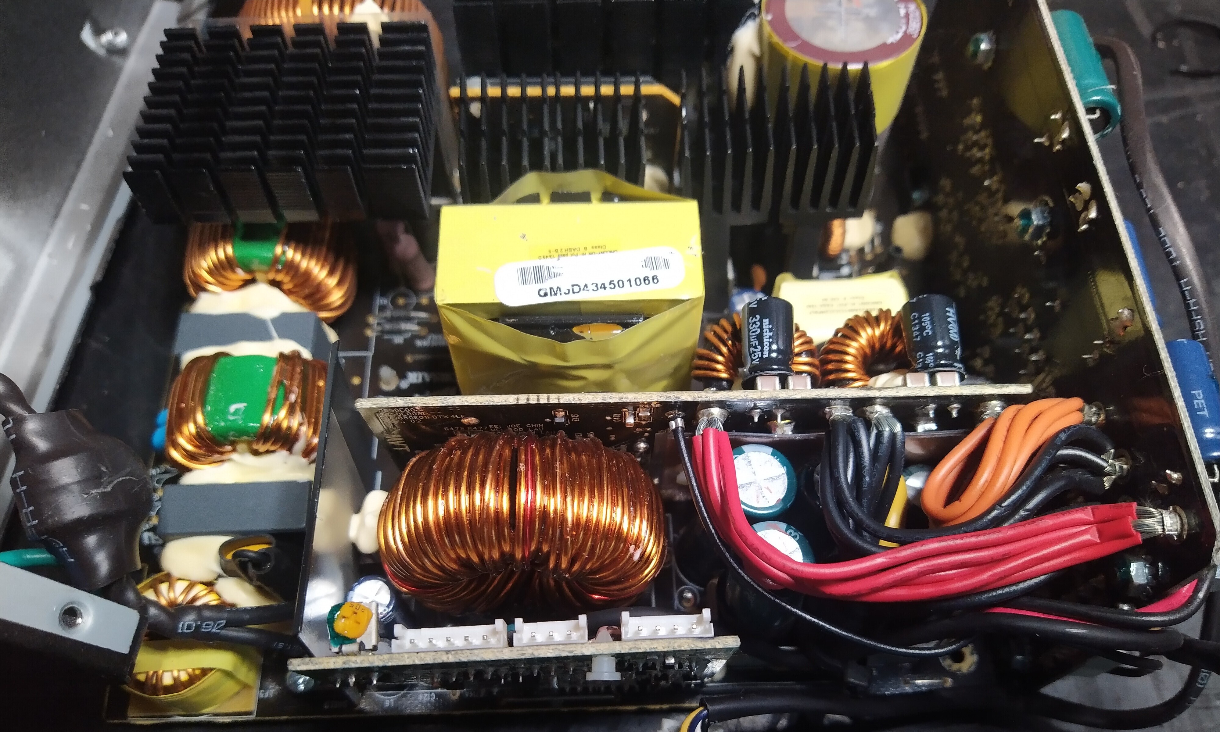

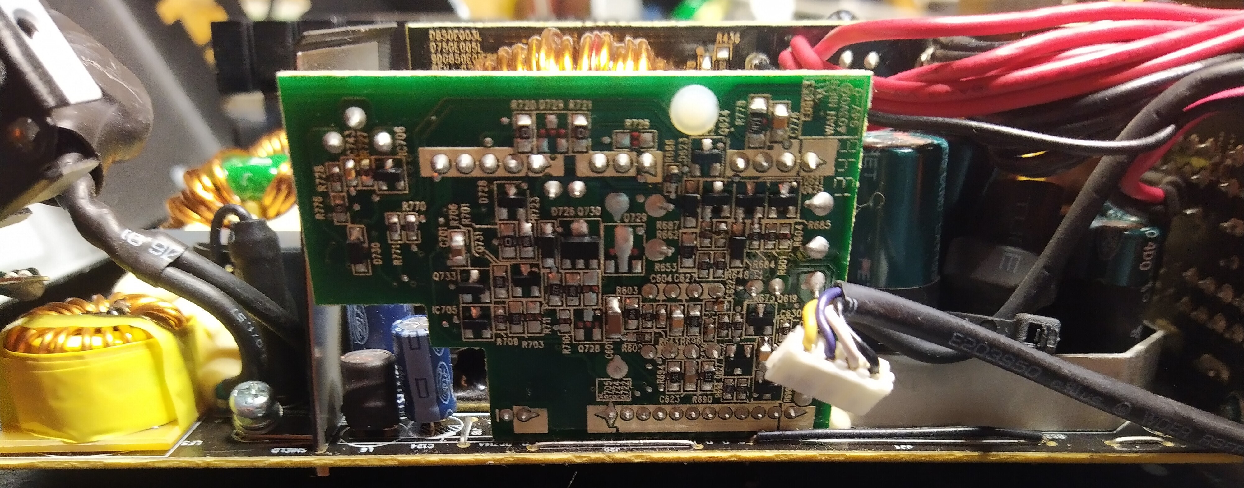

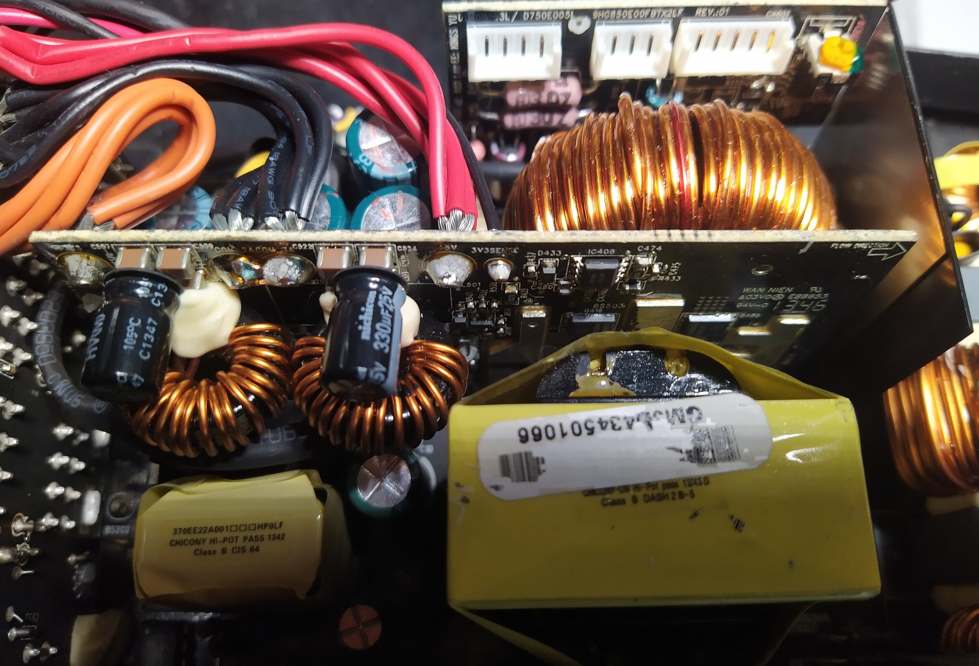

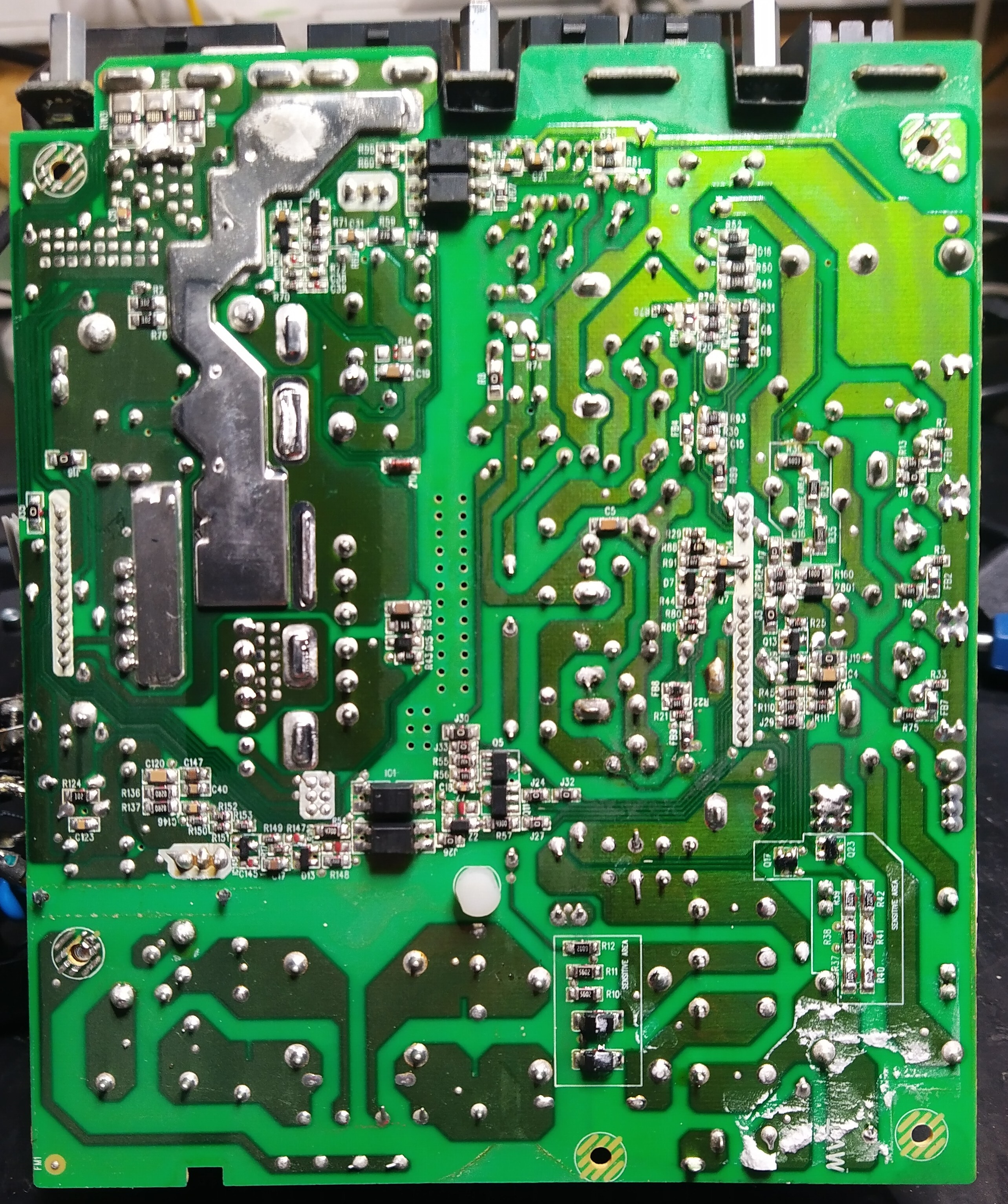

      Okay, I have done reverse engineering on the parts which were exposed and I couldn't find any big resistors which represented current shunts.
      Here are the pictures.
      Any ideas?

        Nobody is gonna belive this, but when I was going outside to take better pics of it, the corner of the PCB (near the primary MOSFETs) had shorted against the case and now I have 10ohms between positive DC and negative DC on the diode bridge rectifier in circuit, 31 ohms between Drain and Source on all of primary MOSFETs. There is also an burning smell inside.

                Order of solder wicks finally came and I found the culprit for the short on primary DC side.
                One of the primary MOSFETs went short. Luckily it was only one so the damage should be minimal, but just for sanity I'll need to replace all 3 60R190E6 MOSFETs.
                Now here's my question, what are the equivalents to 60R190E6​ inifeon MOSFETs? I can't find any online.
