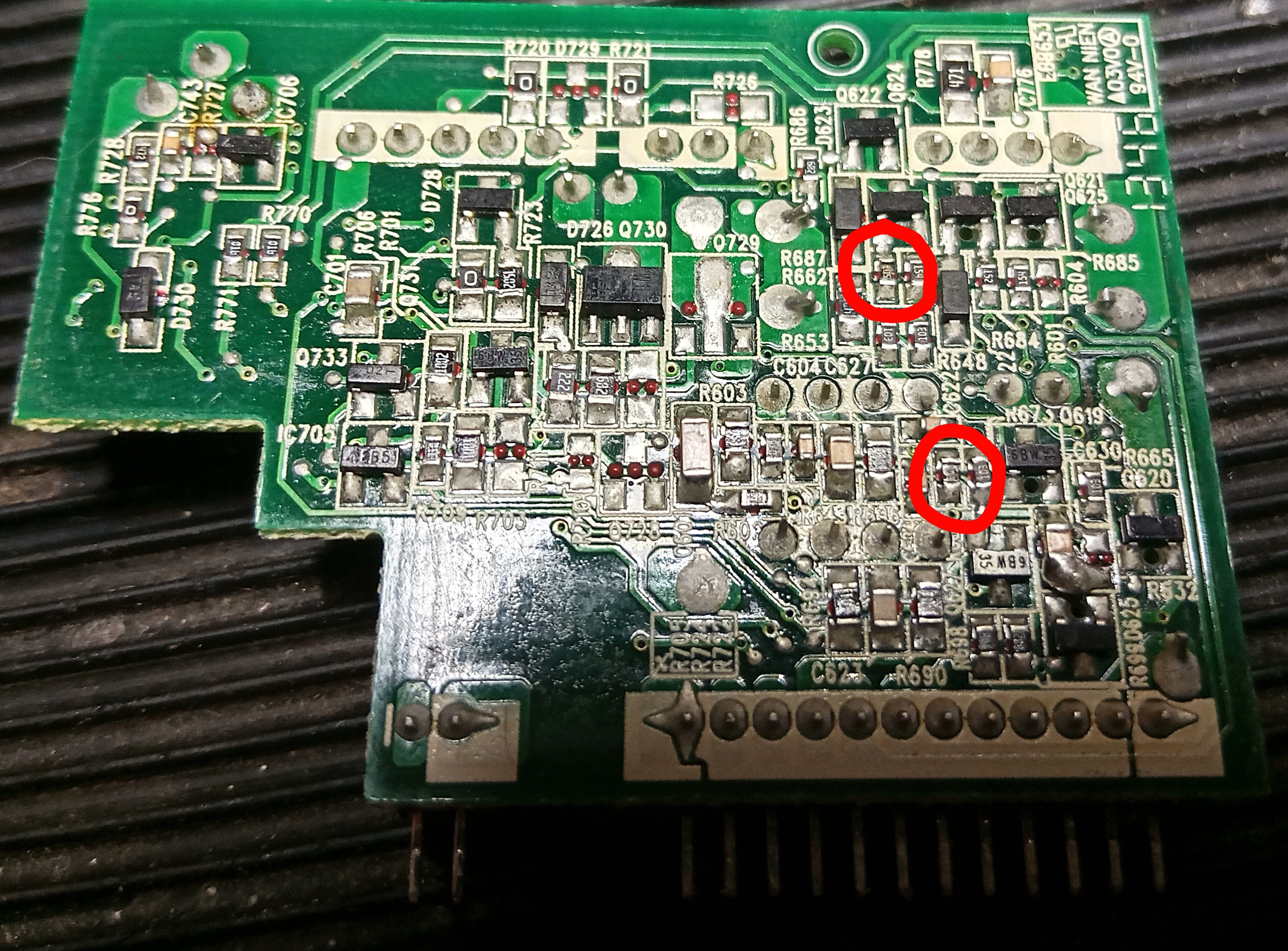

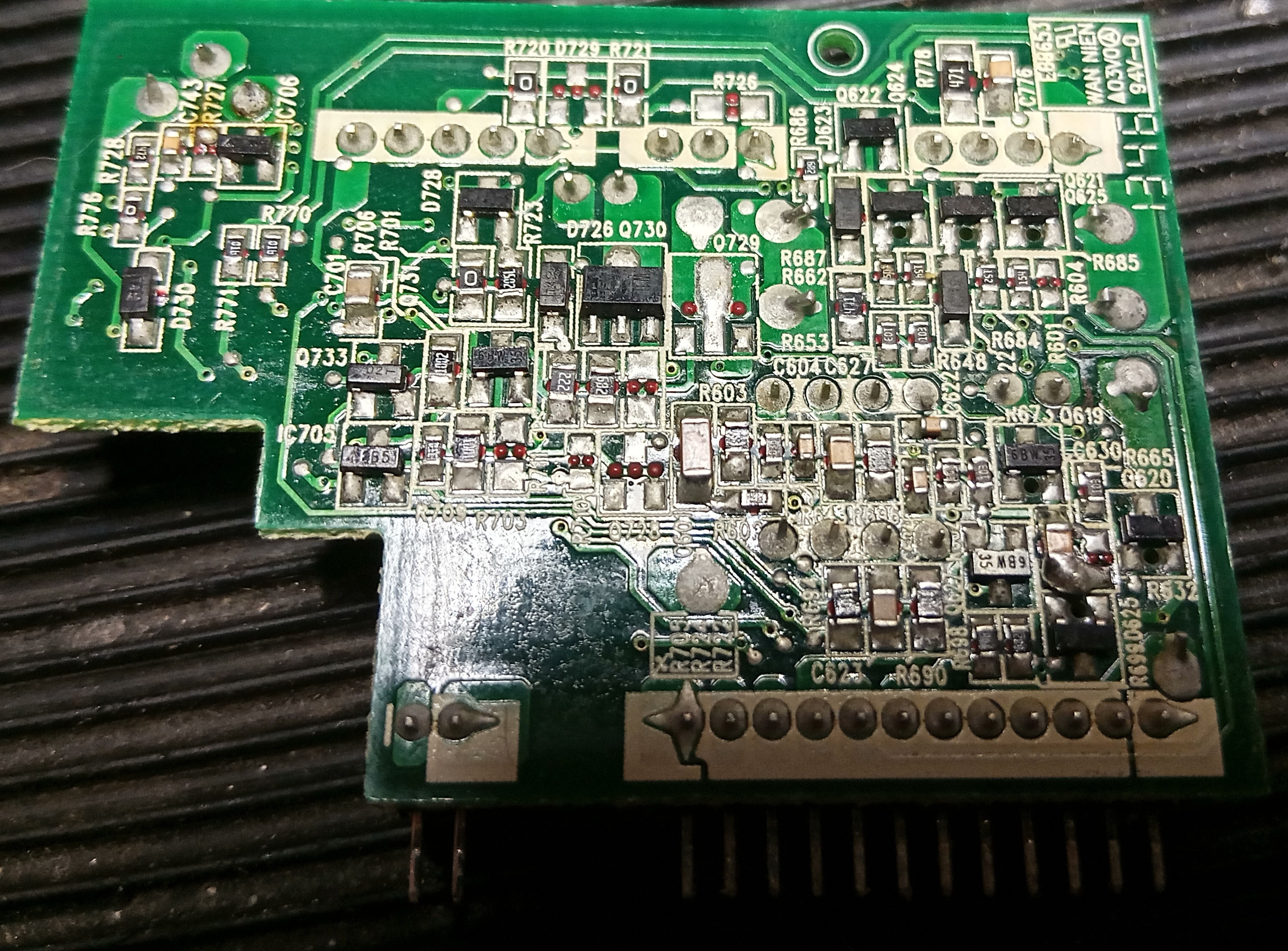

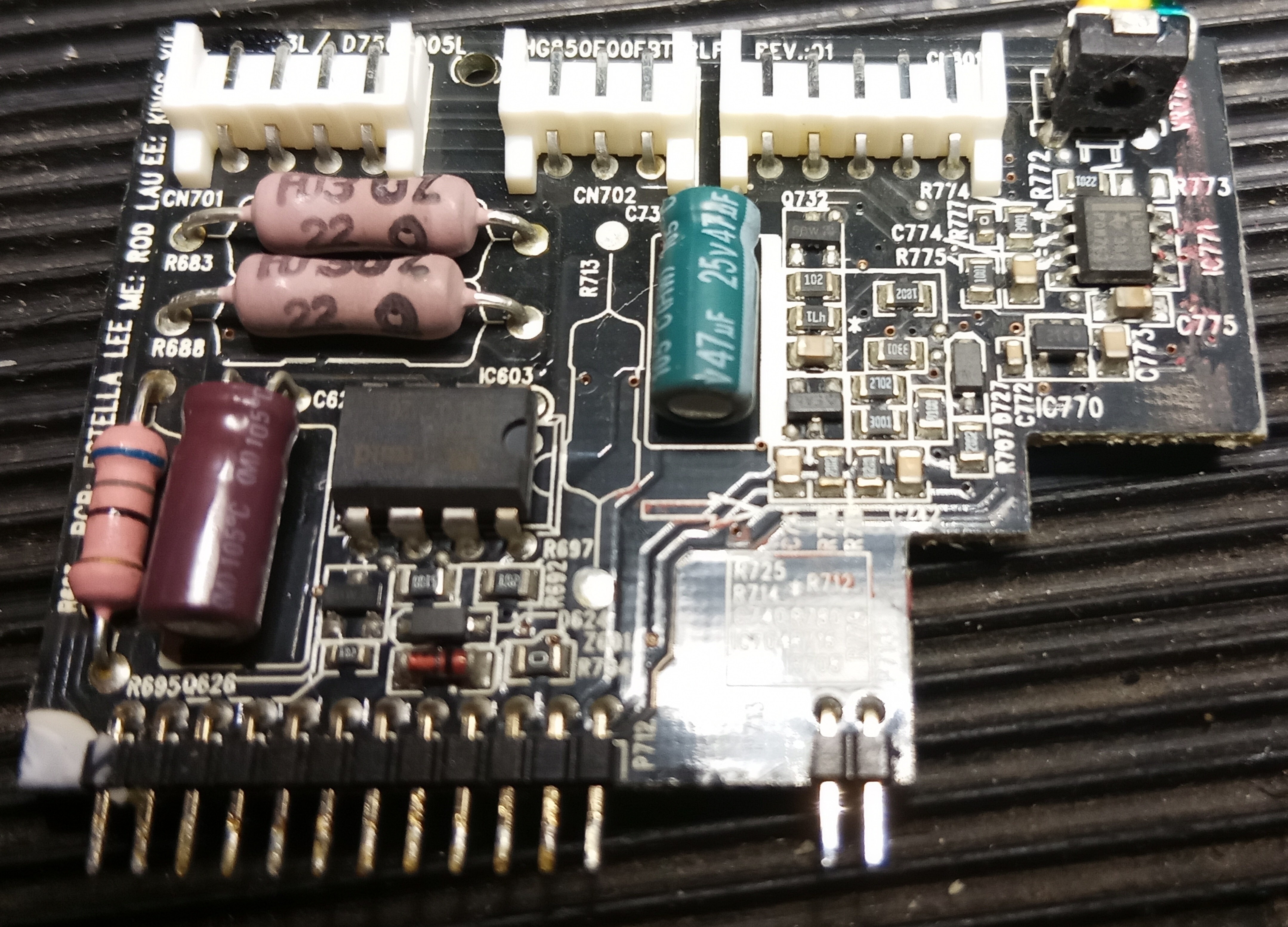

                      Attaching supervisor board pictures. It is based on Weltrend WT7502. That solder blob on the back is factory. Don't know what corshair did.
                      PCB PSU model
                      Code:
                      D750E005L/D850E003L
                      9MC850E00FCTX5LF
                      REV.: 03

                        • 31246
                        #31
                        compare the example to your psu - the PG output doesnt have much to check
