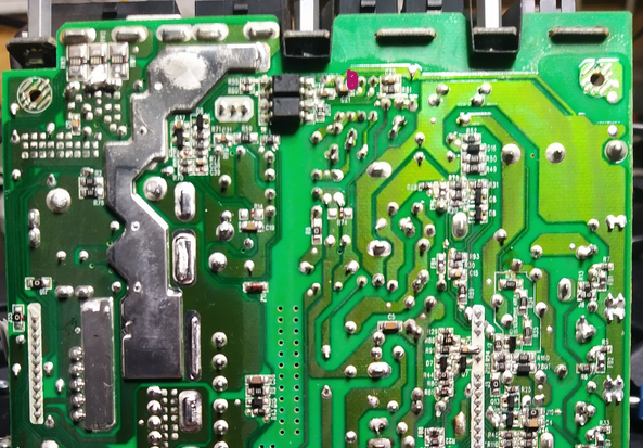

                                    #57
                                    I just got an idea to inject extra 5.10V into the 5VSB rail with the board plugged in. That was I guess we could find out if the mainboard will power on while the 5VSB rail is being "assisted" by my benchtop PSU. I would probably need to limit the benchtop to 500mA instead of 1A (this board needs ~700mA 5VSB current when off).
                                    As for the 5VSB caps, all of the electrolytic ones around the transformer were replaced (there aren't any more on the pre-main power generation circuit). There is one small cap near the primary FETs which I haven't checked since it's in a place hard to desolder. Gonna have to desolder the schottky diode heatsink again. It may be responsible for the 5VSB, but it's very likely for the switching of primary FETs.
                                    Another thing could be that the FETs are still in FP case, not TO-220 but that shouldn't be an issue since 3x 3.5" HDDs should in theory draw more than 60W on spinup (while the board without 4Pin CPU PWR connector should draw way less).
                                    Wasn't the FSB127H responsible only for the primary FET switching? I'll solder some probing wires in order to check it.

                                        #59
                                        Well, this is odd.....
                                        So I've measured the pin 2 of FSB127H and... the results are questionable...
                                        Without mainboard:
                                        PSU with mains applied - ~4VAC
                                        PSU ON - ~5.3VAC
                                        With mainboard:
                                        Mainboard OFF - ~4.7VAC
                                        Mainboard with shorted PWR_SW (still can't power it on) - ~60VAC
                                        Now that 60VAC is very questionable. Max this chip can handle is 30V according to the datasheet. From what I could read from the typical application schematic, it also uses DC voltage and not AC (I made sure the MM is in the correct mode, in DC mode it spews -0.08V with spikes up to 20V when cutting mains power, AC mode has the results above).
                                        What's even weirder for me is the fact that the PSU can boot without the mainboard with AC Vdd.
                                        I made sure I soldered the probe wire to the Pin 2 and not Pin 7 (attached image is where the probe is soldered on).

                                          #60
                                          Agent24 said, there are weird ways the switcher can fail, but haven’t seen this. So check the power input pin and see if the voltage drops to the switcher. Other than that, either the ultrafast rectifier diode, something is wrong with the feedback, the caps for that 5VSB on the output, maybe there is a starter cap on the primary. There isn’t anything else much… besides the motherboard is drawing too much power.
                                          Read the spec sheet. VDD needs to be 12VDC to start and 6V or below it stops.
