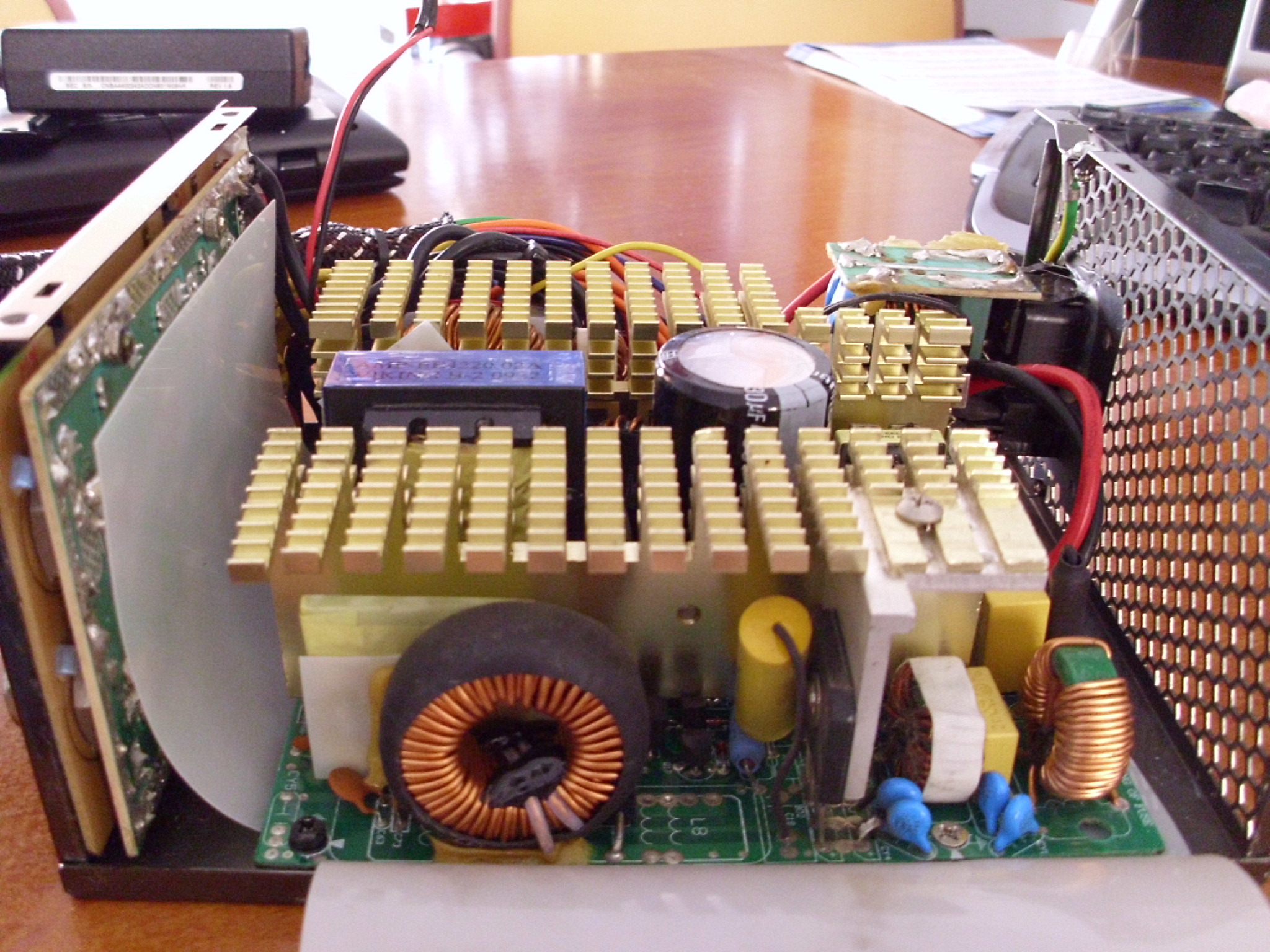

    Need some general advice,
    I have a SF-650R14HE that has the following issue.
    1/ When the PC is not under any sort of load, the PC will randomly shutdown. If I try to power it back on the PC will not power up. LED on the motherboard stays lit at all times.
    I have to unplug the PSU, let sit for a few moments, then the PC will power back on when I press the power button.
    2/ When the PC is on, it will randomly reboot, usually a PC shutdown occurs first, but sometimes a reboot occurs before the random shutdown.
    What I have done.
    1/ The PSU is not particularily clogged up.
    2/ Ive replaced some caps that I though may be the issue but the problem persists, to be precise I replaced
    2 x 3000uF 10v
    1 x 2700uF 10v
    2 x 3000uF 16v
    1 x 330uF(M) 400v
    Measuring all the rails independantly (3.3/5v/12+- etc) all readings seem normal.
    What else should I be looking at to see what is causing these issues ?
    I know its not a motherboard issue as replacing the PSU resolves the shutdown/reboot problems.
    Any input would be appreciated !

          Good clear pictures straight on top and bottom and some from the sides at an angle might help - its difficult if you cant see!
          What caps did you use as replecements - make and series.
          Try puttiing loads on the output 12v car sidelight bulb fans etc.

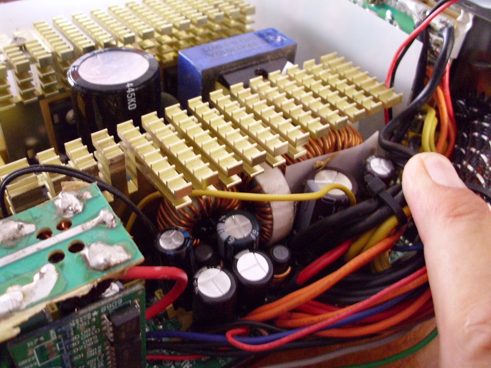

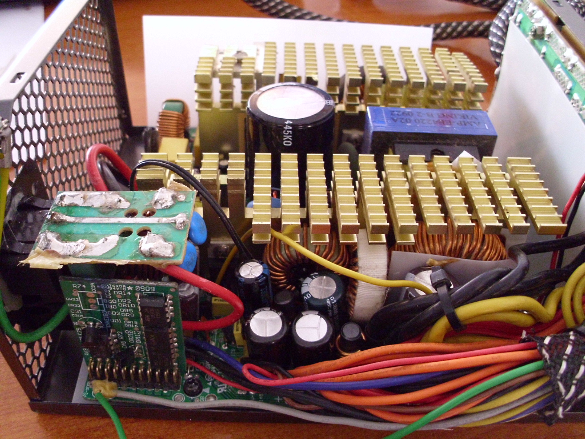

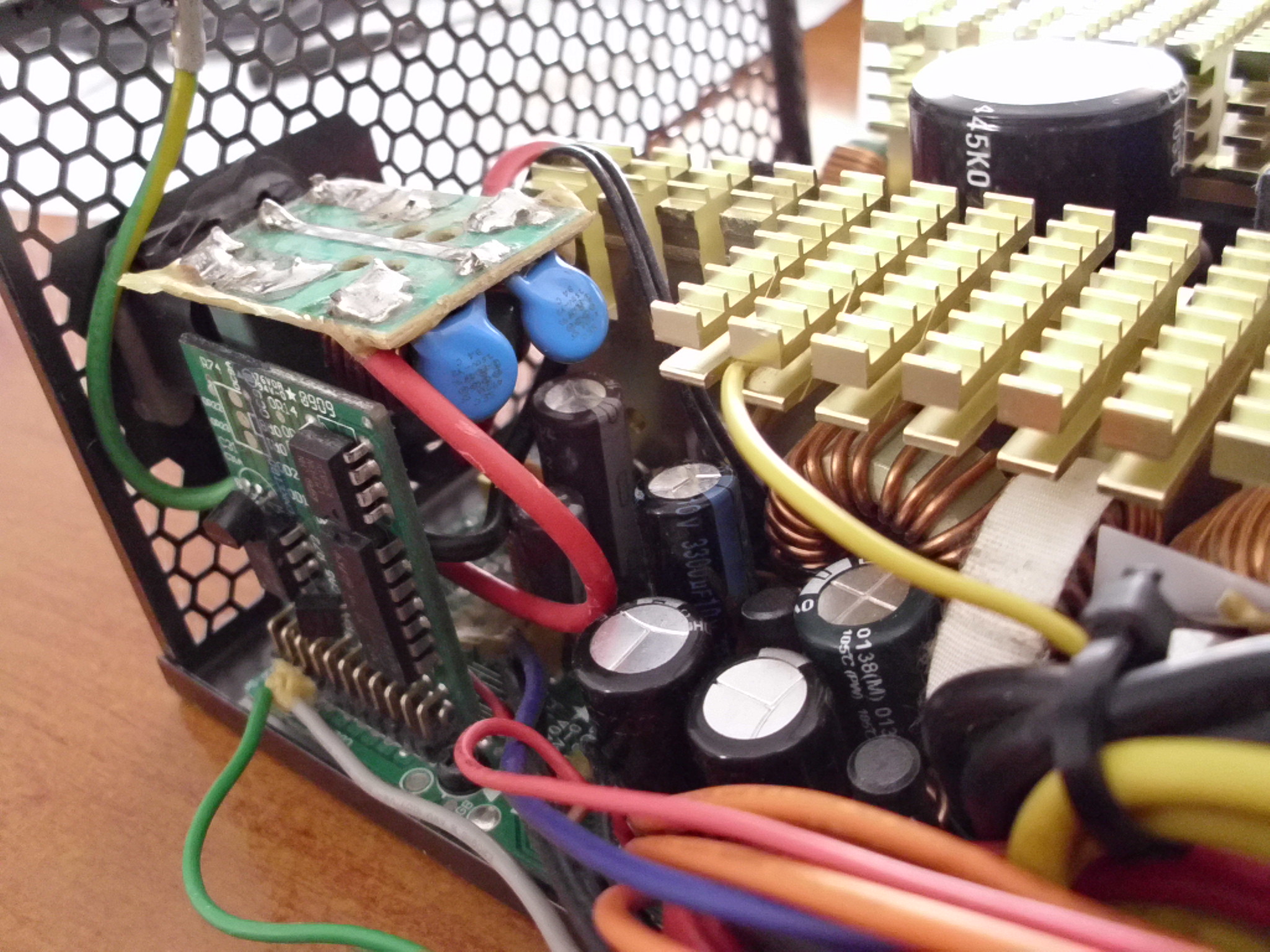

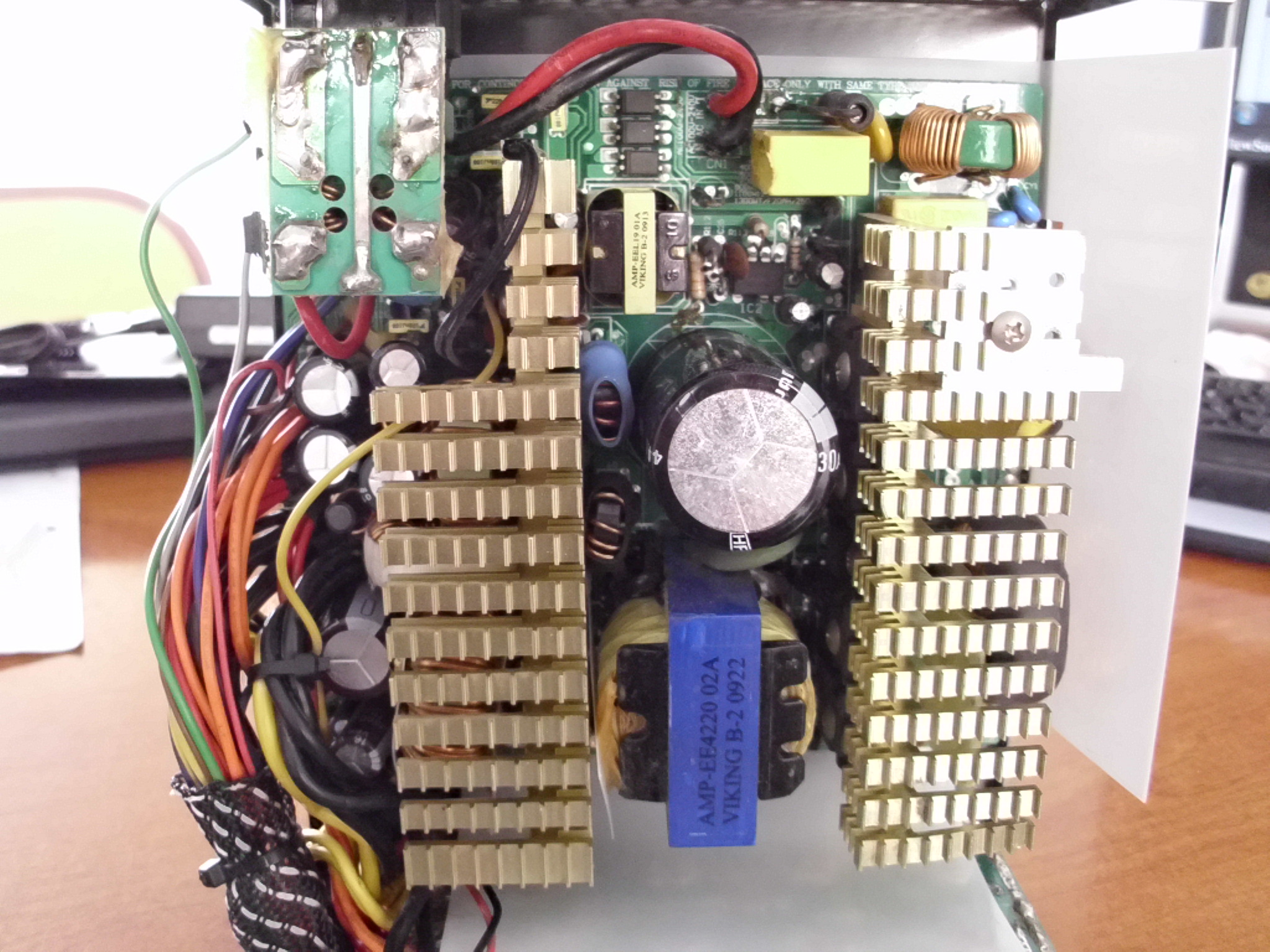

            Re: Sf-650r14he
            Here are the pics.
            @selldoor
            Regards loading the 12v rail, are you wanting me to take a measurement off the 12v rail while loaded (just trying to figure out why you have only asked me to load the 12v rail) ??
            Cheers

              Did you check all the caps with esr/capacitance meter?
              Also check solder side for shorts, bridges etc.
              I would also check the toroid coils for burnt glue that gets conductive and can short turns of copper.
