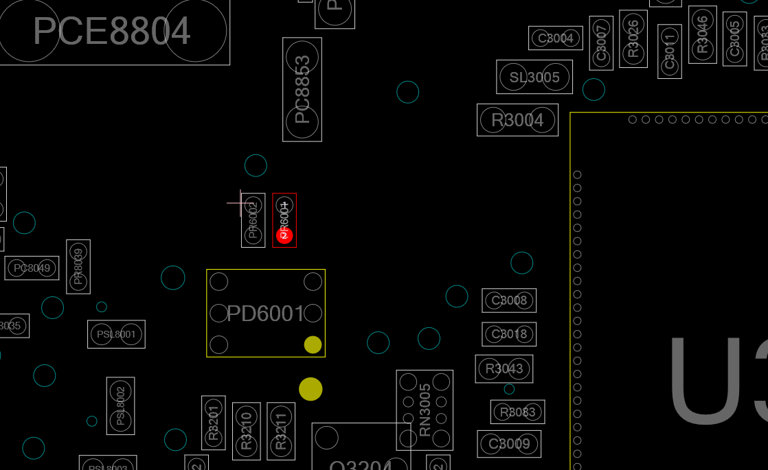

                        • mon2
                          • Dec 2019
                          • 13829
                          Re: Asus tp550ld randomly shutdown
                          Found the requested details.
                          1) J6003 = Battery connector.
                          2) See attached. Do you have this ESD diode array on your logic board ?
                          PD6001 = ESD diode array used to protect the battery interface.

                                • mon2
                                  • Dec 2019
                                  • 13829
                                  Remove PD6001 and test to see if it makes a difference on your logic board.
                                  • khelane
                                    • Apr 2015
                                    • 159
                                    • xxxx
                                    I removed the PD6001 but nothing happened
