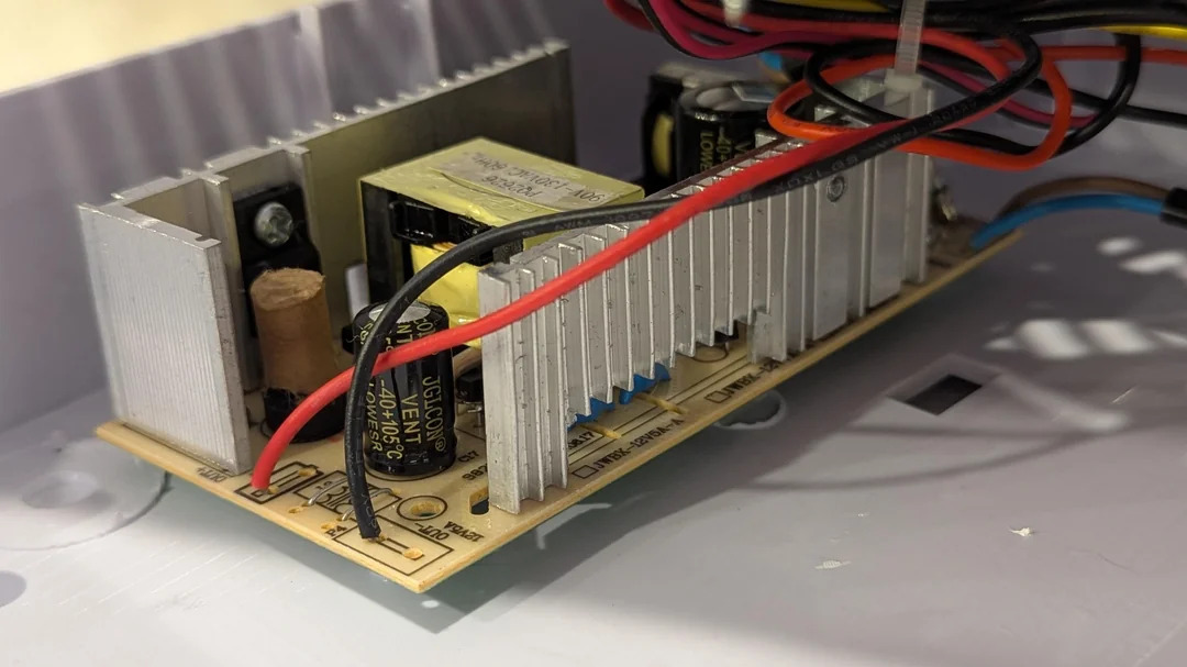

    Turned it on. Green LED is on (set to cool), but the fan did not spin. Opened up the back, and found two blown capacitors. One blew up dramatically enough to remove the outer covering. Not sure if I can find that outer covering. I *think* the power board is the JWBX-12V5A-A (source: nbjianwei.com). She just wants to cool off her skincare products. If I were to buy an 12V AC adapter (Amazon has one by HKY), can I use it with this compromised power board?
    If I need to repair this power board, how can I identify the specs of the nekkid capacitor? I can identify the one with the covering, but I am not sure whether the other one has the same specifications. If anything, they look similar physically. Not sure if other parts are also compromised (MOSFETs?).
    If I want to replace this board entirely, will this JWBX-12V5A-A board suffice?

    show the underside of the board to see if the 2 caps are connected together - if they are then they are probably identical.
    then replace them with panasonic FR series, rated for 25v.
    are the originals 25v or did the makers ride close to the limit with 16v parts?
    also check the diode on the heatsink isnt shorted - incase it blew the caps

      Looks like the 12V output of a power supply and 2 capacitors in parallel. Change both caps to 25V and 105C rated and you can increase the capacitance a little too as long as they fit inside.

              I found them on another site. Looks like the board is a JWBX-12V5A-A
