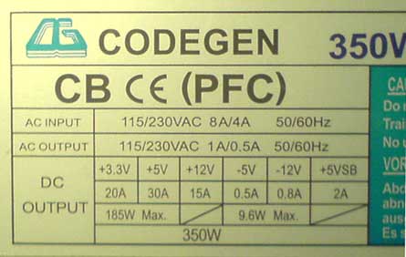

    First I thought it was the PSU (a Codegen 350W that came with the case. A no name that has worked without any problems for me) since I had similar problem symptoms a year ago when my Antec TruePower 550W started to misbehave (after only 2 years of use *see footnote). I tried with another PSU, no difference.

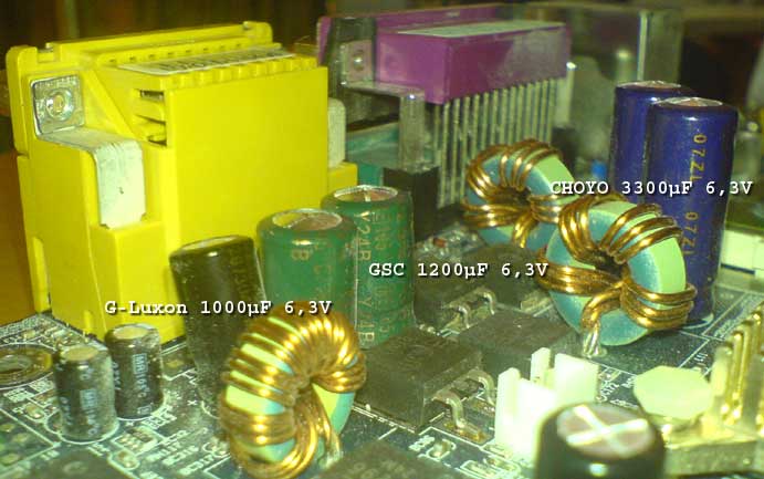

    The 5 caps closest to the VRM and the CPU all had bulged tops and one was bent at the bottom (2 x Choyo 3300uF 6,3V | 2 x GSC 1200uF 6,3V | 1 x G-Luxon 1000uF 6,3V). At the time I didn't really know that bulged caps was a problem...

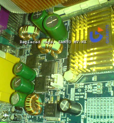

    I decided to give recapping a chance. I bought replacements for the 5 caps mentioned before (for a start) from ELFA located here in Sweden. I chose Sanyo MV-WX that was recommend by CapacitorLab as a suitable caps for mobos.
    I consider myself rather handy, even if it was some time since I last did soldering work. Even if the mobo wouldn't come to life again I could live with that. Since it's from the 2002 maybe it would be a good time to upgrade the entire computer anyway...
    I got going with a new 60W soldering iron and struggled for quite a while, but couldn't get the solder to melt. So the next day I gave it a go with a 100W iron (with a rather big chisel tip, too big and clumsy IMO) and had better luck. But still it was a bit tricky to get the caps out at first, with the too large tip. (Could have used some practice too, I guess ;P but no old mobo to practice on though.) Soldered on the new caps and checked mobo for any possible damage.

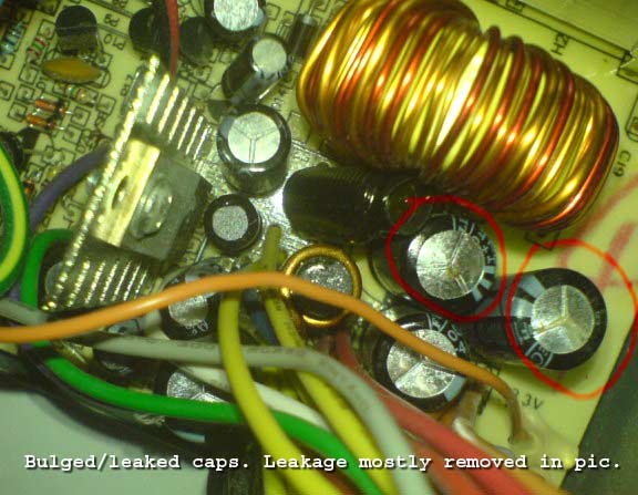

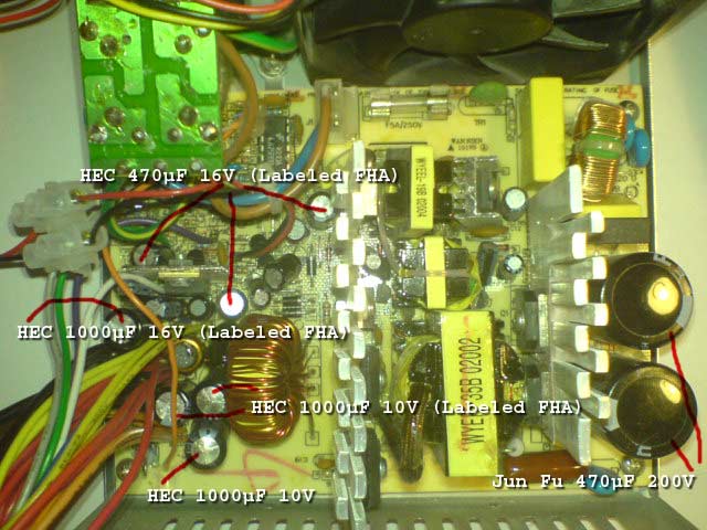

    Opened up the PSU and found 2 caps bulging/leaking at the top. The brand of all the caps inside are "HEC", except for the 2 huge 200V that are "Jun Fu". The leaking ones are both 1000uF 10V what I can see. One is taller and the shorter one is labeled FHA (like some other caps in the PSU).
    The fuse seems intact what I can see. Don't really know how a broken looks though.

    I know there is a shock hazard involved with PSUs and recapping them. But I have not found any good guide for that job. I would like to know how the procedure looks like. What the DOs and DON'Ts are. What the dangers are etc etc. I mostly want to learn. Repairing the PSU is not the main target here.
    Do you think its the caps that are the problem with the PSU. Or is it shorted some how beyond repair?
    Or is the green wire hotwire trick not working and the PSU is actually still working?
    What kind of caps should I use? Same kind as the ones I used for the mobo? The caps I can get hold of have all kind of different typ names (MV-WX, UAX, RJH, MV-AX and so on...) and all this is totaly greek for me. Here is a link to the different types of caps I can get my hands on. It's in Swedish so please bear with me =)

    What caps should i change? Should i change the small 470uF 16V, they all look ok. How about the huge 470uF 200V?
    Does the "FHA" that is labeled on some of the 1000uF stand for something important?

        What typ of caps from Sanyo should I use in a PSU? Is the MV-WX a good choice?

            Those Codeggen PSU`s are all crap, and i have had a few systems with burned out parts due to over voltage caused by them.
            So replace it and go with your Antec.
            A good PSU would most likely do not burn, if the board is faulty.
            Only such POS like Deer, Codeggen and others where the crappy protection circuit is not working, could be damaged by error conditions due to other parts.

              Codegen's are definitely a suspect PSU (to begin with), and NOT worthy of decent capacitors IHMO, I actually did bother and replaced them in a 550w unit which began to fail anyway 6~12 months later... I'm sticking to recapped Antecs from now on!
              AFAIK it's PSU's that kill motherboards not the other way around... I'd give the RMA'ed Antec a quick go!

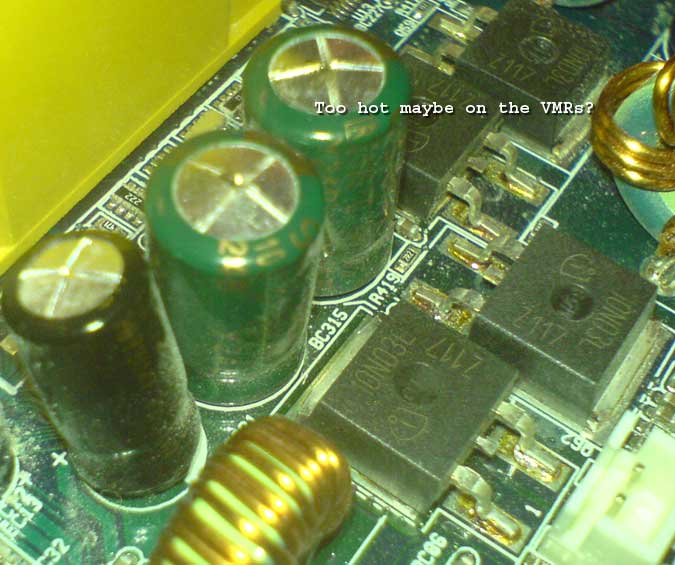

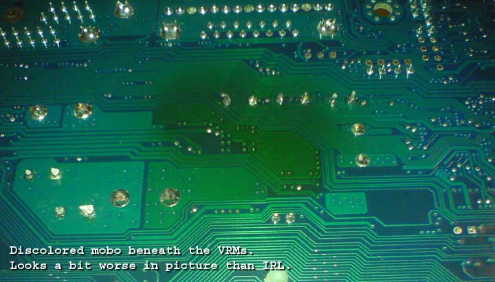

                I took a real close look at the Gigabyte mobo yesterday. I just might have damaged a circuit, I'm not sure. Didn't see it before. But its really small and I don't have a magnifier, so I can't really tell. Think I'll borrow my brothers camera and see if I can get some sharp close-ups that I can zoom in in the computer. (The pics I've posted so far are taken with my mobile phone).
                Anyway, now I've taken a photo of the discolored back side, beneath the VRMs, that probably been overheated by the VRMs. Doesn't look all that good...

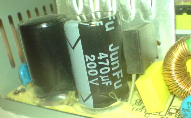

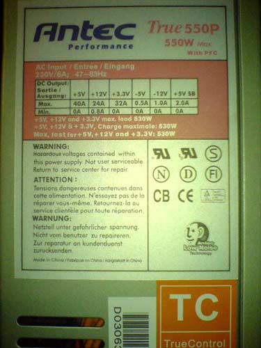

                Took a peek through the holes in my new Antec True Controll 550, its packed with Fuhjyyu caps . Now I don't know what to do with it. Since I'm probably going to upgrade my whole system from scratch I'm thinking of selling it, since it's still all new, and get one from Corsair. But I'm not sure what to do right now actually. I guess I would be using my current computer as a back-up, and then a 100% 24/7 stable PSU wouldn't be needed in it. So my crappy Codegen could get some last use before its final rest, in case I just could cough some life in it . Or do you think that a recapping wouldn't bring it back?

                  That looks like you've overheated something there, I was pondering what other components could be effected by using a 100w iron ie. IC's
                  By recapping the Codegen, you may only slightly extend the life of a POS power supply at best, I wouldn't bother as it would be a waste of good capacitors IMHO

                    Just to clarify, in case some one has misunderstood, the discolored mobo looked like that prior any soldering took place. I tried to be as gentle as possible with the 100W iron, knowing it was a bit over sized for the job. But of course, I can't be sure if there's been any damage due to the heat.

                        although its looks like a lot of heat damage its probably ok if all was working before recap
                        looks more like discoloring of the solder mask from heat
                        not good thought for the PCB but does happen when you have components that get hot
                        (in this this case maybe a little too hot)
                        Yes going over with a mag glass or loupe is highly recommended I would consider it a "must" really as you do not want any shorts or damage to PCB.
                        A badly made solder joint would have high resistance or possible only good connection through a slither of solder and so to some extend the cap may as well not be there.
                        all joints should look smooth and like a volcano
                        (but a lot of times you end up with more solder then does really need to be there)
                        there is a post in the FAQ's on testing VRM HERE thanks to Akor for posting that one
                        As for the Codegen PSU drop in the bin is best advise, especially if its a known MB killer type
                        As to the Antec.. seems their a good supply when recapped for long term reliability. so that would be the go
                        Corsair are expensive but from the review at jonny's these things are little power houses...if memory serve they are of seasonic Manufacture.

                            Another vote for trashing the Codegen. I have a couple new ones here, never used, they came with a couple cases we got. I wasn't about to try and use them, they're horrid! The Apevia/Assfire POS looks like a Seasonic by comparison, they're so cheesy inside. Mine are missing all input filtration components, just like a Deer/L&C POS. How it's even legal to import this garbage baffles me, frankly.
                            If you're pinched for cash, the FSP Blue Storm 400 would run your system nicely, and only costs $50 at the egg. I've been using them as general-purpose replacements around the office, and they're working nicely. I have one in one of my home machines in fact, 3GHz P4 with 3 400GB SATA hard drives. Exhaust air is barely lukewarm, and it's been running almost constantly since January. Solid as a rock. I have been shutting the home machines down lately though to save electricity.

                                No, the Compaq is an ATX and I checked it with a voltmeter that it's normally wired. Connected it to the mobo and the PSU fan just gave a short flick. So the mobo is dead at the moment but that's ok since I've got a better one anyway now. Haven't bother myself trying to fix it, yet.
                                At the moment I'm actually running my system on that 145W Compaq . And it runs fine too. The only problem is that the placement of the ATX-connector on the Asus mobo is really stupid and the cable from the PSU is damn short. So I have to have the PSU standing on a box outside the case for the cable to reach, hehe... It's temporary.
                                Yeah, I saw that post before and did a check on the VRMs. Either I'm doing it some how wrong or the VRMs are damaged. When testing the resistance (in step 3) I'm not getting zero ohms. Just to clarify if I'm doing it correct in step 3, do I measure the resistance from the ATX-connector on the mobo (correct pin of course) to the input & output of the VRMs? I'm not quite sure about which one is input and output either. Is input=source and output=drain?
                                I did the same test on my "new" mobo and it didn't give me zero resistance either, which made me think I was doing something wrong .
                                BTW, the Codegen is going in the bin.
                                I'm thinking of recapping the Antec, but haven't yet decided if I'm going to keep it or just sell it as it is. I guess it wouldn't have any problems running my next rig. But its a ATX12V so it has a 20-pin main power connector, no SATA or 6-pin PCIe. I would end up with a lot of adapters i guess . Anyone know if that would decrease the performance worth mentioning?
                                Now my question is what kind of caps should I use in the Antec? is the Sanyo Electrolytic capacitor, 105 °C type MV-WX, low impedance, miniature, radial the right choice?
                                The caps I can get hold of come from http://www.elfa.se/en, the place I mentioned in the first post. Didn't see that they have the site in english as well . So it would be very appreciated if someone, how knows better, could suggest which one to use?

                                  The 80mm fan in the POS Codegen is worth saving for a 'casefan' later down the track, I save all PSU fans (unless cactus) for this exact purpose

                                    Only caps I've used to replace the fuhjyyus in Antecs are rubycons and samxons from Topcat. I don't see why the Sanyos wouldn't work, but I'm not sure on all the ripple and ESR ratings and such.

                                      The Sanyo MV-WX are fine, I've used them on a few mobos
                                      They are comparable to Rubycon ZL, it isn't what you'd use in a too recent K8 or P4 grade mobo though. Which is to say for Pentium 3 or Athlon XP based computers they will be just fine...
                                      However Elfas selection of them is quite limited...
                                        The fan has already been replaced once to a Zalman since the last one started to imitate a chainsaw. So it's a keeper .
                                        Guess I'll go with the Sanyo's MV-WX then. Or do you Per know another place to get better caps from, since you are located in Sweden too?
