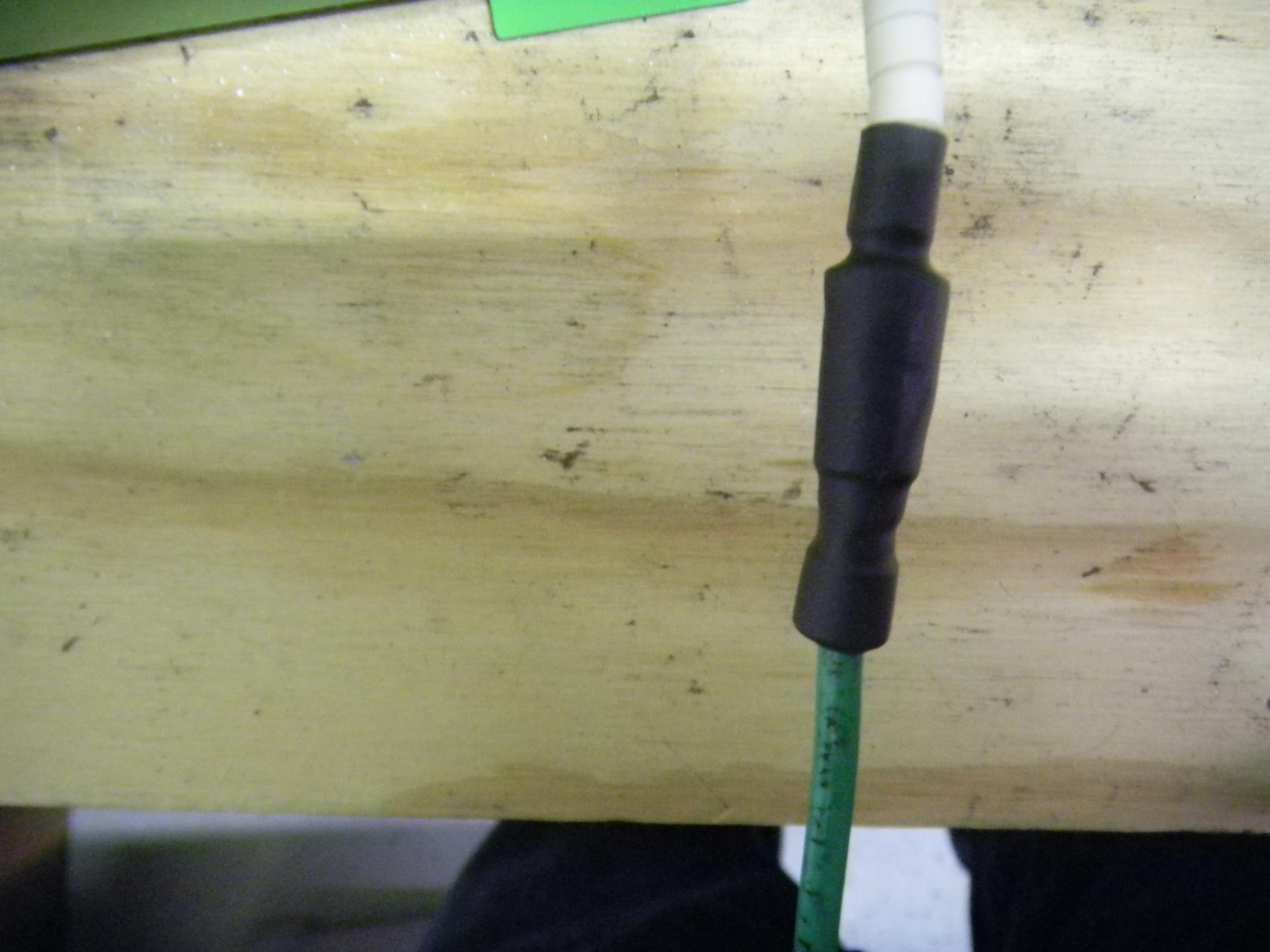

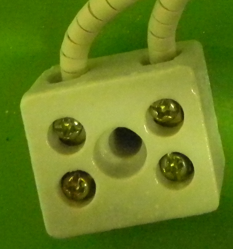

Which connection looks best and more stable
  • xboxhaxorz
    • Jan 2011
    • 196
    Obviously the ceramic connectors will be more expensive which is not a real issue, i am simply looking for the best connection
    The ceramics do take up a bit of room compared to the other connector as well

    Re: Which connection looks best and more stable
    For some reason, im favoring the 2nd photo with the heatshrink tubing
      The one with the least contact resistance, safest, meet compliance requirement. How much current will be flowing through the circuit? Any compliance and inspection required?
        We are trying to meet UL/ CSA requirements but we are not going for inspection
        It will have 110v per line ie; 220v at approximately 2 to 3 amps
          different tools for different jobs,
          ceramics are for high temperature stuff - used with heatproof wire obviously.
          halogen lights are a good example.
            A soldered connection is always superior to screw terminals, for vibration and temperature, resistance, corrosion etc. but is more work.
            Usually the heatshrink is CSA/UL rated for 300V, or a final wrap of electrician's tape (one layer per 300V minimum) is good. You can buy thickwall heatshrink comes/with hot glue inside, for a totally waterproof seal. If this is a high temp >105C application then special heatshrink is prob. needed.
