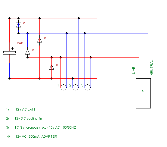

    Hi Guy's
    I need some help with this circuit as it does not work. The motor should turn slowly the light should come on & the cooling fan should run but nothing is working. I have been struggling with this project for week's now as I have posted it before as Synchronous motor.
    Any help would be very welcome indeed
    Jim
  • rievax_60
    • May 2012
    • 897
    • australia
    Re: curcuit problem
    One of the bridge diodes has been placed directly across the AC supply, clamping one half cycle.
    And another one is across the DC rail doing nothing.

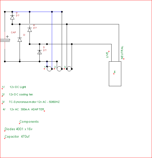

        Re: curcuit problem
        My Mistake guy's posted wrong layout that was one I made earlier I have got the proper one here.& Many thanks' for your replies
        Jim

                Re: curcuit problem
                The motor runs of ac adaptor the light does not which should make it dc the fan is dc if im not mistaken there is the problem on the light????

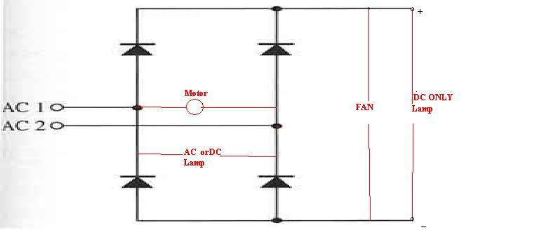

                  Re: curcuit problem
                  Pinching Domas' picture would this work?
                  EDIT Possibly - 1 think early led bulbs were all dc recent ones are AC/DC
                  I dont know if any AC only ones were made

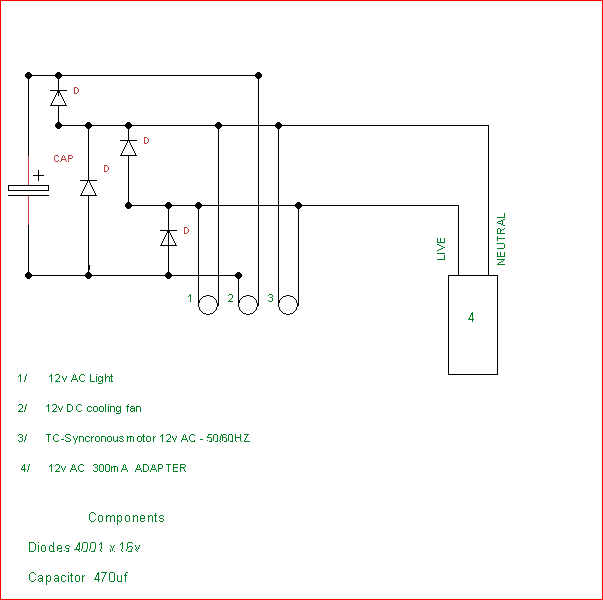

                        Re: curcuit problem
                        Tried it as this but does not work I have left the capacitor in as it was there at the beginning of the project. This is how it made up now

                            Re: curcuit problem
                            I am only getting 2.63v AC after the jack there is something on the circuit that is not right All diodes have been tested as well as the capacitors & all are good
                            The motor is only 1-2w

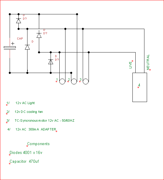

                              Re: curcuit problem
                              You are probably overloading the 300 mA adapter. You should remove the light, fan, and motor then check the voltage. If the voltage is correct then add the devices back one at a time and check the voltage after each one. Also check to see if each device will work correctly without the other 2 connected.
                              You should sum the power requirements for all three devices and use that to determine what size AC adapter is needed.

                                Re: curcuit problem
                                I disconnected the light & the motor started turning but the fan did not. So I disconnected the motor & the fan still does not run so there in a fault some where with the DC layout???

                                    Re: curcuit problem
                                    OK, lets get the info as to how much current each load requires to run:
                                    Lamp = xxxx A
                                    Fan = xxxx A
                                    AC motor = 12V @ 1~2W (~167mA)? for sure, what is on the label?
                                    300ACmA AC transformer with bridge rectifier can only supply 180mA of DC, you will need to calculate the cap size depends on the AC ripple that the load can tolerate.
                                    Right now that transformer can not handle the loads.
                                    Get a 1A transformer so you will have head room and the transformer will run cooler. Also verify your wiring for sure it matches your drawing, seems to have so many corrections from the beginning on this thread and the other thread.

                                      Re: curcuit problem
                                      Okay now I have disconnected the capacitor & now I get 12vAC & 12 DC At last . I will reconnect everything back tomorrow & repost with the results So thanks a lot guys for all your valuable help it has been very much appreciated
                                      Ps I will also get a better AC adapter
                                      Jim
                                        Re: curcuit problem
                                        The 470 uf cap? without cap you will have 120Hz pulsing DC, with the cap in place the voltage on the cap should be around 17VDC, the cap should be 25V rating.
                                        Correct polarity of the cap connected to the circuit?
