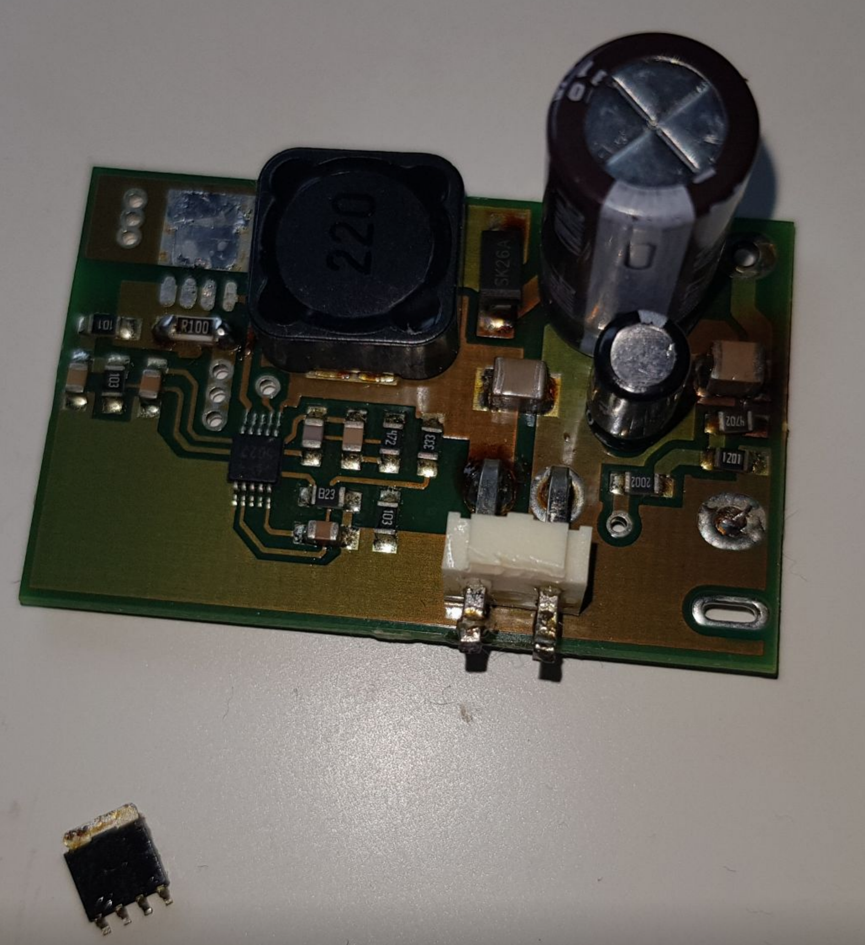

                              #34
                              To everyone who has been celebrating - Merry Christmas!
                              With help from colleagues I have desoldered the mosfet from the buck converter board and the resistance across the input terminals is now 159 Ohms.
                              Should it have increased after de-soldering the mosfet if that component was broken? Just trying to understand the logic behind questining the low resistance across the input terminals being a sign of the problem.
                              Thank you!
                              • CapLeaker
                                Leaking Member
                                • Dec 2014
                                • 8352
                                #35
                                Take that mlcc smd capacitor above the 2 pin prong out and check it out of circuit.
                                • tester001
                                  Tony
                                  • Dec 2023
                                  • 24
                                  #36
                                  Thank you for your suggestion!
                                  I've taken the capacitor out of the circuit and the meter fails to get a capacitance reading (I gave it time!):

                                  The resistance across the input prongs of the little board with one polarity is now 1.795 kOhm and if I switch the probes around it is 34 kOhm.
                                  Does this mean anything?

                                  • CapLeaker
                                    Leaking Member
                                    • Dec 2014
                                    • 8352
                                    #37
                                    Shorted input capacitor. Check the resistance of that cap and you see it has the weird ohms you measured before between these 2 pins. You can just put a regular electrolytic capacitor in its place (keep the polarity of the cap in mind) like 63v or 100v at 10, 22 or 33uF. This circuit should work without this cap too.

                                      #38
                                      Hi CapLeaker,
                                      Sorry! I've not been very clear. The removed capacitor is showing resistance of 4-5 MOhm and counting. Unable to get capacitance reading.
                                      The 1.795 kOhm and if I switch the probes around it is 34 kOhm resistance readings are now across the prongs Click image for larger version

                                      • CapLeaker
                                        Leaking Member
                                        • Dec 2014
                                        • 8352
                                        #39
                                        Is that mosfet out too?
                                        • tester001
                                          Tony
                                          • Dec 2023
                                          • 24
                                          #40
                                          Yes, Mosfet has been out (as pictured a few posts above) and the little yello cap that was above the prongs is now out too
