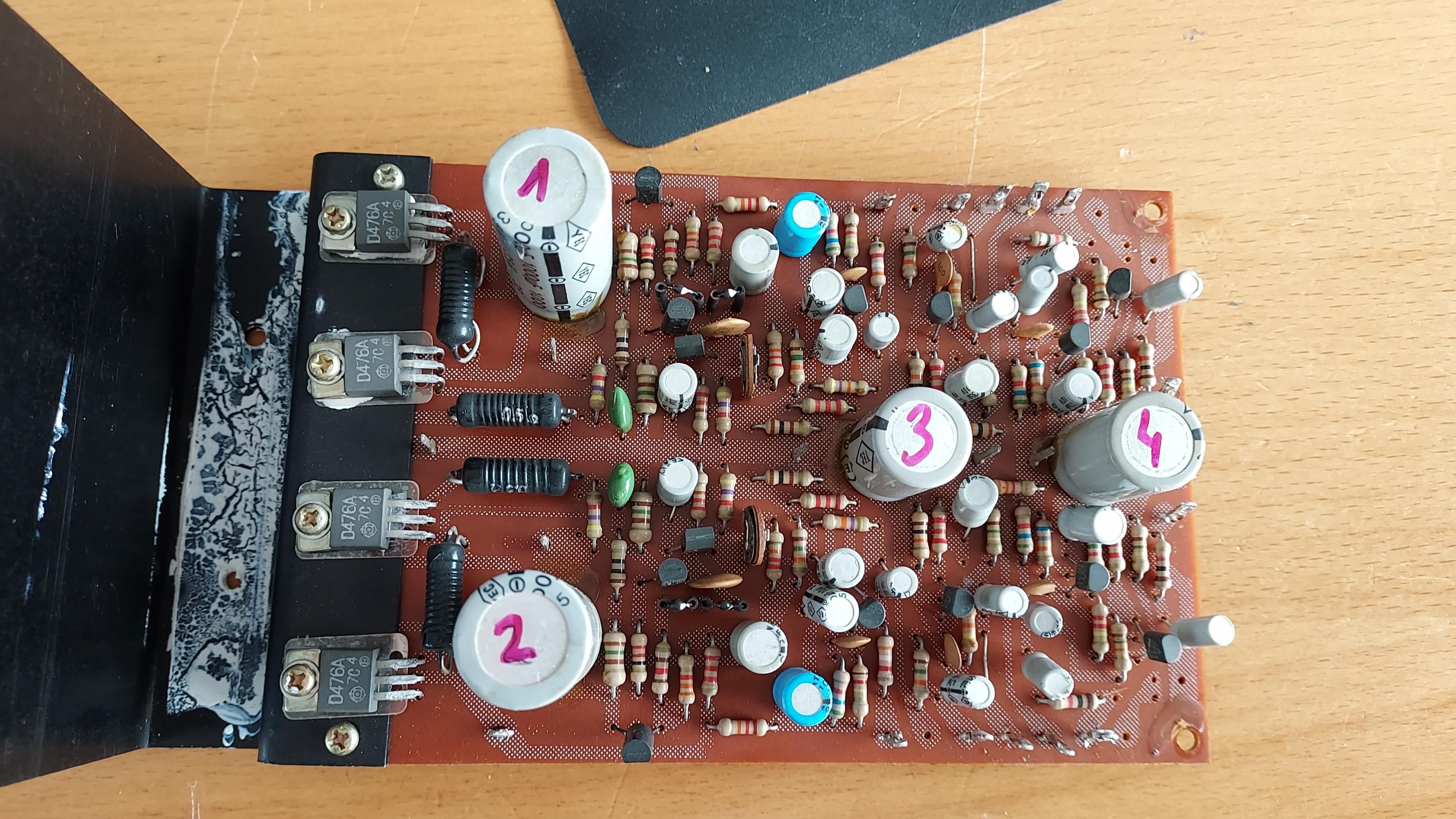

    Hi:
    I bought this amplifier from the 70s to try to repair it. So far it has no output sound, just noise. You can volume it up and down.
    I've checked fuses and all are ok.
    I've continued with capacitors:
    • The main black one should have 4700uF, but it has lost half of its capacity during these years.
    • The ones that I've numbered have still a really low ESR and the full capacity after ¿40 years?
    The 4 transitors are perfect. Desoldered and tested individually.

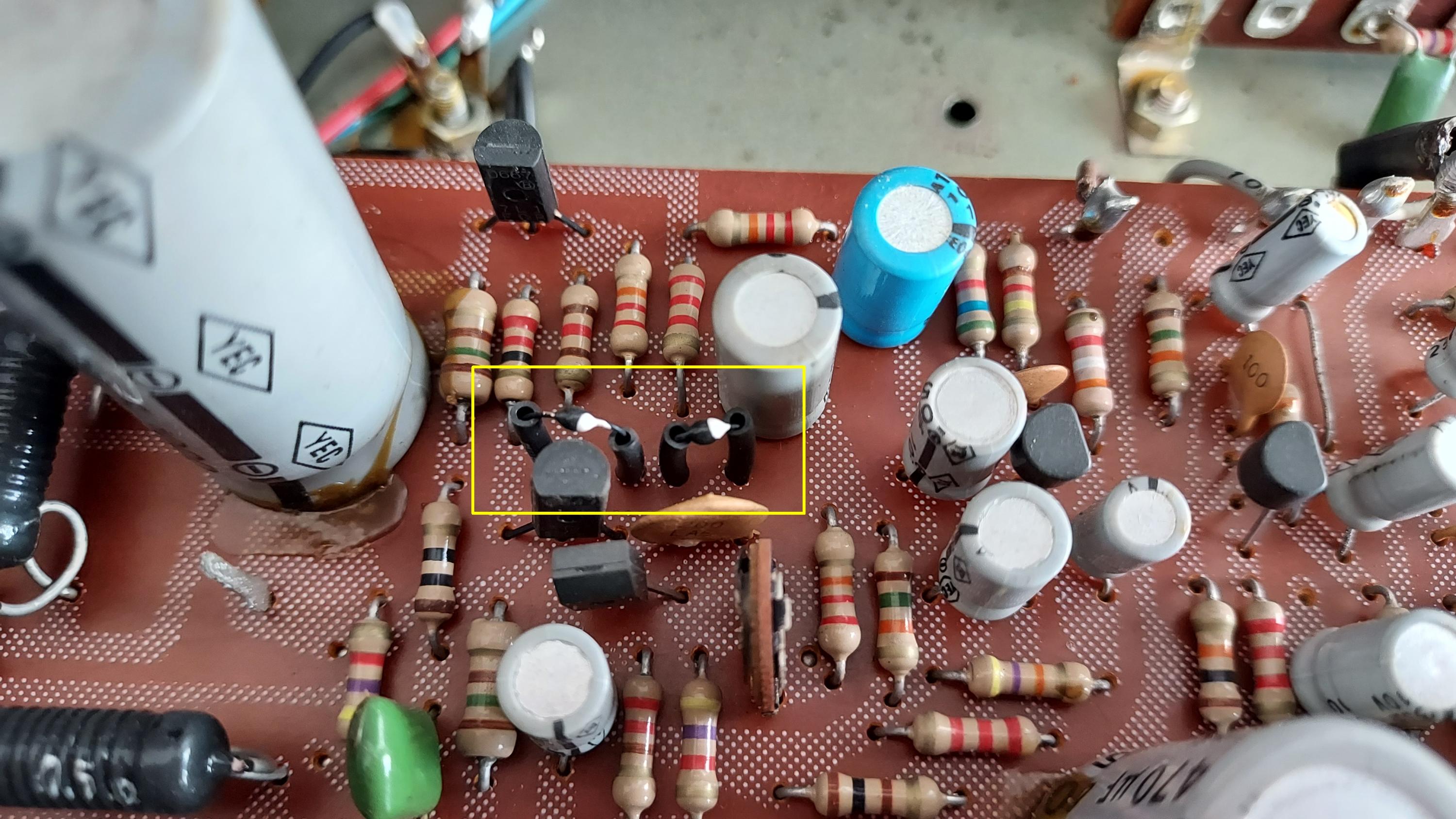

    There are also components which I don't know exactly what they are. The two components I've marked in a yellow rectange.......are these diodes? (there is one next to capacitor "2" that I think doesn't read correctly). This however wouldn't explain that both outputs have no sound :-)
    Keep on analysing..........so far, quite lost but happy :-)

    maybe bias compensation diodes . could be a diode string inside each one . diode test them and see .
    no sound is most likely corroded controls .

          Yeap.......I tested so far all PCB components, and didn't see anything wrong. I mounted again and took contact cleaner spray. Once I cleaned up the potenciometers, specially the 4 position selector it started to sound again in both channels.
          The amplifier sounds ok, however I am just wondering how changing the filter capaciter would change the sound.
          The black capacitor says 4700uF / 50V, but the voltage after the rectifier is 53V and it's capacitance it's only 2000uF. Would you change it or just leave it as it is? (any recomendation/type?? Nowadays capacitors with this capacitance are 4 times smaller )

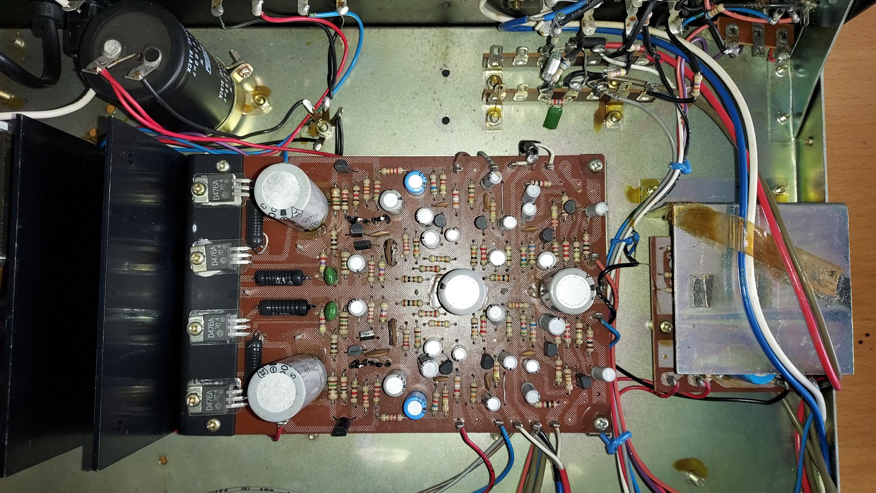

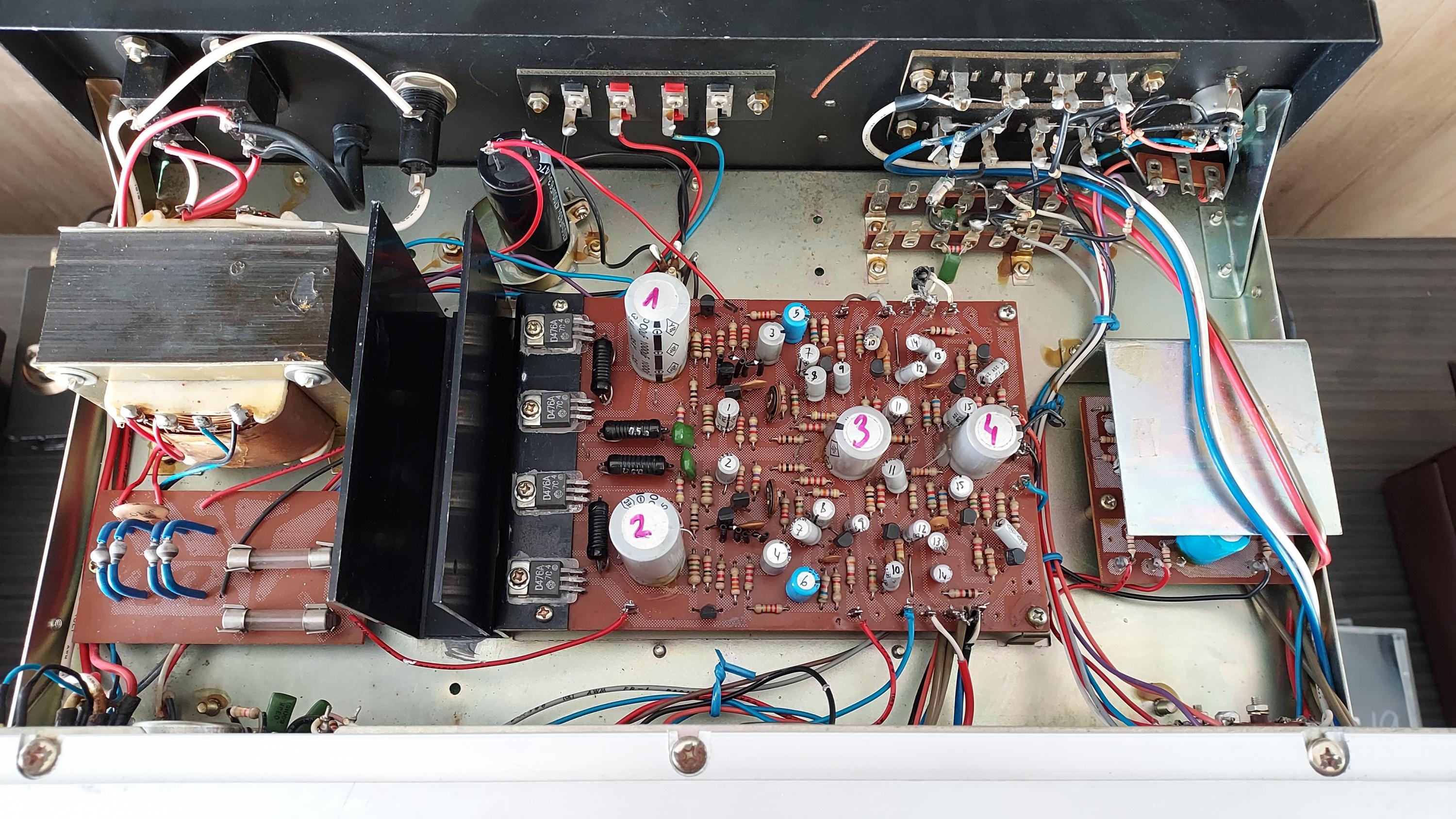

                  Everything mounted and reviewed. Main capacitor changed and stacked with glue.
                  Potentiometers cleaned with "clean-contact spray"
                  The new main capacitor makes a difference. I have the feeling that it sounds better. Maybe it is.

                          the transformer is a 220~220 primary 40v single 12v single secundairy transformer, i suspect a 70 watts one, but it will get hot under normal use (70c), better to mount a 100w transformer to have some spare power so it runs a little cooler.
                          You could just take a 39~40v secundairy and use a small step down print to get 12v for the front light (cause that's what the 12v is for, it runs on AC the light), or you could get a higher voltage smal light so you dont need the 12v.
                          in my opinion a 220v Pri/ 40v Sec 4A wil be perfect. than you'll have 1,5A leftover power..
                          It probably died cause all the caps are bad, and the bias needs to be set reasonably low.
                          All the caps in mine where shot, and the bias pots as well, and a few transistors where off spec.
                          it caused the transformer to heat up immensely, it got like 100c.
                          so i replaced all caps, bias pots for multiturn, and now it (transformer) runs at 65c after a few hours.
