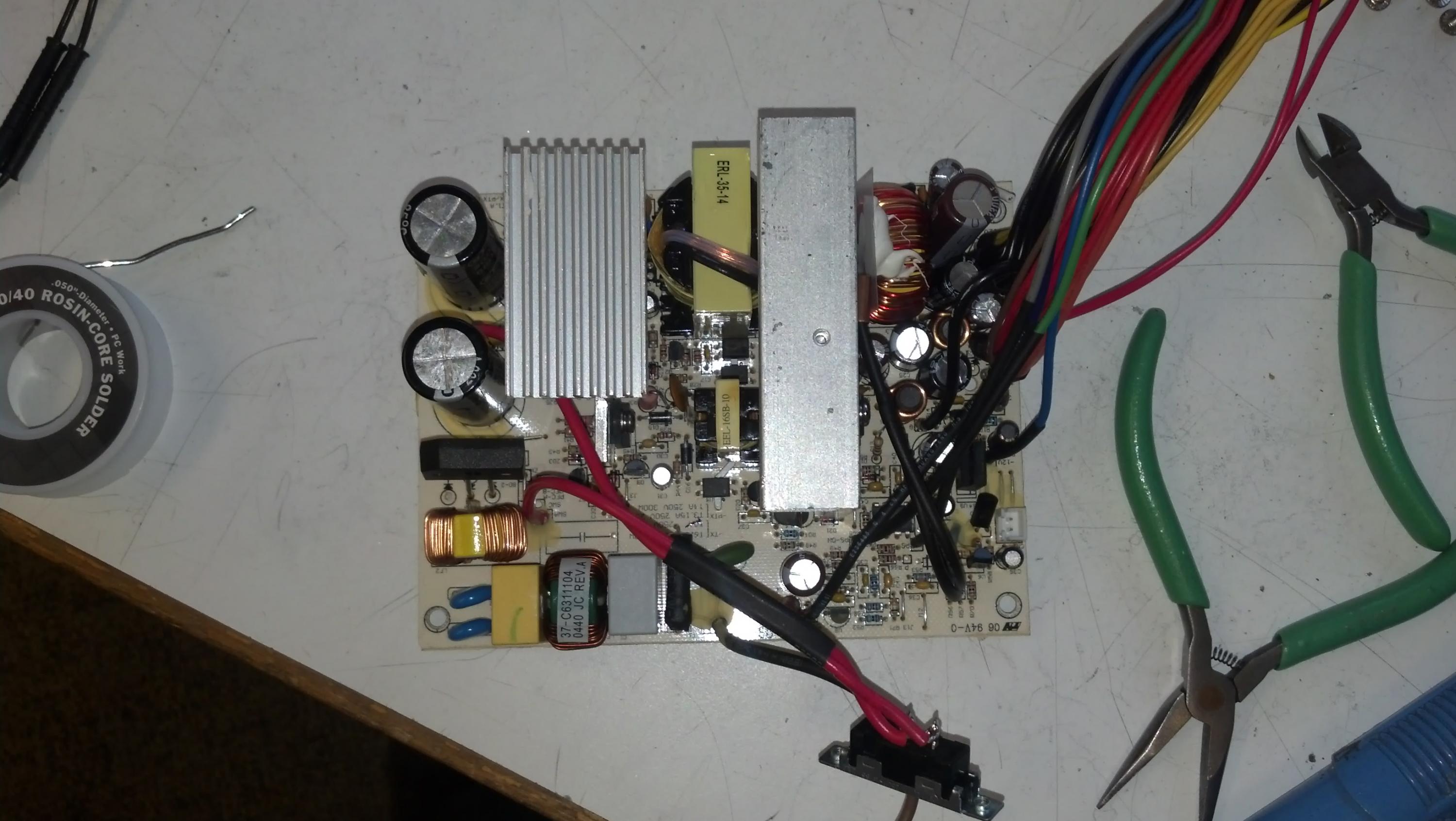

    Re: Weird issue with HEC Orion PSU
    I wonder if the output caps could be faked too. Wouldn't surprise me if HEC sourced them from the same supplier as the primaries.
    • Pentium4
      CapXon Be Gone
      • Sep 2011
      • 3741
      I will check all of those caps after I pull them. They look pretty genuine but then again, so do those primaries
      • lti
        • May 2011
        • 2547
        Those caps were unusually small.
        • Pentium4
          CapXon Be Gone
          • Sep 2011
          • 3741
          Yeah, pretty small. And they're very light!
          • domas
            News Hater
            • May 2013
            • 323
            • Denmark
            after you fixed the transistor, is the primary heatsink getting as hot as before?
            • Pentium4
              CapXon Be Gone
              • Sep 2011
              • 3741
              ^ No, it is not as hot as before, but still pretty warm
              • Pentium4
                CapXon Be Gone
                • Sep 2011
                • 3741

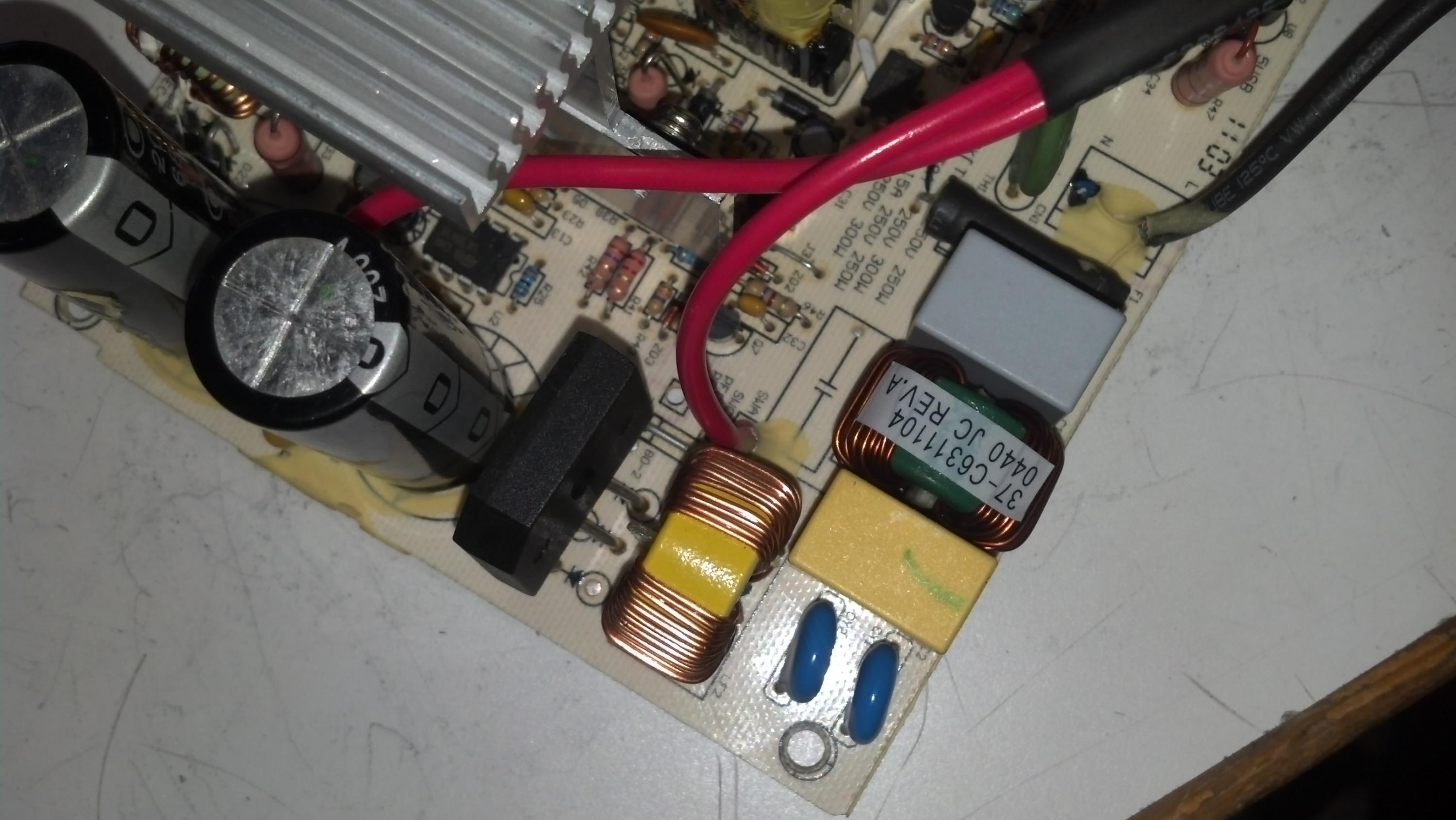

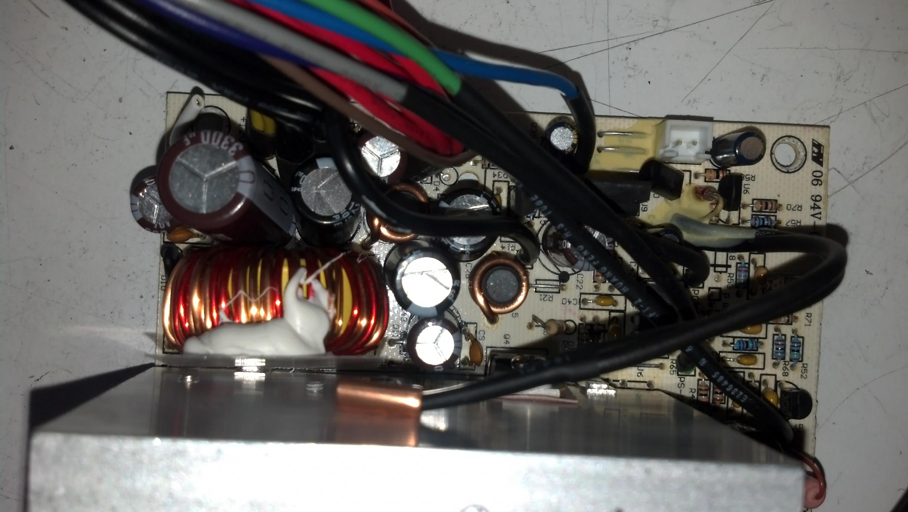

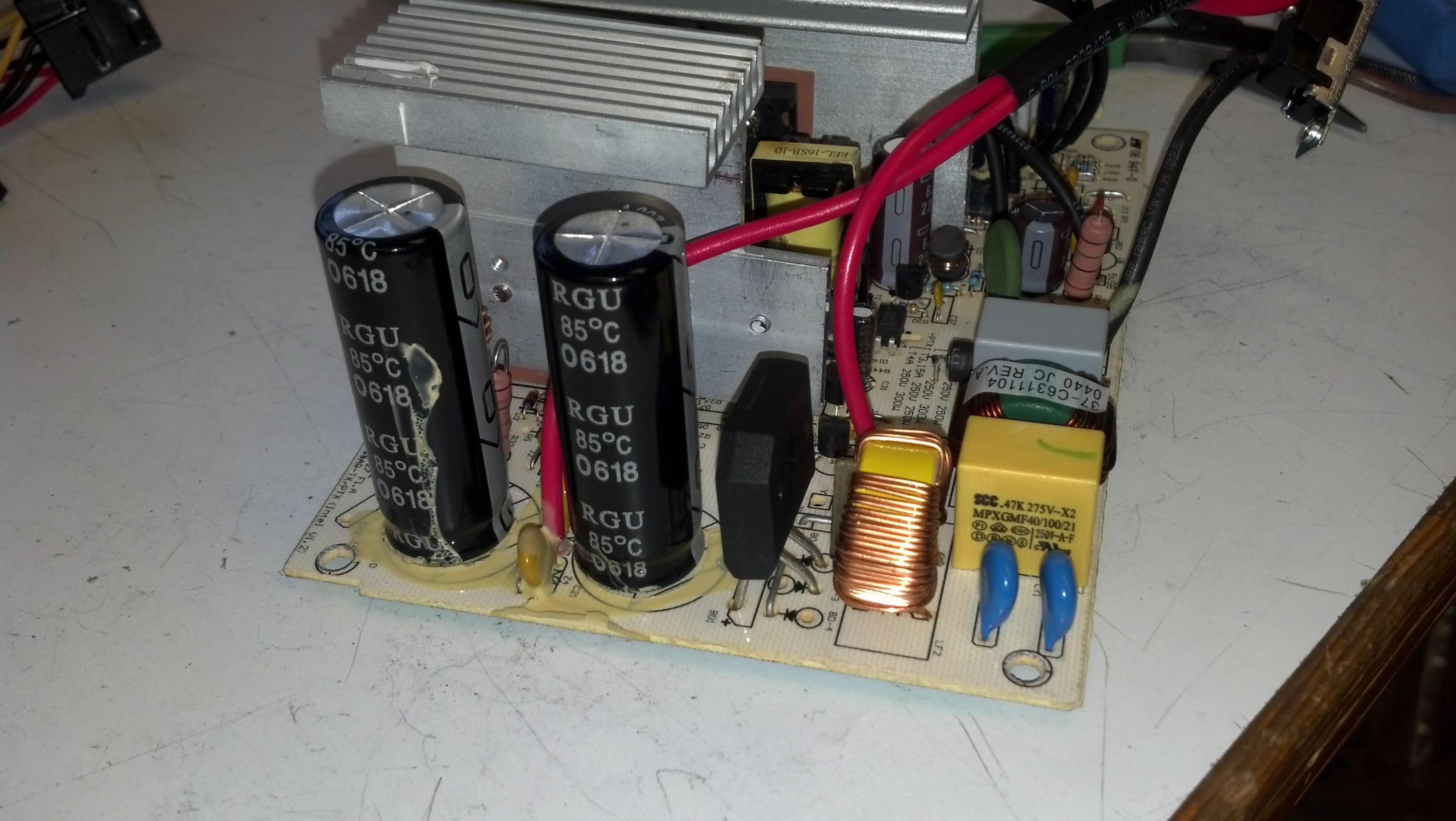

                It looks so much better now added 2 X caps (Both 0.47uF), 2 Y caps, and 2 coils for the input filtering.
                Added a much larger 6A bridge rectifier, replaced those Teapo caps with those 680uF OST caps
                Replaced all of the secondary caps. The 12V only had a single 2200uF cap and no inductor (But it has one on all the other rails....) so I put in a 3300uF KY cap, I'm hoping that will lower the ripple a little bit. The 3300uF KY cap has 1,100 more rated ripple current than the 2200uF Teapo SC. All the voltages look good, and it's been powering a hungry P4 system for a while now
                Edit: All the Teapo secondary caps were in spec, but there was one SEK (GP) which had pretty high ESR
                  Didn't it originally have an 8A bridge without a heatsink? The one in the review did (GBU806 by Lite-on semiconductor).
                  • Pentium4
                    CapXon Be Gone
                    • Sep 2011
                    • 3741
                    #29
                    Not mine, it had a wimpy GBL406
                      master hoarder
                      • May 2008
                      • 12168
                      • Bulgaria
                      #30
                      Looks nice and beefy now. Good job!
                      Only that minimum load resistor on the 5VSB bugs me a little bit, but it looks like a 47 Ohm one, so it shouldn't be that bad. It's dissipating about 0.5W of power. If it was any higher, I would have changed it.
                      • Pentium4
                        CapXon Be Gone
                        • Sep 2011
                        • 3741
                        #31
                        Thanks man! Oh that one next to the 5VSB transistor? Can't believe I checked for those on the secondary but not for the 5VSB...I will remove it
