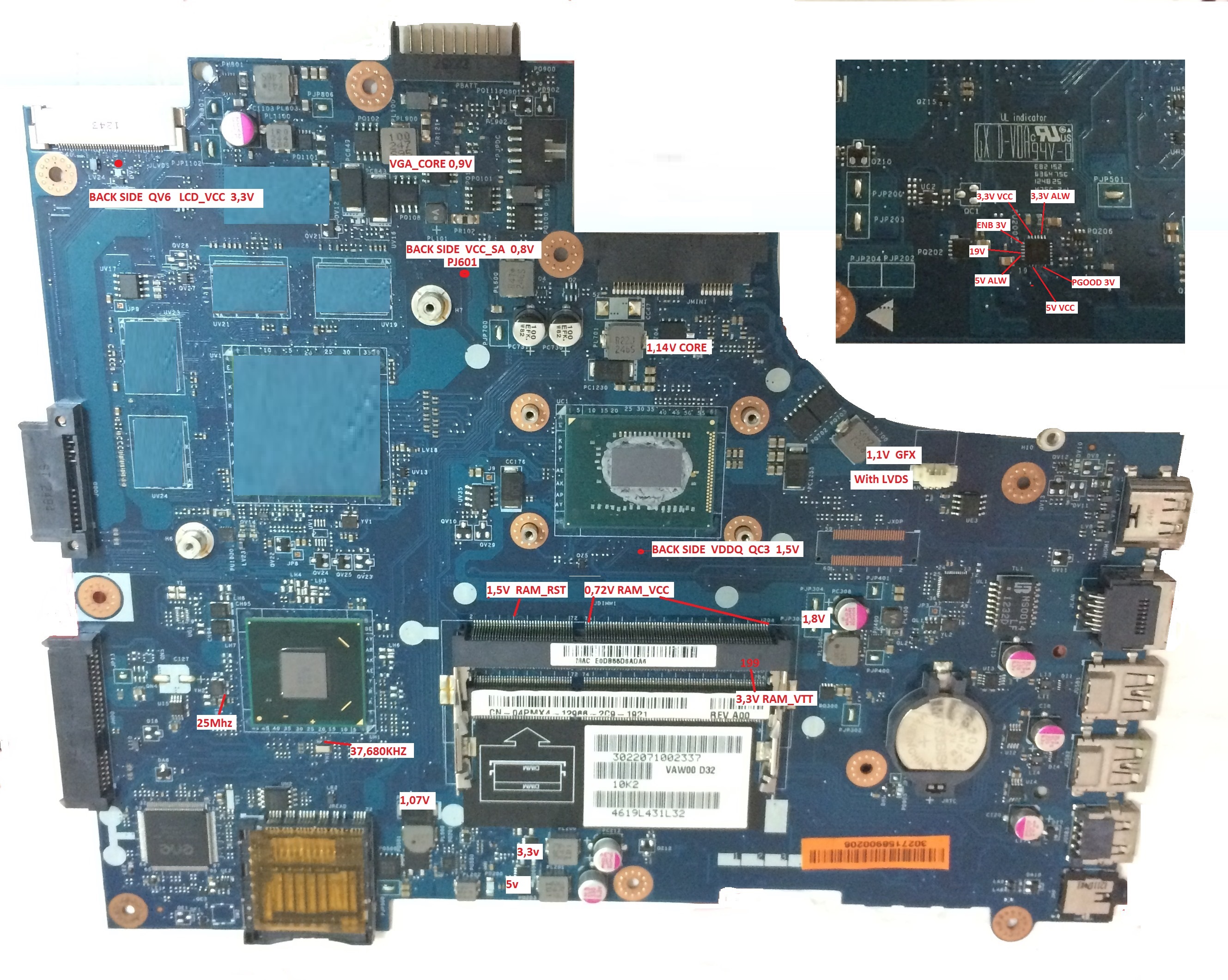

    Hey guys, need help fixing a weird issue with DELL 3542 with board cedar intel mb 13269-1

                            @Spider1211: hi; i have exactly the same laptop, and i have weird voltage 3.7 and 5.2 instead of 3.3 and 5; after many hours, i found it the guilty ic; it was U3504, a protection chip for usb .... i never think those chip gonna messing up the voltage....it has 0,7ohm between pin 1 and 5 .... it blow my mind; take me aprox. 7 hours to find it ....
                              Re: Weird but interesting issue with DELL 3542 (intel mb 13269-1)
                              @c.daniel, thats interesting. I wish I still had the board to test. How did you eventually find the fault? Can you please share your diagnostic approach.
                                Man, yes, i can share; i'm at begining with repair, so my method was absolutely dodgee; here it is:
                                - i attach multimeter, on voltages, on rail 3,3volts, wich it has 3,7volts and let it do the reading
                                - i begining to heating up the mainboard, with hot air station, low flow, very hot air; and, i walk around the mainboard, to see where those 3,7 volts beginning to change value
                                - after i find the area, from 3,7 going up to 3,73 volts, i cool down with vacuum cleaner, and check again with 60watts soldering iron, on chip capsule, to find exactly what chip making the "3.3" to change
                                - all the method took me kind of 3-4 minutes .... but, after i spend almost 7 hours trying....
                                - but, me is verry happy, and that's is all about
