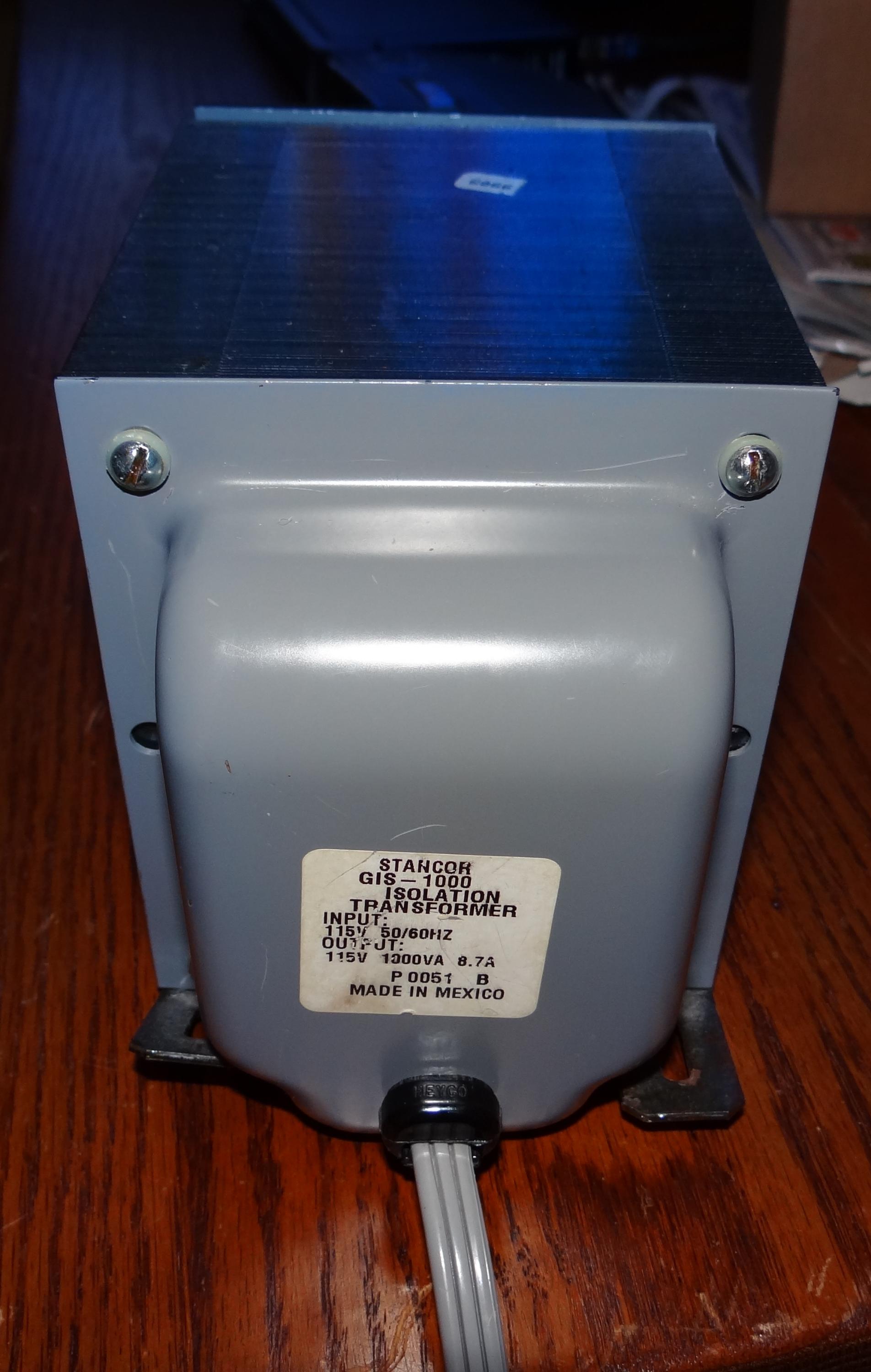

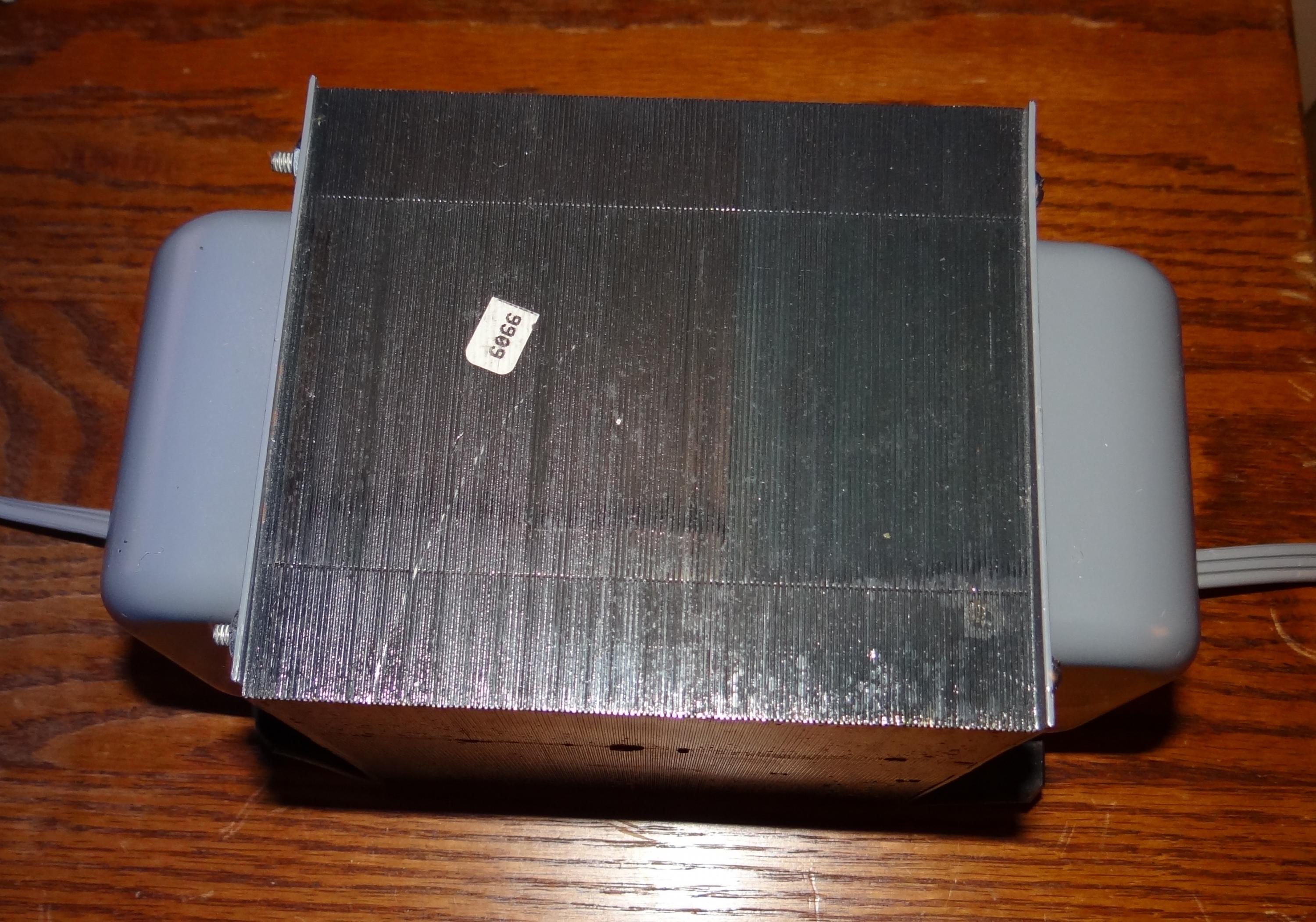

                If I remember correctly, I paid under $100 on eBay for my Stancor iso transformer. It's rated at 1300VA.
