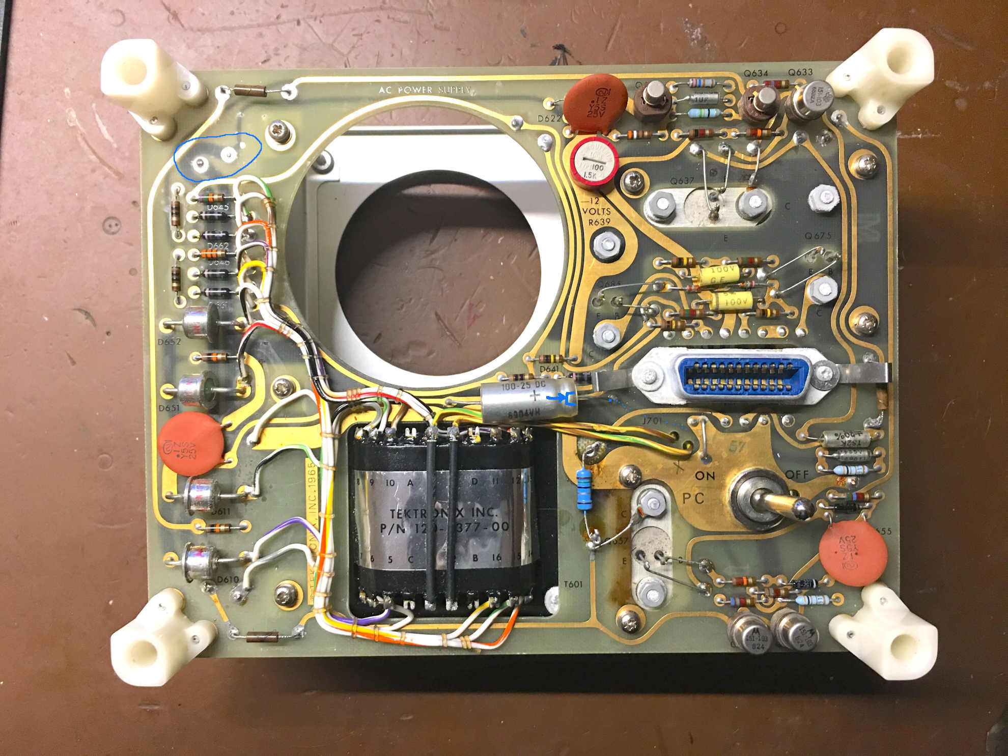

    Picked up a Tektronix type 422 oscilloscope locally for a few bucks last year.
    It wouldnt power on at all so I stowed it away under my bench for later testing.
    Today I remembered it was down there and pulled it out to see what was what.
    I checked for continuity and everything checked out.
    There was a burned smell and a resistor was replaced with a temporary replacement (see yellow box in picture).
    The burned smell is very pungent/acidic and I am not familiar with these vintage electronics to know whether I am smelling the remains of the replaced resistor or something else.
    From my google search I learned this power supply has safety mechanism to prevent it from being turned on without a load. I wanted to hold off on bypassing anything before I did more spot checks and got some advice.
    I turned my attention to the transformer. The smell was just lingering and I though it might be from the transformer.
    First I tested the primary coils in circuit (see pink arrows in picture) with my Anateck Blue Rink Tester. First time I am using it so I am no expert but from the readings the transformer is reading as bad/shorted.
    Again I don't have much experience with this tester and Im not sure what a good transformer of this age/type should read but if it is bad what might my options be?
    The thermal cutout (red circle) isnt reading continuity on the leads and that's a problem for sure but I dont have a replacement and dont want to bypass it incase whatever caused to to die is still present on the power supply.
    Is there anything else you guys suggest I try or look at?
    Bypassing the no-load safety would involve injecting voltage directly to the primary of the transformer and reading the voltages on the secondary.
    Not sure what bad could happen to the unit by bypassing the thermal cutout either. It would be inaccessible while I have the power supply back on the scope so wouldnt be able to keep an eye on anything while I was powering the unit up.
    While this is common I am not to excited about such an undertaking bcos of this unit's age.
    Any tips or advice would be greatly appreciated!

    Okay I went ahead and bypassed the thermal cutoff/fuse and the unit powered on.
    I figured with the power supply out of the case the temperature of the unit couldnt rise fast enough for me not to notice it.
    The cutoff likely failed due to age and stress.

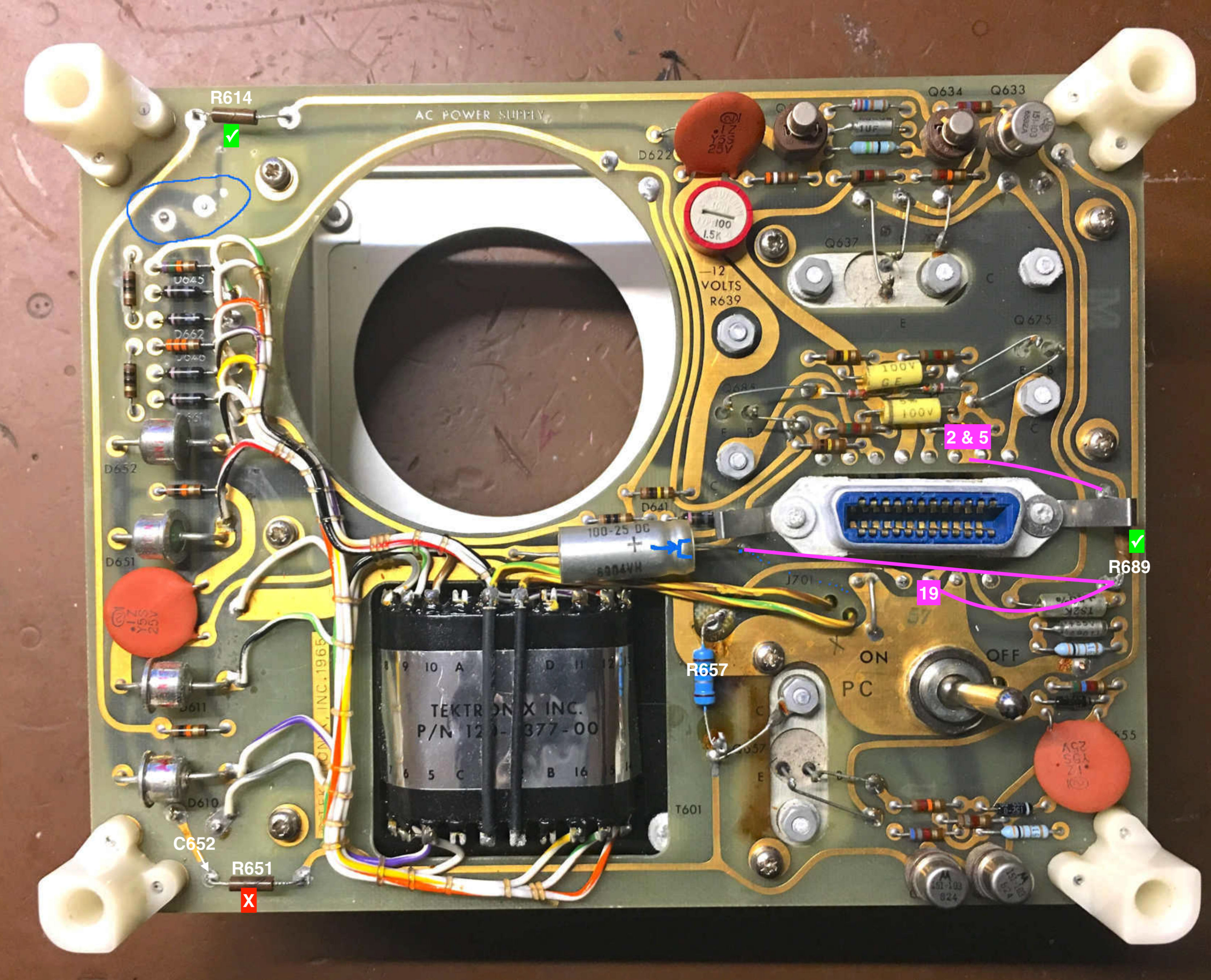

      Red circle... to me that's not a thermal cutoff, it's a TO-66 packaged power transistor! Like Q637. Proof is the high value base drive resistors that also connect to it, and three connections.
      The electrolytic and tantalum capacitors need to be checked, they are pretty old. 1969 was a while ago. I wouldn't blame the transformer quite yet.

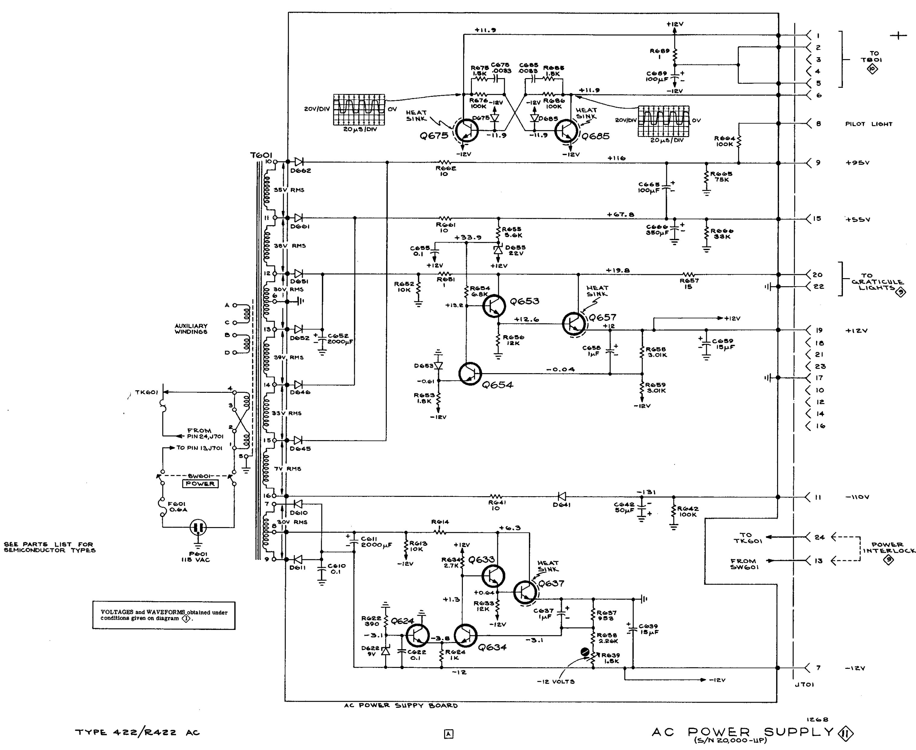

        Specific to the AC supply is https://w140.com/tekwiki/wiki/File:Tek_422_acps.png
        The schematics for this unit can be found on its tekwiki page:
        https://w140.com/tekwiki/wiki/422
        You are definitely right that the caps (and even diodes) need to be checked and i hope to do that today.

          q657 supplies the +12v
          • redwire
            • Dec 2010
            • 3907

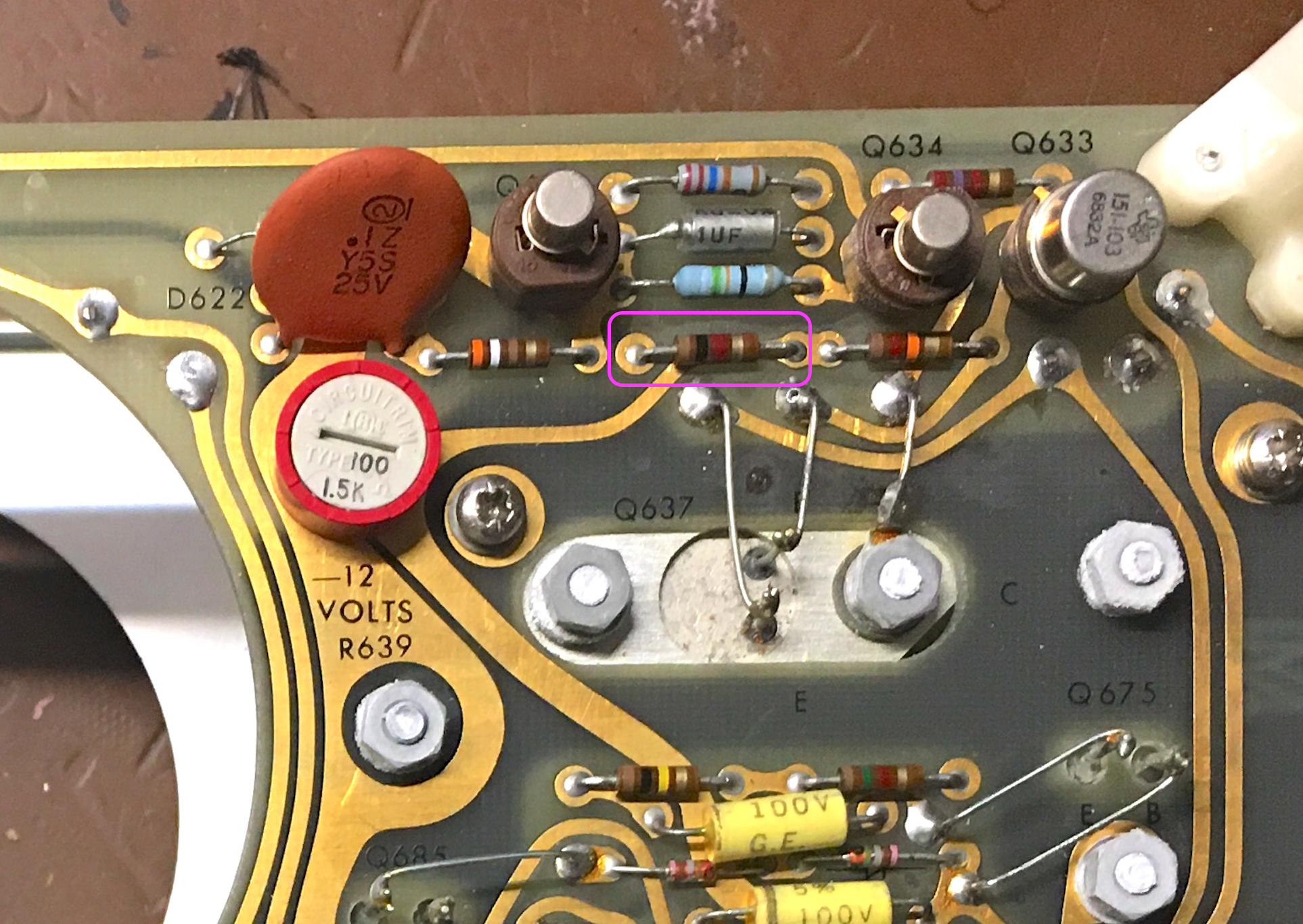

            Someone has replaced the R657 15Ω resistor for the graticule lamps. The lamps must have shorted out to GND, which would overload the 12V rail and make mucho smoko.
            Problem is the +12V regulator depends on the -12V and +55V rails. So those have to be working first.
            I would be using a variac to power it up and troubleshoot the power supply BUT with the HV DC-DC converter disabled so it does not roast trying to start - lift a leg on R689 1Ω which feeds Q675/Q685, also check those two transistors.
            Or maybe a dim bulb to power it (with HV DC-DC disabled).
            At this age I would suspect the electrolytic capacitors, the transistor sockets can also make a bad connection.
            Older Tektronix is a challenge to troubleshoot and repair. Try to have fun and learn lots.

              redwire Forgive me but I do not see a 1Ω resistor (R689) anywhere on the board. Would you lend me an assist and point it out? Ive been going mad looking for it.
              I did some spot checking of components last night and just about everything checked out.
              The capacitance/ESR of the Large Caps were as follows:
              C689 - 113µF/0.28Ω
              C652 - 2482µF/0.08Ω
              C611 - 2616µF/0.08Ω
              C642 - 55µF/0.55Ω
              C665 - 111µF/0.68Ω
              C666 - 376µF/0.12Ω
              I checked most of the resistors and found only 1 which may have off a bit (1KΩ which i believe is R624) but when I lifted the left to check it out of circuit it broke.
              I didn't use much for when pulling the leg so i think it may have been physically damaged.
              I checked the power transistors (Q657, Q685, Q675, Q637) and they all checked out as good. Although Q637 (right below the dodgy 1KΩ resistor) wouldnt register with my meter until I took it out of circuit.
              I would have to bridge the safety interlock (pins 13 & 24) to get the PS to turn on without the indicator unit attached.
              There is simply no way or room to do any troubleshooting with it attached as its sandwiched together.
              I dont have a variac (yet) but I am familiar with a light bulb as a current limiter if this is what you mean by "dim bulb".​

                OK so how I would approach fixing this PSU is to first disable the HV DC-DC converter driving T801 which connects at P701/J701. Disconnect power to it by lifting a leg on the 1Ω resistor R689, connects to 100uF cap C689. But where is this resistor, clearly stolen. Or on the other side of the board? It might have smoked and somebody cut it out. I would follow the (+) of C689 100uF cap to the 1Ω resistor. C689 surely dead dried out.
                I wonder if that is the brown things on the board edge that look like a wirewound inductor (super fragile! leave them alone they will crack in two) There's other 1Ω resistors I can't find like R614, R615, R651 to see what they look like.
                OR can you power up the PSU board with J701 (rest of scope circuits) disconnected? It looks possible? But mains safety interlock is there. Hmmm. Tek did not want this or something.
                Just to confirm the +12V, -12V, +55V, -110V, +95V rails are working, hopefully using a variac because the rails will all be high due to no load, and we don't want caps going bang. Only the +12V, -12V are regulated.
                Only power it up with a lightbulb and fuse present on incoming mains.
                See pic, is something missing there or parts on other side?

                        Schematic shows three 1Ω resistors but did not see them on the board. I would say Tek used these small phenolic-body inductors instead. Didn't have ferrite beads back then. For filtering RF.
                        The inductor windings appear on the outside body I think and look like a bump or crack but it's magnet wire. They are too fragile to take out I would leave them alone.
                        Another way to disable the HV DC-DC is short the E-B junction of both transistors Q675, Q685 to keep them off.
                        You can also just test all semi's on the board using Diode-Test with a multimeter, it's a couple minute's work and saves troubleshooting time.

                          Firstly, I already tested C689 (along with all the other major caps) and it is surprisingly okay (cap=113µF; ESR=0.28Ω)
                          Taking petehall347's cue I went and checked out these brown things and 2 of them read 1.2Ω.
                          The other one (R651 on the bottom left of the board) is dead (reading -4.3 MΩ and fluctuating).
                          Cosmetically it looks in better shape than the other 2.
                          Thank you Pete for dropping me that bread crumb.
                          These are the only unidentified component that are present in a quantity of 3 and the fact that the 2 good ones read within tolerance (20%) of the 1Ω we are looking for.
                          I verified this by tracing the PCB track from the C689 to the mystery component and I got continuity. That 'resistor' (R689) is reading as good.

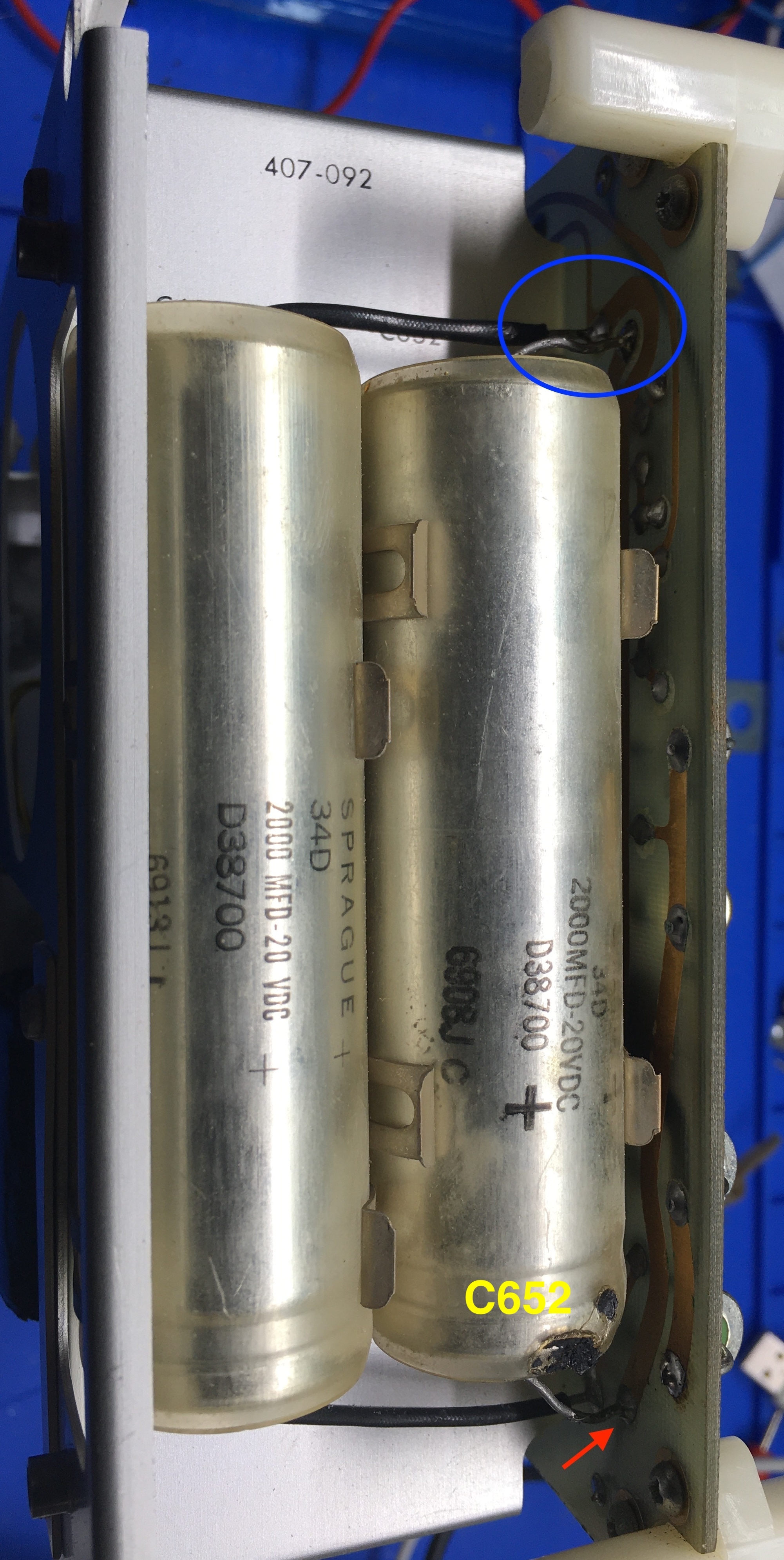

                          The spot which you circled in blue is where one end of some filter caps (C611, C652) are soldered to from the other side.
                          The other end of C652 connect directly to the blown brown resistor/inductor (R651). R651 leads directly to the blown 15Ω resistor (R657) that was replaced by the previous owner.
                          Since R651 is toast I think there is no harm (no choice really) in replacing it with a new/contemporary resistor as was done with R657. I have read about replacing old components with new ones in these vintage machines and how it throws things like calibration out of whack but I think that maybe more relevant to the indicator unit than the power supply side.
                          Shorting Q657 was how I got the PSU to show signs of life (back when I thought it was a thermal cutout Im ashamed to say!).
                          Dont have a variac (yet) so I'd have to hold off on that part of the testing. Will see if I can find one locally and proceed as recommended.
                          Thank you guys very much. Learning a lot here. Old time board are a lot different than the new ones of today. Takes a bit of getting used to!

                              Your sequence of events does not make sense
                              If R651 was open circuit, shorting Q657 would do nothing - there is no +19.8V rail feeding it with the resistor open.
                              Anyway, check Q653, Q654, Q657 because we don't want the +12V reg malfunctioning and giving the scope 20V or something.
                              For a R651 replacement I would put in a 1Ω 1/4-1/2W resistor with ferrite bead on the leads if possible. Ideally fusible resistor because it seemed to do that job here.
                              Or use a small inductor of a few uH and 1Ω DC resistance.
