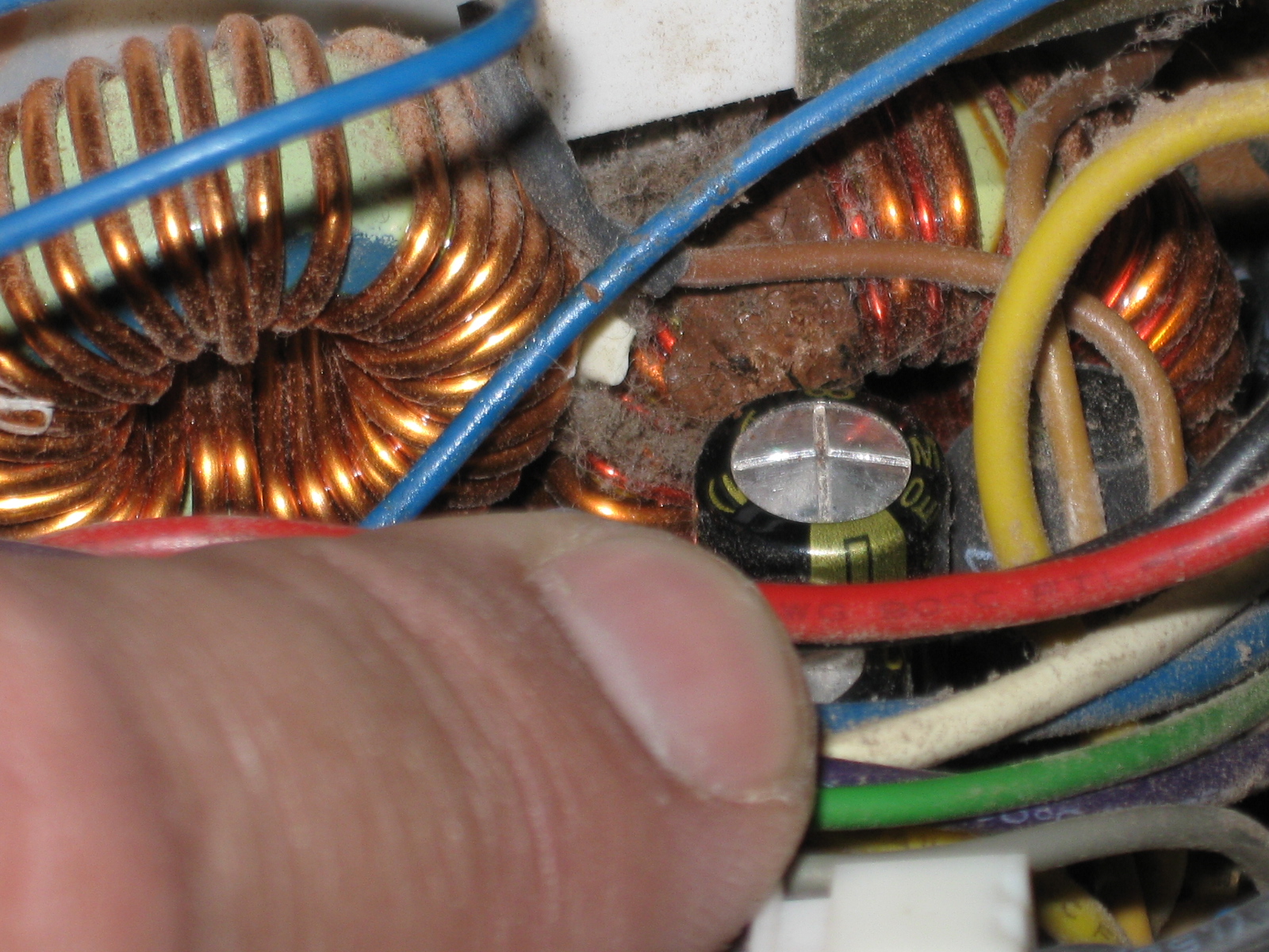

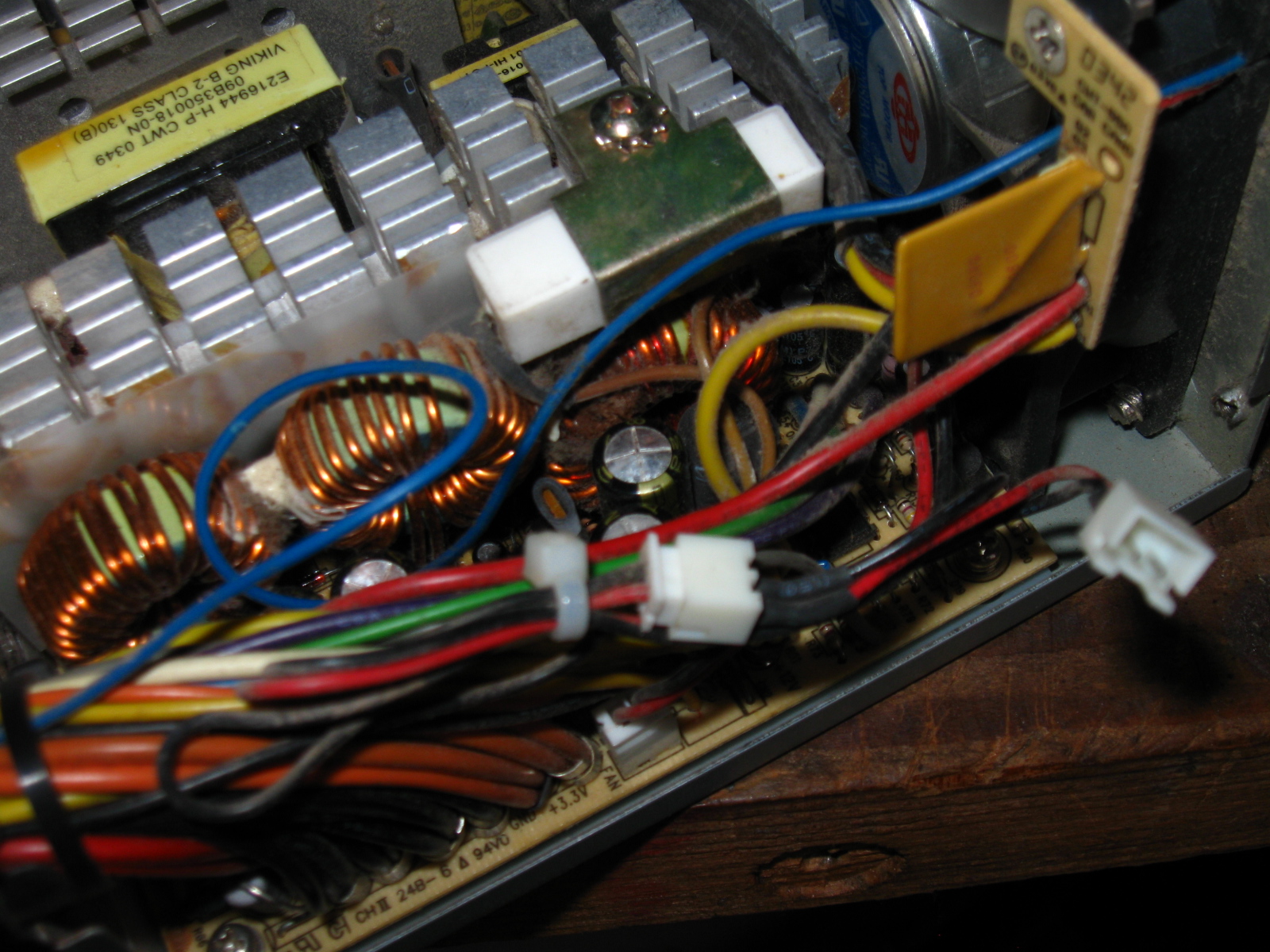

                    That's why I replace those dodgy capacitors because I can't afford an All-Star-U-Beaut-Top-Of-The-Range PSU... wish I could but them's the breaks eh?
                    Thought I'd pop in to mention that this PSU is still running flawlessly powering a new (slightly updated) system, on it's second or third system build

                        Nah... them's theoretical 100% maximum loading watts, that calculator is only meant to be used as a reference guide

                          Just a quick update, PSU and s754 system still running without issue well after industry dictated obsolescence... it's been 8 years since the initial recap with Samxon Capacitors was carried out.

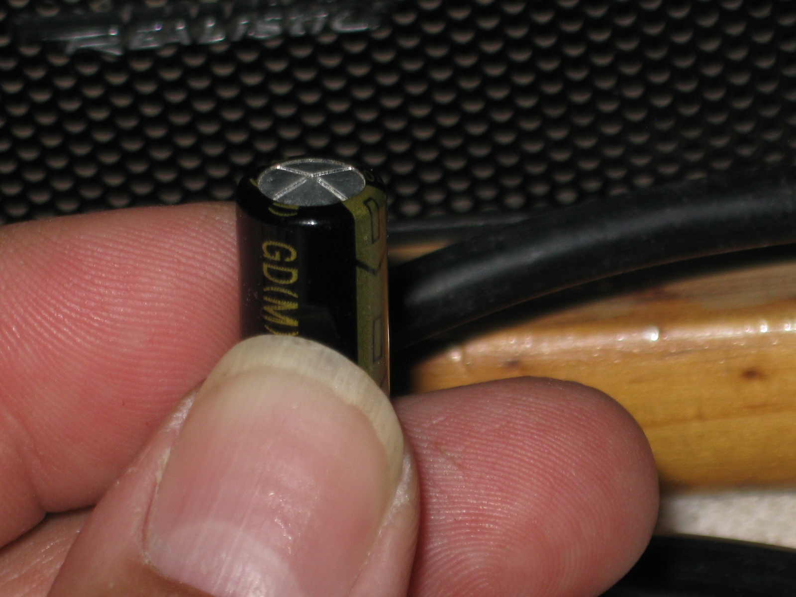

                                That is pretty good isn't it? the low air flow can be an issue as we live in a pretty hot part of the country and experience high 30 and low 40's (Celsius) each summer, unfortunately something obstructed the fan on this unit and it began making some odd noise, on disassembly it was nothing more than a stray wire which required a replacement cable tie.
                                I inspected the capacitors whilst blowing 8 years of dust out and noted the 2200uF 16v had a misshapen top (as seen below), a 5 minute fix and all was well although the capacitor hadn't become flaky at this point...
