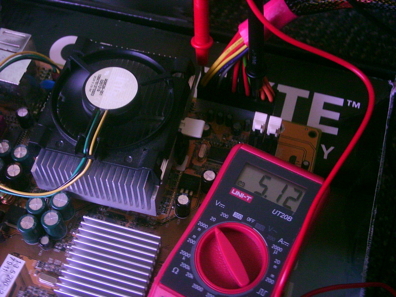

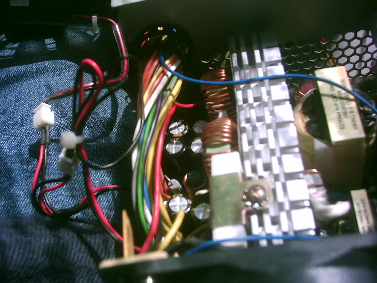

    I've had this PSU for a little while, and it's been in my 'to do' pile for most of my ownership... originally it was purchased in 2004, but came to me via 'flea-bay' and was causing system instability almost straight away (to my dismay), a quick dismantle confirmed the 'crap caps' diagnosis... so off (as I said) it went into my 'to do' pile
    Thankfully with assistance I was able to source some suitable replacement components with far improved specifications when directly compared with the original 'offensive' Fuhjyuu's (see below)
    One of this PSU's most obvious issues, other than the 'slightly domed' fuhjyyu's was the low 5v line which was only producing 4.8~4.9v, thankfully now (since recapping) that is a healthy 5.12v

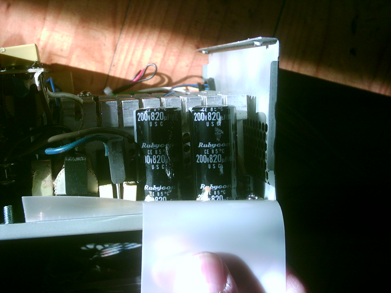

    I'm glad to say that at least Antec used Rubycon's on thier PSU input, though I don't know why they didn't bother to use them consistantly thoughout the PSU circuit
    Replacement capacitors
    4 x 3300uF 6.3v GC Low ESR Series(10x25mm) 0.009 Ω @ 100khz
    2 x 2200uF 16v GD Low ESR series (10x25mm) 0.012 Ω @ 100Khz
    2 x 1000uF 10v GC Low ESR series (8x20mm) 0.012 Ω @ 100Khz

        Re: Antec TruePower380 & the Fuhjyyu Syndrome
        Are those Fuhjyuus you removed leaking electrolyte? They don't look domed, and the stuff on them looks more like glue than electrolyte. I know some PSU manufacturers pour loads of glue onto the components to minimise vibration, but I don't know about this...
          Taz
          Great result. 5.12V.
          I am now very glad that I replaced the Fuhjyyu caps in the new expensive system I just built for someone. I did not want to risk an Intel 975 chip set motherboard system. Even if PS warranty may now be excluded.
            No it's not electrolyte (just glue) they didn't get to the venting stage of death, and granted you're quite correct the 4 capacitors in the foreground of the shot were not visually damaged at all, however the (remaining) 4 3300uF caps were ever so slightly domed at the top (hence I used the term slightly domed), though this picture is not a good illustration of said defect
