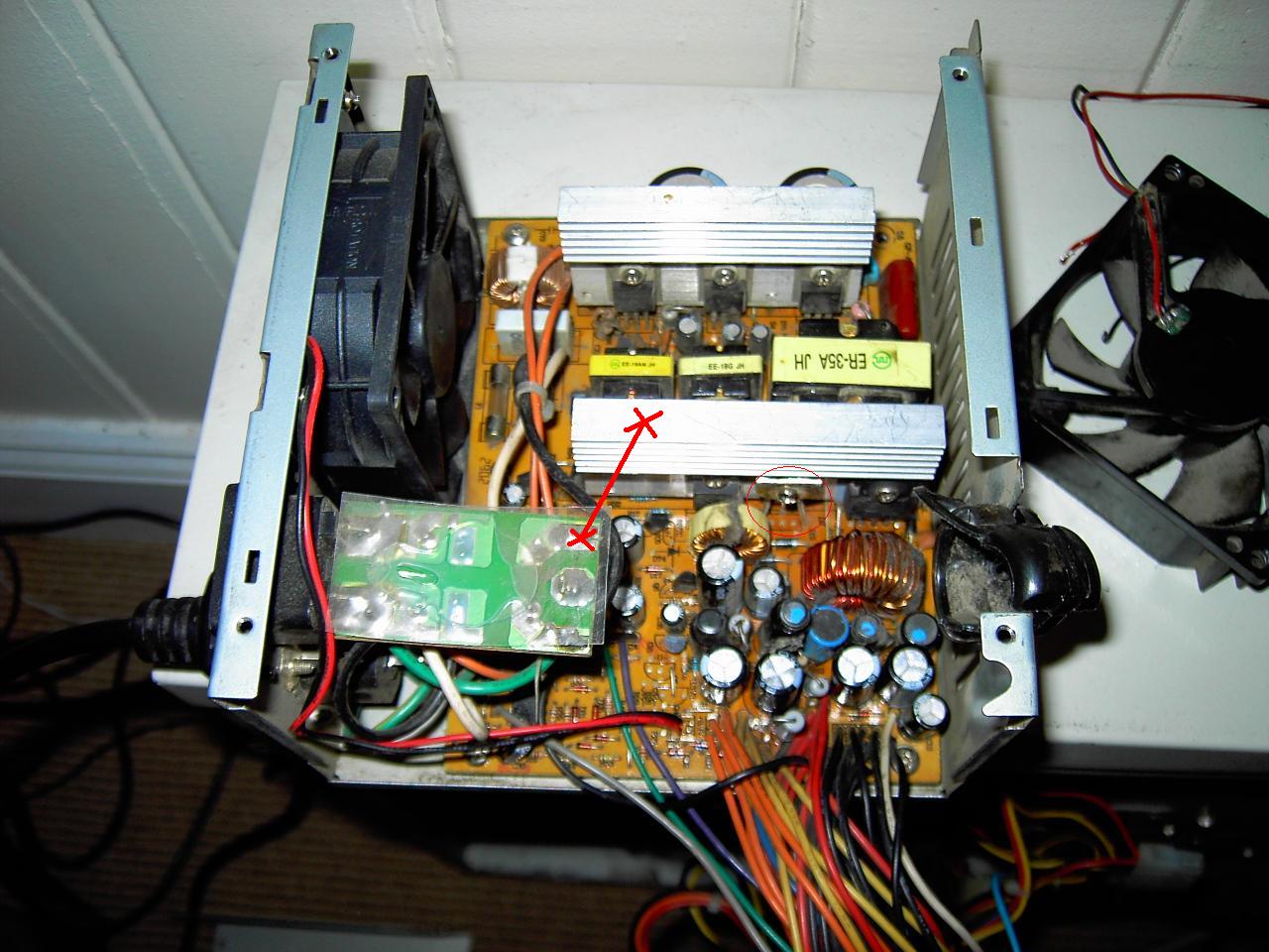

            thanks Pete, my mobo is an ASUS A7N8X-X, the PSU is a AGUILER 400W. But now i have gone and done something incredibly stupid and managed to blow something else up, i was adding a heatsink (to the lower one in the pictures) with thermal adhesive cos the one in there looked a little small and got very hot . So all was good till i though "hhmm thats ended up quite close to the live terminal" and grabed the power cord to pull it out and adjust it all and its sliped outta my fingures, bounced back, touched the mains live wire to the heatsink and BANG tripped all my electric off, unfortunatly it has also made my PSU not want to turn on, i have power on the 5VSB and green "on" wire but it just dont want to swith on. i am just wondering what cuircuits might have blown? i have attached some pics of the supply.
            i am going to go buy another tomorrow but i still want to fix this one
            i have marked with an x and a red line the 2 bits that touched and circled in red the only component thats is connected to the heatsink, i am so pissed at myself for this lol also to the left of that is the rectifier i put in.
            so what id like to know is if there is anything in pareticular to check and replace or have i basically screwed lots of stuff up now? i cant find anything burned anywhere, only the wire welded itself to the heasink and the pins the the socket at the back welded a bit too, i can hardly pull the cord outta the back now!
            so yeah any help apreciated i really need it lol
            Will
            EDIT: it looks very hard for the 2 things ive marked to touch hehe but the heasink i glued on top came very close to the marked bit on green board, i took it off so i could look for burned stuff

                    Re: Help with a blow MOSPEC
                    As Pete and Japyltic have pointed, these are one of the Deer/L&C family of supplies - probably an earlier generation. They're usually not worth fixing, except if they're still functional but flaky. That one is definitely not 400W, but more likely close to 150W-200W.
                    That said, they can still be put to non-critical use - here are the things to look out for:
                    1. If the +5Vsb is good, but the PSU fails to power on, then it's most probably a bad secondary rectifier - either the one on the +12v rail and/or the +5v rail.
                    2. Earlier Deers did not have a third rectifier on +3.3v - that was derived from +5v by dropping 1.7v using a MOSFET linear regulator. Check that MOSFET to see if it has a drain/source short. This is mounted on the same secondary heatsink as the two rectifiers.
                    3. I had posted some upgrades to Deer/L&C supplies in another thread - one of the upgrades is to beef up the secondary rectifiers. For +5v and +3.3v, you can use a SBL2045 or a 3045 (if it physically fits). For +12v, SBL1040 should be OK.
                    4. Paralleling Schottky rectifiers will not be very effective in doubling their current rating unless they're exactly matched, from the same die. To do this, you have to use a pair from a single package on each leg; that's too messy to mount on a PSU PCB. At any rate, why bother? 20A and 30A-rated Schottky rectifiers cost less than $1 each.
                    5. Replace all secondary caps with long-life low-ESR non-aqueous caps like the Nichicon PW-series.

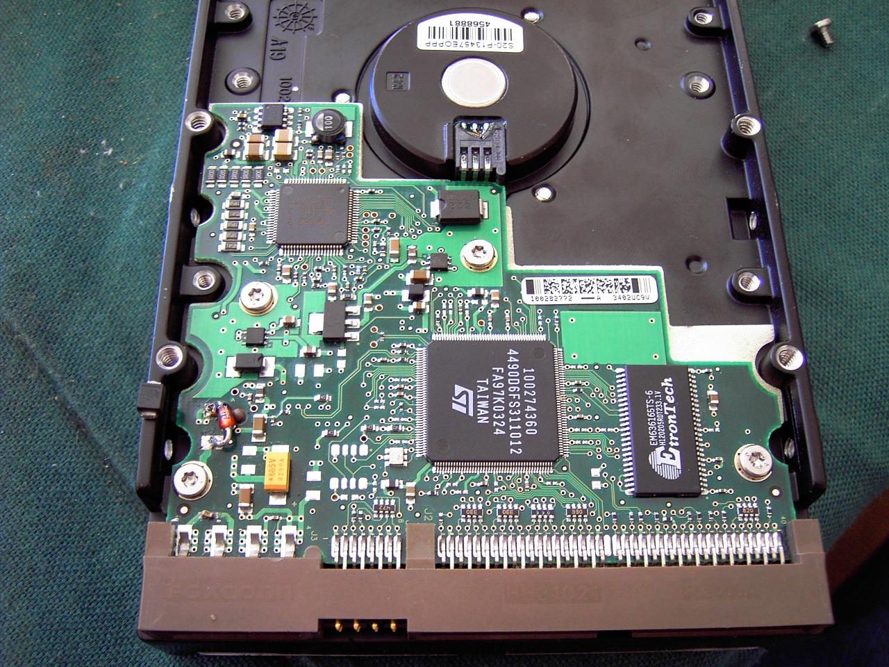

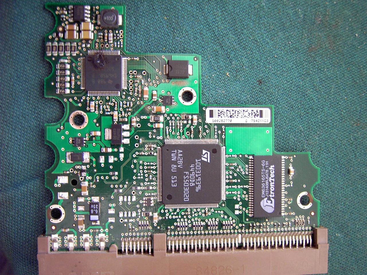

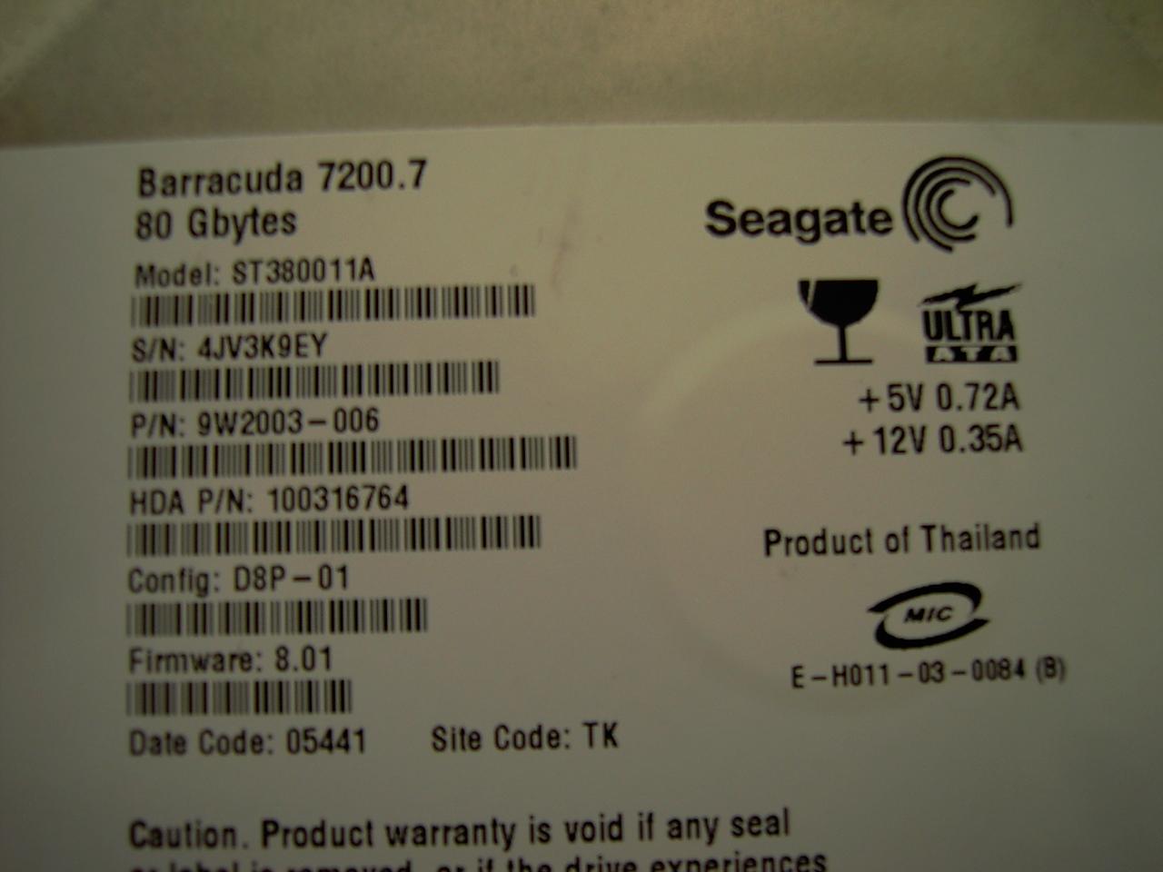

                          Thnaks for all your replies! some very helpfull posts here i have had to put the supply on the shelf for a few days becauswe i went and bough a better one on monday (a Skyhawk SH480A8H, dunno how much better but it definatly has much bigger heatsinks) and plugged it in and oh god! my pc wouldnt power on, some quick fiddling revealed that i couldnt power on with either of my hdds plugged in... my damn power supply had grounded through my hdd's!
                          I was very pissed at this and pulled em out and after a bit of testing managed to figure out it was only the 12v line that had grounded and only through a small diode on the hdd (bottom left of pic), soo i replaced the diodes with some equivalents and my 40Gb Hdd span into life whereas my 80Gb burst into flames! lol must have been somin else wrong.
                          So i am realy pissed now lol why couldnt it be the other way round? so anyway i took the curcuit board of the 40Gb and fitted it to the 80gb just to see if i could acces all my critical stuff and it worked! the drive makes some horrible clicking and screeching noises but otherwise still runs at full speed and without data corruption, so i managed to recover everything!
                          but anyway i was hoping that maybe someone has a logic board similar to my fried one from a 80Gb Seagate drive? the fact that my 40Gb board worked on the 80Gb platter leads me to believe they are all very similar and just detect what platter they are connected to (probably/hopefully 99% backwards compatible?) Its not essential as drives r pretty cheap these days and ive recovered all my stuff but if someones got a broken one lying around ill give ya some cash for the board off it just let me know!
                          so now that my drive problems are pretty much over ill be getting back to trying to fix the PSU hehe. hope someone finds this stuff usefull!
                          1st pic fixed 40Gb, 2nd burned 80Gb logic board (top left chip) and 3rd is my drive info.
                            if you got your data back just rma the drive.
                            seagates have a 5 year warrenty.i use the online rma and am ready to ship it in about 5 minutes.
                            i also keep the bad ones that are oem for parts to recover data like you just did.never know when you need a headstack or pcb.
                            • Per Hansson
                              • Jul 2005
                              • 5895
                              • Sweden
                              Yea, what kc8adu said...
                              And also be very happy that you where able to recover the data, I take it since you are looking for the "correct" PCB for it that you want to continue using it longitme, I would not recommend that
                              Because the firmware contains the list of bad sectors that is specific to that drive only, plus some other misc "individual" stuff...
                              So congrats on recovering the data but now RMA the drive or retire it, do not trust it with any new data...
