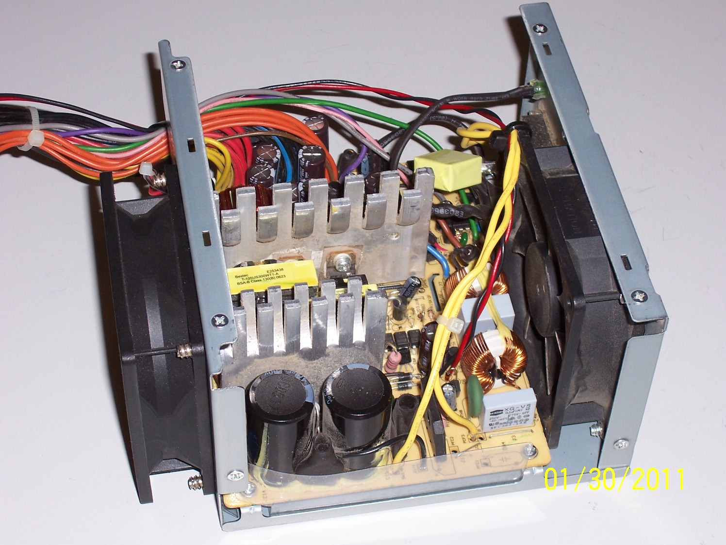

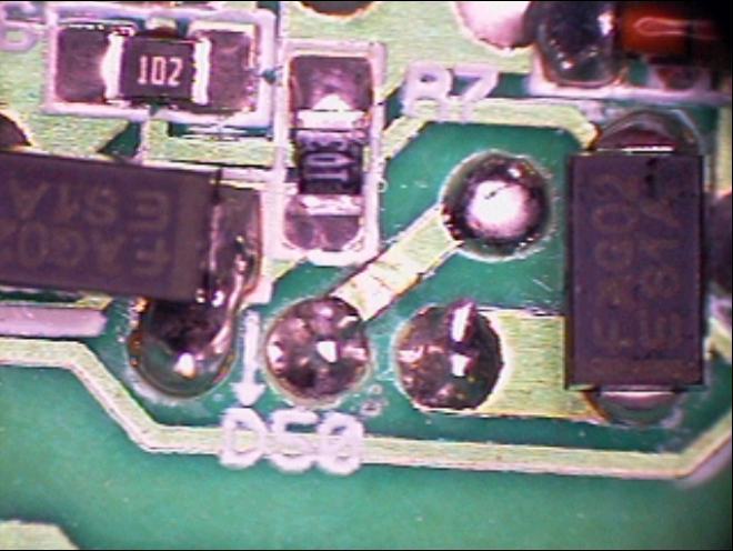

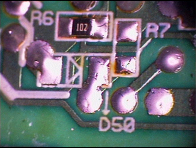

How off are we talking about? You said in the other thread that you were "not fully satisfied". Was it at least within spec? I imagine that the final 5V and 12V output also changed a bit when you swap the stock caps. I thought PFC was supposed to take care of all of this?
This is a mod I had long since contemplated for my XBox... RBJTech posted an incomplete schematic to his (now defunct) site which no one ever got working. That was waaaay over my head back then and I doubt I could figure out how to do that now. I'm still trying to figure out how to implement your DM311 standby circuit to some PSUs.
Did you ever trace which caps were for which rails (Pi filters on the secndary)? Would be nice to know what's 3.3, 5, 12 so that I can have more flexibility when choosing replacements and fiddling with pi filter pairs. I've done this with my FSPs.
Thanks for all your help.
Also.....if you like to tweak.......add a 5vsb fan circuit such that when power supply is off but plugged into wall outlet, the 5vsb fan comes on and keeps everything nice and cool. Then when you turn the computer on, the 5vsb fan goes off and the main fan comes on.
