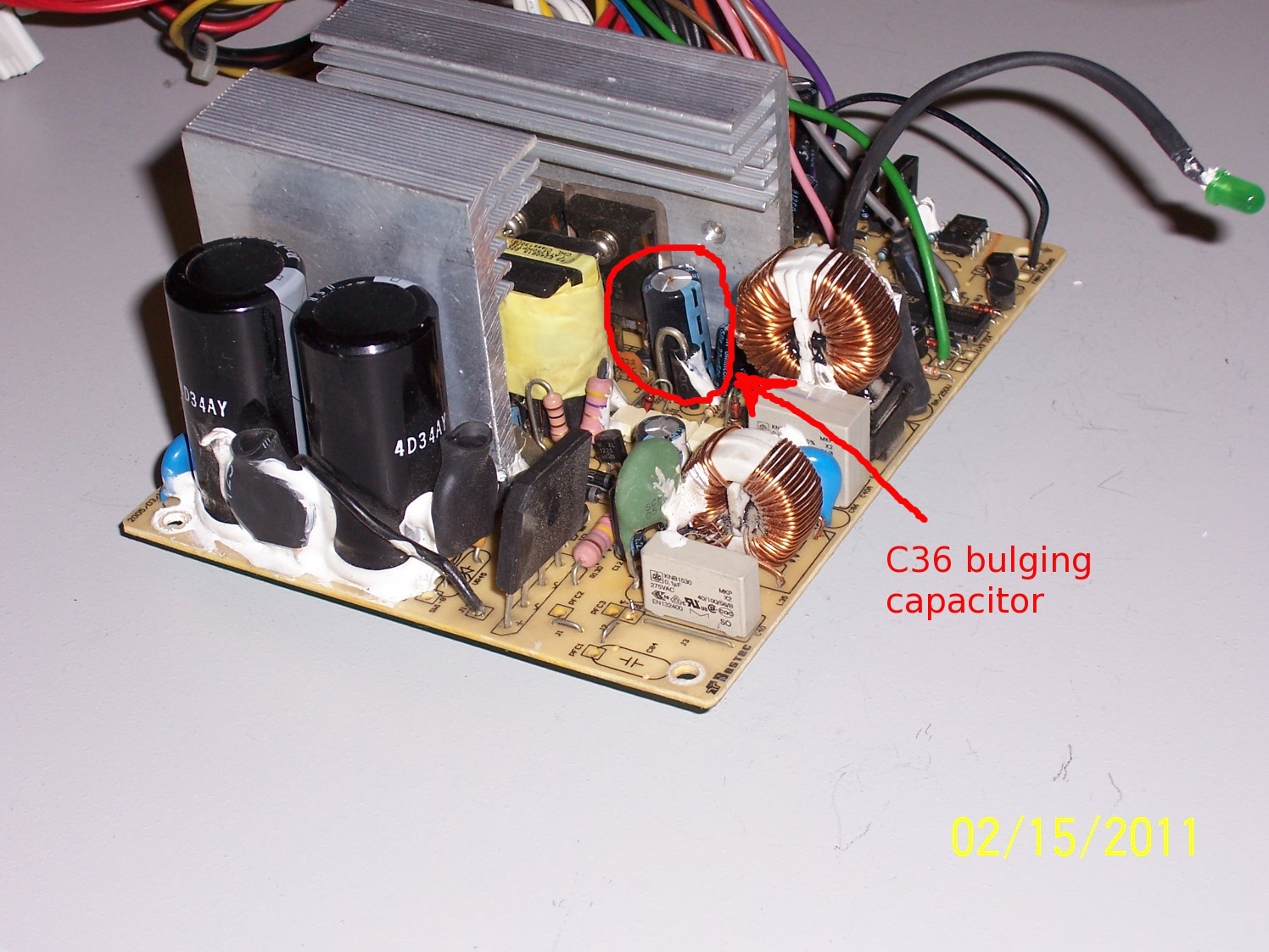

                    The Bestec ATX-300-12EB3 is a more current version of the Bestec line. It has two 12 volt 18 amp overcurrent protected rails. Very good for newer design computers which are more heavy on the 12 volts. A good one to fix and use. Does it work at all?
                    A common problem on this power supply is bulging (or bad) capacitor at location C36 due to heat. It is located next to the heat sink and probably doesn't get much air circulation. Check your power supply for bulging cap at C36.

                      Regarding the cap C36 near the diode that gets very hot. I've looked at an image you uploaded in a previous thread where you showed where to move it to, I can't find a suitable place to move it to in my revision, as it's different than yours.

                        The A6351 chip is the 5vsb chip. To move C36 to the other side of the heat sink, here are pictures showing where to drill holes in the new location I used.

                            The capacitor for this location is 2200 uF/10 volts, a 6.3 volt will probably do but I prefer using a 10 volt cap. A 12 mm diameter cap should fit in either the original position or in the new position where I drilled new holes.

                                I've got a 16V 2200uF OST "RLS" series cap there (And it's not bloated. All the rest of the caps on the PSU are, this is one of the only ones that isn't). Thanks for the datasheet, I looked at that yesterday and I didn't see anything there about using it in a standby circuit like I usually see with 5VSB datasheets, that's why I asked.
                                Ok, I'll probably end up measuring it. Reason I'd prefer a 6.3V cap there is because I can get them for pennies on the dollar.

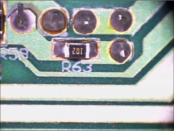

                                    I just practiced drilling a hole on an unneeded PCB, the size is perfect, so I'm going to attempt it on the 300-12Z.
                                    No, I still have to order caps for this thing, just taking care of all the preliminary stuff first.

                                      One thing I forgot to ask you... In a different thread, you mentioned a mod to tweak the 12v and 5v voltage with a trimpot. I looked up that model, it's $5+ at Digikey. Do you remember which value gave you optimal voltages so I can just swap the resistor?
                                      I'm almost done removing and cataloging the caps. I drilled the two holes, almost as nice and clean as the ones you made, could have been better if I could only find that set of dremel bits I have lying around somewhere.

                                        1. The resistor value will vary from one power supply to another. That is why I did the modification to replace that resistor with a 50K pot. Using fixed resistors is a hit/miss situation.
                                        2. The value needed will vary from one mother board to another. If you want to tweak the output voltages for a specific power supply mated to a specific mother board, the pot is the way to go. Do the mod, fire up the psu, and adjust the pot to set the voltages for what you want. Then you are done! No more hassle.
                                        Also.....if you like to tweak.......add a 5vsb fan circuit such that when power supply is off but plugged into wall outlet, the 5vsb fan comes on and keeps everything nice and cool. Then when you turn the computer on, the 5vsb fan goes off and the main fan comes on.
