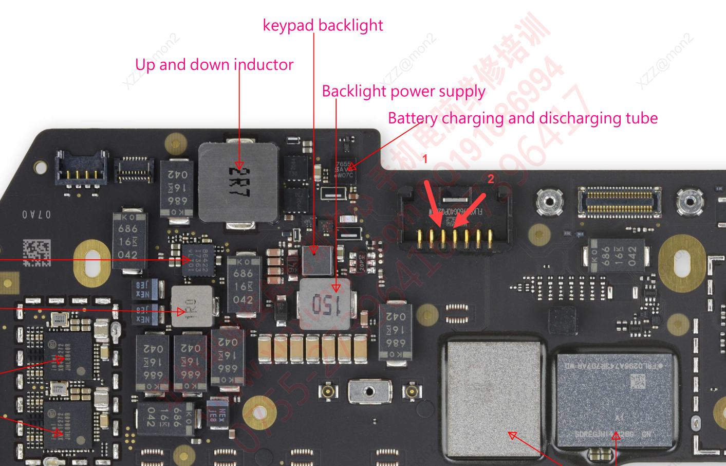

    Hi. No. The above is for the older macbook models. The A2337 is the pain in the arse, M1 design. This unit operates with USB power delivery. There are plenty of details of this model here and repairwiki, etc.
    Start with the using only a suitable rated power adapter. 100W with 100W rated power cable is recommended if the original power adapter is not available. Place a USB Type C meter (bidirectional type) in the middle of this power adapter and your logic board. This meter will tell you if the power delivery chips on the logic board are working or not. If you do not have 20V, this needs to be fixed from the start.
    Share if you have 20V and also the current draw showing on this USB type C meter. We can go from there.

        Ok. This confirms that each of your CD321x PD controllers are working since you have 20v negotiated with the external type C power adapter. Good.
        Carefully, measure the voltage to ground of PPBUS_AON @ fuse F5200. Check both sides of this fuse. This is a critical main power rail for the board. What is the voltage to ground? This is like the older PPBUS_G3H power rail.

            At 12v, the PPBUS_AON is not boosted to the normal ~13v level. This 13v level is selected using the I2C / SMBUS interface (SCL / SDA lines).
            Remove all power. Disconnect the battery @ J5150. Meter in resistance mode.
            Measure the resistance to ground of the SMBUS lines (SCL / SDA). One meter probe on the pin to test. Other probe to ground. What is the resistance?
            We are checking if either of the TVS diodes that mates with the SMBUS lines is defective or not. If yes, this can shunt the communication lines used by the ISL9240 buck boost regulator that is reporting to be at 12v and not 13v.

                No. Not necessary. If I recall correctly, some motherboards and perhaps this one, will only boot if there is a pre-charged battery mated with the board. You are in the valid range for PPBUS_AON.
                So what is wrong with this unit? Allow for the usual time to boot to login screen and then press the keycaps key. Do you see the caps key led toggle on/off after a keypress? If yes, the board is booting and you are the login screen.
                If not, carefully, measure the voltage to ground on each and every inductor on the board. Each inductor is linked to a local power supply rail that is taking the PPBUS_AON voltage and lowering it to another voltage (buck regulator design). Check if there are any low / zero volts on the inductors. Check against the schematics. If found, that rail is a suspect.
