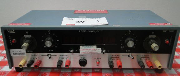

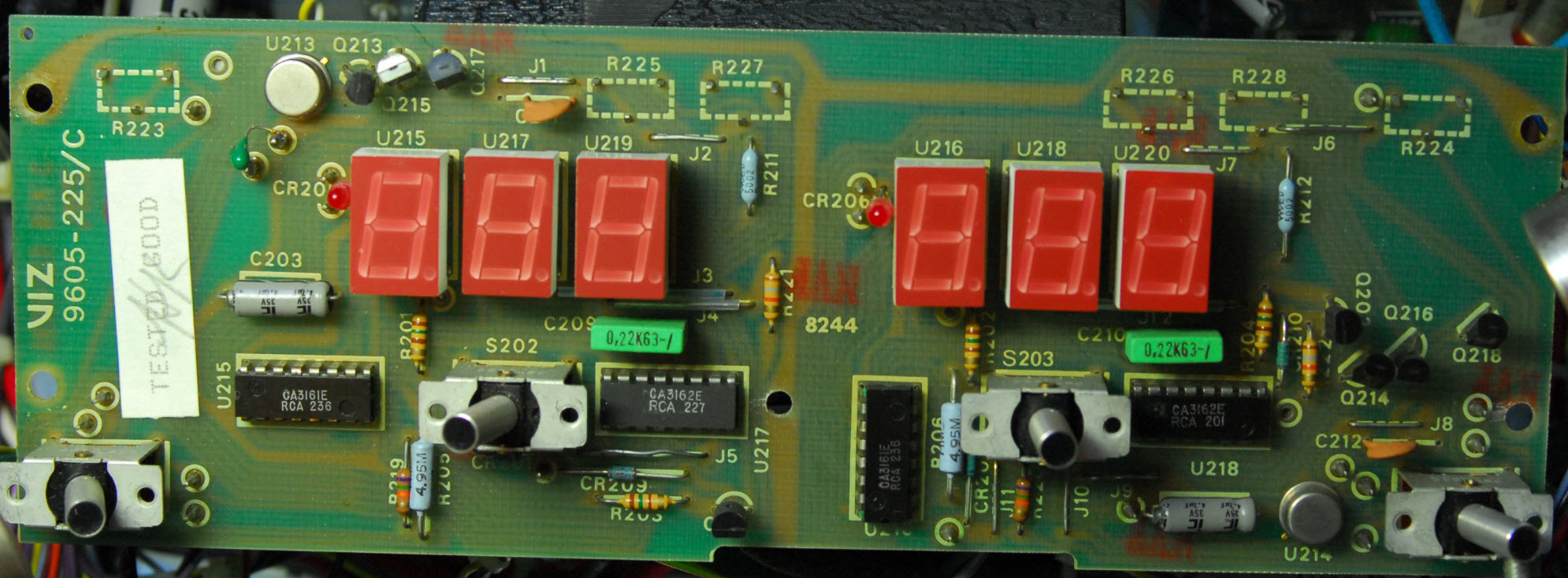

    I bought on ebay an old Viz Triple Supplyst WP708. It's a bench power supply that also has limited voltage/current measuring capabilities.
    It has 2 separate input/outputs, left & right. Everything on the right side works fine, the panel lights up, measures voltage & current correctly and the outputs are fine as well.
    The left side outputs fine but the display does not work. I cannot check if it also measures fine. All connections seem ok, nothing looks disconnected or obviously busted. I looked for service manuals etc. but could not find any.
    Any suggestions on how to troubleshoot? Where to start looking and suggestions on the likely culprit? Of course it would be great if someone had a manual.
    In the attachments a front view of the panel (found the pic as I had taken it apart already) and a view of the problem board.
    Thanks!
    Antonio

    Re: VIZ WP 708 Power Supply Issue
    I do own the original manual.
    It says for troubleshooting:
    Code:
    DISPLAY BOARD
    1. Blinking Display: Check power supply +5V. Check U215 thru U218.
    2. Improper readings: Check power supply +5V. Check regulator U213 and U214 for normal operation. Check voltages on U217/218.
    3. Won't Zero: Check voltages on U217/218. Check R227/228. Check +5V supply. Check C210/211.
    4. No display but power supply has output: Check power supply +5V. Check on-board regulators U213/214 for normal operation. Check continuity of all VCC paths to active chips.
    5. Unstable display: Check power supply +5V. Check all voltages on U217/218. Check capacitors C203/204 for opens or leakage. Check C211/212.
    6. Missing segments on displays: Check each display that exhibits a bad segment by replacement. If this does not correct the problem, checvk U215/216 for output conditions.
    7. Decimal point won't move. Check S202/203. Check CR201/202 and CR210/211. Check Q201/202. Check R221/222.
    If you need the part numbers that it tells you to check I can give you the list as needed as it's a full page.
        Since both displays are duplicated of each other, then you can start by doing voltage comparison reading of the voltages of the IC's, Transistors, etc.
