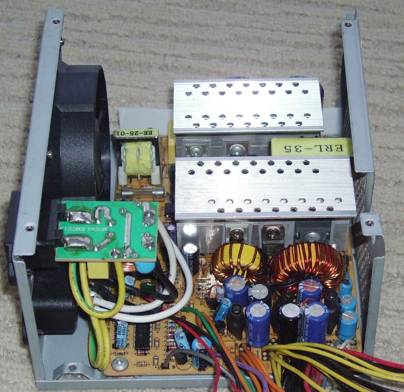

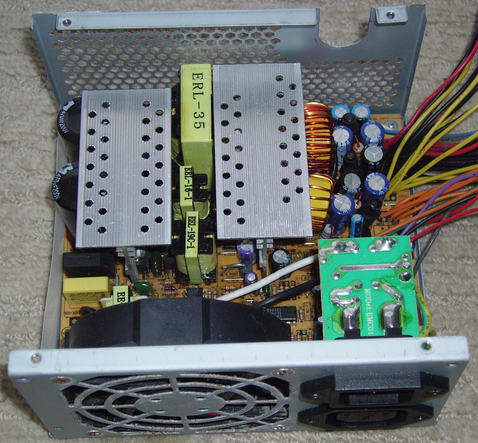

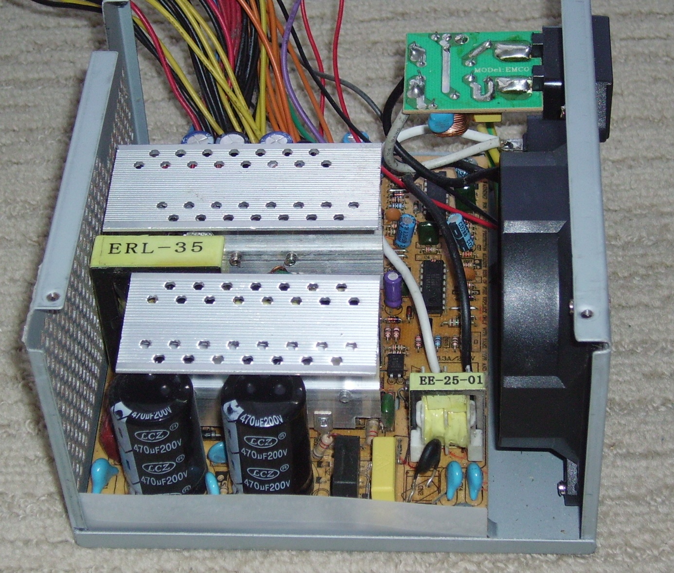

    Xsonic ZS-450W - If loose heatsink screws aren't bad enough
    As some of you may remember, CWT has a bit of a reputation with Oklahoma Wolf for loose heat sink screws. If that wasn't bad enough, I blew up an Xsonic SZ-450W PSU on my load tester this afternoon. It was rated for 450W, and it was under 350W load when the switchers exploded. After un-soldering the (rather thin) heat sink, I found that the switchers were really easy to wiggle around and I un-did the screws with nothing but my fingers, even though only 1 of the washers was melted (the one for the middle switcher), they were that loose. It was somewhat better on the secondary heat sink, but I could still wiggle rectifiers around. The PSU actually looks kind of beefy, but I decided not to fix it, since I have lots of other better ones like antecs to spend my time on.

    Re: Xsonic ZS-450W - If loose heatsink screws aren't bad enough
    CWT? Those heatsinks look like PowMax/Leadman to me
      I know it's not a CWT. I was just saying that this is a lot worse than their loose heatsink screws. I'm not actually sure who the OEM is. It does kinda look like a leadman, but there was no LP-xxxx model number on the PCB.
              What were the primary transistors, 13007's? If so, I wouldn't be surprised it blew at 350W.
              • c_hegge
                • Sep 2009
                • 5219
                Nope, China ATE D304X
                              That's a bit better than 13007's, but not by much.
                              What probably killed the PSU was the loose screws like you mentioned, though.
