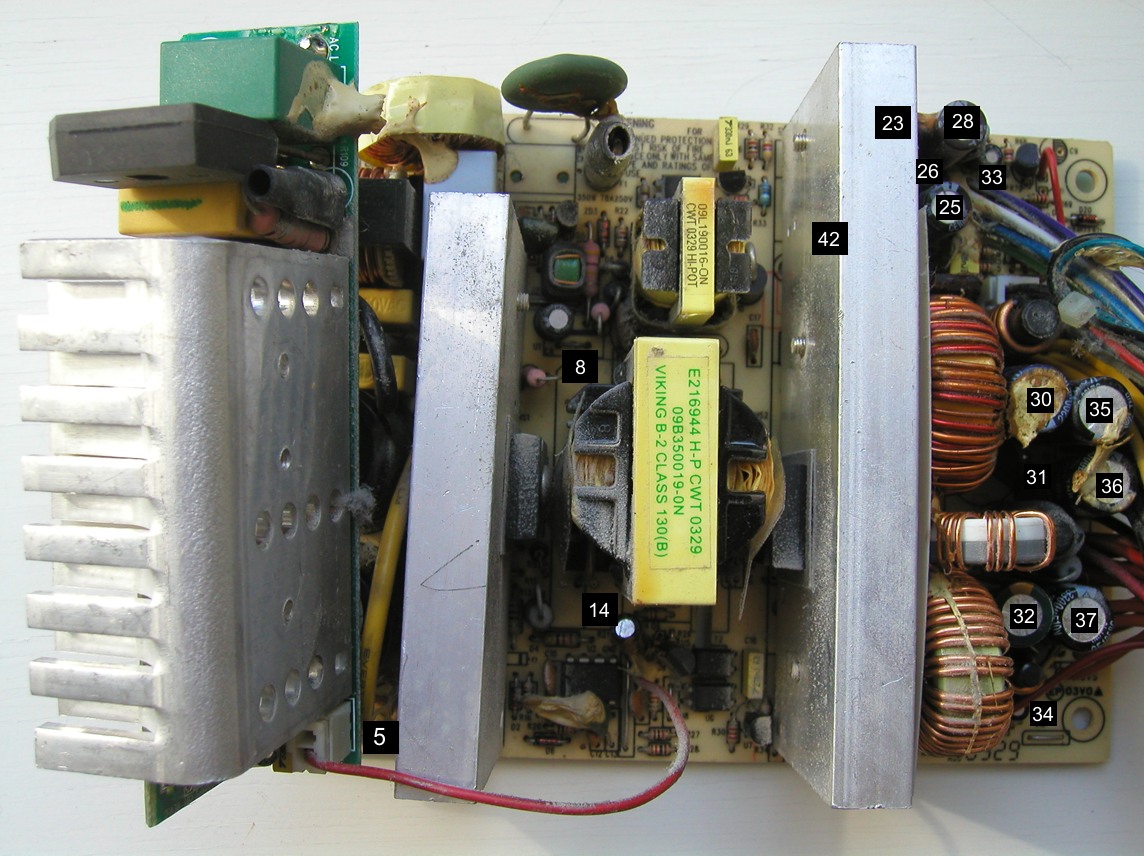

I decided to recap my SL350P after the computer started to crash very often, and I noticed that some caps on the mainboard were bulging (about this in a later thread). So I opened the PSU also, and it was full of Fuhjyyu's (Antec's favourite brand, it seems), with one capacitor already bloated.

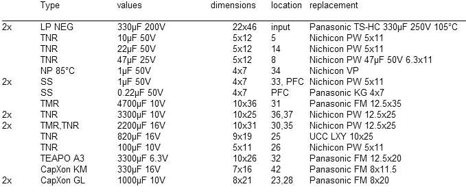

Here is the list of the capacitors I found and their planned replacements (sorry for the dirty solution of posting an image, it was easier with formatting):
Most of the capacitors are Fuhjyyu (I wrote only the type), and additionally a Teapo and two Capxons. I would like to replace all of them, just to be sure.
The two big capacitors will be replaced with Panasonics with a higher temperature and voltage rating.
The TNRs will be replaced by Nichicon PW series, as well as one TMR because its PW counterpart has anyway better specifications.
The TMR that bloated (4700uF/10V) will be replaced by a Panasonic FM, as will also the other 6.3/10/16 V capacitors.
There is one non-polar capacitor, rated for 85°C, whose silkscreen was actually for a polar. I have found a replacement also, but i don't know whether it's better to install a polar, but with 105°C rating.

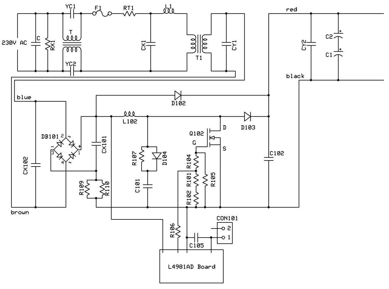

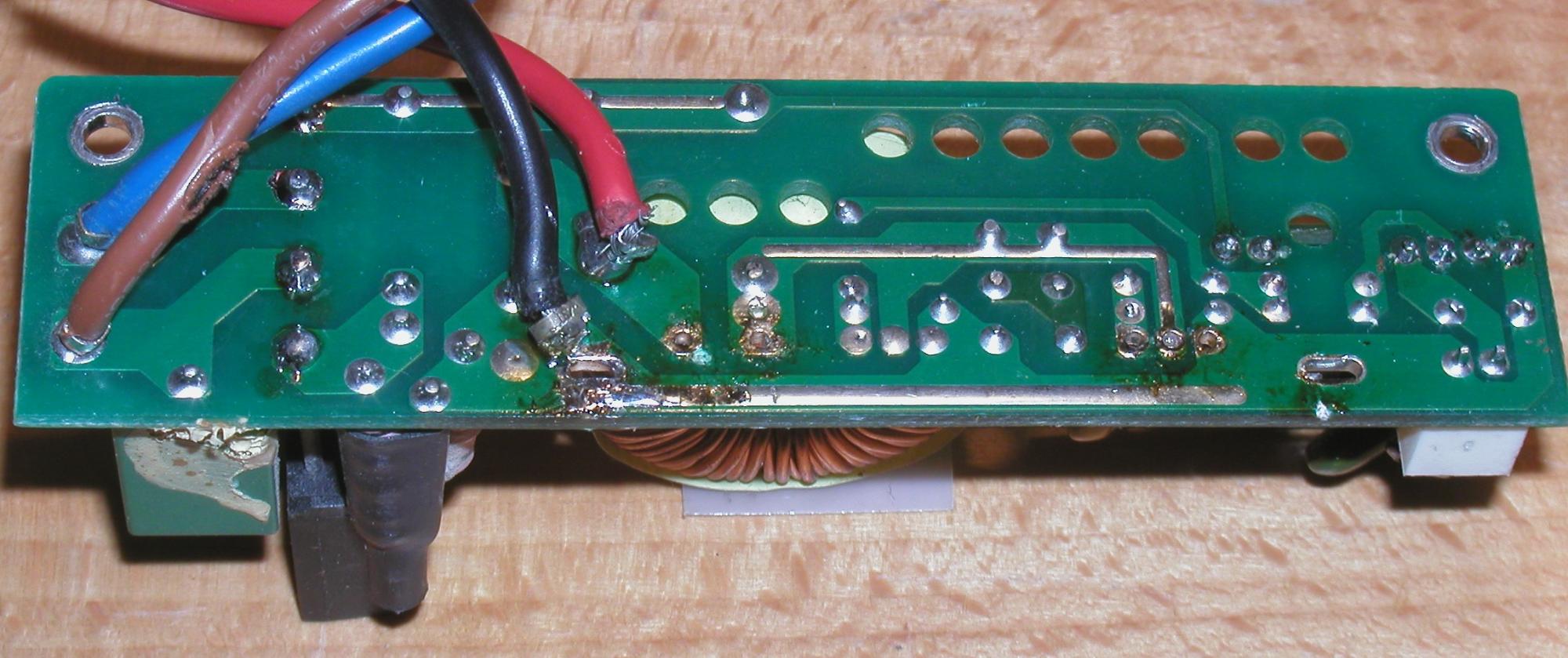

The capacitors at PFC positions are in a small PCB that is probably from the PFC circuit; it is installed atop the two input capacitors.
I want to order from digikey, as they have the best shipping costs (free above 65€).
Please have a look at this and tell me if there is anything wrong. I am especially unsura about the sizes of some replacements, bigger than the originals. Maybe instead of 10V I could go to 6.3V, or decrease the capacitance a bit? I know nothing about PSU design, so I need to rely on an expert's opinion. Anyway, the bloated 4700uF cap had anyway larger space around, so 2.5 mm more in diameter would cause no problems.
