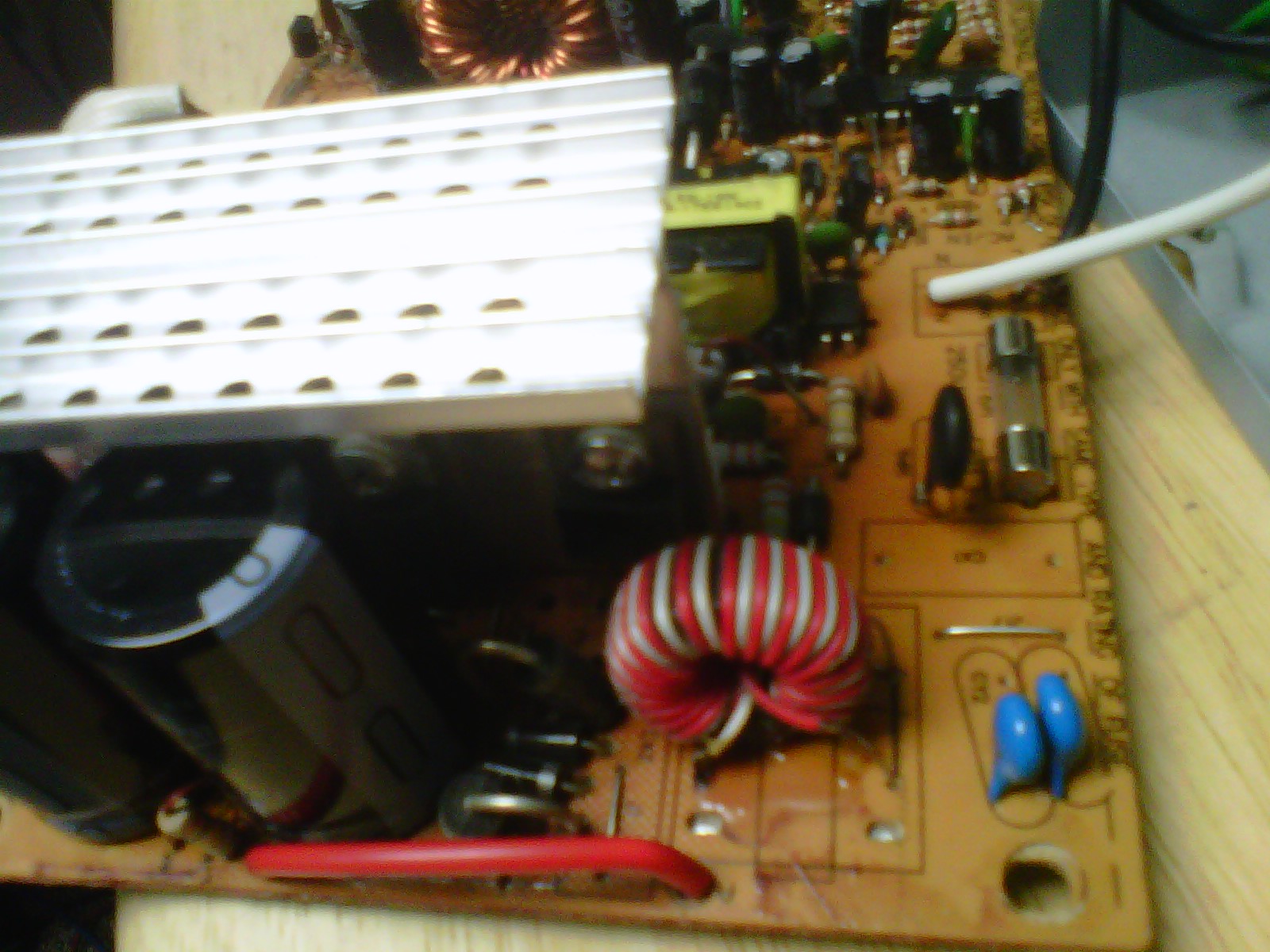

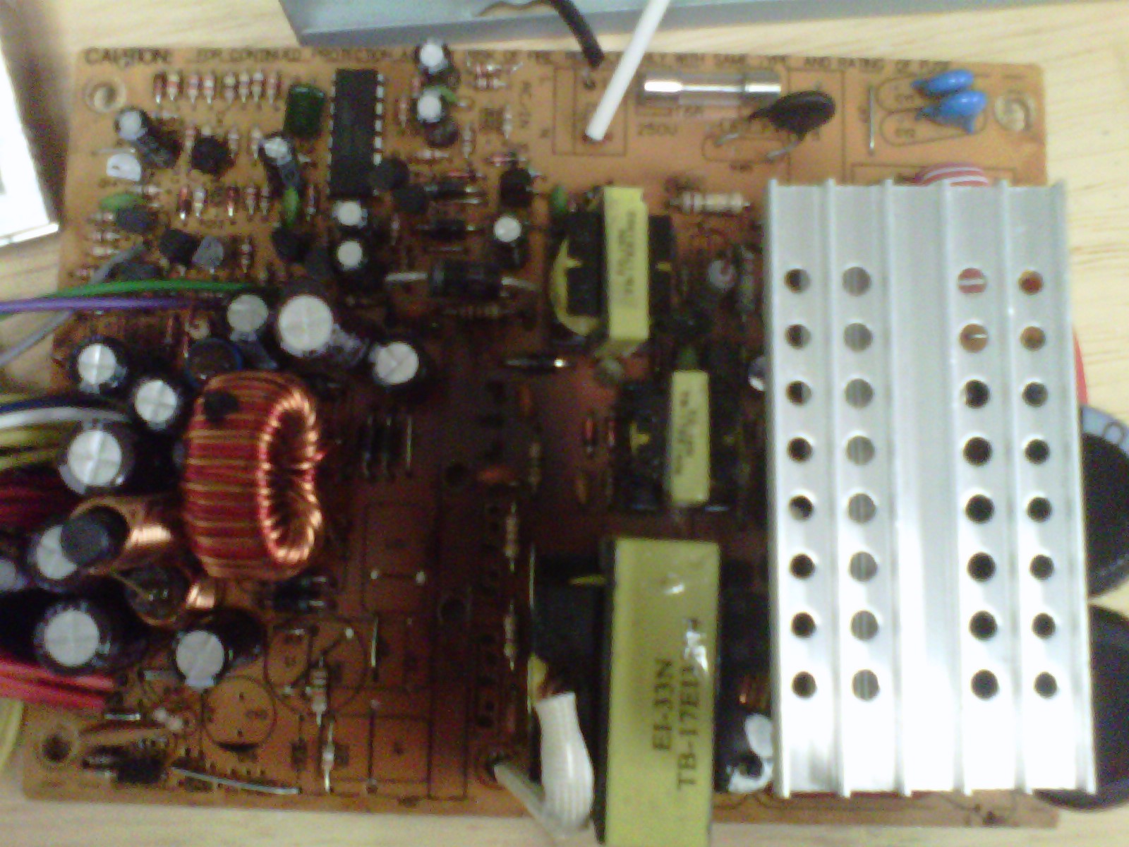

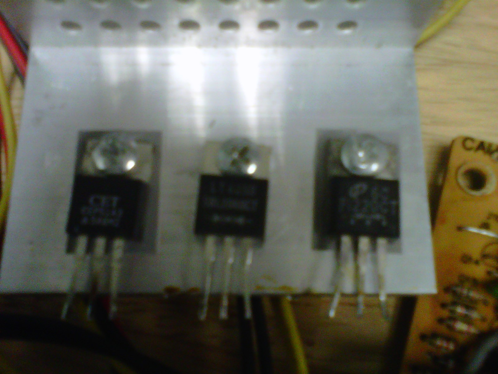

    So I have this Raidmax SMPS (I know yuck), but I would kinda like to revive it. I've been poking around with my novice skills and am a bit lost. I only has +5v standby power, nothing else. I've replaced some caps that failed my ESR tests, checked the mosfets on the secondary side. Check some diodes and resisters in the area near the hot zone around the mosfets. still no go. Looking for some expert guidance if anyone can help me.

      Primary side switching transistors (usually 13007s on this kind of units) failed open. Very common failure mode. But agreed with 370forlife - they are junk.

        I don't dispute they are junk, but it is the only one I have to work on, and it is exactly what 370forlife says, an "educational experience". I was just testing the 13007k and found one that reads both ways....so I'm assuming this is the bad one...Now I just need to find a donor....I'm surely not going to spend any money on new parts for this pile.

          If one is indeed shorted, the other one is guaranteed open. When the primary side isn't working but the fuse hasn't blown, it always means that at least one primary switch has failed open circuit.

            The Unique, your right! It was the 13007, I found a donor, tested the 13007 and it was good. I slapped it in and it fires up. So, no money spent, all donar parts. 4 caps, 2 transistors. I spent some time testing and poking, but it was worth it just in learning and practicing my testing skills. Now yes I realize I brought back to life a complete pile. But it will be a good backup PSU in a pinch. Thanks for the tips guys! This is why I love this site and its forums.
