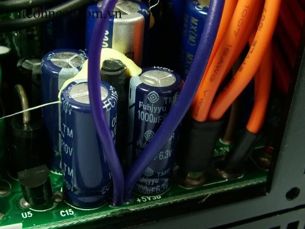

Found pics of same PSU with mixed Mucon and Fuhjyyu.

Look at the second to last image in post 8. The OST and the green Teapos appear to be shorter than the Fuhjyyus in the image you posted.
It is strange to see thermal pads between the primary caps and the case.
At least this power supply has one good cap.Last edited by lti; 07-30-2011, 07:11 PM.Comment

All the Smart Powers and the various 'True'-whatevers plus about everything else they made during that time were Fuhjyyu happy builds.
- All the CWT built units.
They switched to Seasonic as their builder for a while but the Seasonic-Antecs got OST and Capxon.
Then they switched to Delta and those get LTEC and Taicon.
They made something [at least for a while] they claimed was all Jap caps but it was so far over priced you'd have to be on crack to think it was a good deal.
This Antec Phantom 500 is one of the older CWT builds as evidenced by the markings on the PCB in one of the photos.

Not trying to revive an old thread but I'm going to buy some capacitors and re-cap a Antec Phantom 500, and was wondering if you can help me with what caps to use on this PSU.
I have decided to use Panasonic's FK,FM and FC series of capacitors as that's what available on Farnell's site
Here's what I'm going to use:
10 MUcon MX(M) 3300uF 6.3V 10x25
(Recap=Panasonic (EEUFK0J332L) FK 3300uF 6.3v 10x30)

Does this look right? FM, FC, and FK are low ESR right?
Thanks for reading my post, hope someone can help me with this.Comment
Re: Antec Phantom 500 power supply
Those should do fine.Not trying to revive an old thread but I'm going to buy some capacitors and re-cap a Antec Phantom 500, and was wondering if you can help me with what caps to use on this PSU.
<snip>
Thanks for reading my post, hope someone can help me with this.I love putting bad caps and flat batteries in fire and watching them explode!!
