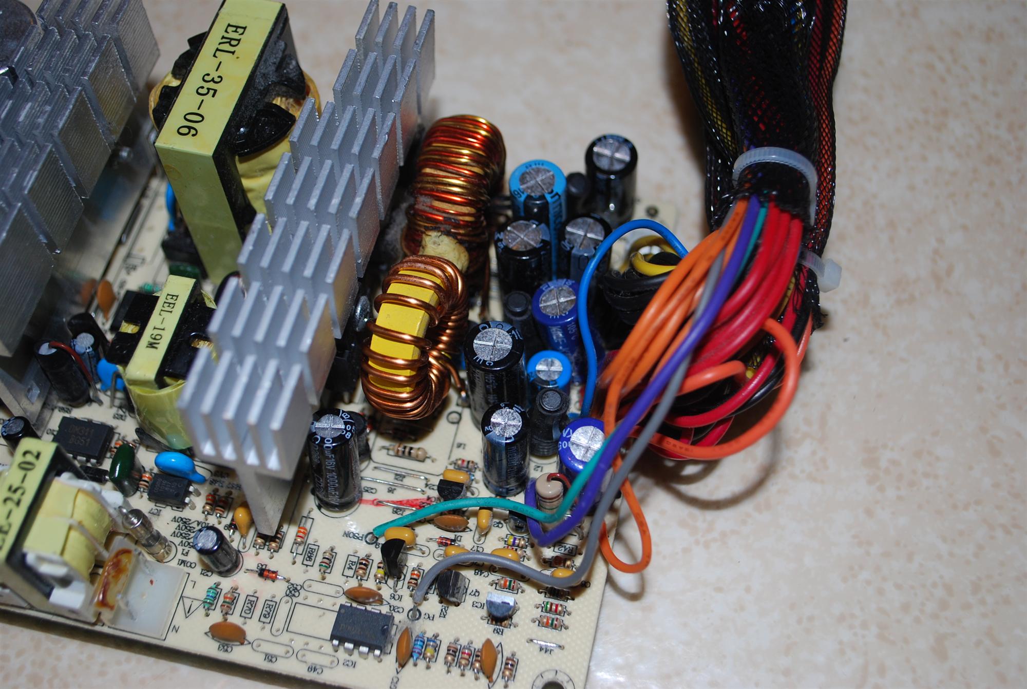

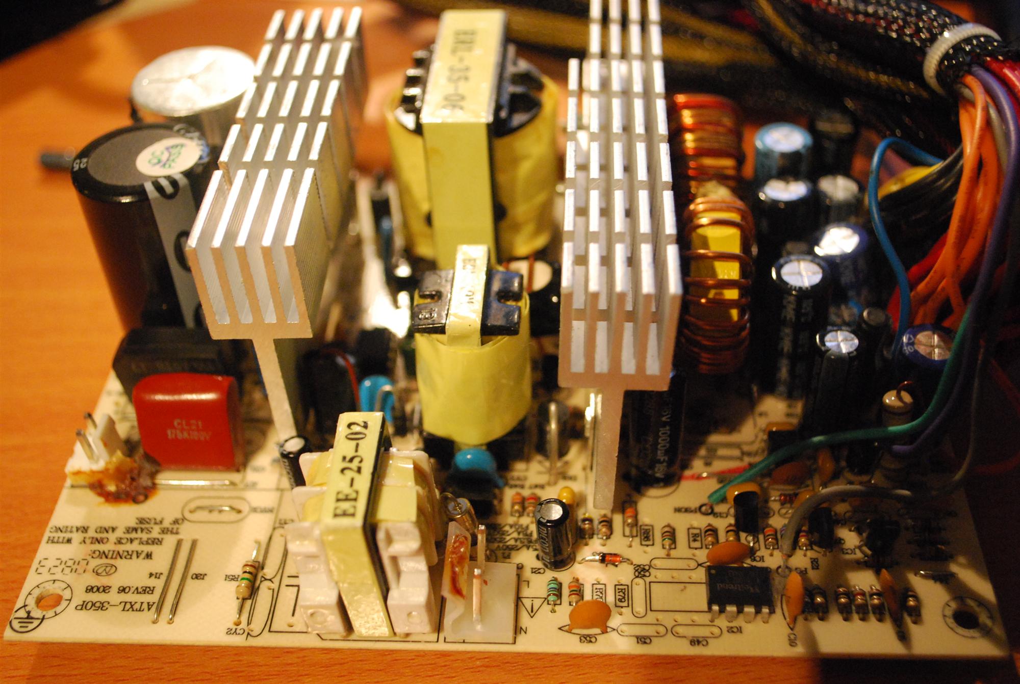

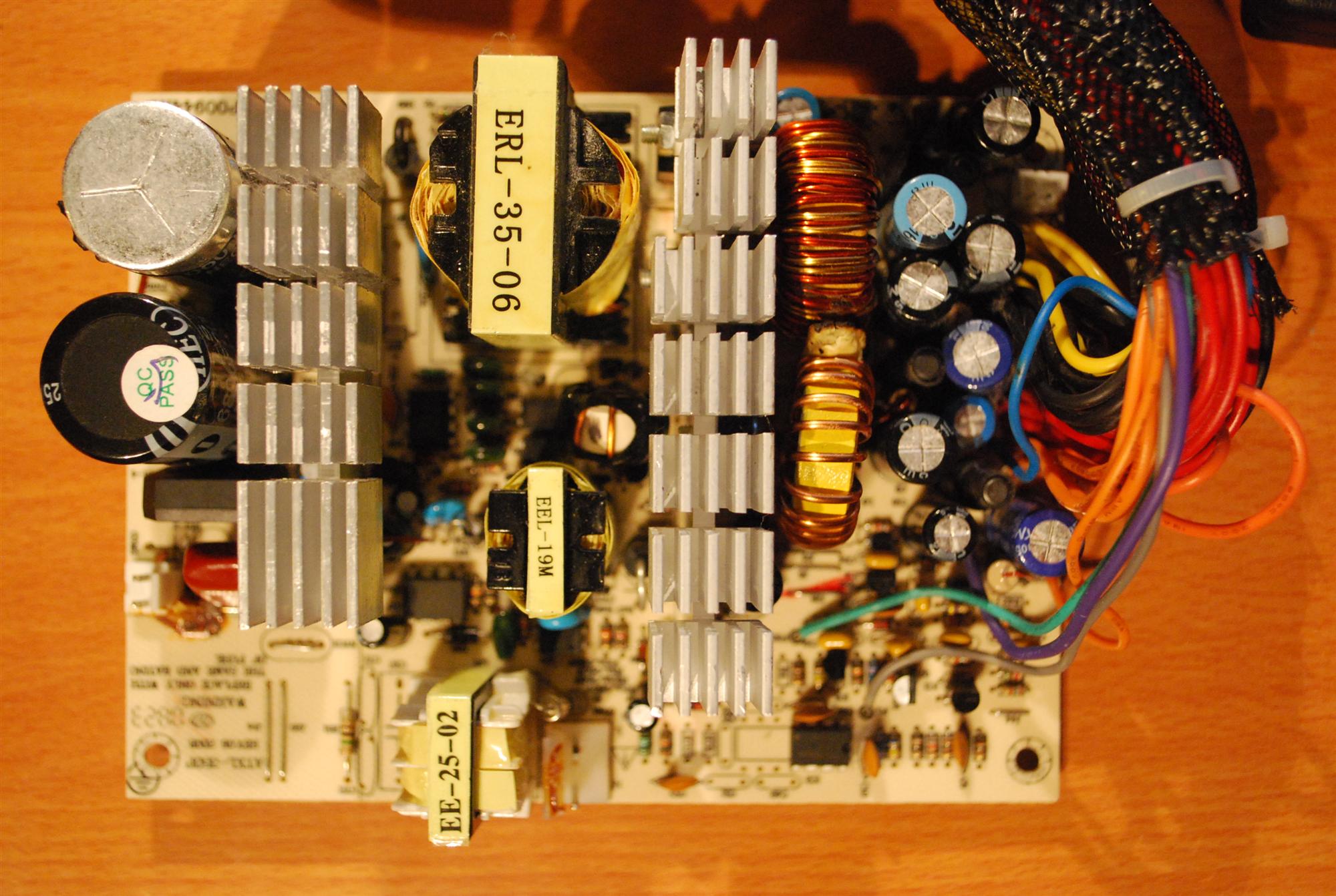

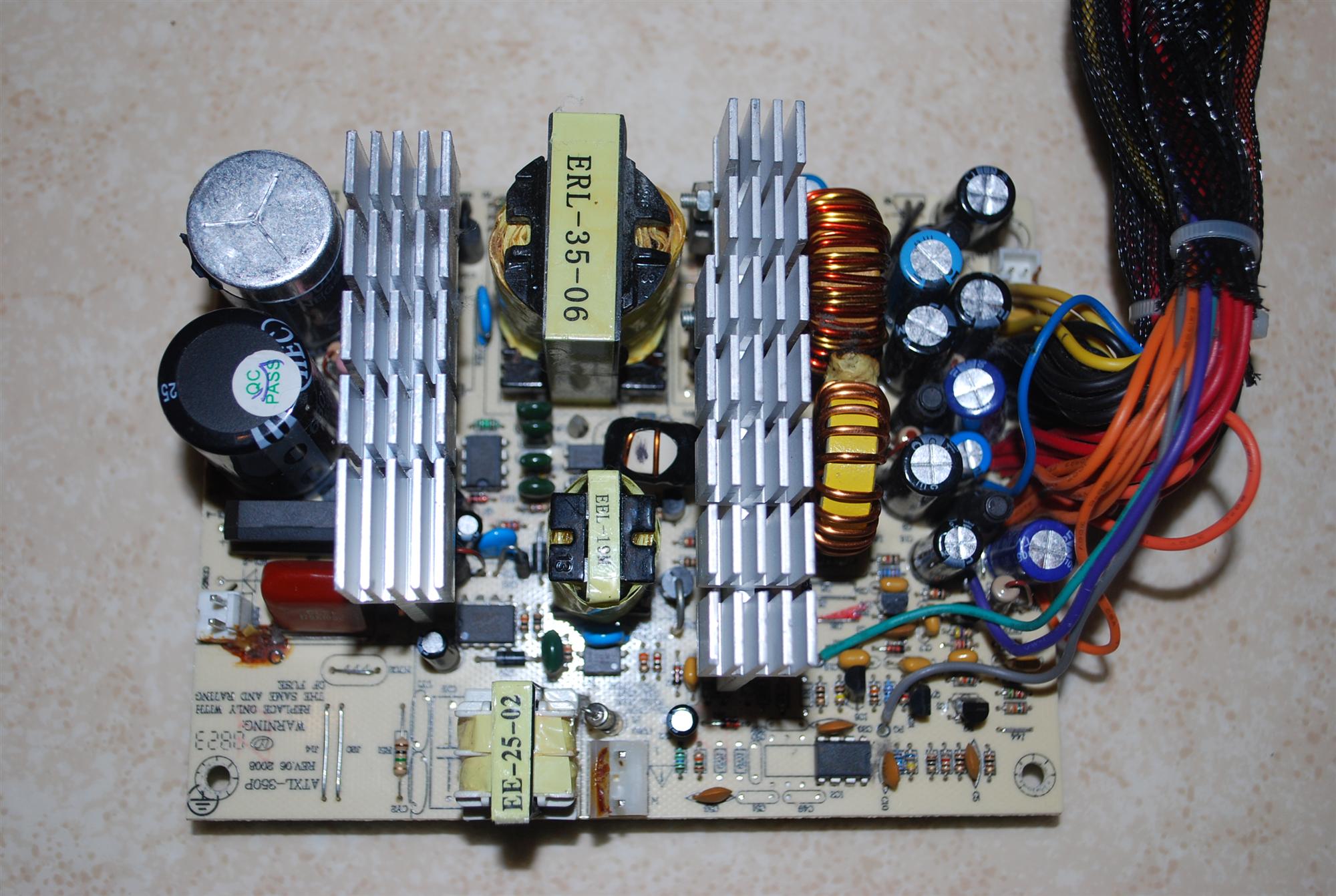

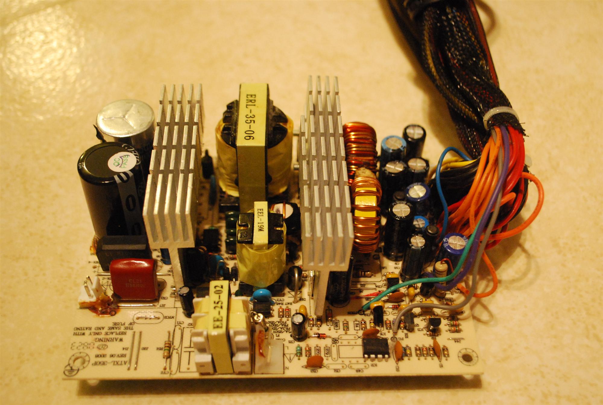

    Hi!
    I have this unknown PSU that seems to be dead. When shorting green with black the fan twitches but nothing more. My CD drive, also hooked up, LED glows for under a second and then turns off again. Repetitive shorting makes it blink, if you understand what I mean.
    I have checked all condensators with ESR and they seem fine.
    Input side are HEC 680uF and the rest are nicon brand.
    No bulging or leaking. Sad really as i hoped to find something wrong.
    I moved on to didoes, schottky and rectifier on output side. All seems ok.
    One coil on the output side seems to have been slightly overheated since some glue on top of it has turned black.
    It has three IC:
    WT751002 monitoring voltage on the output side
    DM311 FS
    UC3843A High Performance currrent mode PWM controller
    Any pointer would be appreciated. Pictures attached and IC datasheet.
