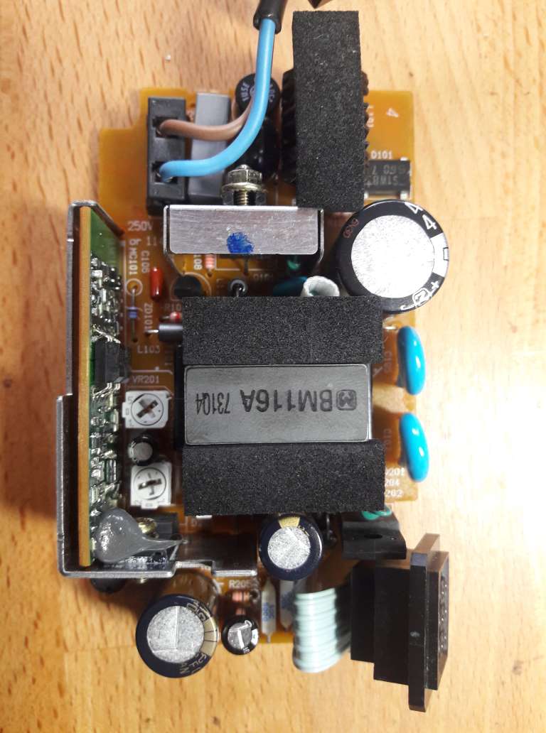

    Hey guys. I have this PSU with the secondary side completely dead and I need some help in troubleshooting and I couldn't find a schematic for it. I'm still a beginner in electronics so please bear with me.
    There is no visible damage to any component, the PSU is reasonably clean with no burnt smeel whatsoever. The secondary side seems completely dead, I couldn't find any voltage anywhere, not even at the transformer's terminals. It seems as if the transformer is not doing its job, maybe because it's bad or because it's not told to switch on .

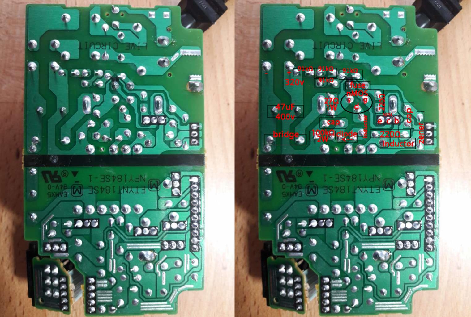

    Here's what I checked on the primary so far (without desoldering, images attached):
    Filtering and rectifying: ok
    Fuses: all ok
    Caps: not shorted
    Resistors: all ok
    Inductors: continuity ok
    Diode: OL and 0.5
    Zener (delsoldered): OL and 0.72
    With the power on, I checked the power mosfet's gate and it was 0v, I don't have an oscilloscope so there's really no way for me to tell if the voltage is oscillating, I tried measureing as AC and DC with the same result. The gate is not shorted to ground, so I concluded that no signal is reaching it.
    The part of the PSU responsible for switching the power mosfet (the small board on the side) seems to be the culprit, it has has 3 pins connected to the primary side and communicates with the secondary through 2 optocouplers.. Of the 3 pins, one is ground, one connects to the mosfet's gate and the last one connects to the transformer through an inductor. I figured that must be where the board is getting its power. I measured the voltage there and it was 0v. I tested continuity between that transformer pin and ground and it tested positive. I think it should be normal, that side of the transformer supplies low voltage and so should have a very small impedance.
    At this point I think either the problem is on the small board, the tranformer is bad or I'm missing something. But, assuming i've been right so far, how can I safely test which on of the two options is the correct one?

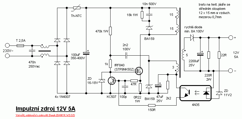

                    It could be similar to this:

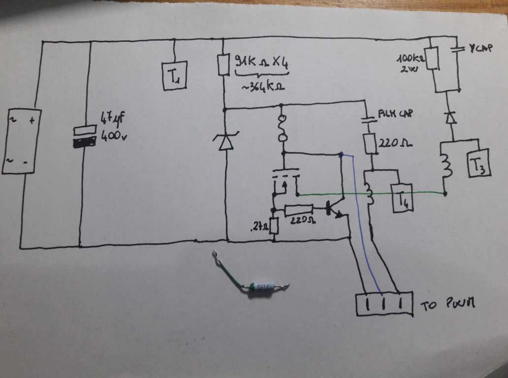

                          This is the schematic, T1, T3 and T4 are the transformer's pins, from left to right. Could it be that there's something wrong with the feedback/PWM circuit?
                          Edit: sorry, vertical image. I checked the internal resistance of my multimeter and was about 0.3, thank you for the trick!

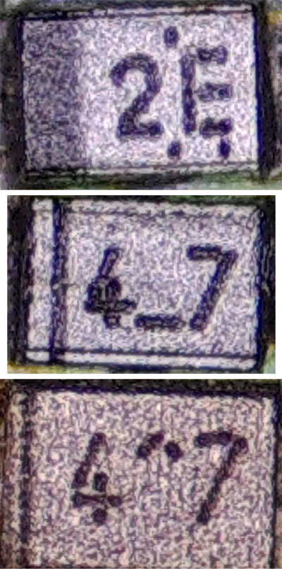

                                Hey guys, finally I'm getting closer to solving the problem. I'm a little ashamed to admit that I cheated my way out of it. I borrowed the same power supply from a friend and the circuitry was exactly the same. I swapped the small daughter boards and the power supply started working again. Then I combined the FB of the working board to the PWM of mine: the PSU worked.
                                So my problem is on the feedback side, I replaced the optos and checked every resistor and diode, comparing the results of the two boards, everything seems good. At this point, the only options left are the 2 ceramic caps (they are not shorted, but at this point who knows anymore) the LM393 and 3 small ICs marked 5H and Z_R. My money is on the LM393. I'm not even trying swapping them, the moment I remove an SMD component it's basically ready for the trash. I will simply replace them all. Anyone can help me identify 5H and Z_R?
                                Picture attached, in the bottom right there are two resistors that seem burned, it's just black silicone, they measure fine.

                                  5H seems to be a Panasonic XN04501
                                  Z_R seems to be a 2SD601A-R

                                      Hi. I know I'm reviving an old topic, but I really need help.
                                      I also have a n64 power supply with a faulty daughter board.
                                      I've found the faulty parts and replaced them with ones from a working power supply.
                                      But now I need to identify them, so I can put them back in the working power supply.
                                      1. Maybe someone can help identify the 3 diodes in the picture.
                                      2. XN4601. Absolete part. I'm planning to replace it with BC846B+BC856B. I hope that is ok, because i already ordered them.
                                      3. the 2 optocouplers are busted, too. Model TLP721F. Can I replace them with PC817C or PS2501-1?
