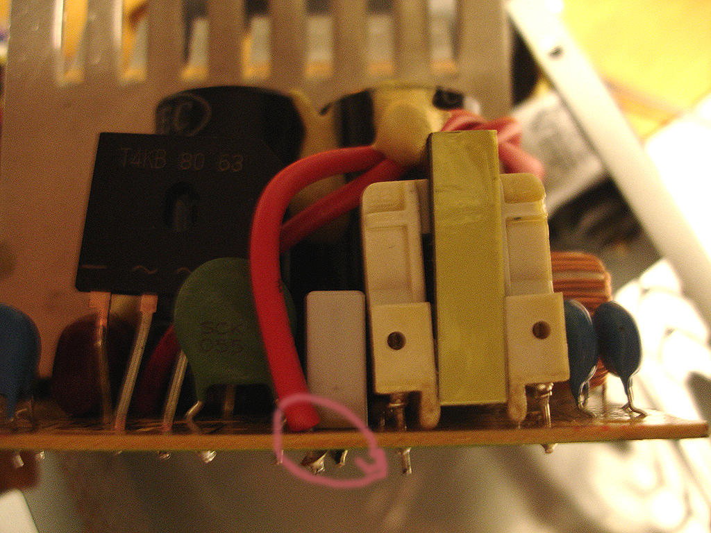

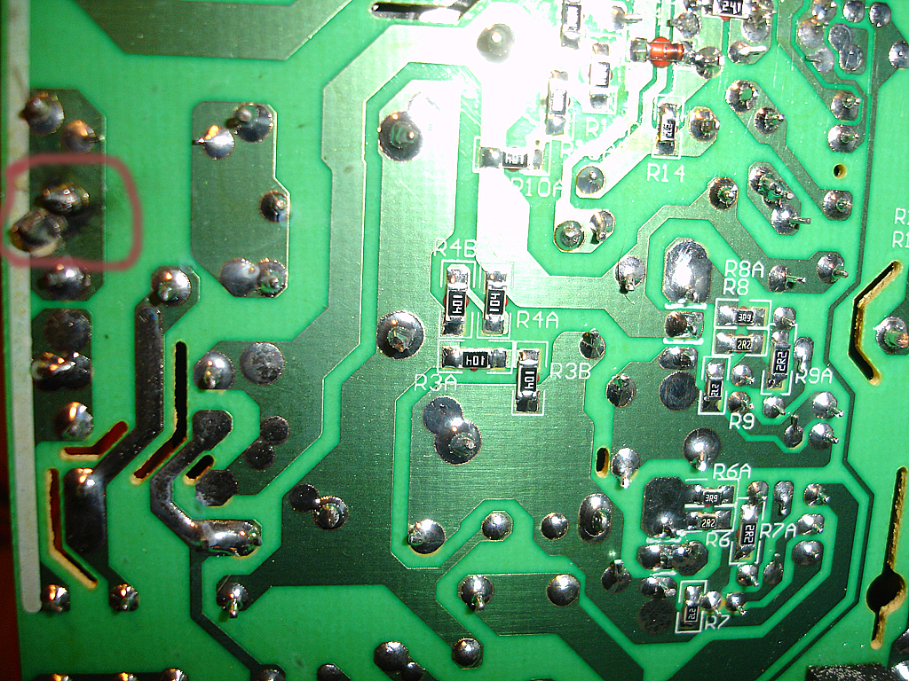

                I think I found the problem. Looks like the red wire that attaches to what I think is a square "X" capacitor (next to the transformer) is not connected to one leg of that cap, but should be. The wire is loose, You can see its sort of pushed out of the PCB, I think the two wires should have been joined by a puddle of solder. There is a black scorch mark there. Tell me what you think.

                  Re: My Dynex 350W lost it's mojo
                  definitely something happened there-probably the high-voltage caused an arc aross the bad connection, making a pop noise
                    It's hard to tell from the pictures, but if the red wire is indeed loose or has become unsoldered, then that's definitely the problem. As shovenose suggested, the noise could have come from the bad connection.
                      thats the voltage selection switch wire... that would explain it if you are on 120v (USA or canada)... if 240v, then nothing because turning the switch on would burn the unit out. switching it off on 120 drops the voltages... and ehnce why you have a problem.
                      resolder that wire. the scorch if from the AC arcing...
                        Looks like part of that pad\track has actually been ripped off. I'm guessing they built it badly, there was too much strain on it and it broke.
                        Might work just fine if you reconnect that wire
                          The red wire was loose. Upon closer inspection, I realized that it was supposed to be attached to a common ground plate in that area. The solution was to attach it to another wire that was firmly attached to the ground plate. Seems to have done the trick as test board now posts. Was able to document all the caps while I was in there so I can in future do a recap. Other than the caps, which are a mixture of CapXcon and FCon, the Primary side is complete with no fudges, although the Primary caps are only 470uf 200V.
