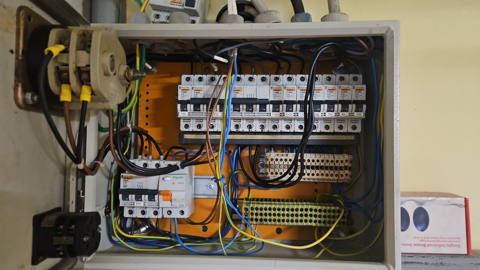

                I did some measurements last night, so the three phases has these voltages during sleeping hours, when there is no load on it on the network:
                1. 216V
                2. 218V
                3. 219V
                So in even in the best scenario I have around 220V at max per phase.
                And the machine works until 210V. We can go up to 240V safely I guess.
                And when the machine stops working, I measure around 208V on every three phase.
                This is the utility box where the power comes in to the machines:

                  Ahh, that’s a bit better now and making more sense. Because if your 3 phase 380v goes down to 207V you got some major power problems. I think having 208V single phase is acceptable to the power company, as 99% of things keep working on that voltage. There are 3 phase voltage buck and boosters out there.I saw 10kva for about a Grand. I guess that’s what you need to have. The idea is same as when a UPS does a buck or boost to compensate the voltage output without going to battery.

                                    Found out that a CNC machine on 3 phase does have a +10% / -6% voltage tolerance rating. And the math is there when this machine cuts out. 380v -6%=357.8V. I calculated out 358v using the 207V single phase measurement taken from the op. On the other hand 380v + 10%= 418v. Calculate that down with wye calc and that ends up at 241V per phase. Bang on then.
                                    Problem is going to be on how to fix it. Best solution is getting a heavier power entrance with thicker cables. Cheapest solution is to ignore it and live with it I guess. The buck / boost transformer is an idea but no matter how I spin it, it ends up costing an arm and 2 legs.
