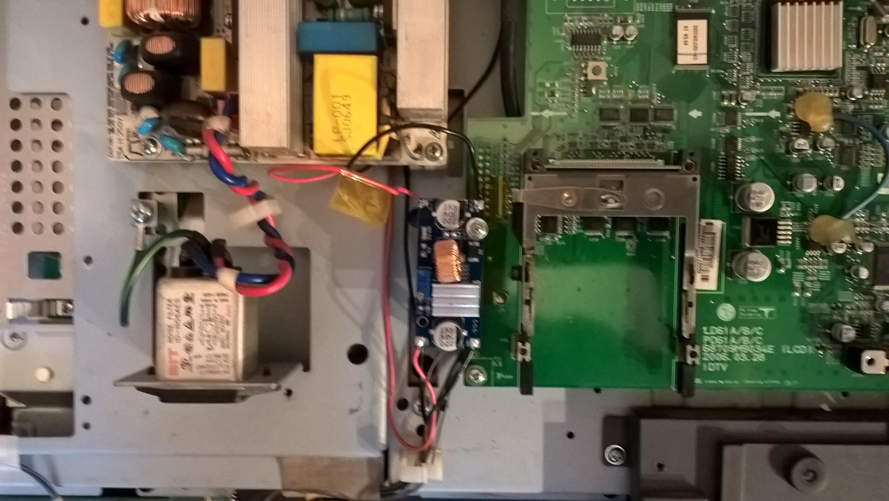

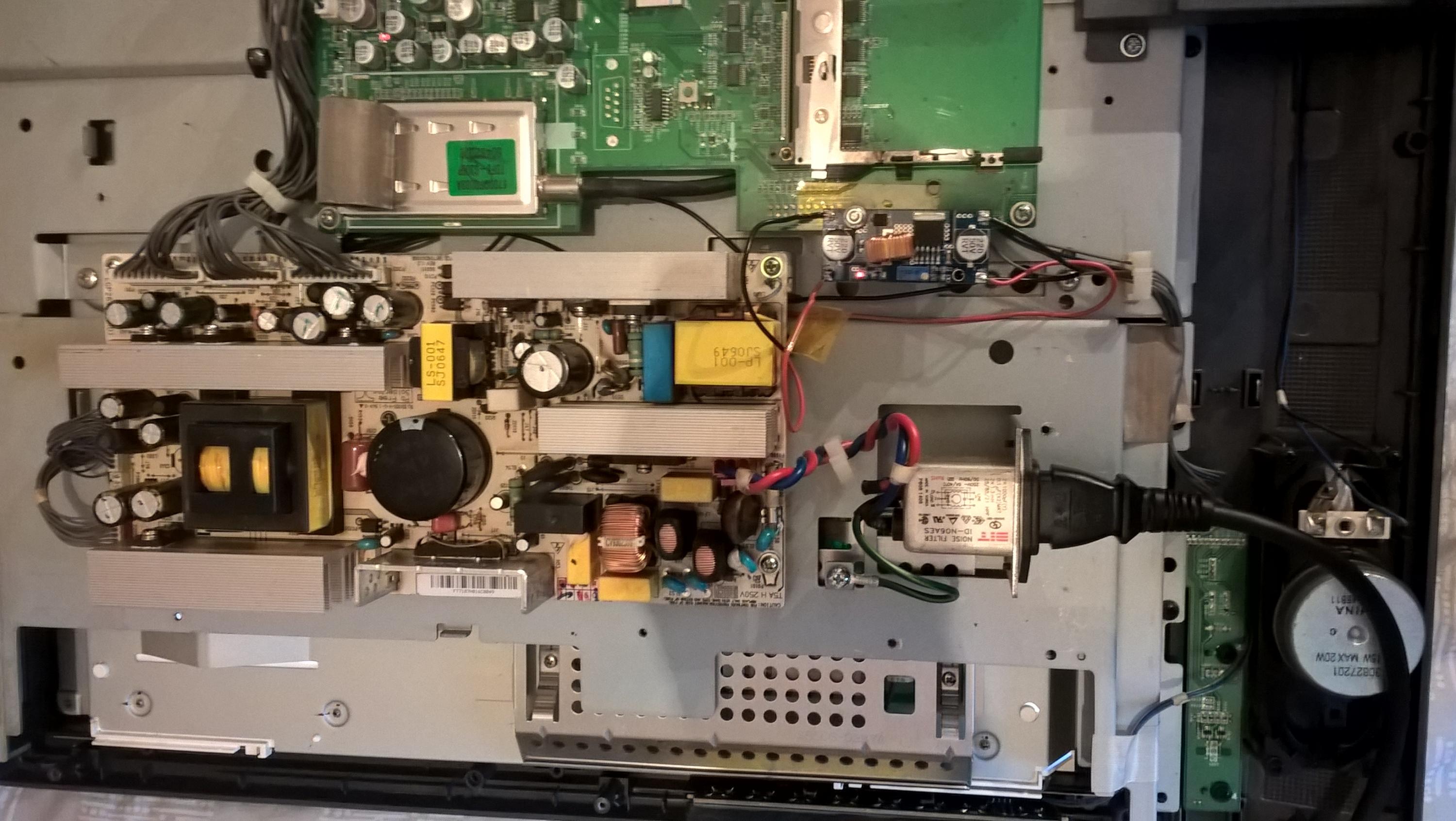

                  A update i managed to find room and mounted the power module, i loaded the psu with the resitors and set it to 3.4 volts, i then soldered the output to the 3.4 volt coil as per budms advice the good news the set now scans channels fine and has sound so im soak testing the set now. I did not do nothing to the 3.4on pin as the set seems to function ok as it is.
                    #169
                    Re: LG LCD power supply
                    Good news, so you removed the IC U200 and the two MOSFETs? I think they have the 3.4V_ON/OFF signal to turn off the 3.3V to reduce the power consumption when TV is OFF so the 5VSTBY will have minimum load.
                    Does the IC get very hot?
                      too be honest budm didnt check the ic heat although i did fit the heat sink supplied too it i did check the running voltage of the 3.4v pins it read a steady 3.4 so under load the module did its job ok the 3.4 on pin still read 2.04 volts like it has allthrough my fault finding and swopping parts etc. I found a spare screw hole on the mainboard so attached the module too that and ran wires to the psu pictures included, the set seems to run fine but theres a lot of heat out the top vents and also the lcd has one dead pixel only visble on a black image.(yes removed mosfets and ic as your advise) thanks for your input guys another set saved from the landfill for a while at least.
                        #171
                        Glad to hear the TV is working, I may get some of that module to play with.
                          They seem good for the money took a good few turns of the screw untill the voltage started to drop but seems to do the job ok and stuff at the minute coming from china too the uk takes around 9 days so not bad.
                            Nice!
                            Great to hear the set is running as it should be. I guess the original power supply buck converter does have a design flaw somewhere.
                            As for not using the 3.4V_ON pin... your TV will probably waste a little more power in standby, since the 3.4V rail won't be turned off then. But I guess that probably won't be too much of a deal for most people.

                              Thanks momaka i know its not a proper fix adding the additional module but i carried out the fault finding as far as i could myself without a scope etc (yes i do have a 20 mhz one i need too test and see if it works correctly then i can try too learn how to use one) but for now this set is working if i had realised it had a dead pixel i probably wouldnt have bothered as its such a old set, but too be honest i have it on soak test myself still and i hardly notice it at all.This isnt my set a neighbour got it from out of our comunal rubbish bin room and asked me could it be fixed for them, i will show it them working tomorrow and show them the dead pixel and see what they want too do with the set, money wise it owes me about £10.00 in parts so not a bad result even if they dont want the set i may get more parting it out (except power supply/lcd) i will see what they want too do.

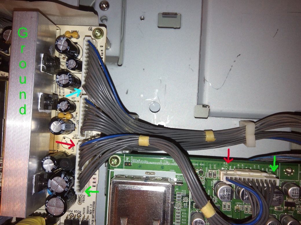

                                          Thank you very much for responding, and a happy new year. I belatedly read your PM and that seems conclusive that I have a bad main board. I have a replacement on order so we will see. Below is what I was going to ask, but I now understand you already successfully got the red arrowed point to read 3.4v with the TV on.
                                          The "3.4v" pin is marked with a RED arrow in the attached photo. It's the first pin in the connector and on my TV is distinguished by a blue wire. I would appreciate knowing what you have for both TV on, and TV in standby.
                                          For the avoidance of doubt the "3.4 ON" pin is the last pin on another connector (BLUE arrow). That signal is also of interest please but not to be confused with "3.4v" (RED Arrow) which is my main concern.
                                          For the negative wire on the meter you could use the heat sink marked GROUND in the photo, but be d*mned sure you get the right heat sink - the ones at the other end (nearer the mains input) are very "hot". Alternatively you could use the pin at the other end of the same connector (GREEN arrow).
                                          BTW under the red arrow on my PSU I have removed L204 but yours may still be in place? Actually a photo or two of your fix/mod would be very nice.
                                          Thanks again, Duncan
