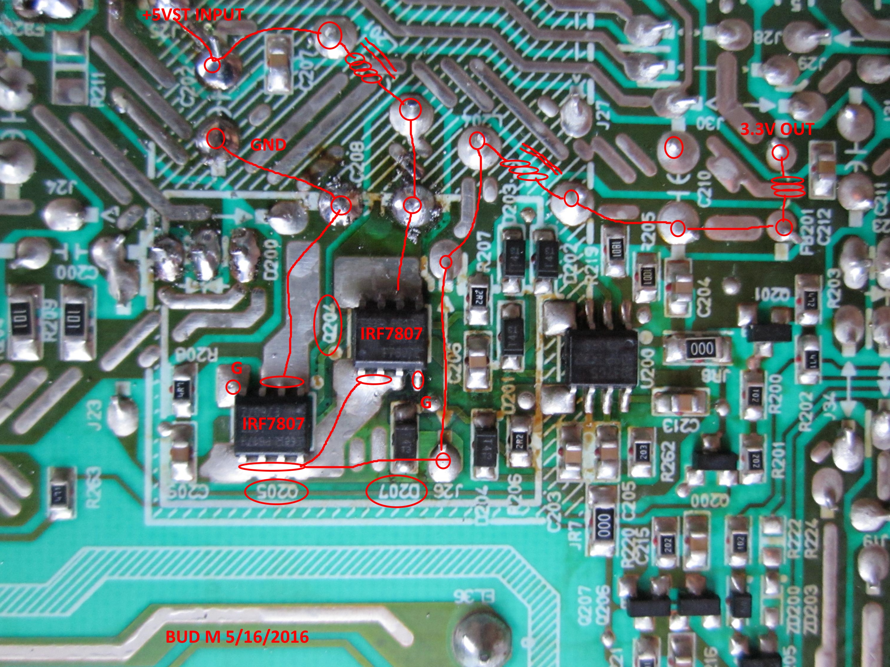

    Mitsubishi CNC switching power supply board dead / relay board bad diode failure
    by sam_sam_sam
    I was working on this CNC machine today found no keyboard functioning no control relay powering on
    The screen powered on and was giving an operation error but the manual was not very clear about what the error exactly was but with a little bit of troubleshooting and finding out that the control relays not powering on and no keyboard functions we narrowed down to this one switching power supply which of course does not have any indicator LED light they are on the keyboard interface/relay controller board
    Found shorted diodes on main controller relays there are 3 of them that...
