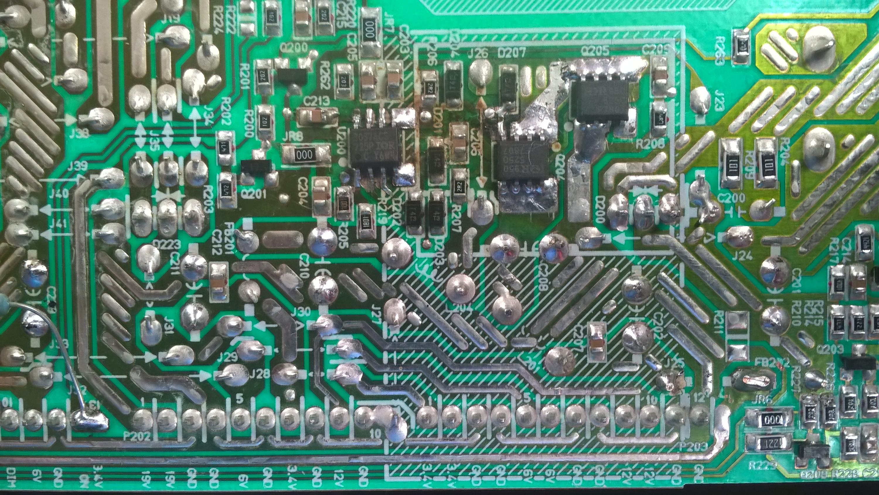

    just a update for budm i had a bit of spare time today so i checked the psu again i used flux and solder braid on the ic pads that i have removed the short has now gone i persume it was u200 causing the short are these ok as replacements i know there from china but finding replacements cheap in the uk without minimum order costs etc im struggling to find a supplier.
    http://www.ebay.co.uk/itm/2820147396...%3AMEBIDX%3AIT IRF7807
    http://www.ebay.co.uk/itm/3019086960...%3AMEBIDX%3AIT IRU3037

          #84
          Re: LG LCD power supply
          Budm im about too fit the new parts too this board but in post 34 you asked me to remove two filter MLC CAPS on the 5VST pins, bud any idea what uf and voltage these need to be? as i cant find the ones i removed as i removed the ones of my spare board too.
          Edit ive found the value in the service manual 10 uf 16 v 1206 size

            #85
            Just a update i have replaced the three ics and the two mlc caps good news the psu now runs without any clicking problems the bad news is the 3.4 volt line is low 1.1 volts so no freeview etc this seems a common fault on these psu s with no reported fixes most people just replace the psu any idea budm what i can do to fault find next also what pins do i link to run this psu on the bench (i know this is a psu issue as i had another 37 inch set with sound issue once i replaced all caps and was fine, and the set im repairing runs fine with the borrowed psu) 37 inch set nowreturned though so cant run anymore tests.
              #86
              The 3.3V is generated by that U200 and the MOSFETs which you have already replaced, so at least the shorts circuit is gone due to the Buck converter circuit (u200, MOSFETs) was bad, but now the shorts is gone and you get the 6V back but the output of the Buck converter is only putting out 1.1V, so there may be more bad parts in that section.
              Low output can be due to heavy load, you may try disconnecting the 3.3V line out from the connector to see if it will come back up to 3.3V. It can also be due to bad feedback circuit, or bad caps in the output.

                      #90
                      https://www.badcaps.net/forum/attach...5&d=1463429645
                      The U200, Q204, Q205 are the one you changed, right? They are for the 3.3V that converts the 5V STBY down to 3.3V.

                          #92
                          Hi budm this isnt my psu but shows the connectors quite well which two do i need to bridge with a 1k resistor so i can test the psu on the bench thanks
                          this shop jimmy link maybe better though as you can zoom in better
                          http://www.shopjimmy.com/lg-67099000...wer-supply.htm
                            #93
                            I cannot see all the lable of the pin from SJ picture due to the angle of the picture.
                            I see ON pin (may be for the Inverter ON/OFF) and the 3.4V ON pin.
                            Check to see what you have on those two pins when you turn the TV on and off since you can at least turn the TV ON but the 3.3V is low.
                            If those two pin toggle Low (TV OFF) and toggle HIGH (TV ON) then more likely those are the two command receiver pins that you can connect the resistors to for manually forcing on the power supply board.

                              #94
                              cheers budm ive also just ordered all the capacitors so will do a full recap too as this will rule them out then, also this low reading on the 3.4 rail seems very common on the internet with no fixs posted but must be something like you say above quote the Buck converter is only putting out 1.1V, so there may be more bad parts in that section.
                              Low output can be due to heavy load, you may try disconnecting the 3.3V line out from the connector to see if it will come back up to 3.3V. It can also be due to bad feedback circuit, or bad caps in the output quote. Can you highlight the capacitors on the output budm then i can check/change them thanks
                              i have also disconnected the 3.4 wire from the conncetor still reads 1.1v so it wasnt that maybe you have some ideas what to check next and thanks again budm
                                #95
                                I see c202 for input filter, C210 on the output, then you can trace the '3.3V OUT' trace to see if it has more caps connected to that trace.
                                      update ive fully recapped psu tested all voltages 3.4 v is not there with 3.4 on linked to 5v stb and 5v stb pin linked to on pin all the other voltages are spot on now just tested q204 it has 5volts in but no voltage on the other 4 pins on the opostie side of the chip so where do i start fault finding? thanks guys
                                      • vinceroger69
                                        • Mar 2012
                                        • 6714
                                        • uk
                                        #99
                                        some pictures also d200 diode on heatsink has 5 volt on centre leg nothing on outer legs is this correct fch10u10 not sure if this has anything to do with the 3.4 volt section though.
                                        • vinceroger69
                                          • Mar 2012
                                          • 6714
                                          • uk
                                          #100
                                          so in this diagram i have 5 volts into the q204 ic i have already changed nothing on the otherside of the ic can anything else be stopping the output? i guess a new ic can be faulty?
                                          im not sure why yesterday i measured 1.1 volts on the 3.4 line maybe somehow the mainboard was giving this readings to the pins now running the psu on the bench no voltage at all on the 3.4 volt pins.
