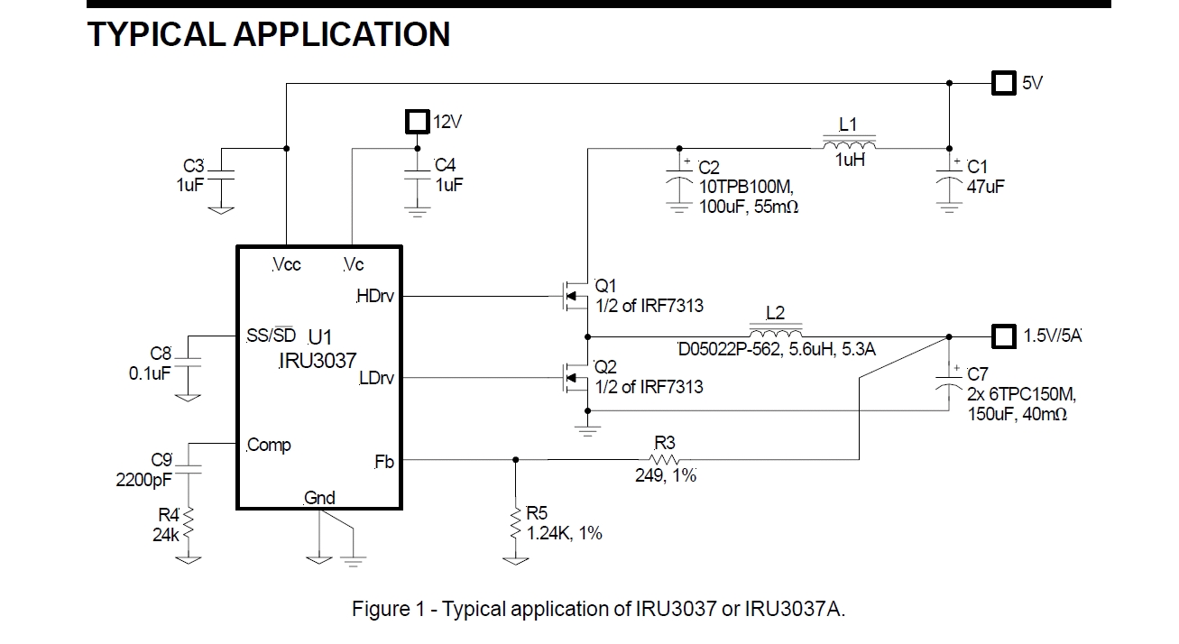

    Seeme to me there is drive signals to drive those two MOSFETs, you need the scope or just check to see if there are at least some action at the Gates of the MOSFET.

      Re: LG LCD power supply
      can i check the gate with a multi meter or do i need a scope? what can cause no gate activity? as i do have a parts board but not sure what parts too change over cheers budm.

        There is not much for that self running buck regulator. You may want to check the resistance between GND and all the pins, then the DCV of all the pins. We know that we have 5V on Vcc and the 12V at Vc but the IC is still not running.
        It is going to be something we are not seeing since the circuit is pretty simple.

          u200 readings
          1 0.78
          2 5.12
          3 1.88
          4 0
          5 3.64
          6 9.80
          7 2.00
          8 2.92
          low voltage on the vc line?
          i have just changed this ic for another one diffrent order as ordered spares.

            Vc: This pin is connected to a voltage that must be at least 4V higher than the bus voltage of the switcher (assuming 5V threshold MOSFET) and powers the high side output driver. A
            minimum of 1μF, high frequency capacitor must be connected from this pin to ground to
            provide peak drive current capability.
            Boost Supply Vc
            To drive the high-side switch it is necessary to supply a
            gate voltage at least 4V greater than the bus voltage.
            This is achieved by using a charge pump configuration
            as shown in Figure 18. The capacitor is charged up to
            approximately twice the bus voltage. A capacitor in the
            range of 0.1μF to 1μF is generally adequate for most
            applications. In application, when a separate voltage
            source is available the boost circuit can be avoided as
            shown in Figure 1.
            So you have 9.8V which meets the requirement since the Vcc is 5V.
            The output drives is not at 0V but on the low side especially the High drive.
            It looks like you are going to need the scope to look for activity of the IC.

              its a odd one as thats the second ic with the same readings on both so that should rule the ics out i guess.

                Something is stopping the IC from working, and we know that we do no have shorts or heavy load on the 3.3V output, and there is no command line to turn the IC on and off that I can see from the pictures of the board.
                [B]Pin 8 SS/SD:
                This pin provides soft-start for the switching regulator. An internal current source charges
                an external capacitor that is connected from this pin to ground which ramps up the output
                of the switching regulator, preventing it from overshooting as well as limiting the input
                current. The converter can be shutdown by pulling this pin below 0.5V.
                [/B]
                You have 2.92V so that is not it either.
                I am running out of Ideas.

                        20MHz is good enough to troubleshooting this buck regulator section, and it is on the cold side so no need to worrying about the isolation.

                                      According to the spec sheet of u200, to turn off the U200 you have bring pin 8 to below 0.5V, right now pin 8 is at 2.9V.
                                      The question is, is the 3.3V buck regulator circuit is an always on power supply or not, hence running the good power supply board by itself.
                                      All he has to do is to run the known good board by itself.
                                      5VSTBY feed the 3.3V BUCK regulator, it is not controlled by the 3.3V regulator.
                                      And for the output to be present at the out put of the Buck regulator, the Voltage (Vc PIN 6) for the high side MOSFET has to be present (9.8V) which it also has.

                                          The VCC is fed by the 5VSTBY which he had found the the 5VSTBY output was showing shorted circuit (post 21) so I start helping him locate the shorts, we fond that the MOSFET for the buck regulator were shorted, then he changed the IC and now the 5VSTBY is back but the 3,3 V is at only 1.4V.
                                          https://www.badcaps.net/forum/showpo...4&postcount=68
                                          https://www.badcaps.net/forum/attach...8&d=1463421872
                                          The wiring of the buck regulator looks to be matched with the circuit app notes of U200.
                                          "So you're saying that vinceroger69 has verified that U200 on his faulty board is getting both Vcc and Vc voltages? (Sorry if I missed it. I read very slow, and with multi-page threads, I sometimes get lost.)" Read post 104, 105, 107.
