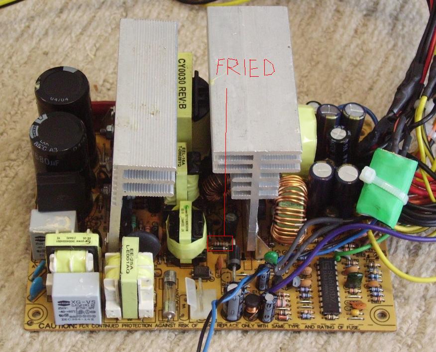

                              Need some help with this PL-400. I have a fried resistor, unable to find the color code or the right value for it. Can you help me with this? Here is the issue:

                                  It's a 1.5K +/-5% (Brown, Green, Red, Gold)
