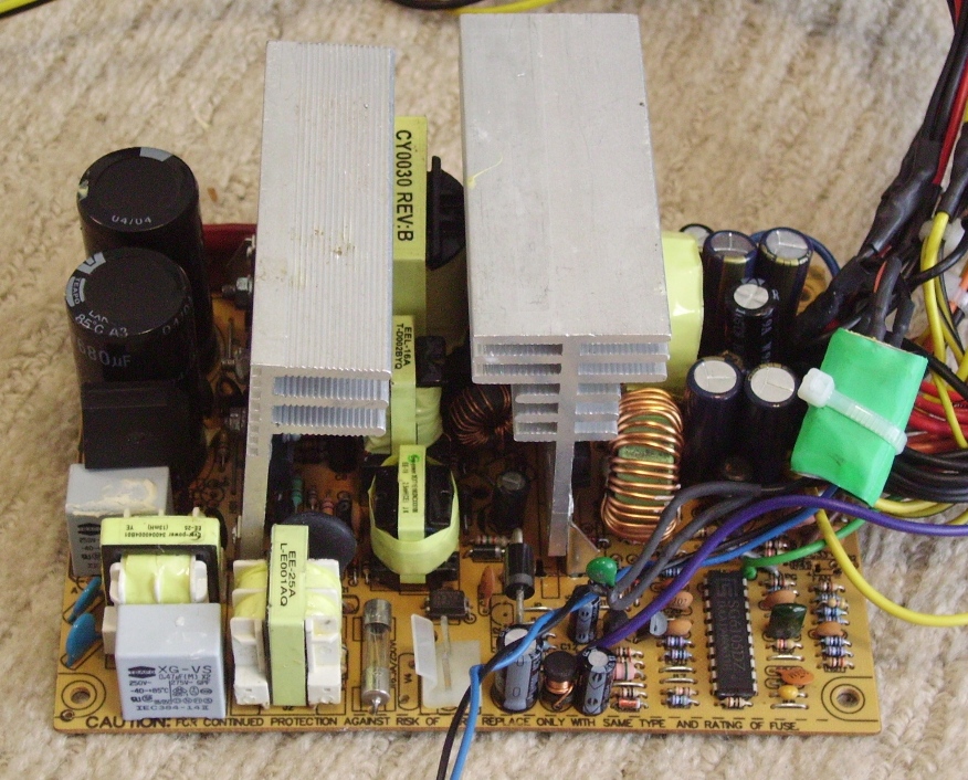

    Get rid of that big load resistor on the 3.3v rail. Looks like a 10 Ohm. If it is, that's almost 1W of heat there and you'll be cooking your new caps. Change it with a different resistor that's 25 Ohms or more (but not more than 500 ohms). Seems like the 5vsb also has a big loading resistor (51 Ohms?). Change it to 100 Ohms or a bit higher. Less heat and improved efficiency when the PSU is loaded.
    See if there are any other load resistors on the other rails.
    PSU looks solid.

            I've given it some additional modifications. It previously had a thermister in series with the fan to temperature control it. I've replaced that with a proper temperature controller I pulled from an failed antec SU-380. I also have replaced all of the connectors (the originals only had 20 guage wires). It now has a 24 pin ATX connector, 8 SATA connectors, 6 Molex connectors and 2 floppy connectors.

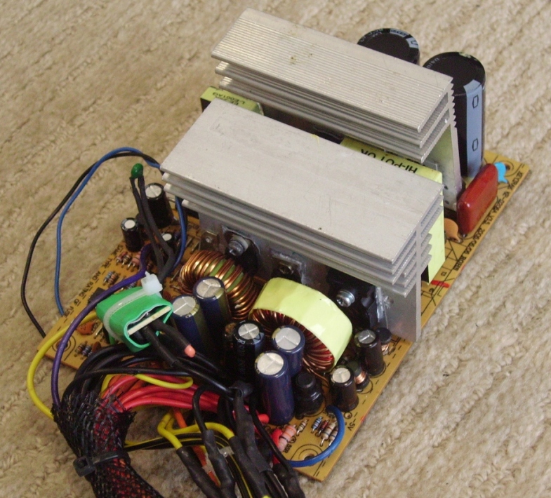

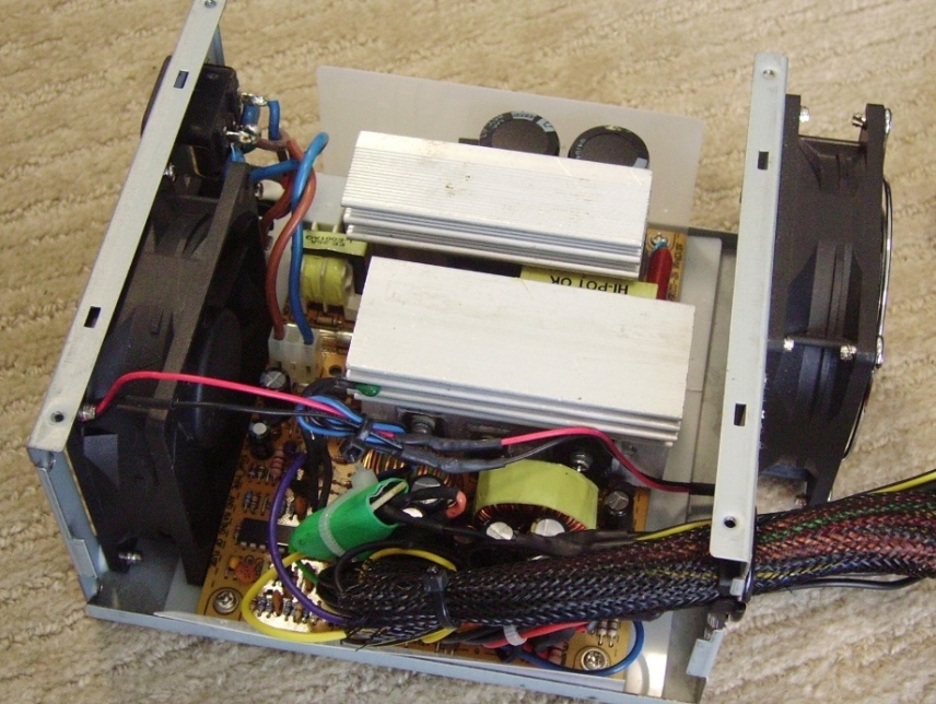

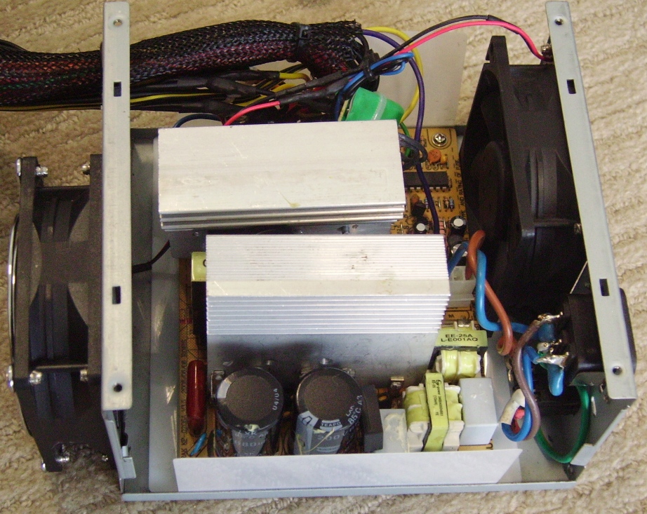

                                Done for now. I might give it the 'everell mod' to the 5vsb later. Feel free to laugh at my new label. I'll test it when I get brave enough to power it on
                                • everell
                                  • Jan 2009
                                  • 1514
                                  #36
                                  Re: Rexpower PL-400 rebuild
                                  I really like that "cool" double fan arrangement!

                                      Looks good indeed. Is the secondary heatsink from a HiPro PSU?
                                        Believe it or not i've seen it on gutless wonders before.

                                          The primary heatsink is from a Hipro, but the secondary is from a Seasonic-OEM Antec SU-380.
