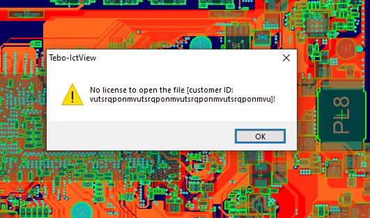

                      continuous rotation in relation to the number of characters
                      zzzzzzz = u t s r q p o
                      zzzzzzzzzz= u t s r q p o n m l
                      I saw that I made mistakes in the decoding

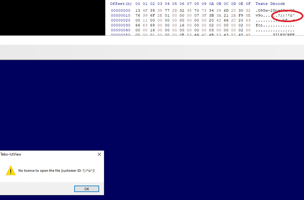

                        Re: WANTED: Teboview / TVW file format specification to write OpenBoardview decoder
                        Originally posted by inflex
                        If I modify my decoder, and make it so it keeps rolling with the rolling index on a '-', we start to see => Header 1: 'O95w-28ps49m 02v9o.' => 'Tebo-ictnjfu ehodv.'
                        if you change this, the program no longer recognizes the filename and therefore does not accept it, yes it designates the type of files

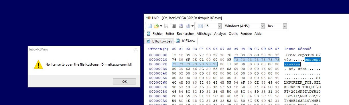

                            ssssssssssssss = nmlkzyxwvunmlk
                            look 9th
                            my decoder is bad
                            s : n m l x z y x w
                              look 9th
                              How did you do this conversion?
                              The mapping I have now ends after 8th
                              Code:
                              	 { 'n', 'm', 'l', 'k', 'z', 'y', 'x', 'w' }, // 's'
                                Code:
                                I force the number of characters to have the rest of the decoding
                                  Oh very smart!
                                    Based on your technique, it appears that there's 10 columns total for the normal letters; I'll code this up and see how it goes then.
                                      Oh very smart!
                                      ssssssssssssss = nmlkzyxwvu_nmlk
                                      ______________12345678910_1234
                                      you notice that after 10th it starts again
                                        exactly, we saw it at the same time
