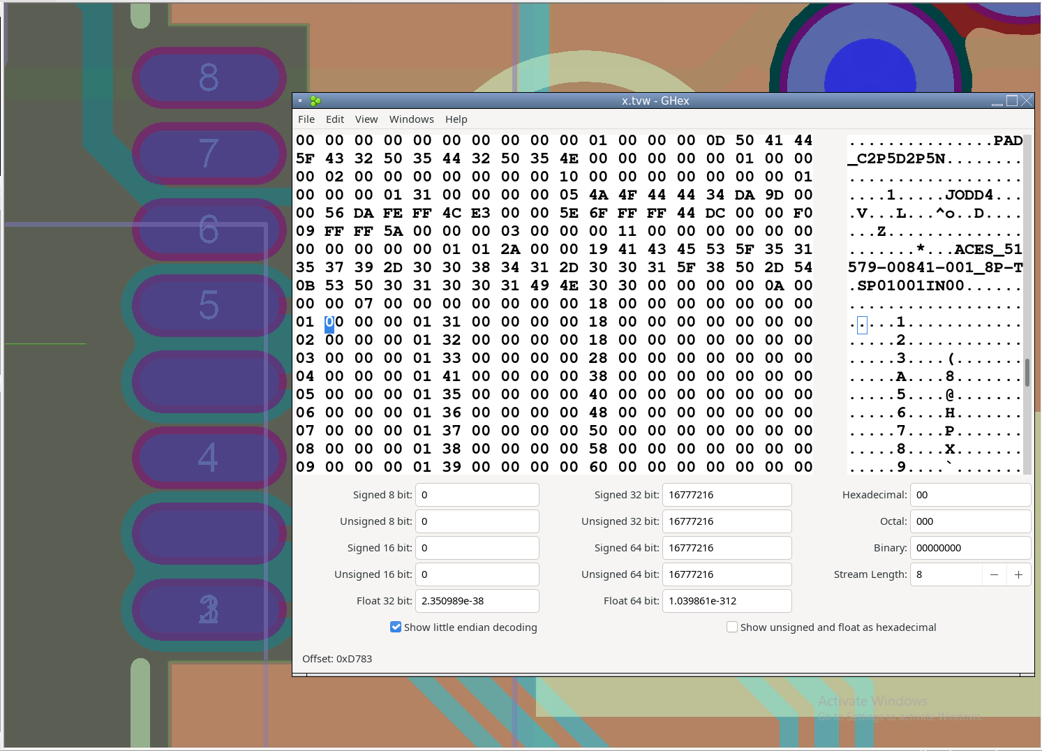

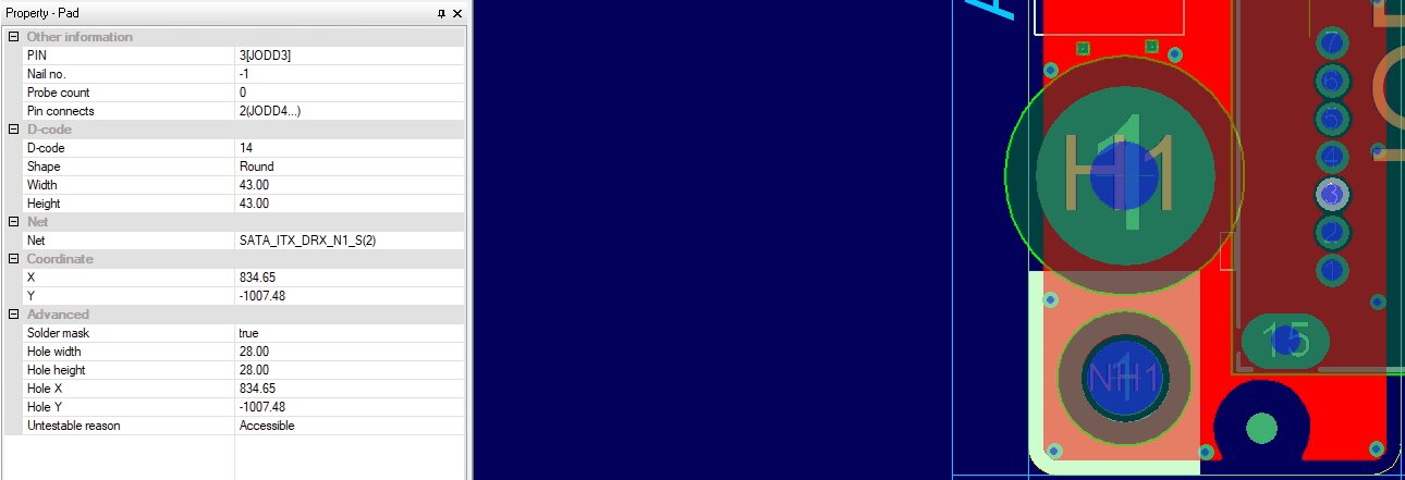

                Bit of an important breakthrough here.... the UINT32 I thought was the network number, I suspect it's actually a PAD INDEX, so the pad array is instead where we'll find the network name.
                I was tweaking values in the pin-index sequence of a part and noticed when I changed the UINT32 value to other existing values, the numerical index of that pin would appear in the respective pad.
                See the image attached.
                So in a way we've found that there is indeed an intermediate/translation table but it's a "PAD" array, and in there we'll find hopefully our network ID... now just to find that array :|
                NOTE/EDIT: Changing the value only changes the position for the display of the string, it's not changing the network or other details of the pad, so the index is just to point to the pad structure where to put the string, as opposed to changing which pad is *associated* with the pad.... so there may be yet another table.

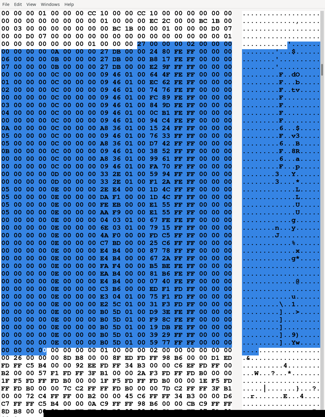

                          Re: WANTED: Teboview / TVW file format specification to write OpenBoardview decoder
                          Yeah that's a list of pad/lines/whatever, with the number of entries, some unknown uint32, then the net, the d-code id (starts at 10), then coordinates…

                            Any chance you can quickly just do a screen shot showing me a hex pad-block with the uint32, net, d-code ID, coordinate sequence?

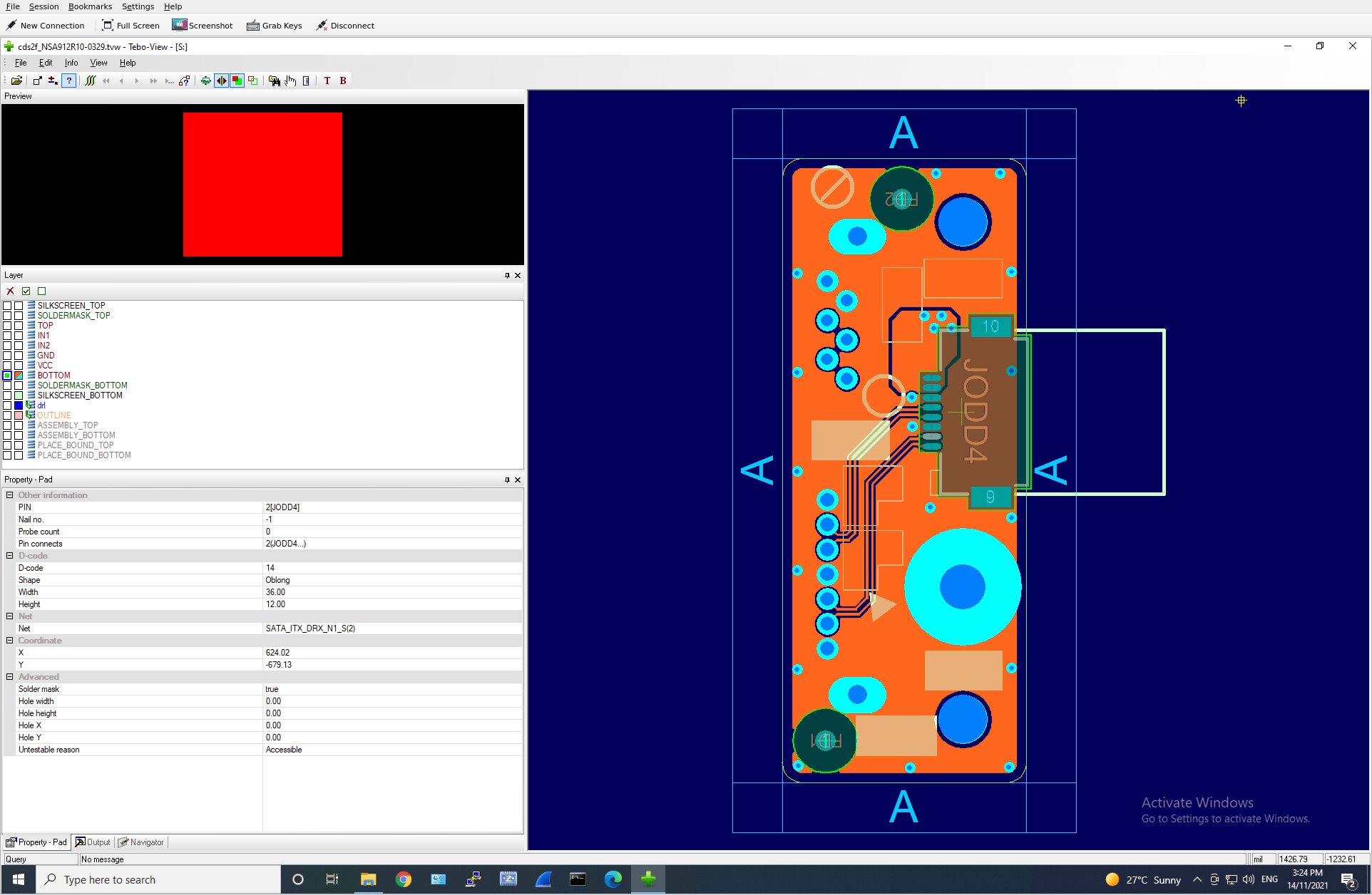

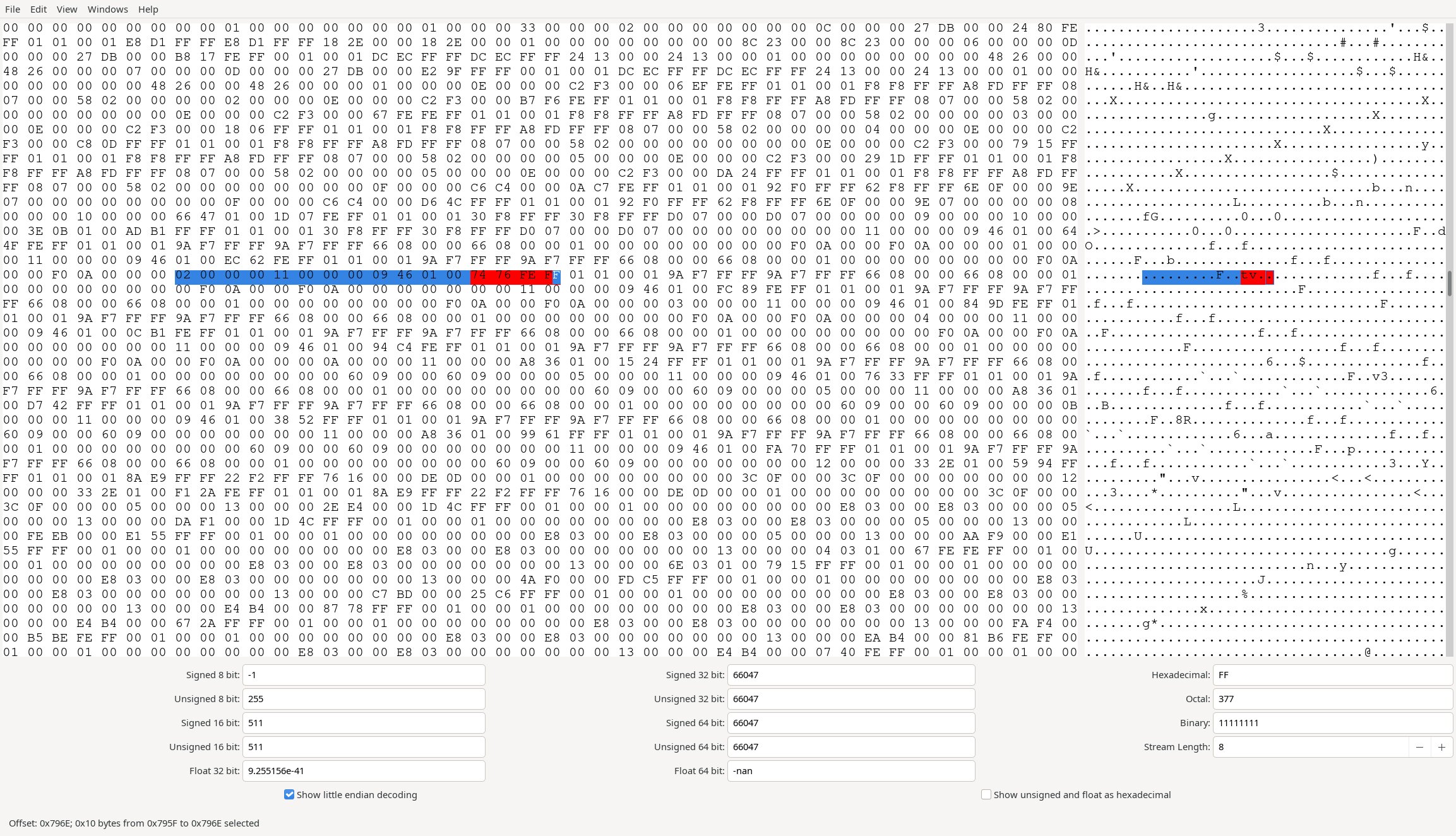

                              Okay, I worked it out, used the cooordinates to give me the anchor point for what you were talking about...and yes, now I see the network ID... HUZZAAARH!!!

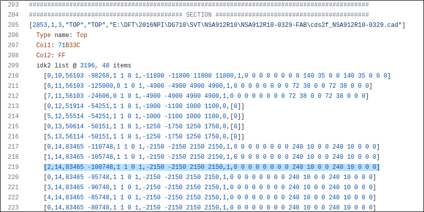

                                Here's a big file of things I've decoded so far in the cds2f_NSA912R10-0329.tvw file: https://gist.github.com/dzaima/b07e8...eea748b8c60ea2
                                Absolutely no clue what boards are or what the file represents, hence the very unhelpful names for everything, but decoding parts of a binary format seemed like a fun programming challenge.
                                Pretty much everything there is parsed starting from a hard-coded location in the file (in the log printed after "@"s, in decimal) as I don't know how the layer formats work, but maybe this can serve as a hint on what to do when encountering things for the people here who actually know what they're doing, and I've tried to lay out the structure of the various things I parse at the start of the file too.

                                  For example, at line 591 is the decoded values of the selected bytes in inflex's last message. The format that's in is described in lines 23-40.

                                      I forgot to mention, basically if you take the PIN PAD array ID, bitshift by 3 (divide by 8) it should give you the 0-based index of the PAD array in the layer it's present in/on.
                                      ie, Pin 3 of JODD3 has a pad index code of 0x48, >>3 and we get 0x09.
                                      if we then look at the TOP layer pad/item array, we see the 10th item ( remember, 0-indexed) it's the right coordinates and show's a network index of '2', which is correct according to the TBViewer suite info panel for JODD3:3
                                      So that essentially all ties it up.
