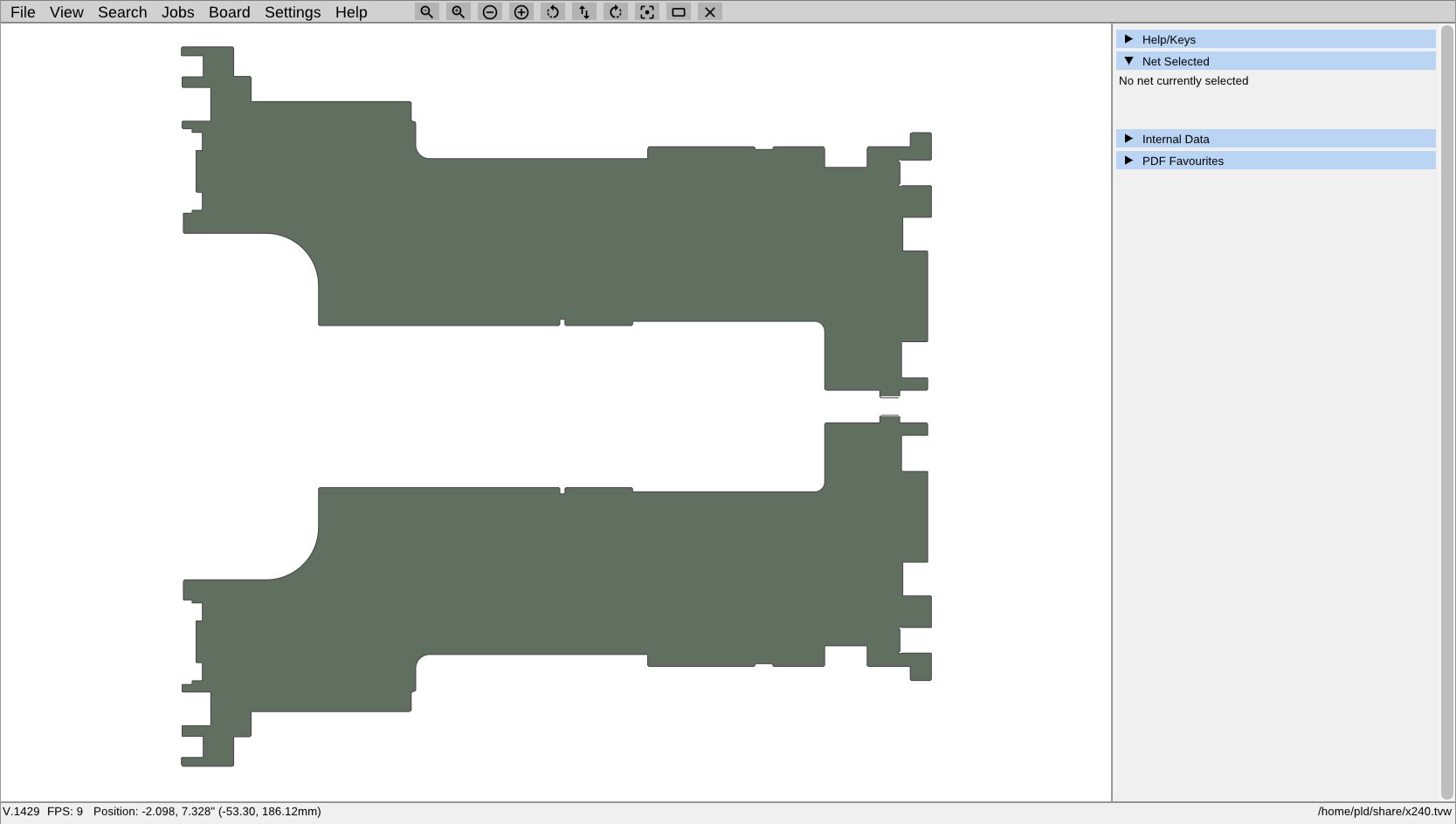

                      I present to you... the very first image for TeboView decoder for FlexBV.
                      This is actually a board outline for the Lenovo X240 Yoga board.
                      YouTube Repair Videos - https://www.youtube.com/user/19PLD73
                      FlexBV BoardView software - Linux/OSX/Windows - http://pldaniels.com/flexbv
                      • inflex
                        • Aug 2012
                        • 545
                        #51
                        Re: WANTED: Teboview / TVW file format specification to write OpenBoardview decoder
                        Interestingly, our sample file had a more complicated outline routing system. There's some segments that are prefixed with 0x08 instead of 0x0A, and with those you read only 2 int32's after the tool int32, and there's no trailing 0-value uint32.
                        I'll add that in to the documentation later.
                        I'm sure there's other little traps like that out there but we'll find them in due time.

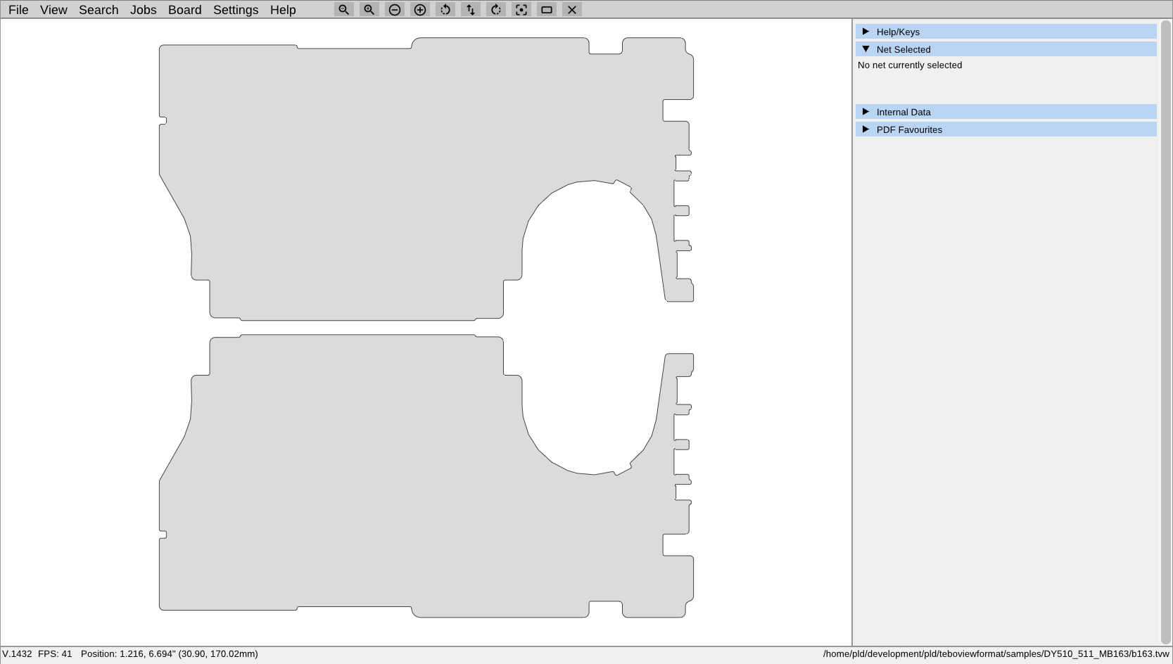

                                  • RethoricalCheese
