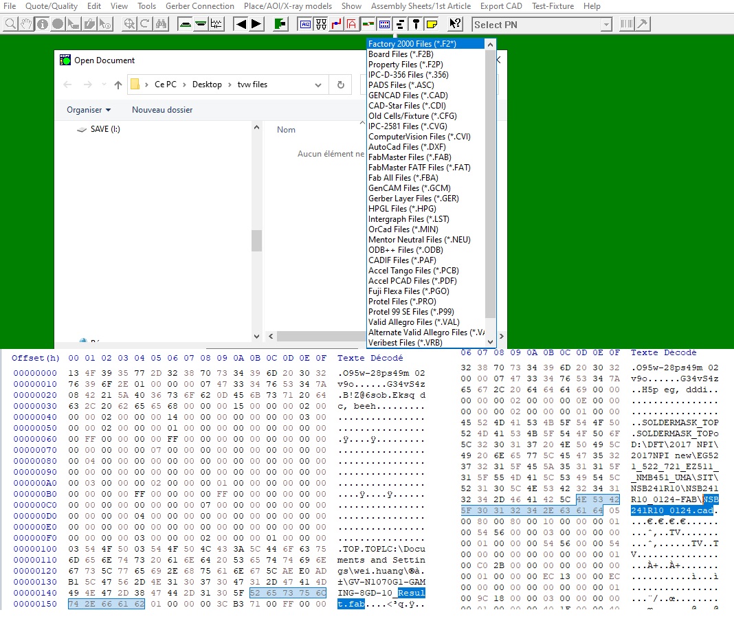

    SUCCESS!!! Finally. That was fiddly.
    The key was that digit (plain) to encoded you have to use 3-rotate, but for alpha (plain) use 10-rotate.
    EDIT: okay, not *quite* success yet, the date is wrong... should be July 26, 2016 :sigh:
    Header 1: 'O95w-28ps49m 02v9o.' => 'Tebo-ictview files.'
    Owner: 'G5u9k8s' => 'Landrex'
    Password: 'B!Z@6sob' => 'G!G@byt3'
    Date: 'Eksq dc, beeh' => 'July 21, 2908'

      Re: WANTED: Teboview / TVW file format specification to write OpenBoardview decoder
      NOW it's fixed....
      Date: 'Eksq dc, beeh' => 'July 21, 2016'

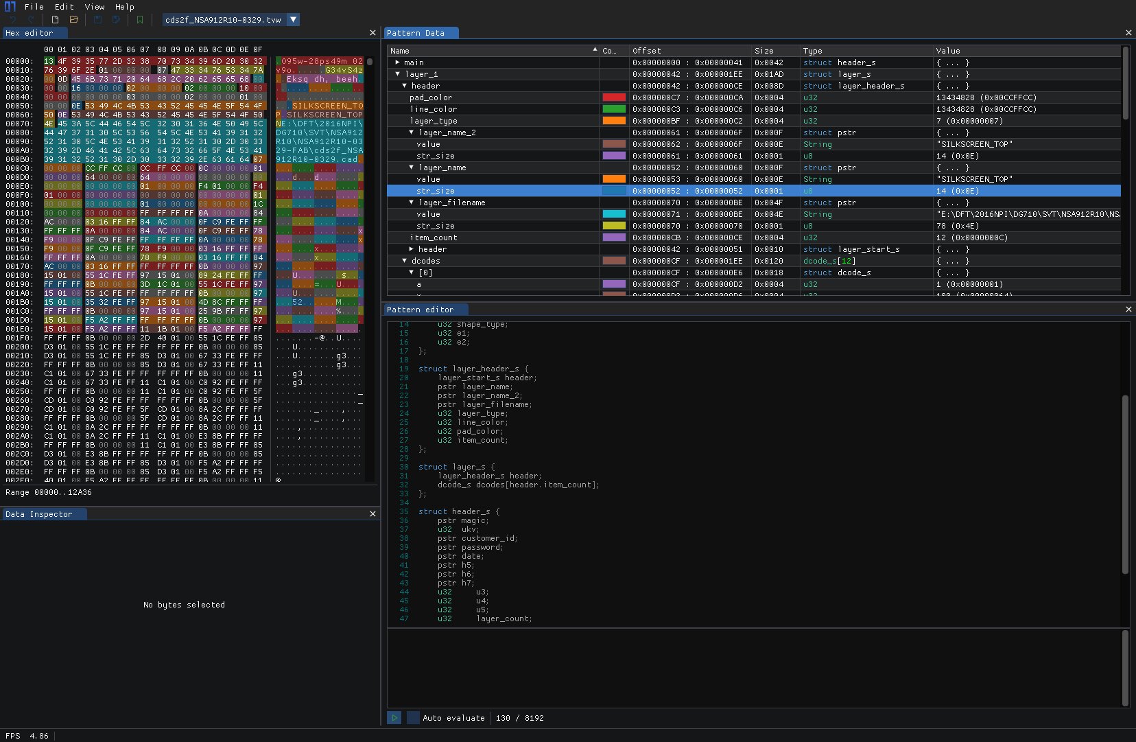

          I've been going back over your python dump_tvw code and migrated a lot of stuff in to my C decoder and things are starting to come together (sadly the whole pins/parts on the boardview won't really happen until right at the end ).
          ie, here's a dump so far of what I've got with the B562.tvw file ( managed to get the nets out on this one ).
          Still some issues with parsing on more complicated boards with different pad options / types and still haven't worked out the block of data after the nets but before the part:pin definitions (with all the probe data).
          YouTube Repair Videos - https://www.youtube.com/user/19PLD73
          FlexBV BoardView software - Linux/OSX/Windows - http://pldaniels.com/flexbv

            Do you have any information on this type of files .cad and .fab ?
            Do you think that it is possible to extract and try to read with another viewer.
            It would seem unisoft and fabmaster would be the only ones to do this work maybe?
            it might be easier to retrieve the right information
            https://www.unisoft-cim.com/pcbview.php
            https://smtnet.com/company/index.cfm...mpany_id=41319
            I think you have already done research on this side

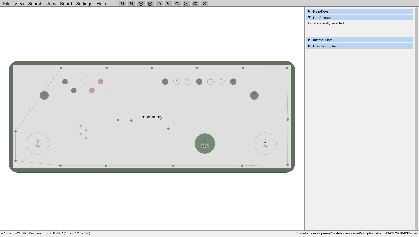

                Have the preliminary DRILL layer sorted out now, and that also makes my first connection with the nets.
                03H30 roughly... spent too much time on this tonight and a lot of kludging, but at least the hole sizes are about similar to the tool sizes and the netnames are correct too.
                Small celebration.
                (edit: tebo uses diameter, I use radius... fixed by /2 )

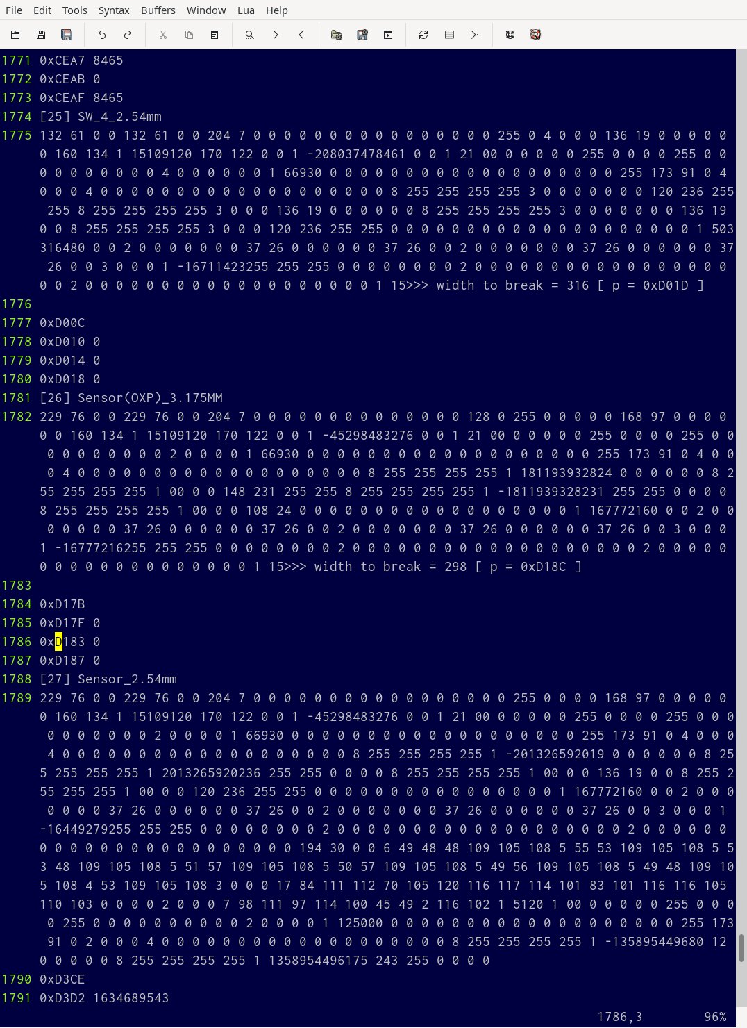

                    I swear I need to write a hex-editor just for these types of jobs
                    ie, so I can do a N-way comparison between starting points in a file and see where the divergences are.
                    wxHexEditor comes close but it also is buggy/odd on linux.
