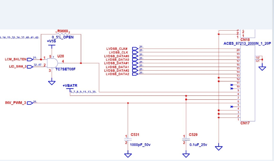

    Here's the schematic I'm using:
    The component names match up to what is on the motherboard itself. That is to say - they mostly do. This schematic is for a HP 540, but I tried hard to find one for a 550 and I just can't. To make things more interesting, sometimes I see this same schematic listed as applying also for the HP 550.
    Using the HP 540 schematic I see that the pin with the missing voltage is pin number 9 on connector CN17. This is shown on page 30.
    Looking at where pin 9 goes, it should lead to a Q61. Now that's the issue. There is no Q61 on the motherboard. Trust me, I didn't do a half assed check to find this thing. I looked over the entire motherboard for well over an hour as I was convinced it had to be there. It isn't. I searched for the resistors connected in series with Q61 (R9613 and R9614) but those were nowhere to be found either.
    I did find U28, but its fourth leg is connected to R15, not R9613 like the schematic shows.
    Do I really have the wrong schematic? So many other parts match up perfectly.

            Hello there AtomDesign! I have the exact same issue and want really to get to the bottom of this! I have also replaced inverter, cables and compatible screen with no avail. Still the same. Picture is on but no sign at all of backlight! I have measured input pins of inverter and can see one pin that has 3.3V and 2 pins that have 19V. Can you tell me your voltages in more detail to be able to compare? Thank you and I will try my best to fix it and help!
            • Dimitrios
              • Nov 2013
              • 127
              • Greece
              Re: HP 550 schematic
              An update! I too confirm that the problem lies on pin9 CN17 but cannot find the path. I also find U28 but voltages are not the same as the schemtic. I think in this part it is somewhat wrong! Have a look on my findings!

                If you can measure +5S at pin 2 of mosfet pmv65xp, and cero volts at pin 1, you should also have 5 volts at pin 3, otherwise this mosfet (q61) could be already damaged.

                    Looks like you reading is off. You got 3.3v at pin3? Or you mean pin 3 is 0v and pin 5 is 3.3 which according to your schematic is connected to +V5S?
                    You can trace where LCM_BKLTEN is coming from and find out why it is giving you 5v. If the output of the NAND gate is 5v at pin 4 of U28, Q61 will turn on and gives 5v at its pin 3.

                      Thanks for answer. The reading is correct and taken when laptop was in power ON. My guide was the official pinout that I embedded below of the chip. The thing is that there is nowhere to be found the rest of the components to try and test them. the LCM_BACKLTEN is coming from Northbridge which also has integrated the GPU. The schematics are wrong in this part (it is from HP 540) but nonetheless the chip should have Ground on pin 3 because of its design. The best thing I can do since I can't find Q61 is a reflow of southbridge and hope that the fault was coming from there...

                            One of the diagrams, Q61 is not mounted, and output from U28 is connected directly to CN17.

                              Did the readings again and are still the same. Even when power off the readings are the same. Two 5V and one 3.3V, one Ground and one 0V maybe the output but on different pins. Both diagrams are the same for U28. Maybe this is faulty??

                                The schematics are wrong because I found that U28 does a completely different job. I traced the resistors around and can confirm that it is a part of battery charging circuit on page 5 of 48 of the file HP Compaq 540 – 6520s – 6720s schematics (Inventec DDD UMA).pdf as is already uploaded on the 4th post.
                                This is a pic of circuit:
                                and the specific diagramm that corresponds to it:
                                You that the voltages are now correct so there is a problem in Northbridge!
                                      This diagram is the one I am referencing to.

                                        Yes I know but it does not corresponds to HP 550 motherboard. R9669 is NOT linked with U28 after checking thoroughly with multimeter. U28 is the U6 in diagrams after excessive examination and path tracing with multimeter. Notice that U28 is located in an exact near position between D2 and R15, R45 and C503 like the diagram. Also the voltages are confirmed with my diagram and final conclusion is that U28 is the U6 on diagram. This relation corresponds only to HP 550 motherboard and HP 540 diagram which is the closest but not the same.
