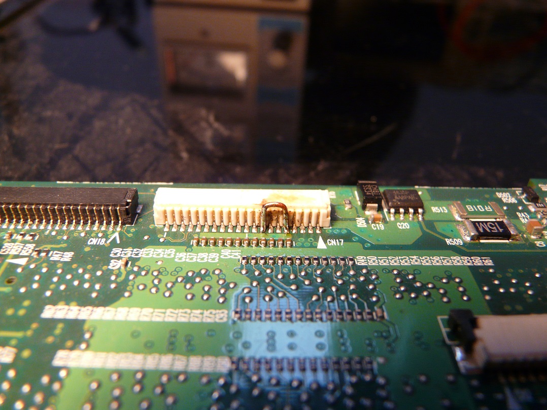

            Sorry to necropost, but it pertains to this specific thread so hopefully its ok.
            Yesterday, I came across a box containing two HP550 with a malfunctional backlight. I didn't realize it was nearly 1.5 years ago when I last looked at these and started this thread. I now see that Dimitrios attempted to fix a similar schematic deprived HP 550 and failed in the end. Probably a good choice, I took way too much time on this one.
            Back to yesterday.. I decided to simply find the CN17 connector pin going to which looked like it needed a voltage, but had none.
            Using a small lab power supply I then gave this pin ~3 volts to see what would happen. Voila, backlight on!
            I still wanted to fix this properly, so I soldered a small wire to this pin and attached it to my multimeter. Lacking a correct schematic, I decided to systematically check every single component on the motherboard for continuity. Having painstakingly done that (twice) and finding nothing, I gave up and soldered a bridge from pin 5 to pin 8. (stupidly enough, I can't remember which of these two pins already had the 3.2V on it and which one lacked it. I think pin 5 had the voltage it should.
            I 'fixed' both laptops this way. I have them on windows 7 now and they both run fine. The repair is a hack, but it works, and its nice to finally have that 'fixed it!' feel. And who knows, maybe someone else can use this to fix their laptop.

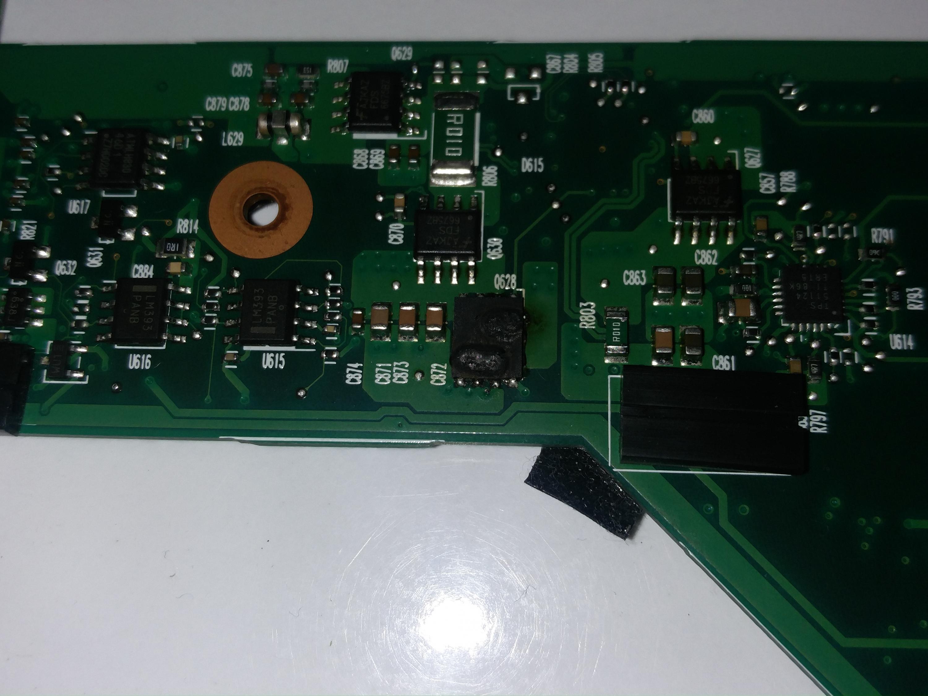

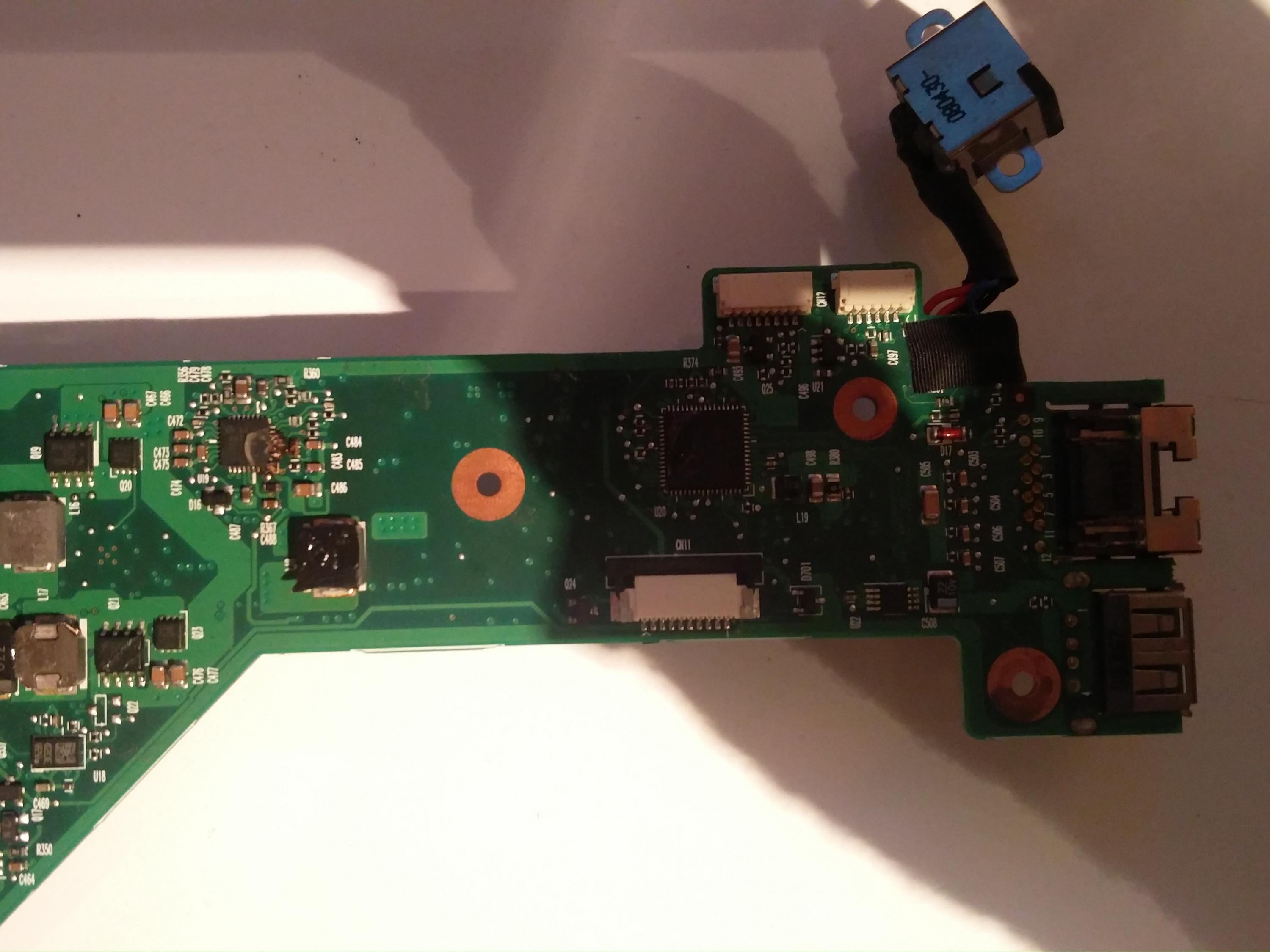

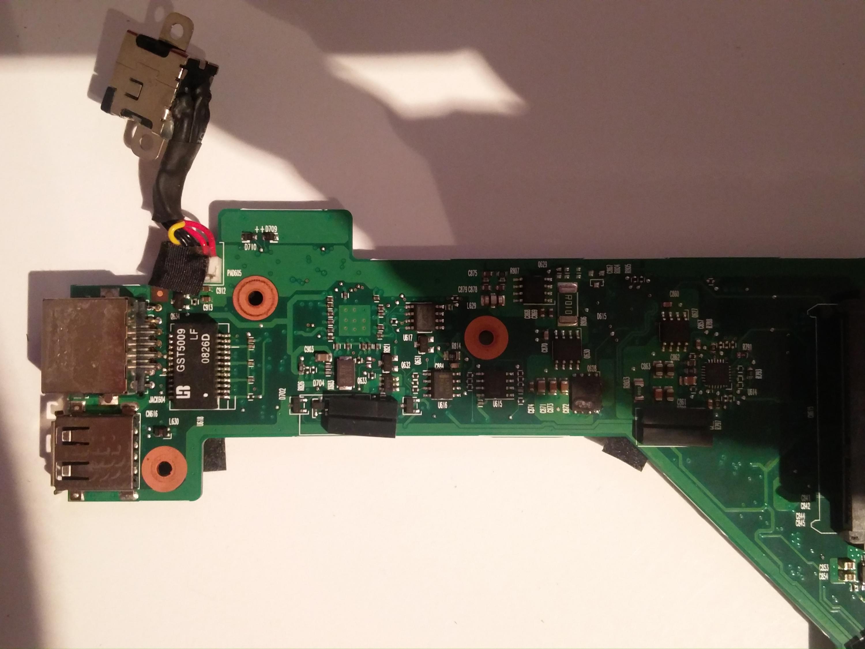

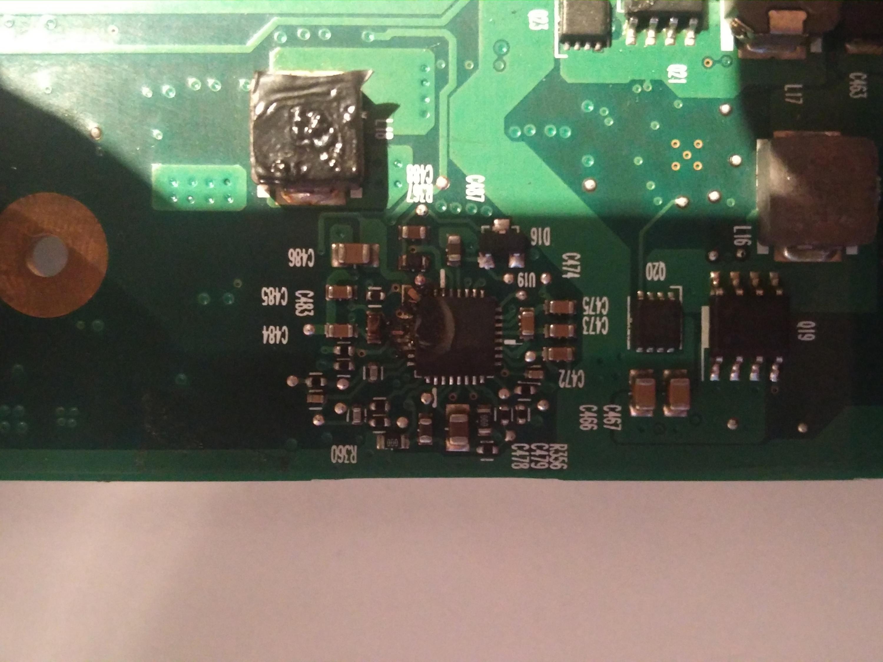

                Hi!
                My problem is different but I'm Grabing this post because the motherboard I've trying to repair is exact the same you have. Please can someone tell me what is the reference of the IC U19 and Q628? They are burned as you can see in the photos I'm attaching with this.
                If someone can help me I appreciate! Regards

                  Re: HP 550 schematic
                  Originally posted by emoniz
                  Hi!
                  After some search to find the short circuit after removing that two IC, i still have short and the hot goes to graphics card NVIdEA GRrRRR.
                  If someone still have schematic, it can be usefull to solve other problems in this motherboard, If i still want to repair this one, i need to have the reference for that burned IC's.
                  Regards
