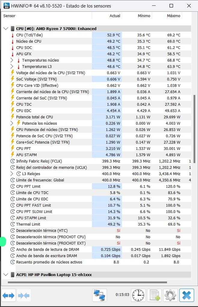

          Another thing to look for is PROCHOT#

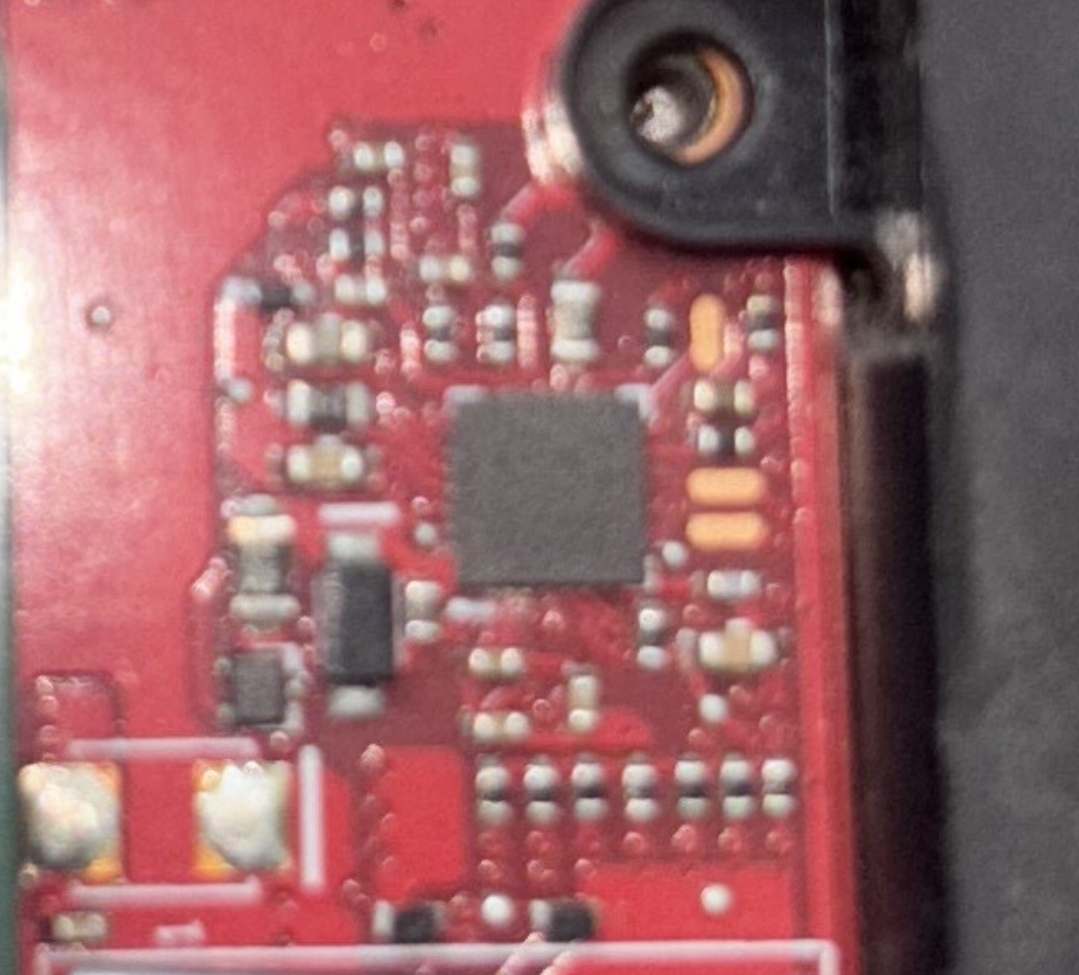

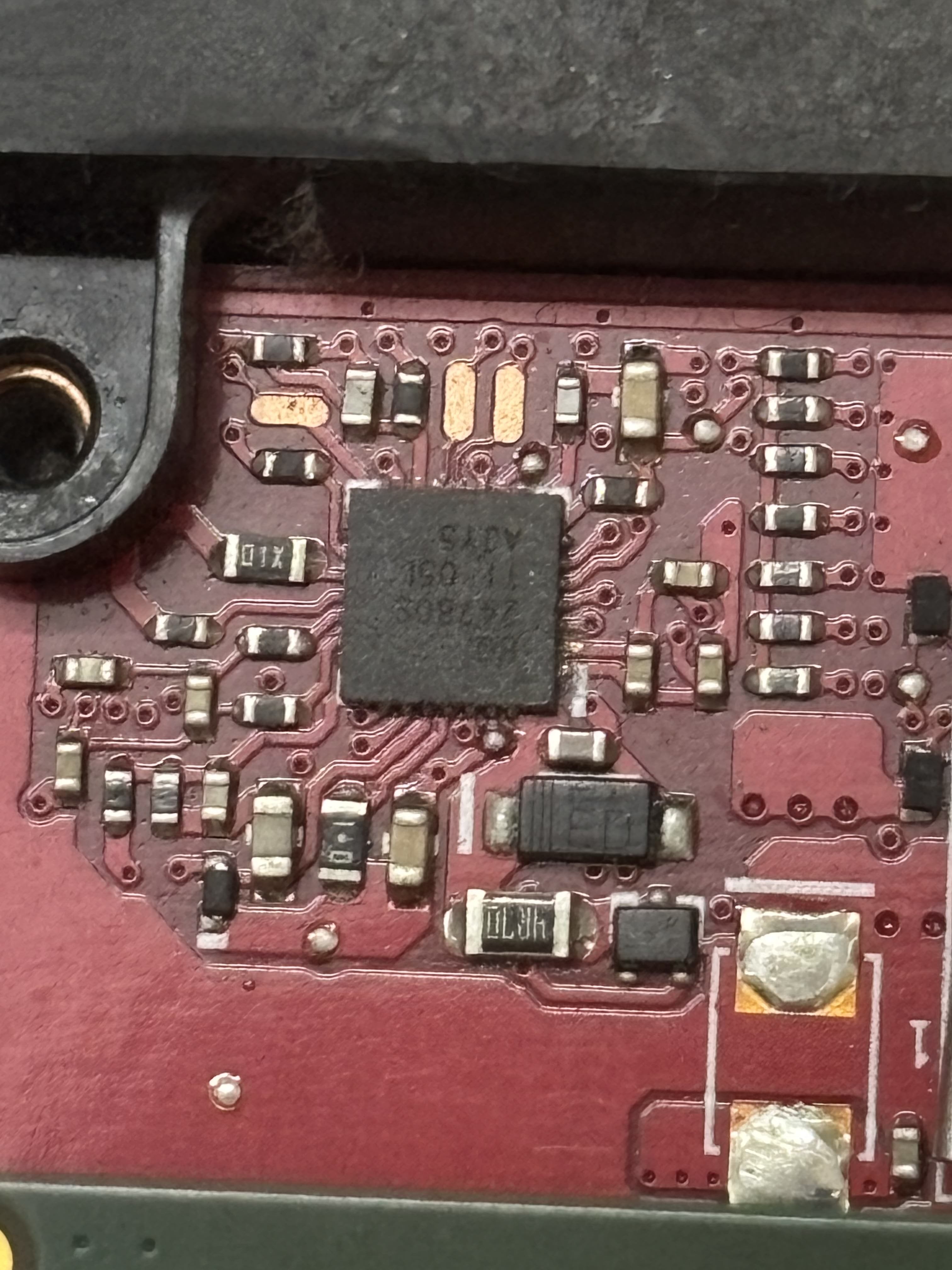

                Share a picture of the charging controller and surrounding circuit please. We will find suitable measurement points.

                • m1ch43lzm
                  • Mar 2019
                  • 883
                  • Peru
                  Ryzen CPU? You can download HWINFO64
                  https://www.hwinfo.com/download/
                  Get the portable version, open it and select "Sensors only"
                  Then scroll down until you get something like this
                  If it shows PROCHOT_EXT as "yes", that's the issue
                  Another thing to look for is the CPU will be stuck at 400MHz
                  It happened to me on a HP laptop, could be anything like a bad pull-up resistor on that line, to an IC pulling down the line for whatever reason

                    Do you think that PROCHOT could be the reason? I'm asking because the battery is also not charging properly and very slowly. If prochot is the issue, the battery should charge at normal speed when the pc is off?
                    I formatted the SSD but couldn't install Windows on it because of system running very slow to check prochot I will have to install another SSD on it.

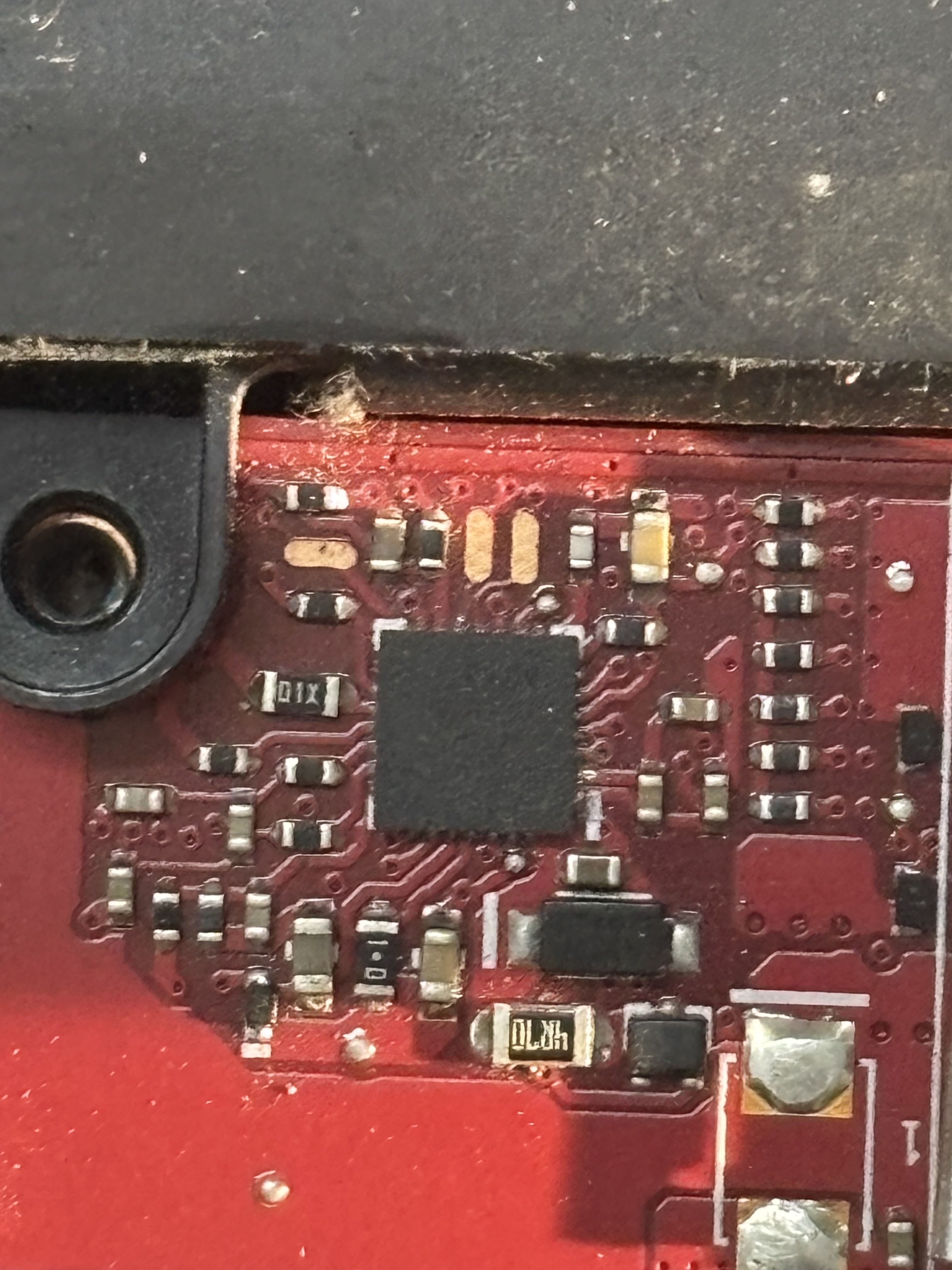

                        I measured the resistance between pins ACN and ACP pins it was 0 ohms. Though I am still not sure of the readings. I am attaching pictures of the motherboard and the schematics is attached above.

                          Closer and better quality please

                          • MakNCheese
                            • Jun 2025
                            • 11
                            Will these work?

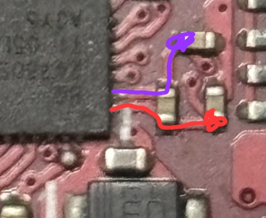

                              • Sephir0th
                                • Oct 2020
                                • 1289
                                Originally posted by MakNCheese
                                Will these work?
                                It's just needs to be visualized what connects to where. So instead of to measuring between ACN and ACP directly you can measure between these two points.

                                • MakNCheese
                                  • Jun 2025
                                  • 11
                                  Thanks mate. Checked these points and ACP and ACN points directly. The resistance between the two comes out to be 0. Continuity is there too

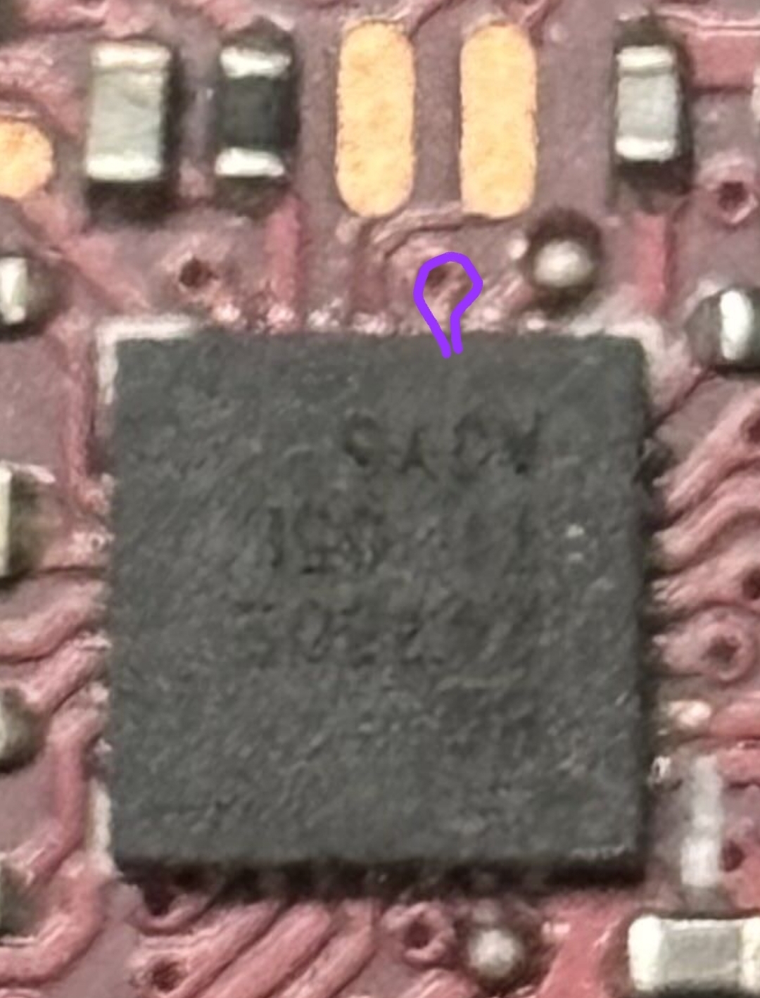

                                  • Sephir0th
                                    • Oct 2020
                                    • 1289
                                    Okay, let's check voltage of PROCHOT# then. Unfortunately this becomes more complicated since there is no nearby component where we can measure. So either you move carefully and with thin probes to Pin 10 directly or you carefully scrape the mask of the via to make this track better accessible.
                                    The important part here is a) to perform this test with the board powered AND turned on and b) to not slip with the probes...
