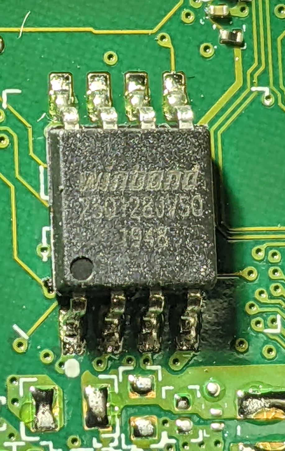

      Thanks for the tip. Wasn't aware of this tool, it looks great. I'm wondering though if it works for power on passwords or only BIOS password lock? I can see that it says "missing unlockable content" if I drop my dumped bin file onto it. When I open the bin I uploaded in UEFITool it appears to be structured like a valid BIOS dump, from what I can assess based on my limited familiarity.

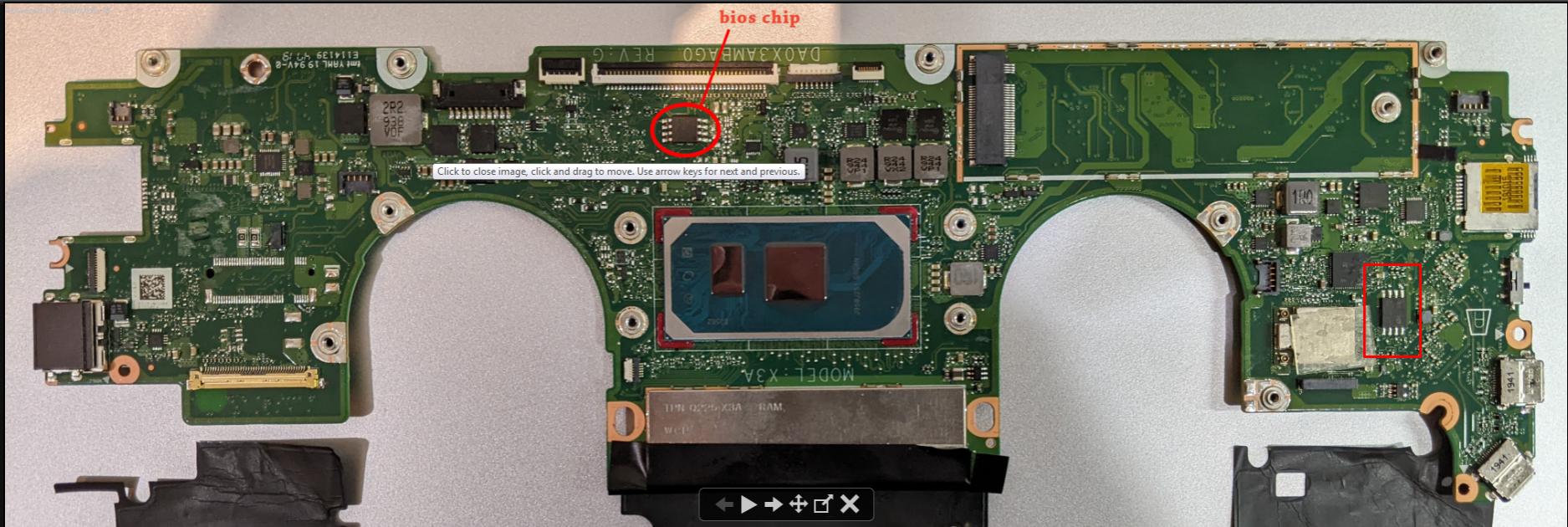

      I've attached pics of the Winbond chip I dumped and the only other two that look like possible alternate BIOS chips, Winbond 25q80dv1g and MXIC mx25l8008ezni.

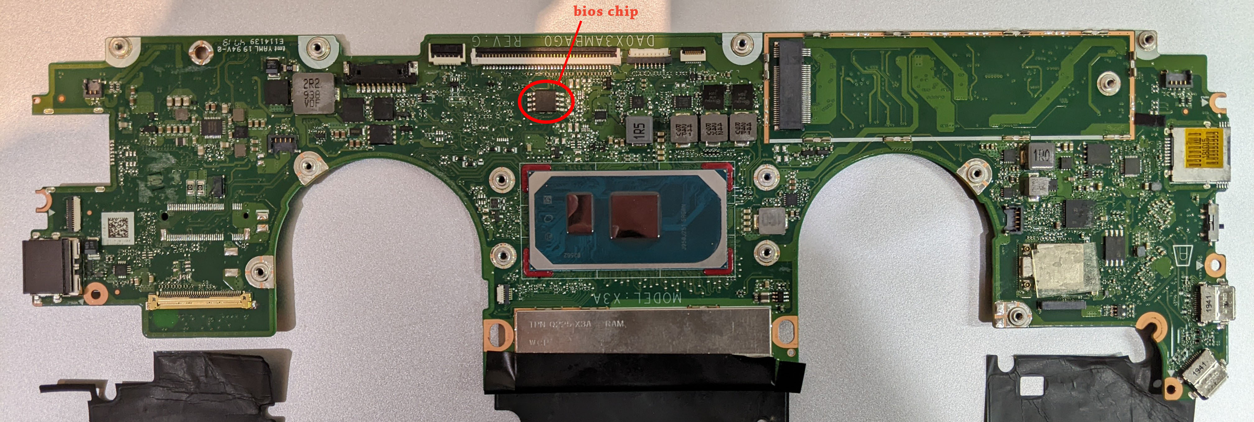

                Re: 13-aw0023dx BIOS PWD Removal
                Main BIOS chip is highlighted. Is there another chip I need to dump / reprogram?
                  Check this marked one.

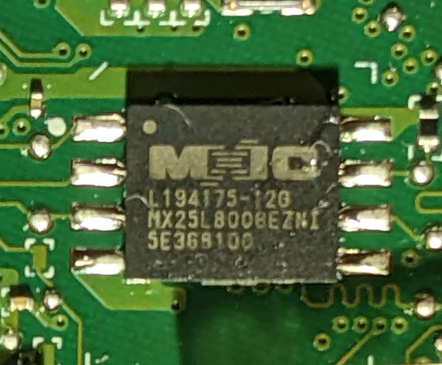

                    OK, that highlighted chip is an MX25L8006. A dump is attached
                      Anyone know what purpose this MX25L8006 chip serves on this board?

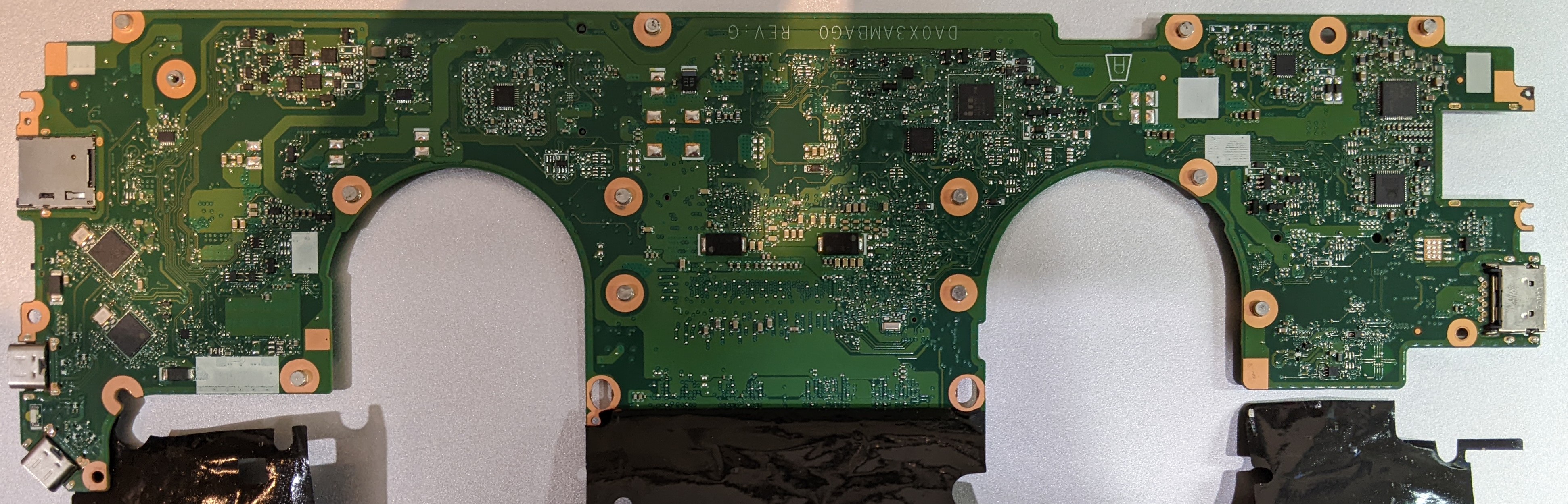

                        MX25L8006 is not bios chip. Check below picture, it's look like a WSON chip. Lets me know name of that chip

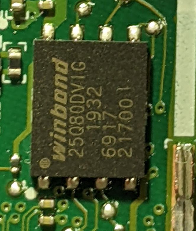

                          I've attached a photo indicating the chip model for the two WSON chips on top of board.
                          • hoaca388
                            Badcaps
                            • Jan 2022
                            • 11624
                            Try read data of both wson chips.
                              Dump of 25q80dv is attached. I uploaded dump of mx25l8006 in a previous post.
                                If your model is HP Specter x360 - 13-aw0023dx, chip bios must be 16MB (eg 25Q 128.. with Winbond chip).

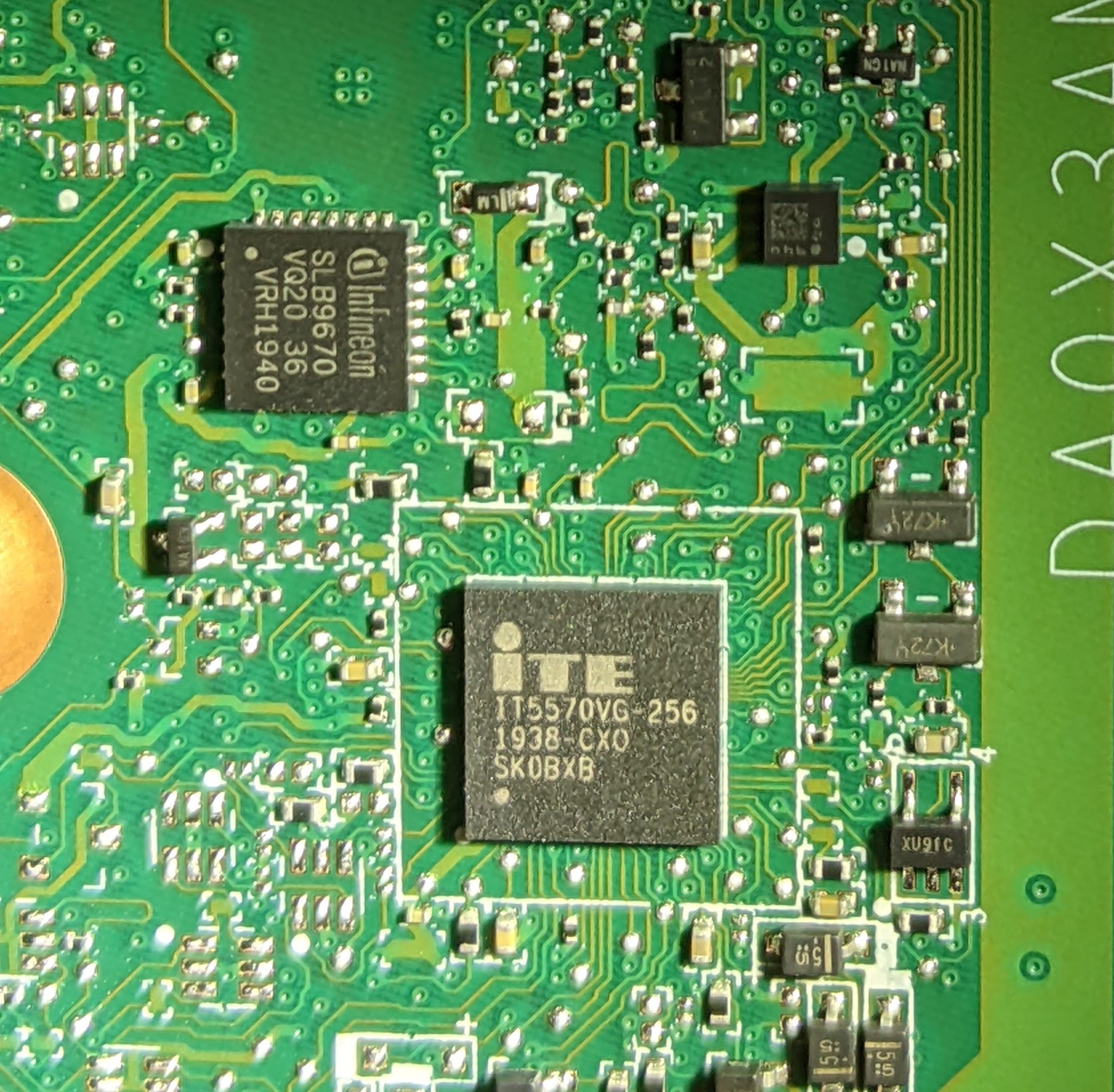

                                    I tried the bios dump you posted, hp-13-aw0023dx-pwd-unlocked.zip, but get only quarter fan spin and short power cycle, no post. You also posted this EC bin file however, but I'm not sure which chip this is for?
                                    On the bottom of board there is SLB9670 TPM chip next to IT5570VG-256
