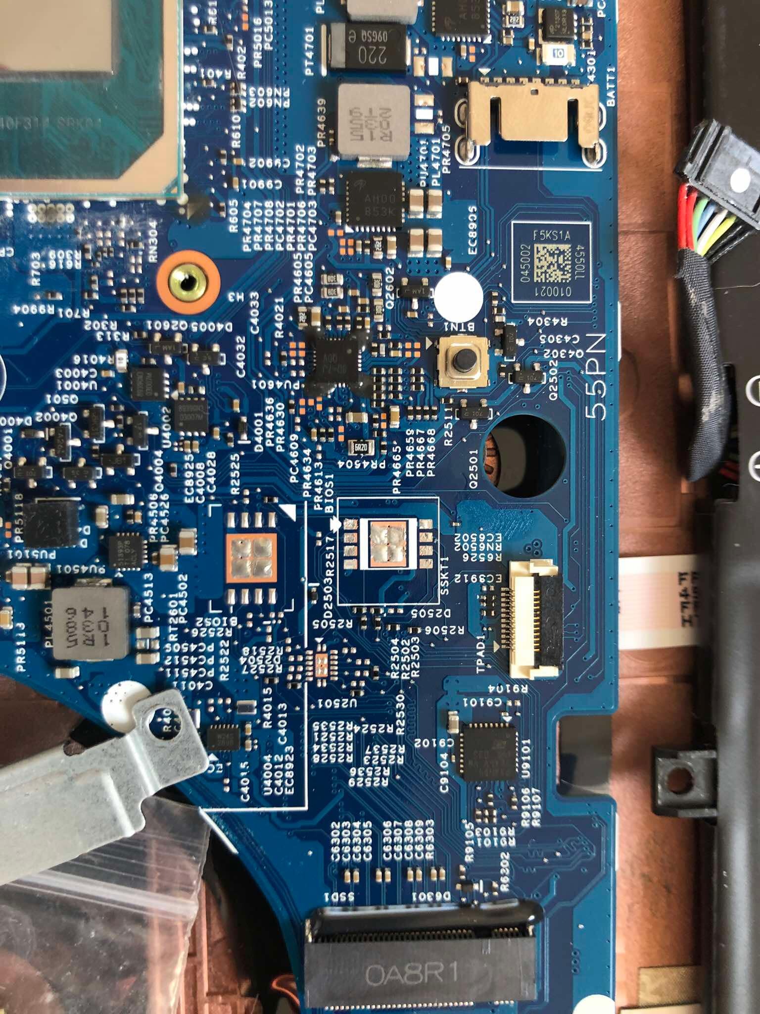

                      Thank you in advance!
                      Click image for larger version  Name:	fe47d915-f606-4dad-97e3-26964a95828b.jpg Views:	0 Size:	391.0 KB ID:	3628768
                        SMDFlea commented

                      #91
                      Originally posted by PMDev
                      This motherboard has two BIOS chips. I have the first one (BIOS1), but the second chip (BIOS2) is physically missing from the board and I believe I will need to order and program it myself.
                      Details:
                      - BIOS1 chip: MX25L25673GM2I-08G
                      - BIOS2 chip: missing
                      Only units with vPro CPUs are supposed to have 2 chips (i5-1145G7 and i7-1185G7), the rest of them only have one. Open the schematics and you will see. Or check images on Lenovo's parts catalogue.

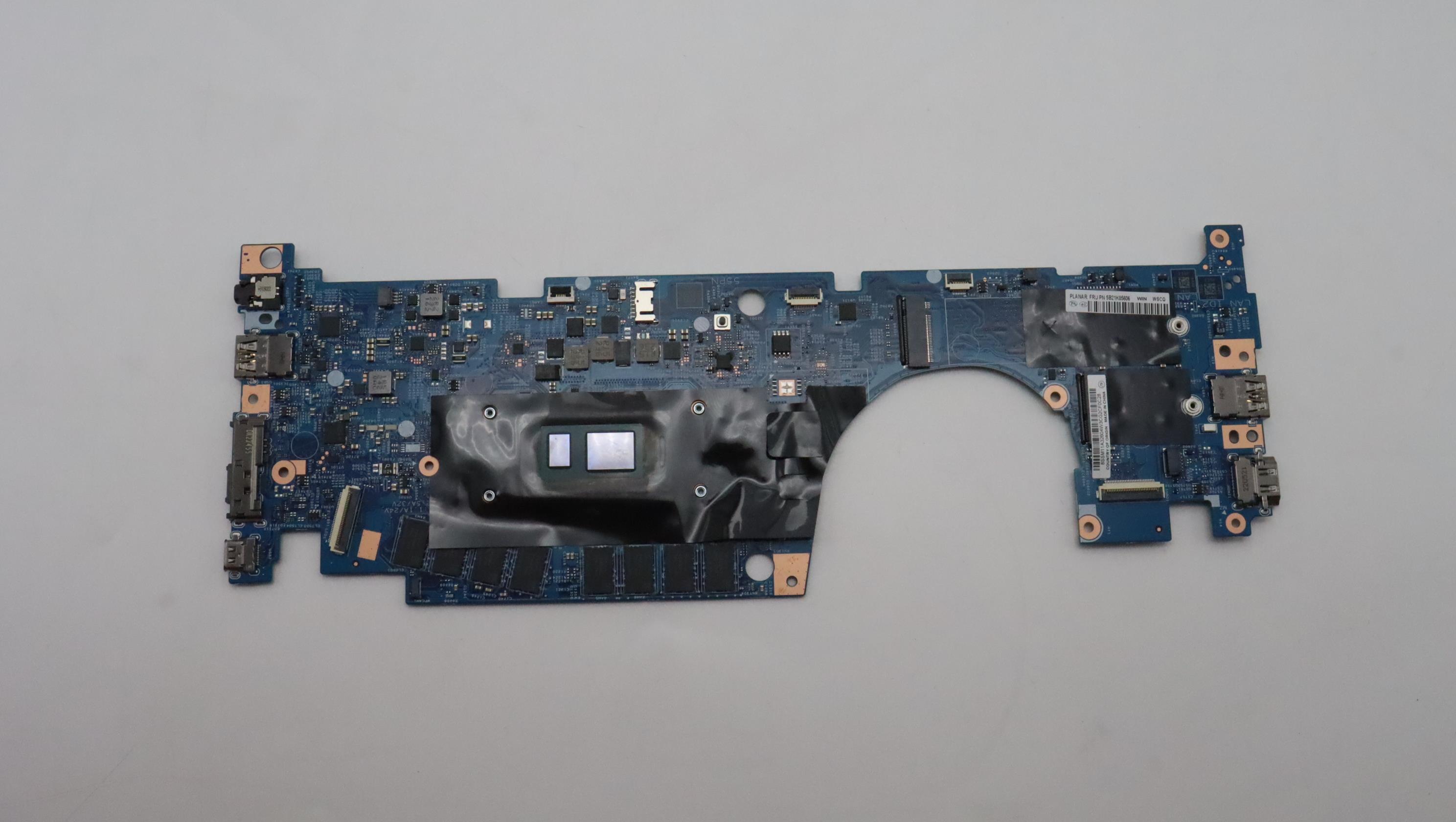

                          I got a problem because when I turned it on there is only a beep melody on the beginning and laptopt turn off. So that why I was thinking about the second chip.
                          There is an app called Lenovo PC Diagnostics. It can decode the beep melody into an actual fault code. So I'd start from there.
                          And here is the picture of your board from Lenovo (FRU: 5B21K85606)
                          As you can see, there was no second chip. I believe there has to be some design flaw with L13G2, cause you can see dozens of them dead on eBay. Maybe it is a soldered ram that needs a reflow, maybe something else. I have no idea. In any case, there is more than enough working bios dumps for a board like yours on this forum. Give them a try. Even without cleaning ME region, the board should start. It is gonna post with a significant delay, but nonetheless, a donor BIOS should work if the hardware is functional.
                          You can use this link https://pcsupport.lenovo.com/us/en/warranty-lookup#/ to verify that you're picking the right donor. Type in the serial, go to Parts - As-Built and filter by Logic boards. There were at least a few of them with i5-1135G7, and i7-1165G7 should also work.
                          Also, just in case if you're not sure whether your screen is in good shape or not, you can try the built-in LCD test. With a charger connected, press Fn+CTRL+power. Damaged/dead screen or cable may result in it playing a tune. Or you can try hooking it up to an HDMI screen with the LCD cable detached from the board.
