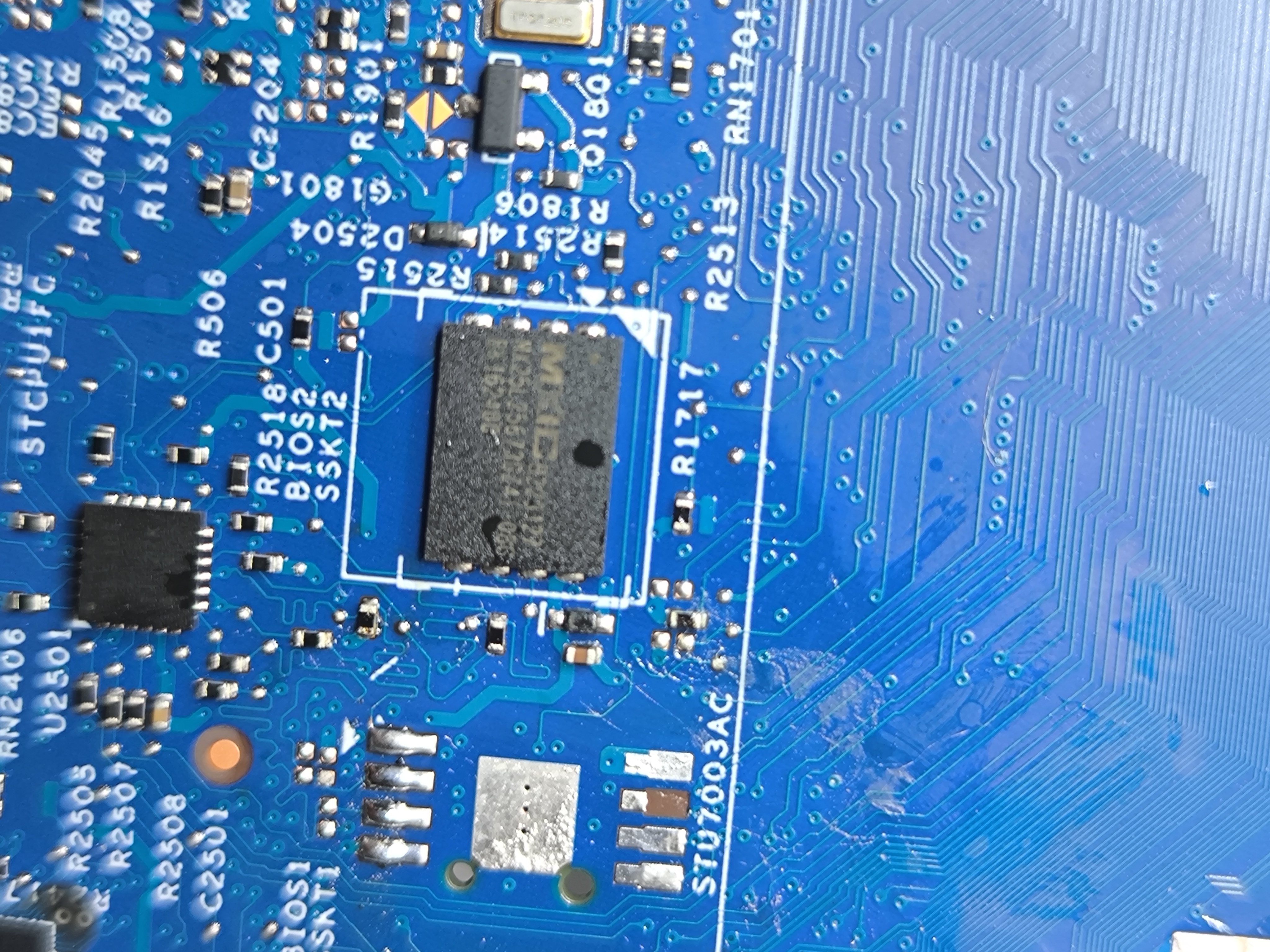

    motherboard: LG4 LT5 ADL RT UMA MB 8L - 448.0PZ26.0011
    IC Bios 1: MX77L25650F
    IC Bios 2​: MX25L25673G
    EC Chip: NPCX997KAABX

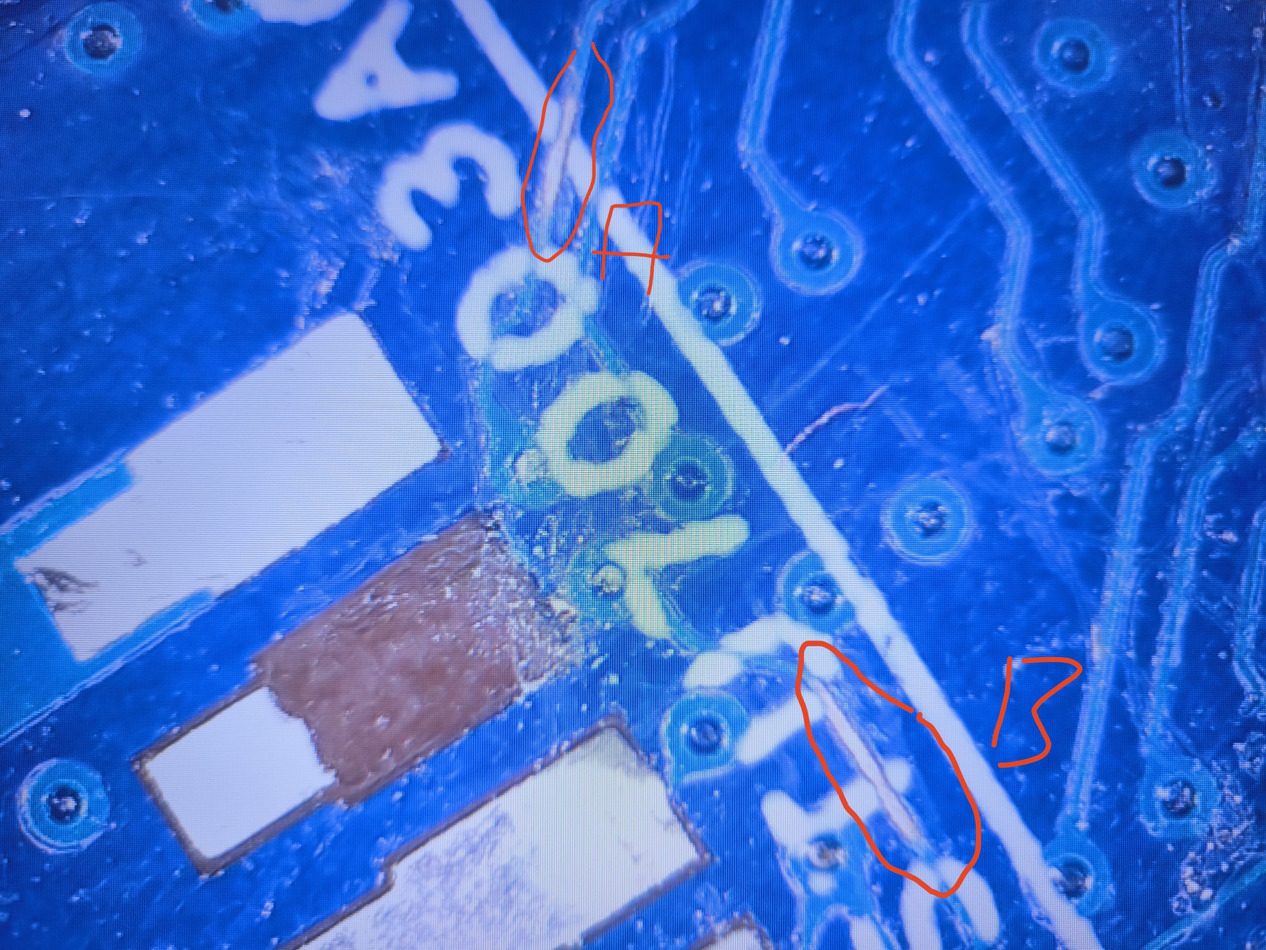

    So far I've been a silent reader, but now I need your help
    I bought a laptop. The seller said the bios was locked. I was looking for a way to remove this ban.
    I then got the CH341A and pulled the corresponding files from here https://www.badcaps.net/forum/troubl...en-3-need-bios
    Laptop arrived and i ​t then turned out that the laptop also has a supervisor password.
    Okay, one thing at a time, first remove the bios password.​
    I started to desolder the bios chip and a pad tore off, see pictures. Unfortunately, I was no longer able to understand whether there was one or two connections on the pad.
    Klicke auf die Grafik f?r eine vergr??erte Ansicht  Name: 001.jpg Ansichten: 0 Gr??e: 2,97 MB ID: 3551334

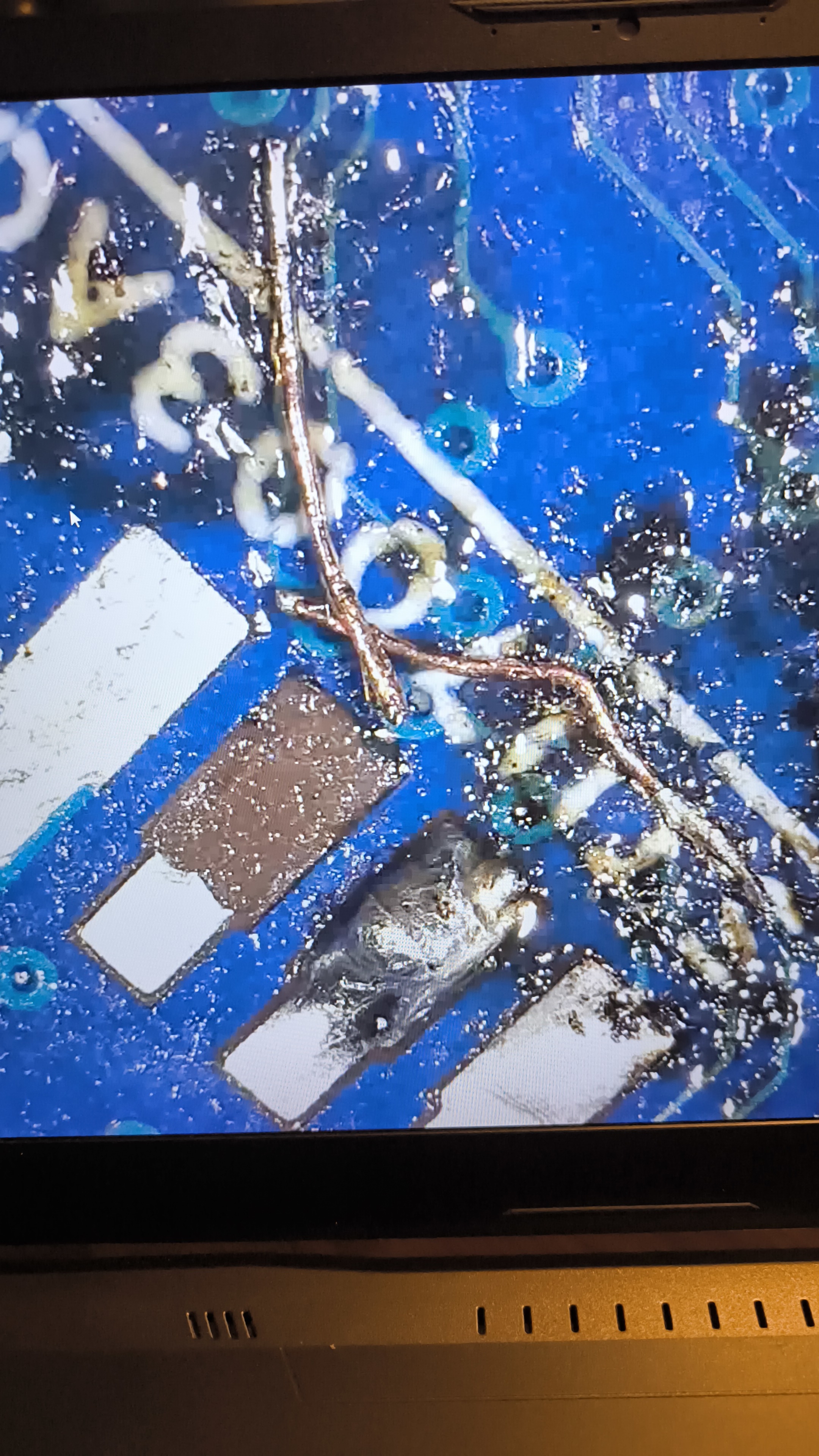

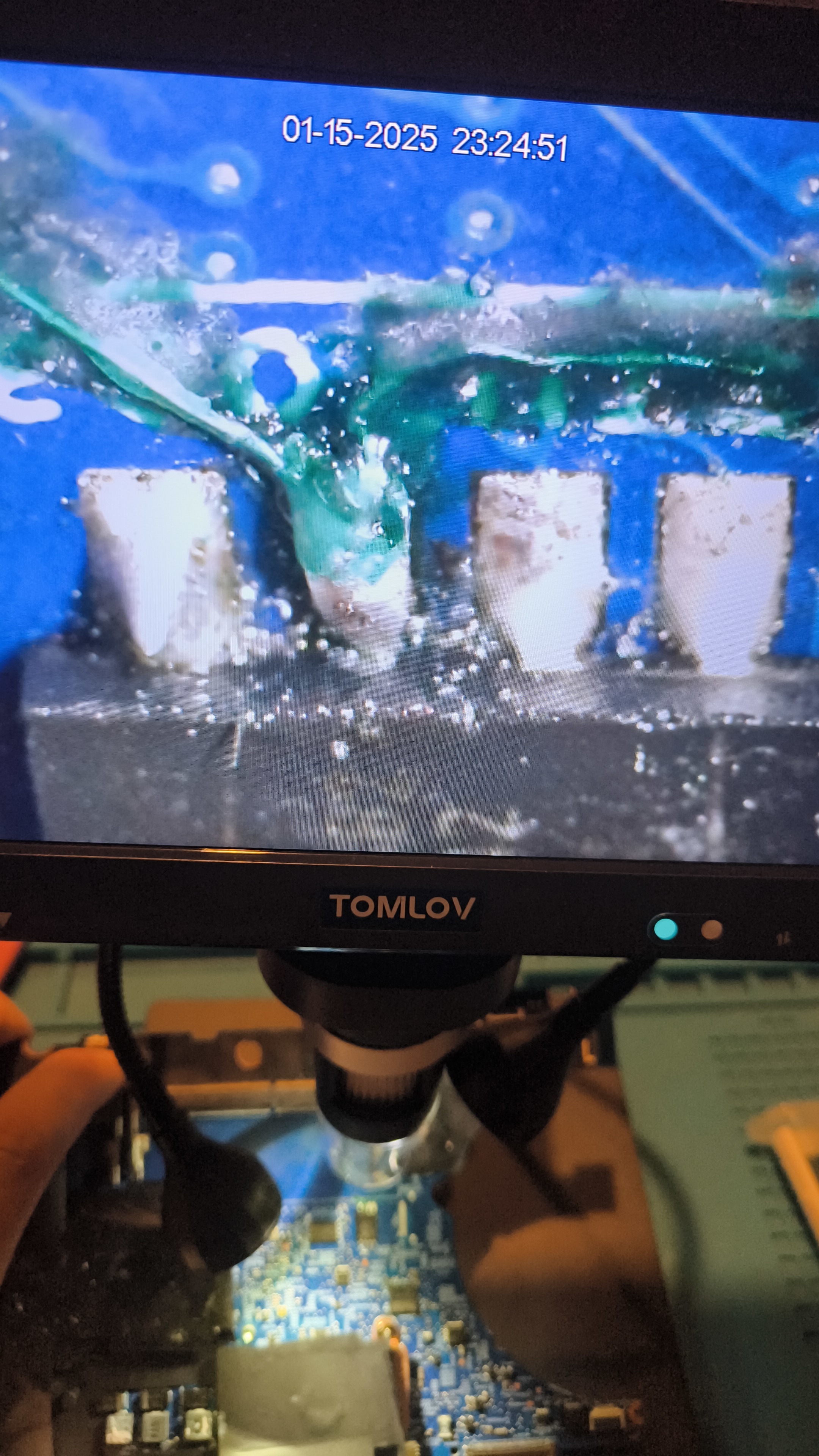

    After a long examination, I was of the opinion that there were two connections - I think it was a mistake.
    Klicke auf die Grafik f?r eine vergr??erte Ansicht  Name: 003.jpg Ansichten: 0 Gr??e: 5,27 MB ID: 3551335 Klicke auf die Grafik f?r eine vergr??erte Ansicht  Name: 005.jpg Ansichten: 4 Gr??e: 5,29 MB ID: 3551336
    In my opinion now, connection 2 and conductor track B are the only connection.
    However, I connected both and tried my luck - unfortunately without success.​
    Klicke auf die Grafik f?r eine vergr??erte Ansicht  Name: 023.jpg Ansichten: 0 Gr??e: 3,21 MB ID: 3551333 Klicke auf die Grafik f?r eine vergr??erte Ansicht  Name: 024.jpg Ansichten: 4 Gr??e: 3,05 MB ID: 3551332
    Unfortunately there isn't one here yet circuit diagram, but could someone send me a picture of their mainboard showing what the original connection looks like?
    Could someone tell me which component my additional connection may have caused damage to - i.e. not towards the BIOS chip but the other direction.
    I'll remove and check the bios chip on Monday when the children are not home - with a bit of luck I'll only have shot the bios chip.​

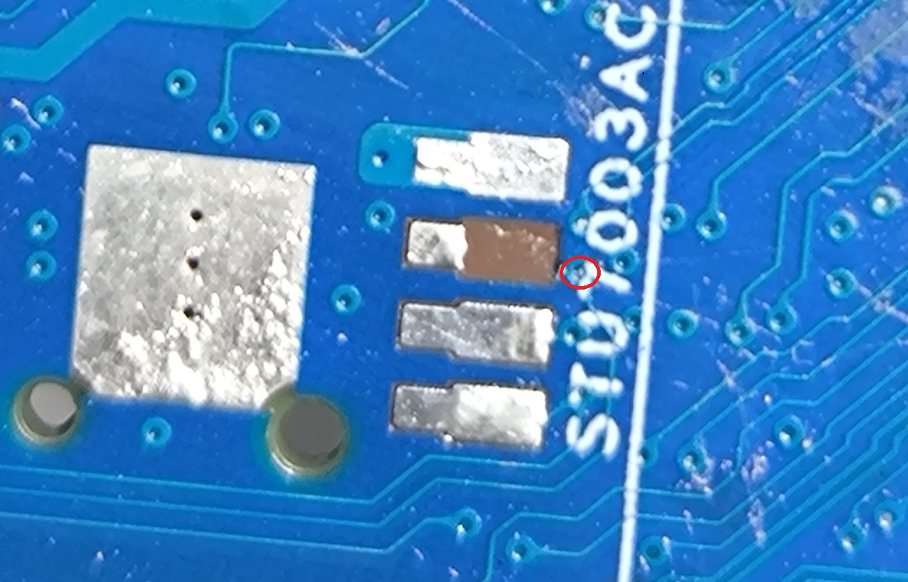

    Click image for larger version  Name:	image.png Views:	0 Size:	1.31 MB ID:	3551460
    only this one, I think.
    use dot repairing or smaller wire on the dot and wrap it like a snail to recreate a pad.

      If you are not shure about a recreation connection, better use a resistor like 1kOhm in between the wiring. In case of a wrong connection, you will not damage a signal / IC.
